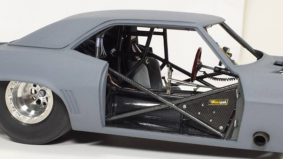

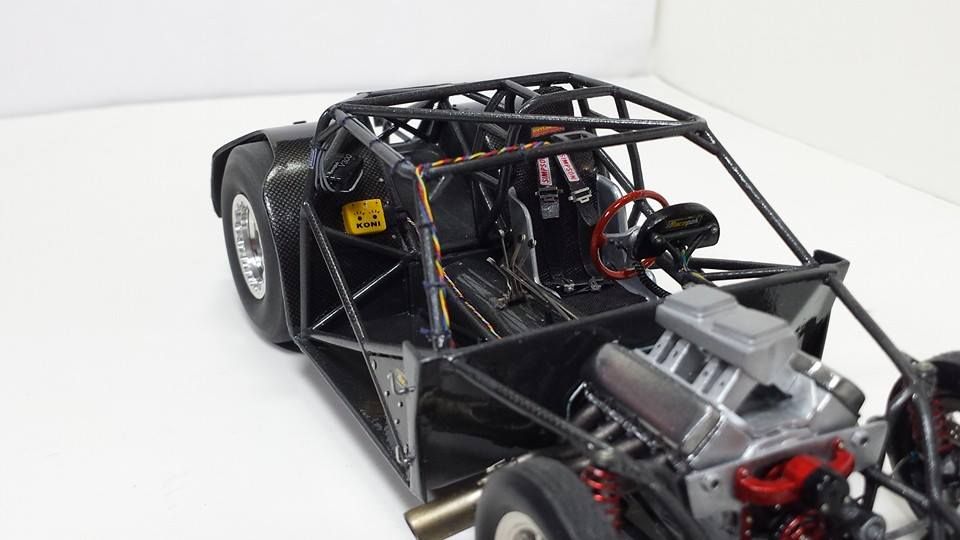

Thanks alot fellas,,,, Fred I'm still not sure on a color yet...lol... I've made some progress on this one... I've got most of the electronics for the inside of the car done and started installing them... I also got the overhead box wired in...
10593101_4583873371802_40251382628987958
16072_4583875091845_6331870551504404478_
10411770_4583875251849_59257852079221823
10644957_4583874891840_47775984066370340
10364177_4583875891865_14938629072373946

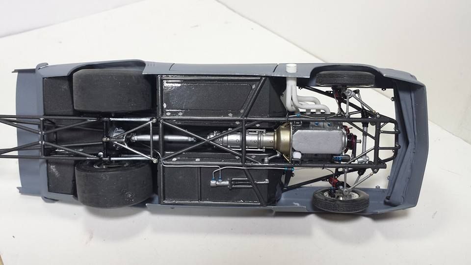

I also started making my headers... I have one made up..
10623080_4583874371827_81482071097388063
10644936_4583874051819_26049702220431944
10364083_4583874731836_26107766773316353

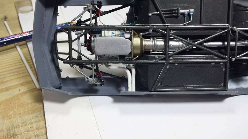

Niko.. I have come up with a way of doing my headers now that works pretty good.. I drill holes in the heads for exhaust ports ....
10615964_4583873531806_91299871063311709
then I make my lower tubes first.. I mark in side the inner fenders where I want them to come out. and tack them together with super glue..
10377632_4583873691810_78391571071433802
then I make the two top tubes....
I then trim the tubes down and add the collectors...
10624908_4583875691860_48040571994653799
drilling the holes has worked well for me Niko... hope this helps...

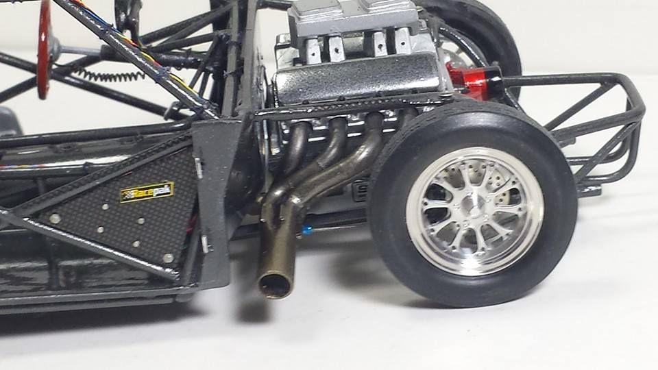

Alright fellas... I've got the headers all finished up.. I added some weld beads from archer decals, painted them gloss black and then hit them with some chrome...
10574225_4586074826837_61931763369200781
then I hit them with different shades of metalizer paints...
10653544_4586074946840_55551566596391999
10606026_4586075106844_89813820846762702
10570409_4586076146870_73130801712974230
10626642_4586075986866_41598430317745229
