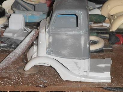

fractalign Posted October 17, 2015 Author Share Posted October 17, 2015 (edited) Hey Guys. I managed to get the swage line added to the hood. I also added some more to the top of the hood as it sloped down to steeply for the planned cowl vent. I have also started filling the gap along the bottom edge of the hood. Like the bottom of the edge of the lower cab section, I will back fill this area with resin too so that it sits flush over the fenders. Next task will be to add the cowl vent and clean up the surface ready to primer. Edited October 17, 2015 by fractalign Quote Link to comment Share on other sites More sharing options...

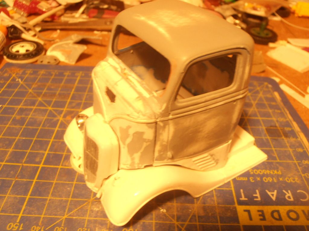

fractalign Posted October 22, 2015 Author Share Posted October 22, 2015 (edited) http:// Hey Guys ! I am back onto using Photobucket again so images are back to full size at last. This one is a little blurry but what I can say is that all the major construction on the cab is complete. The cab now sits firmly in place over the lower section, the swage lines are finished and I have started work on the cowl vent. It has been a long road to get it to this stage but it will be worth it in the end. I added a flange around the cowl area for the hood to lock into. I just need to add the remaining filler to the bottom of the hood and it will sit in place neatly. Next task will be to complete the hood and finish the surface area on it, the cab and the lower section. Edited October 22, 2015 by fractalign Quote Link to comment Share on other sites More sharing options...

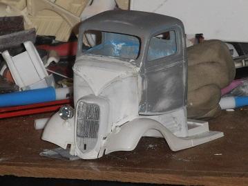

fractalign Posted November 10, 2015 Author Share Posted November 10, 2015 (edited) Hey Guys. Its been a while since I posted anything. Work has not stopped but I have had to make some major changes which slowed things down. Edited November 10, 2015 by fractalign Quote Link to comment Share on other sites More sharing options...

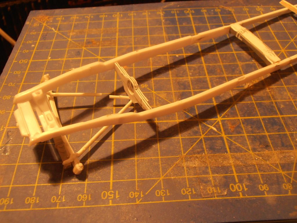

fractalign Posted November 10, 2015 Author Share Posted November 10, 2015 (edited) The biggest problem was the chassis, it was the wrong shape and the running boards did not sit flush with the bottom edge of the rails due to the depth. I bit the bullet and decided to modify the 37 pickup chassis instead. You will notice the step up towards the front. this allows the fender/floor asssemlble to lock into place. This chassis is also much smaller and finer than the other chassis, so I have decided to make this one a 131 inch wheelbase version. Edited November 10, 2015 by fractalign Quote Link to comment Share on other sites More sharing options...

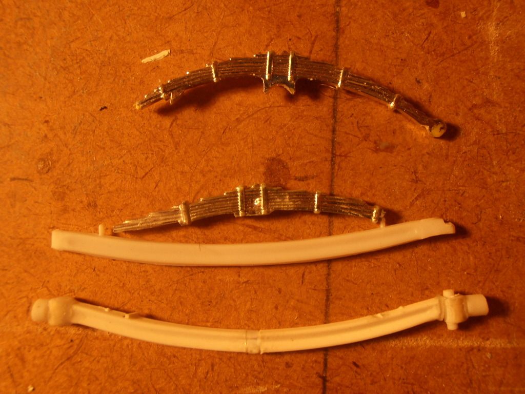

fractalign Posted November 10, 2015 Author Share Posted November 10, 2015 The leaf spring on the front end is actually the rear leaf spring from the Lindberg 34 Pickup kit. I needed this spring due to the higher arch allowing better wheel clearance. Because the new chassis is modified from the 37 pickup version, the fenders sit inline with the chassis rails but there were issues with clearance with the 37 leaf spring. The 34 leaf spring is certainly better detailed and more truck like.http:// Quote Link to comment Share on other sites More sharing options...

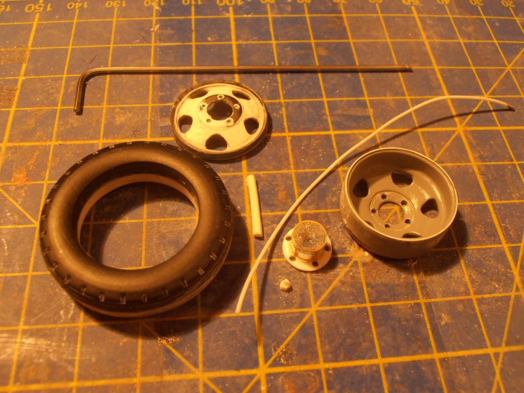

fractalign Posted November 10, 2015 Author Share Posted November 10, 2015 (edited) The other thing I have been focussing on is the wheels, especially the rears. This is new rear wheel with separate hub. You will notice the allen key in the back ground. I moulded this to make up the lugs. You can see one of them in the foreground. The lugs are being cut from the hexagonal tubing that was cast, the studs are being cut from the fine styrene tubing. Its a tedious process but it will be well worth the results. The wheels will have individual lugs for extra realism. With my focus back on the chassis and wheels getting them finished will be the next task. Edited November 10, 2015 by fractalign Quote Link to comment Share on other sites More sharing options...

Chariots of Fire Posted November 11, 2015 Share Posted November 11, 2015 Lots of work, eh?? Have you considered using small brass imitation hex bolts for the lug nuts? Really saves a lot of work and they look great because they are so nice and clean. Quote Link to comment Share on other sites More sharing options...

fractalign Posted November 25, 2015 Author Share Posted November 25, 2015 Hey Guys. Sorry for the lack of updates. I have been somewhat preoccupied. I found a new FB group that is all about 28 to 38 AA ad BB trucks. It has been a wealth of information. Scrolling down though the images I saw one of a 1935 Dump Truck. I could tell straight away that the front end on the truck was much heavier duty than mine. The spring has less of an arch and the axle is less bowed. As a result I have begun to rework mine to look like the one in the image. Quote Link to comment Share on other sites More sharing options...
fractalign Posted November 25, 2015 Author Share Posted November 25, 2015 (edited) The new spring is a modified version of the AMT 33 Willys rear leaf spring. The ends have been cut off and the ends from the AMT 34 Ford Corvette Rear end are being added. The was a corvette IRS so it is less bowed on the ends, which is perfect. The axle above is the one I will be using. I have bet it down and rather than widen it at the centre like the old one below, I simply shaved the stub axle mounts which have become part of the axle. The new stub axles will simply be grafted on from the old axle below. The other thing I have been working on is the chassis. The rear rails behind the cab have been raised to meet the bottom of the cab edge. The rails are deeper and more truck like as result. I have been moulding the cross members from the old chassis to add to this one, rather than trying to scratch build them, that will save time. As for the wheels and tyres I was un happy with the tyres I was using so I have scratch built my own that I hope to mould tomorrow. This will be very different to anything else out there. The centre section was machined from resin with the tread carved in. I am not sure when I will get photos of the finished wheels and tyres, the photo uploader o my computer is giving me trouble. When I do get it sorted out I will have photos of the finished wheels ad hopefully the chassis as well. Edited January 28, 2016 by fractalign Quote Link to comment Share on other sites More sharing options...
