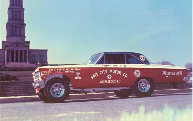

I am looking for some under hood shots of the Altered Wheelbase hardtop that was campaigned by the Sox and Martin team.I am interested in seeing the inner fenders and how they were modified from stock when the "k member" was moved forward. Would anybody have any to share?

But but basically, just like mentioned. they just moved the whole shock tower plate forward and welded in flat sheetmetal where it used to be ( sometimes )

That's what I figured but then I see some pictures that looking in the wheelwell it looks like a rollbar tube from maybe where the hinge point of the doors down to the base of the shock tower. I have see nsome pictures of the restored cars that show this but not sure if it was like this back in '65.

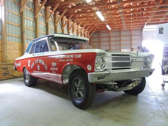

Wish I had taken better ones, but here are a few shots I took when I saw it last year. If it's actually how it was back in 65 I'm not sure. Sending you a PM, too.

Keep in mind this is the sedan,,, aka Paper Tiger II . Which was a shop built car ,,
All the Mopar OEM built cars were hardtops
Ahhh...I see, thanks for the heads-up Bill. I was unaware that this one was shop built and might have been prepped differently from the hardtops.

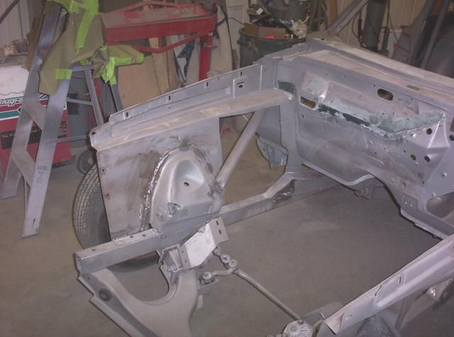

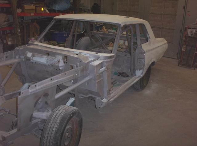

If you look in the front wheel opening, below, behind the front wheel, it looks like some kind of structure in there like it might be simliar to the Sedan.
These are from a website I found that has pictures of the Altered Sedan as it was being restored but I am not sure if the Hardtop was the same or not.
Website in which I found the restored pics from http://hiteautobodyandrestoration.com/projects/main.php. They also have pictures of the 71 Sox and Martin Cuda and 71 Dick Landy Challenger.

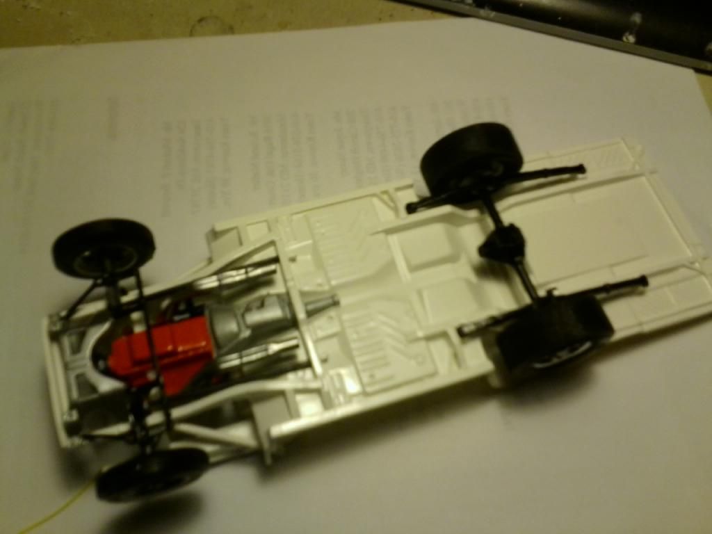

Just some quick pictures of my latest project. Speed City Resin body, Lindberg 64 Plymouth Chassis.

Looking really good.
I really like the speed city stuff. Have the same project in a box waiting for me.

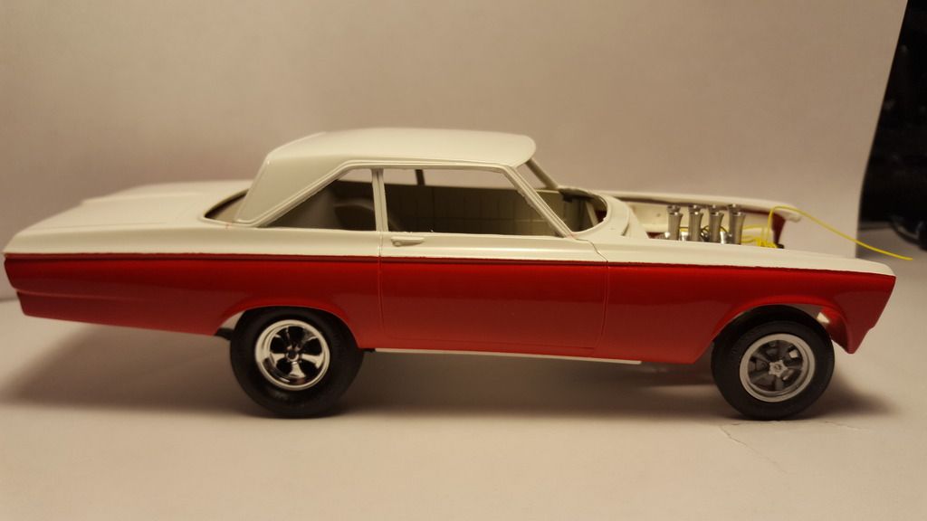

After 2 years, let the painting commence. I just finished reading the new Sox & Martin book that has been released and it got me to thinking about this and others I have to build.
