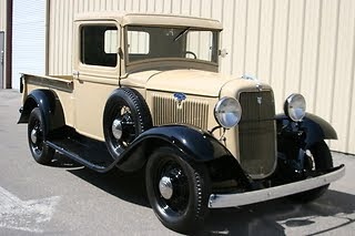

The plan is a close copy of this stock '34 that I found on the net.

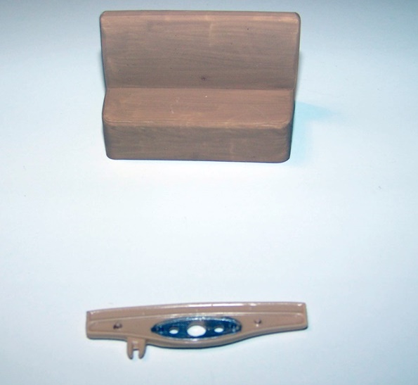

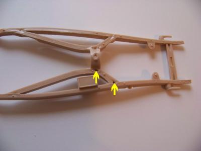

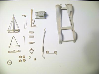

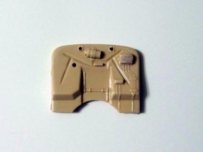

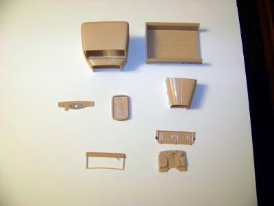

After countless hours of prep work removing parting lines and sanding, I was finally able to get some parts primed and painted.
I still have some other parts to prime, hopefully the humidity will be co-operative tomorrow. Today was the first day in quite awhile where it wasn't 80% or higher.
The cab, bed, hood and radiator shell were sanded with polishing clothes working up to 12,000 grit. I plan on leaving them in the tan the kit was molded in. The fenders will be gloss black.

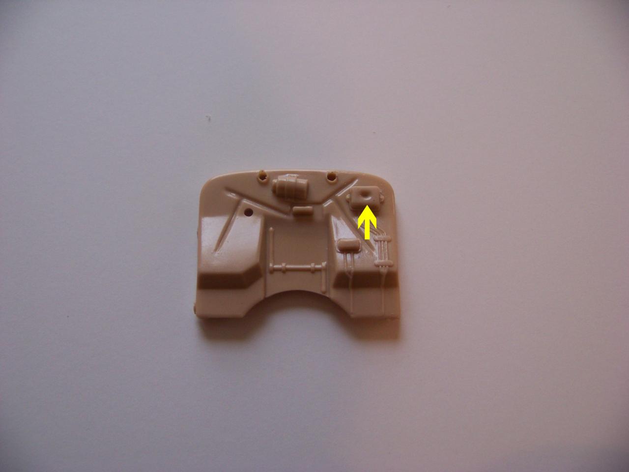

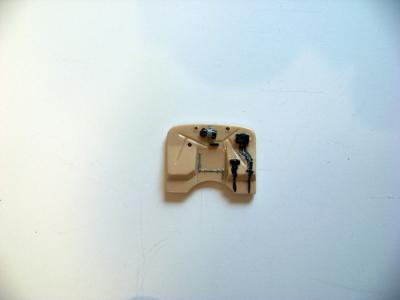

The firewall will also be left tan but I will do a little detail painting on it. I filled the hole in the voltage regulator with some sprue glue which I made with some shavings and acetone.

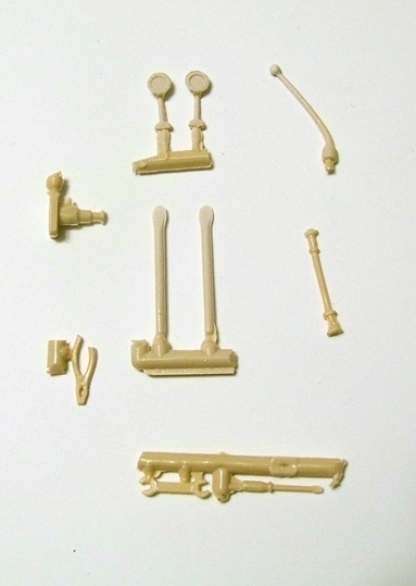

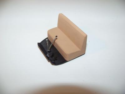

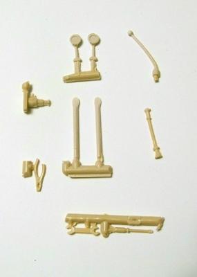

I also stripped the chrome from the tools, mirrors, gearshift and brake handle.
I still need to prep the wrecker boom from a later issue kit. That will take some work as it was molded in red.
I should be able to get to painting everything this weekend.
post-12704-0-69606500-1408066771_thumb.j
post-12704-0-02052900-1408066773_thumb.j
post-12704-0-09781500-1408066774_thumb.j
post-12704-0-52846000-1408066775_thumb.j
post-12704-0-53595500-1408066776_thumb.j
post-12704-0-58601300-1408066777_thumb.j

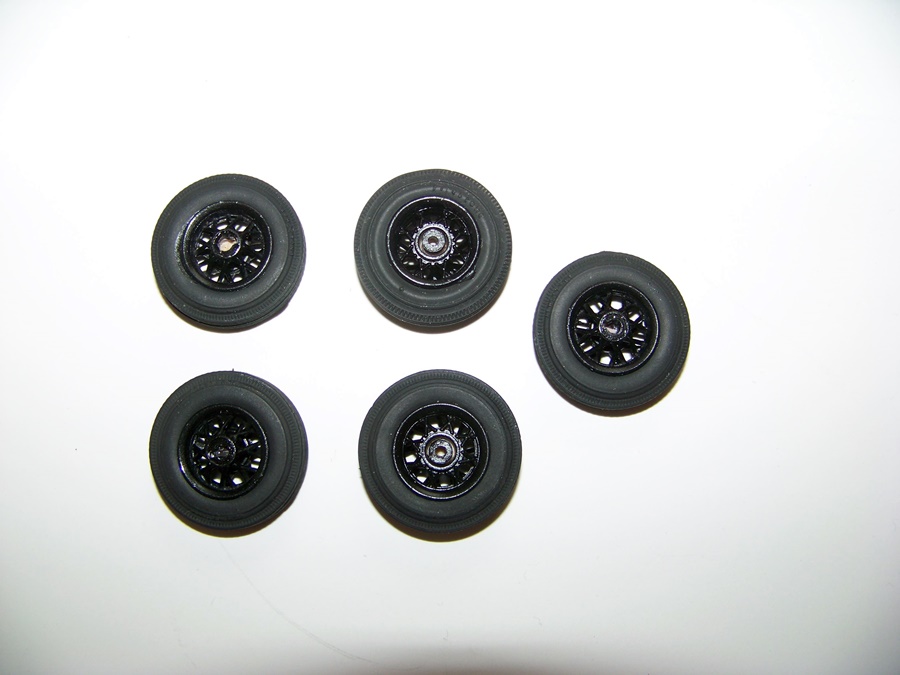

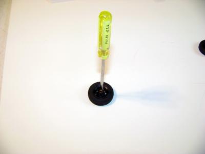

I glass beaded the tires and painted the rims gloss black. I used a small blade screwdriver to line up the spokes the best I could.

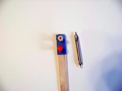

Also drilled out the horn for a more realistic look.
Firewall detailed, a little touchup work needed here and there.

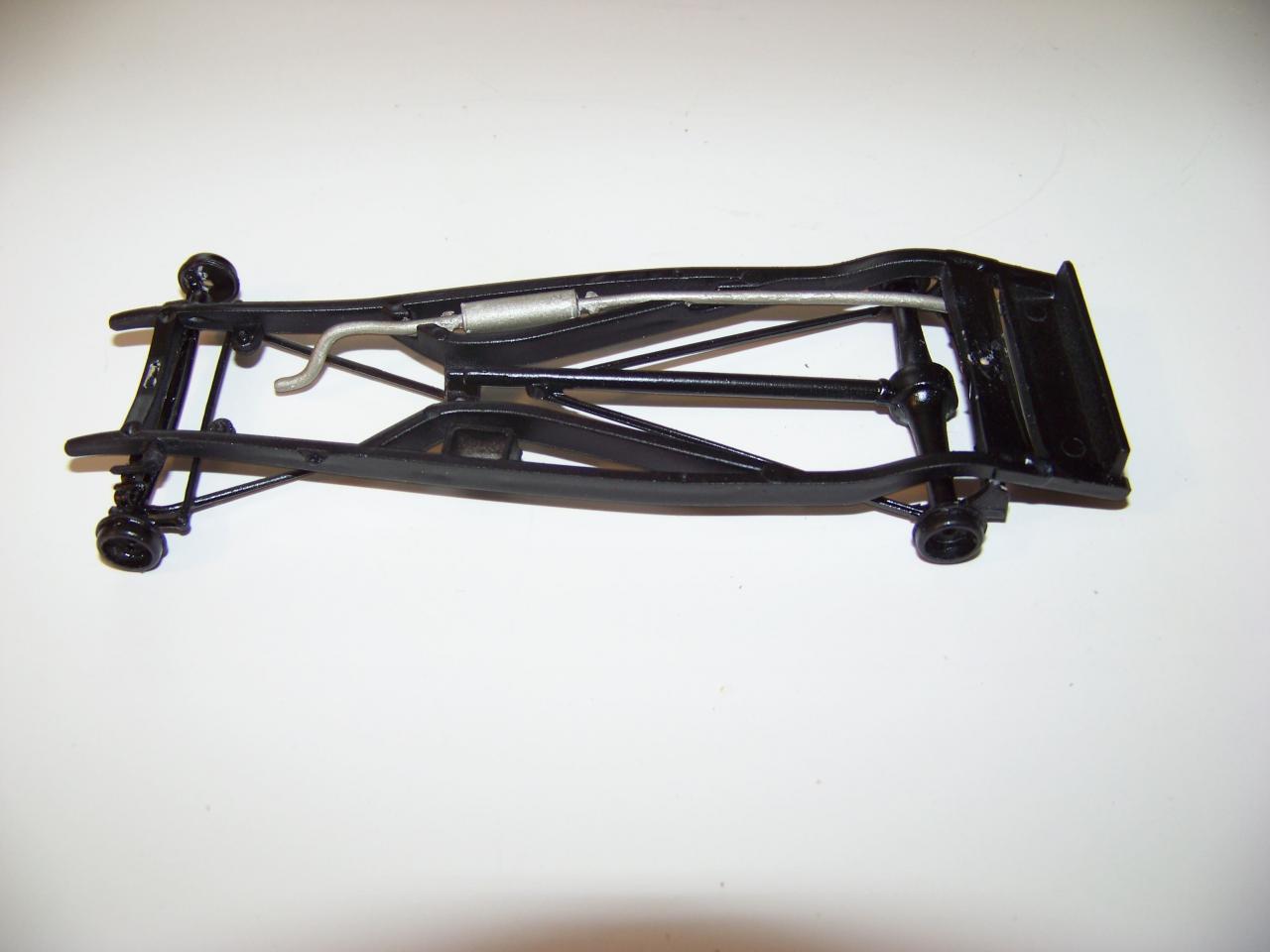

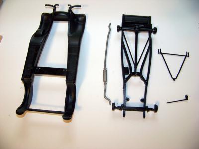

Frame painted satin black with gloss black suspension and drivetrain.

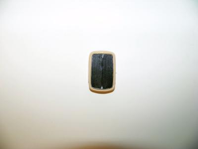

Grill painted satin black with a silver sharpie for the emblem and trim.

Don't see this kit built stock very often...you're doing a nice job! Like the idea of using a Sharpie to highlite the grille pieces.

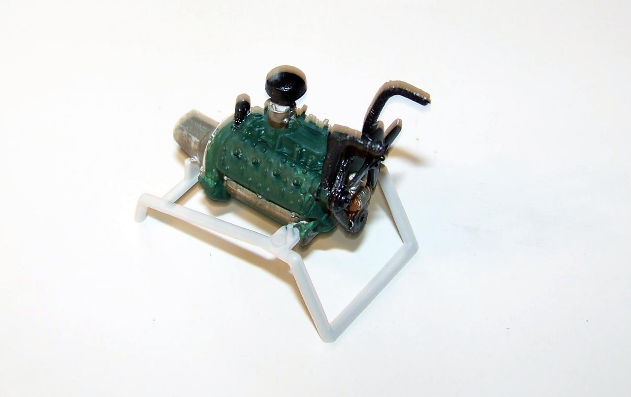

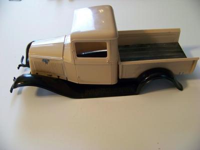

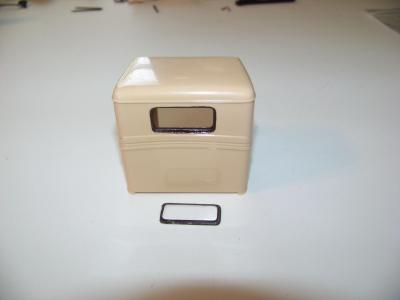

An update as of today.
Engine painted, after looking at the photo's I see a little touchup is required.
I painted around the rear window of the cab to simulate a gasket. I'm not sure if that is correct or not as I couldn't find any reference pics. If not it at least adds some contrast to the tan body. I also painted the inside lip of the clear back window.
Started assembly of the chassis and components, waiting for the cement to set up before going any further.

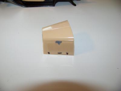

Attempted to detail paint the hood emblems, handles & catches. Looks better in person plus it's going to be a shelf model.
Finally had a break in the weather with only 50% humidity to get some paint on the fenders.
One setback was somehow the windshield has mysteriously disappeared. I'd like to blame it on the cat but I don't have one! Luckily I had a parts kit but that windshield was scratched worse than the one that was "misplaced". I sanded it out working up to a 12,000 grit cloth & brushed on some Future. It will have to do.
A quick mockup of how it will look. The only component I painted was the fender assembly. The rest of the components will be the molded tan color that I polished out.
I am going to wait until the weekend to start the final assembly as I want the painted fenders to finish gassing out.
post-12704-0-73700500-1410385780_thumb.j post-12704-0-16082100-1410386062_thumb.j
post-12704-0-54636400-1410385903_thumb.j post-12704-0-75384100-1410386087_thumb.j
post-12704-0-87511500-1410385932_thumb.j post-12704-0-23244900-1410386191_thumb.j
