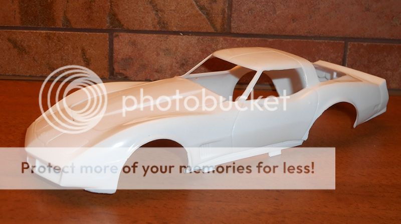

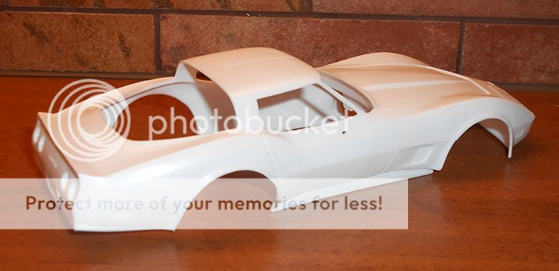

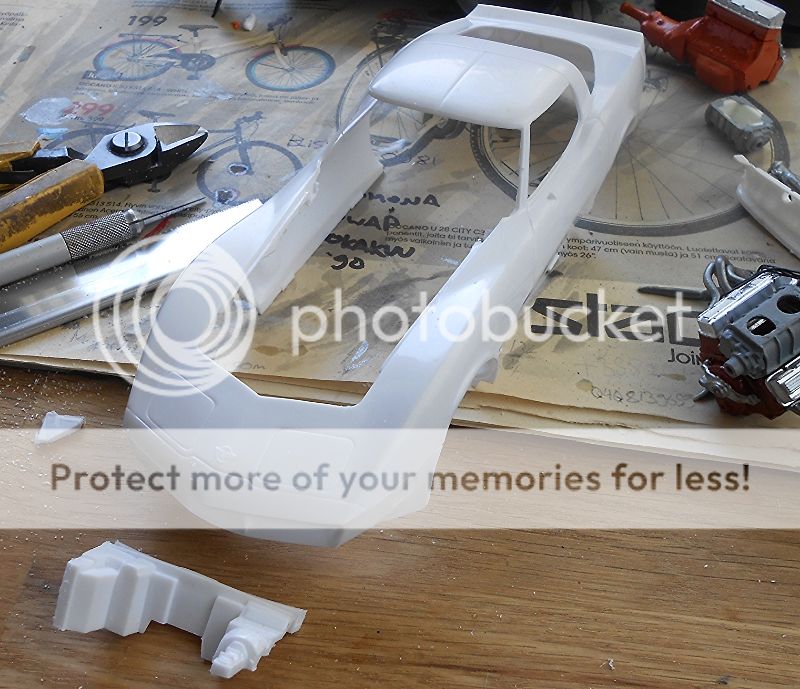

Here are a couple of pics of the original body.

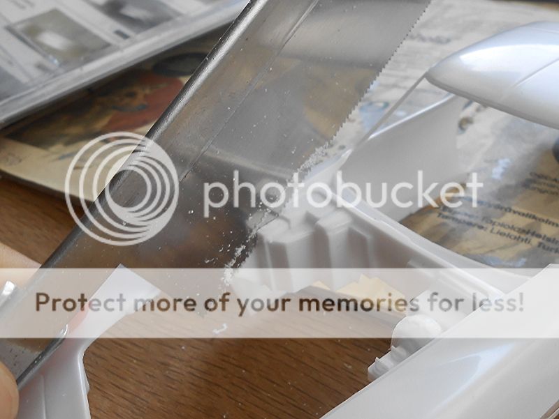

The firewall was molded to the body as one piece, so it had to go first. With my razor saw, I cut it away and then I glued the hood shut, as Pro Mods have one piece nose.

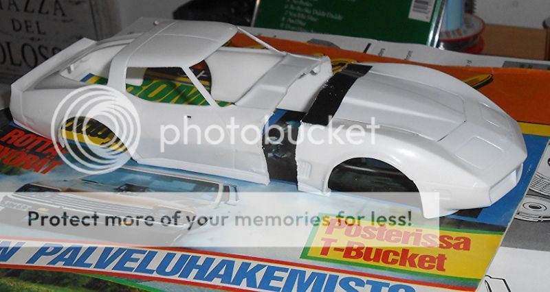

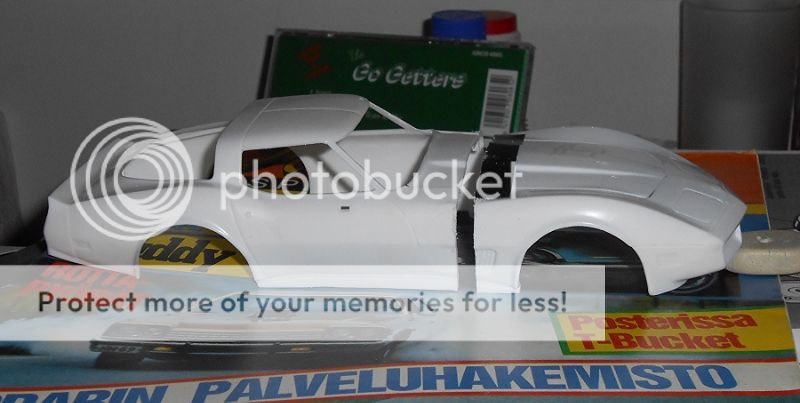

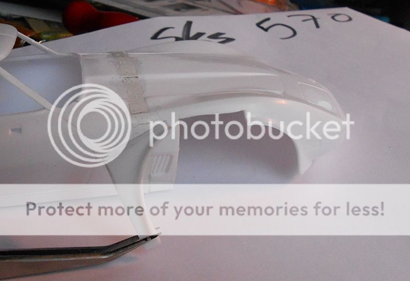

Today I decided to cut the front end off to wait for stretching. I used Dymo-tape as a quide and used my razor saw again.
This picture shows how much the wheelbase must be stretched.

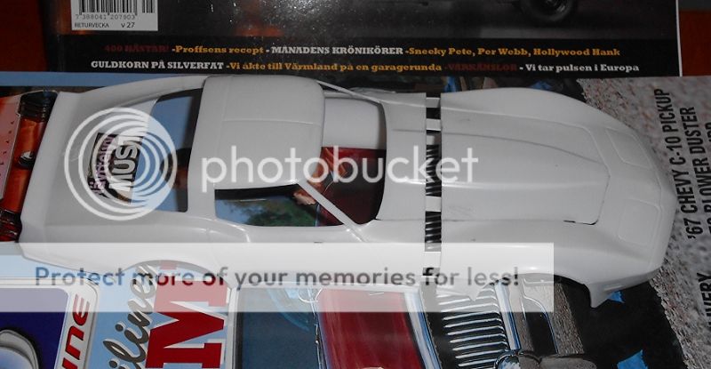

Well here's a little update. After cutting the front end in two pieces, I glued small bits of styrene inside the body and I put 0.20 inch marks on them. Now I could glue the front end back on, and the wheelbase should be correct now. I'm not sure if this description makes completely sense, but I'm pretty sure that the pictures will be worth thousand words on this one. Next step will be filling the gap with styrene.

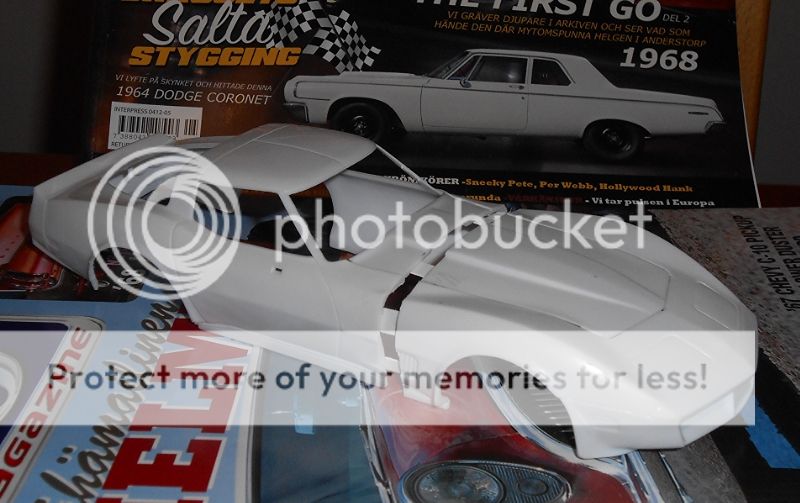

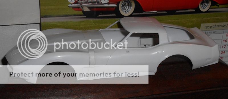

A Minor Update for this one, too. It's the same story as with my '55 Chevy that I've had zero time for modeling in a while. Luckily today I was able to make a little progress with this. Not that much, but as I'm doing this as a Step By Step thread, I think this might be worth posting anyway. So I filled the gap on the nose with sheet styrene. I used two different styrenes: Thicker one where it doesn't need to be bent that much and where I had to bend the styrene, I used thinner material. It was actually really easy to fill the gap, but it's still in rough stages. When I can get a bit more time to work with this, I'll rough sand it and then continue with other body modifications... Stay Tuned.

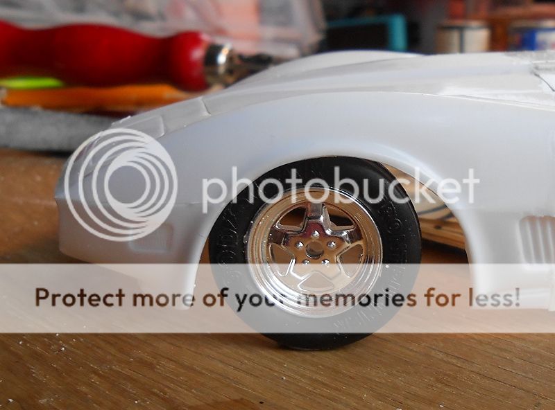

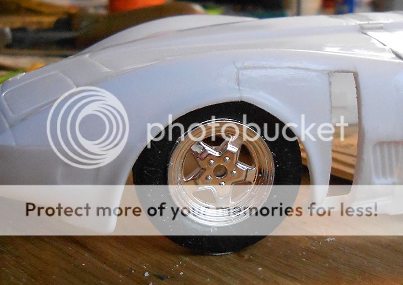

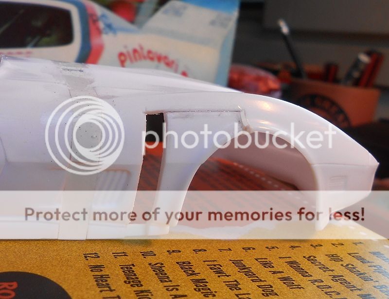

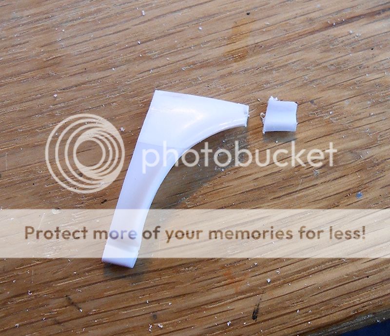

Today I started working with the front tire openings on the body. The Frontrunners looked way too small on the original wheel openings, so I did what has been done to many Pro Mod bodies and I decided to make the wheel openings a bit shorter. Of course the first thing to do was a little mock up with the tires I'll be using. I'm not going to use those wheels, they're for mock up only.

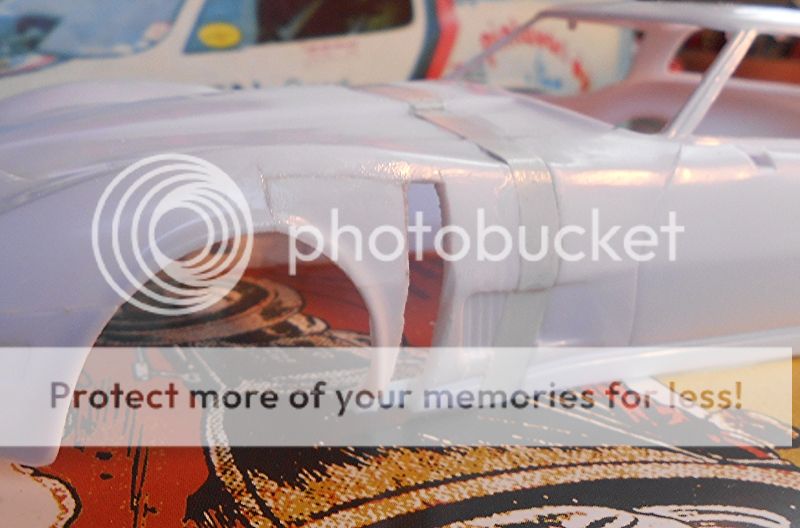

Then I marked on the body where should I cut so I took out my razor saw and cut out the rear part of the front wheel opening. Then I mocked up the front tire on place again and marked on the part I had just cut out from the body, how much the wheel opening must be shortened and shortened it a little.
Then I did the same thing for the other side, and glued the parts back on. Now the wheel openings are much better and the front tire looks good in those openings. I did a little mistake on the co-driver's side so I had to add a little styrene between the body and the part that I glued back on.
As you can see, it's still very rough, but once I get it sanded smooth and when I put some more liquid glue to smooth it out, it should look really good. Hopefully I will have more pics soon.
Next I must fill the gap and continue sanding the body. I must narrow that thing as well some day. :)
