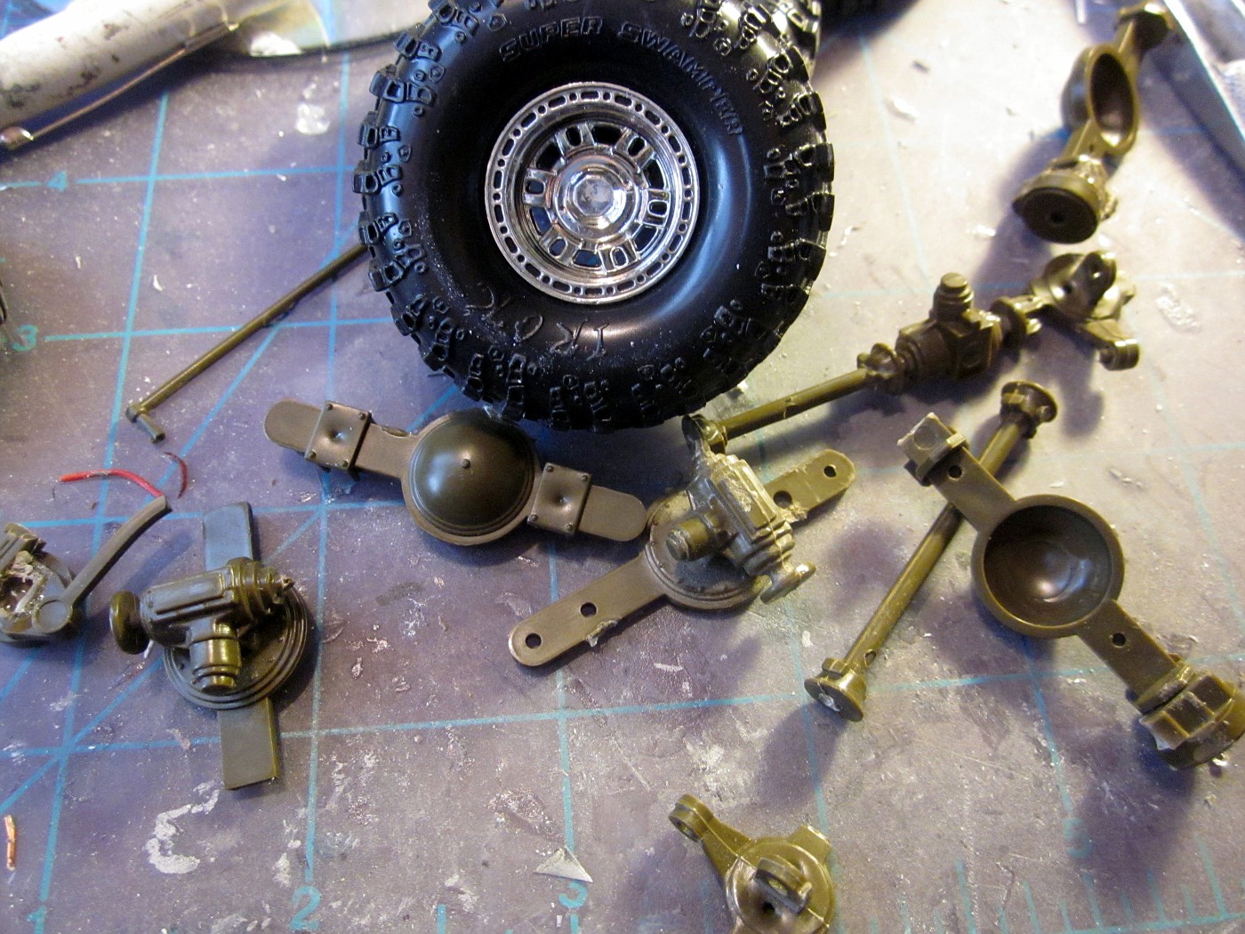

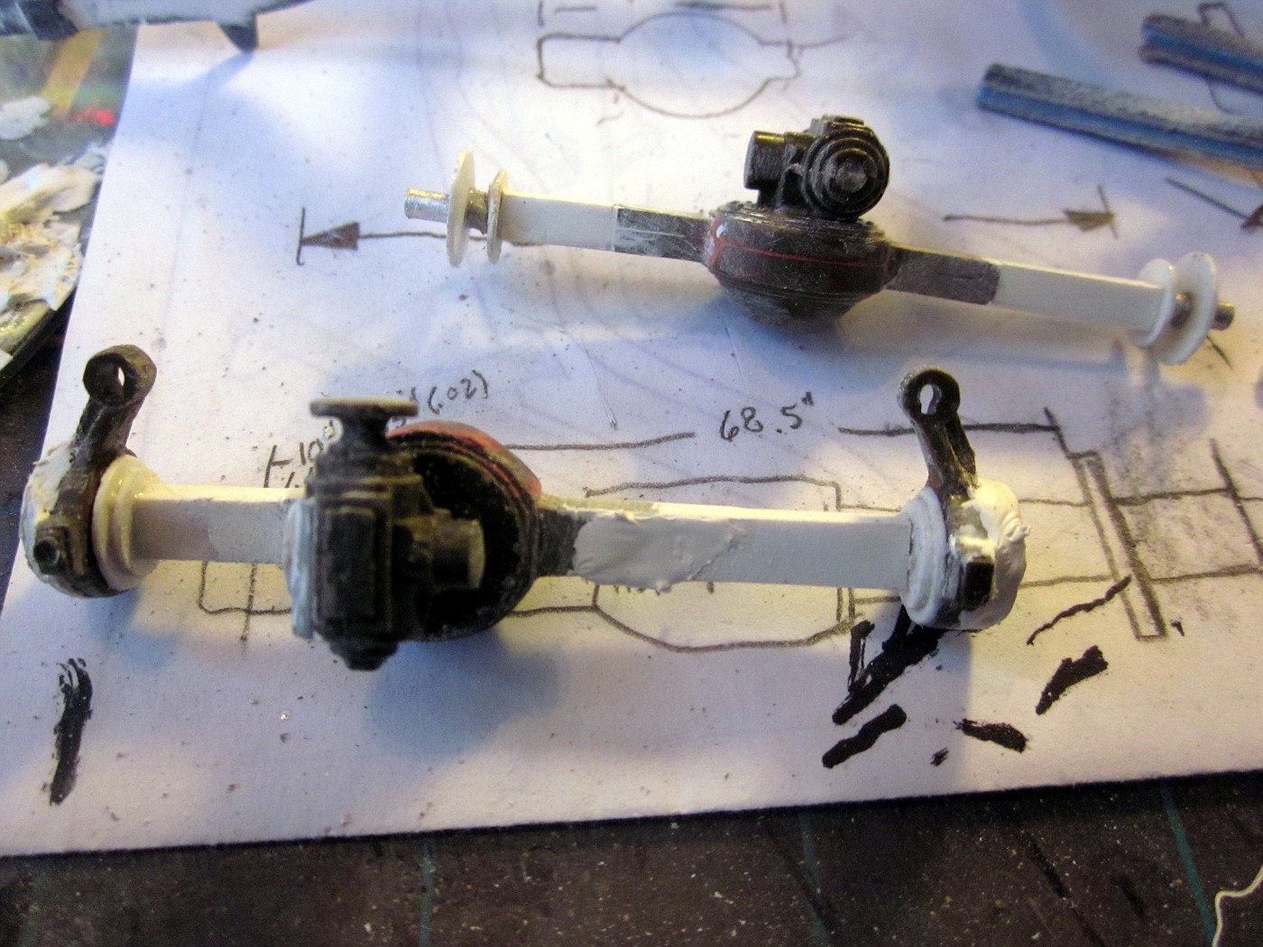

Now on to the fun part. The real J20 has 2 1/2 ton Rockwell top loader axles and 49" Super Swamper Irok tires under it. The tires were easy. I had a set of 49" Iroks I had been hoarding from a So Real diecast that were exactly what I needed. The hard part, they have never made (that I have found) a duce and a half in 1/25 scale. While some resort to using the axles from under a monster truck kit, IMHO they do not look anything like a 2 1/2 ton Rockwell. My solution was to use the axles from the Revell 1/32 5 ton Wrecker kit. They are kinda toy like and not exactly to scale, but with a little tweeking the will do for this build.
IMG_1311-vi.jpgHosted on Fotki

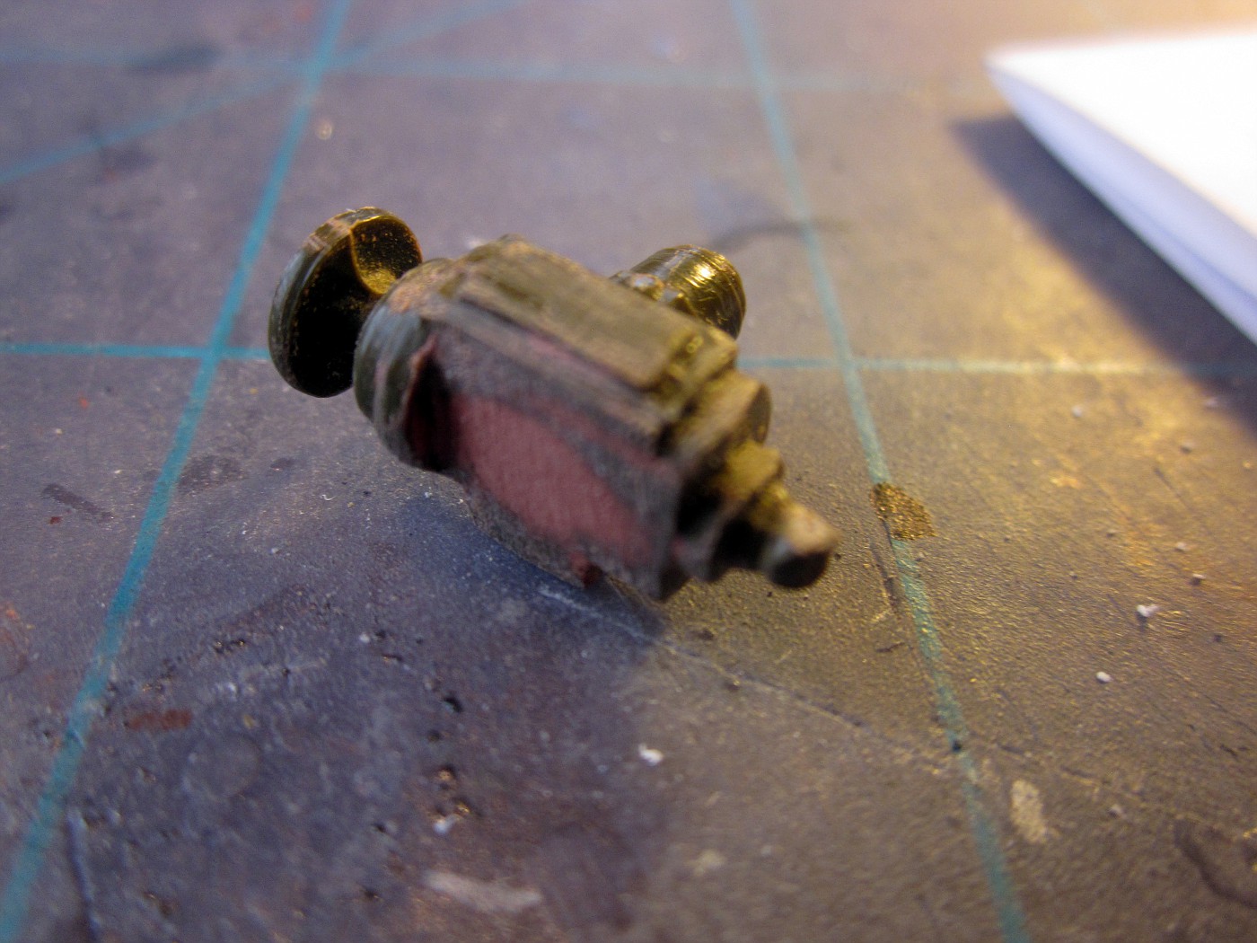

First step was to get the top loader looking a little more realistic.
IMG_1320-vi.jpgHosted on Fotki
A little Plastistruct half round, some Evergreen sheet and some super glue and it already looks a little more correct.
IMG_1322-vi.jpgHosted on Fotki
Added some Evergreen square to get the track width a little better, some .020 sheet to make some flanges and some Tamiya putty and there starting to look a little more like the real thing.

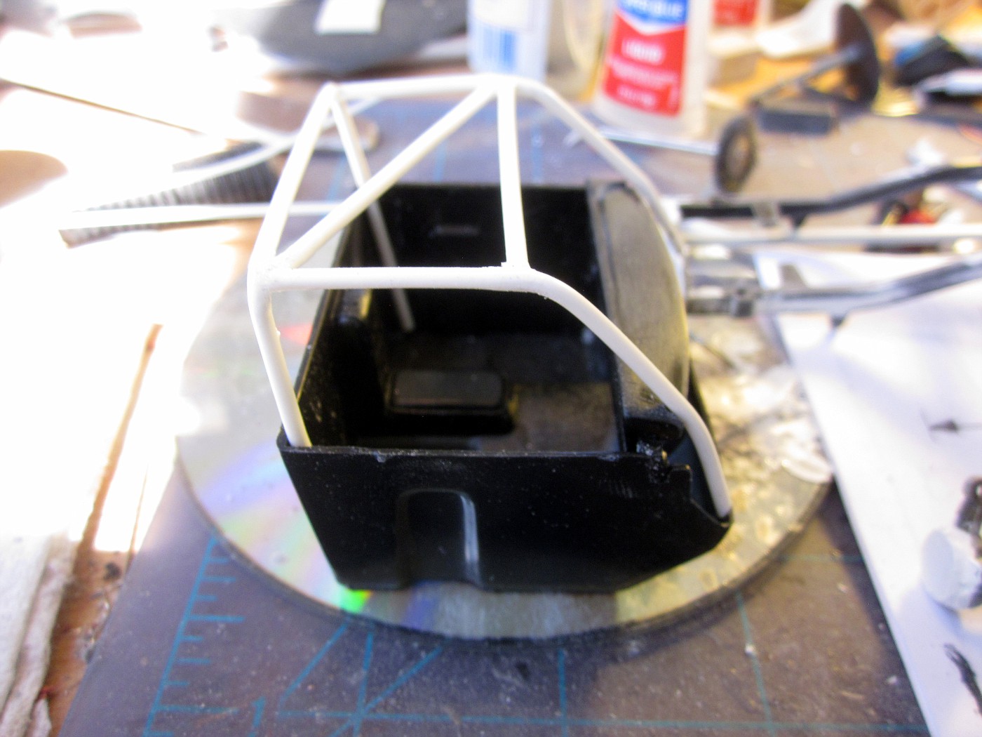

Built a quick simple cage from .080 rod.

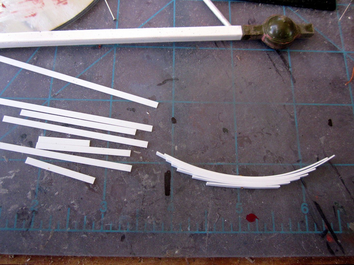

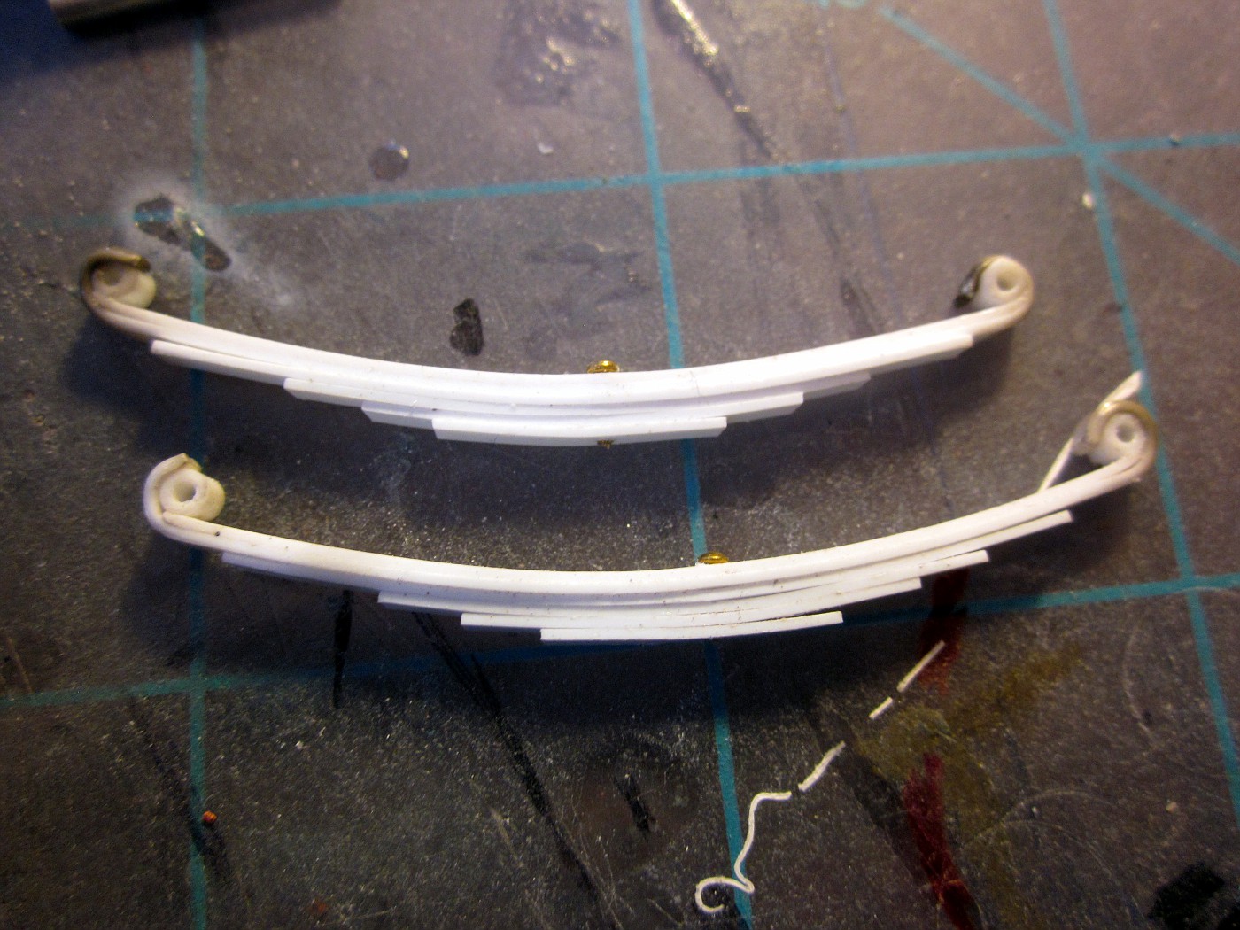

Now its on to the suspension. Started building some leaf springs out of .010 x .020 Evergreen strip. (these will be fully functional when done)

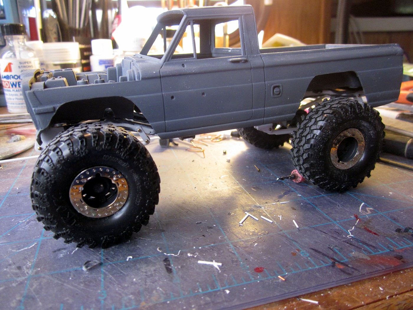

Not a whole lot of progress.
IMG_1375-vi.jpgHosted on Fotki

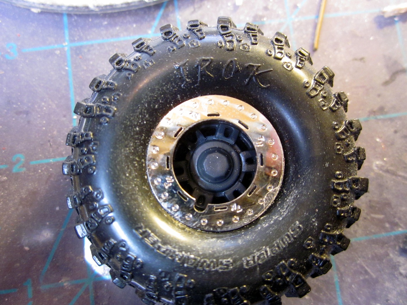

Got a set of the Trail Ready Bead locks from dirtmodeler.com. Will likely spray them with some dull coat to tone down the chrome.
IMG_1376-vi.jpgHosted on Fotki
IMG_1377-vi.jpgHosted on Fotki
IMG_1378-vi.jpgHosted on Fotki

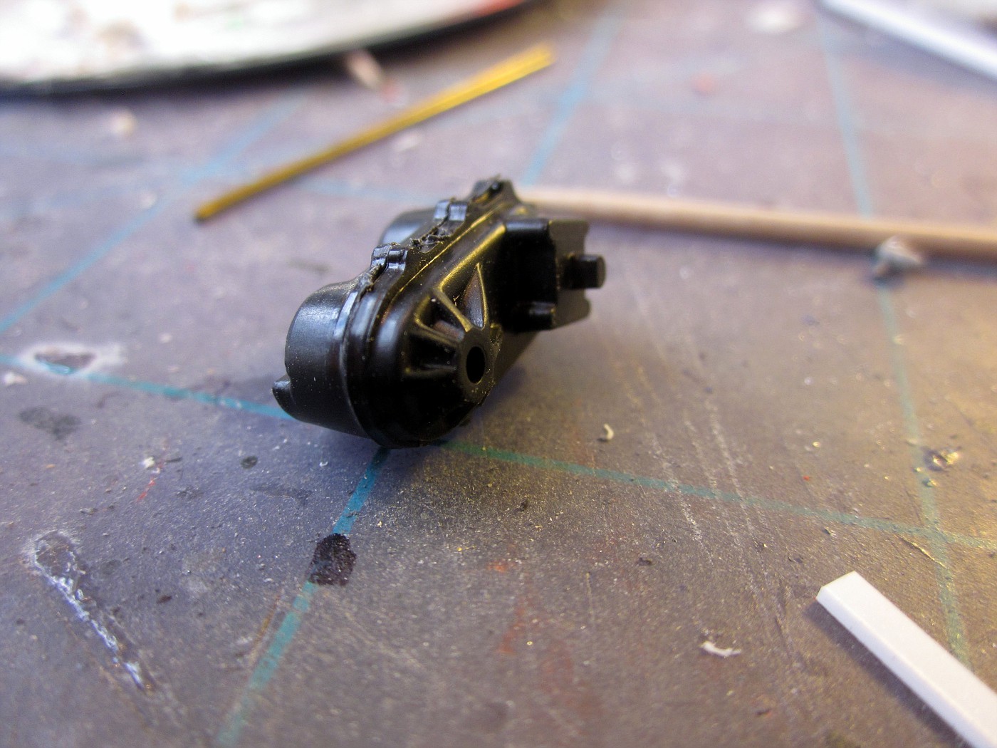

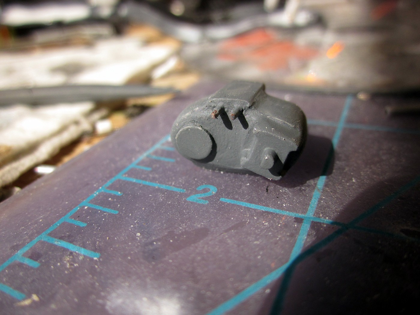

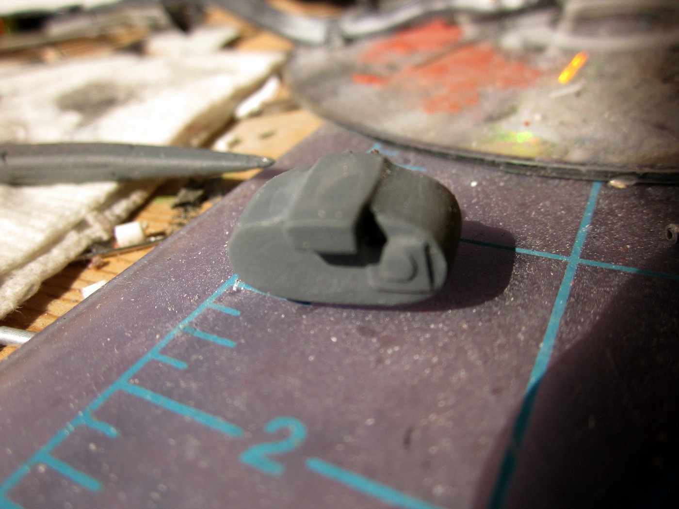

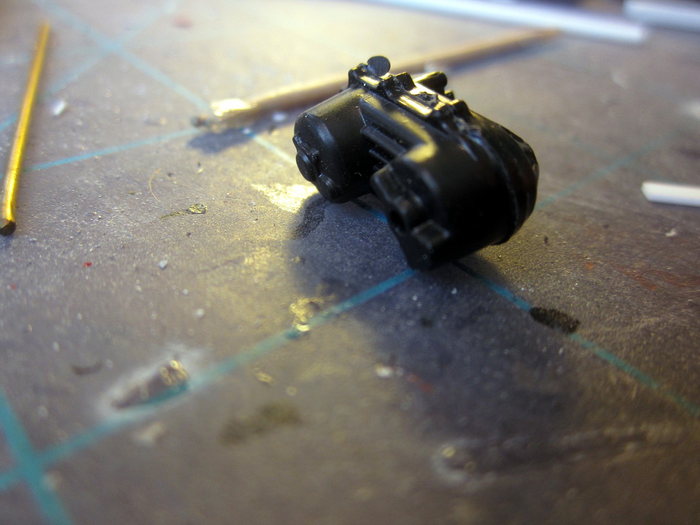

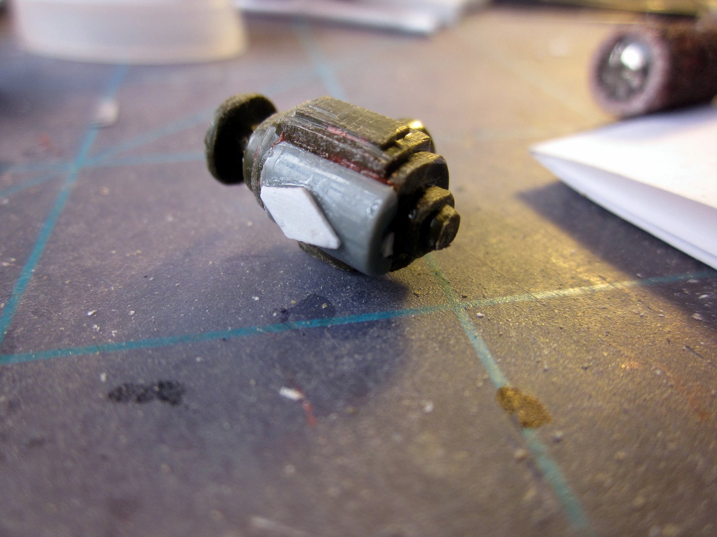

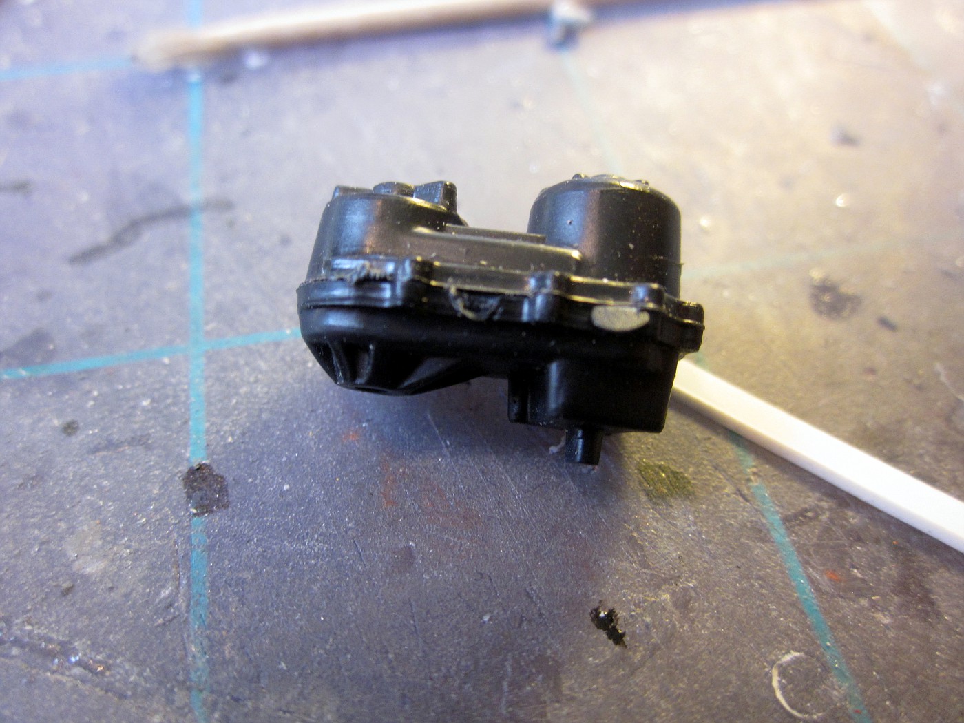

Not a fan of the real Quadratrack t-case so I had to do something with the kit supplied case.
IMG_1387-vi.jpgHosted on Fotki
IMG_1389-vi.jpgHosted on Fotki
A little sanding, some Evergreen pieces and some putty and we have a much more acceptable Atlas II t-case.
IMG_1380-vi.jpgHosted on Fotki

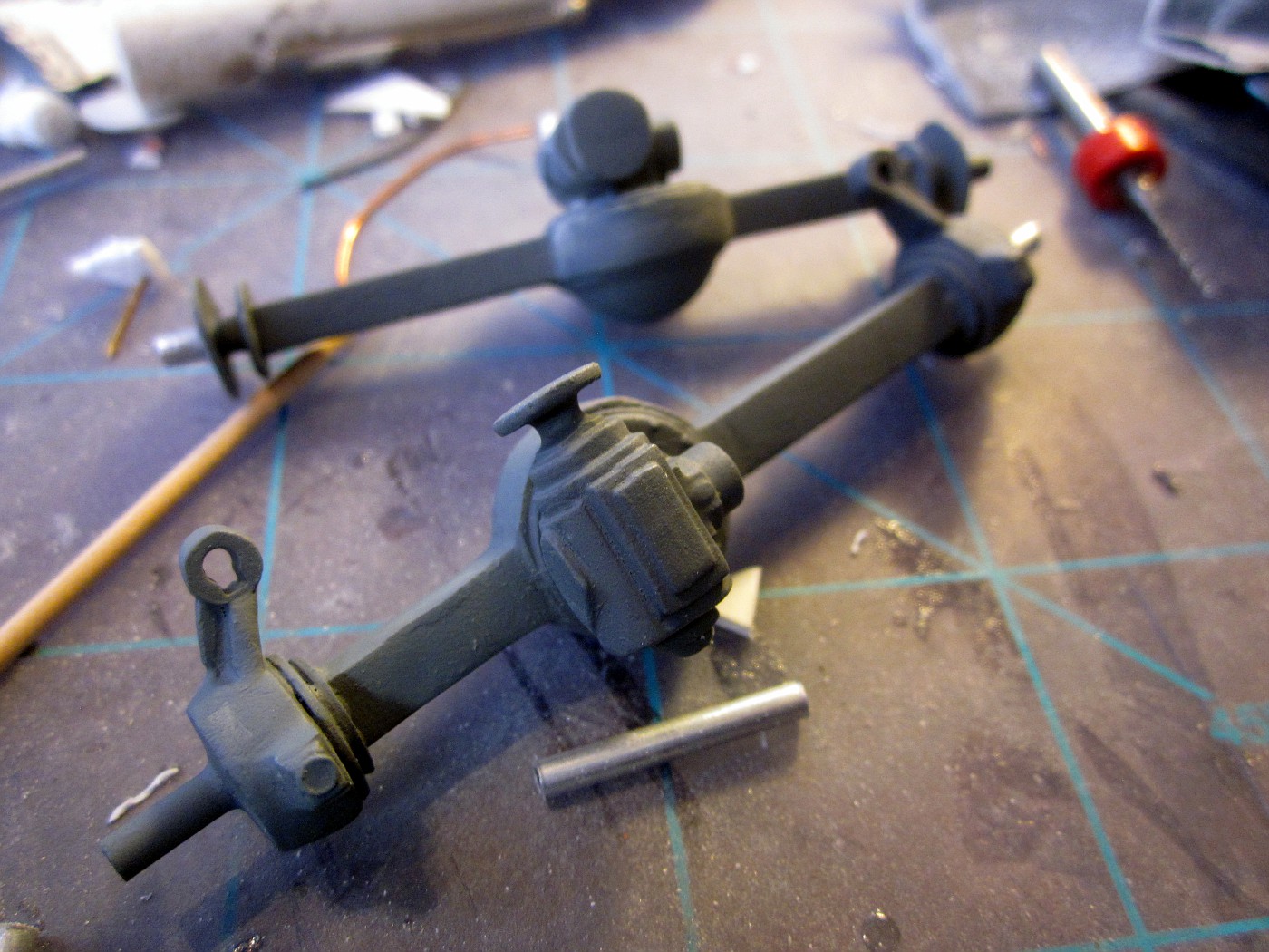

Axles are basically done.
IMG_1383-vi.jpgHosted on Fotki

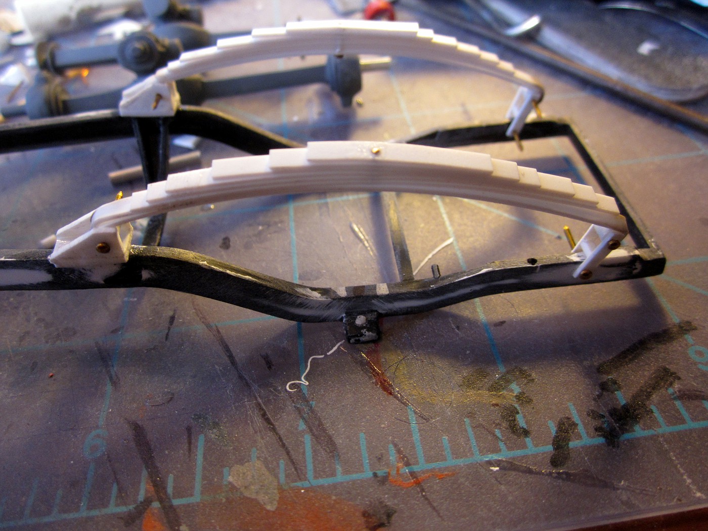

Rear springs mounted.
IMG_1384-vi.jpgHosted on Fotki
IMG_1386-vi.jpgHosted on Fotki

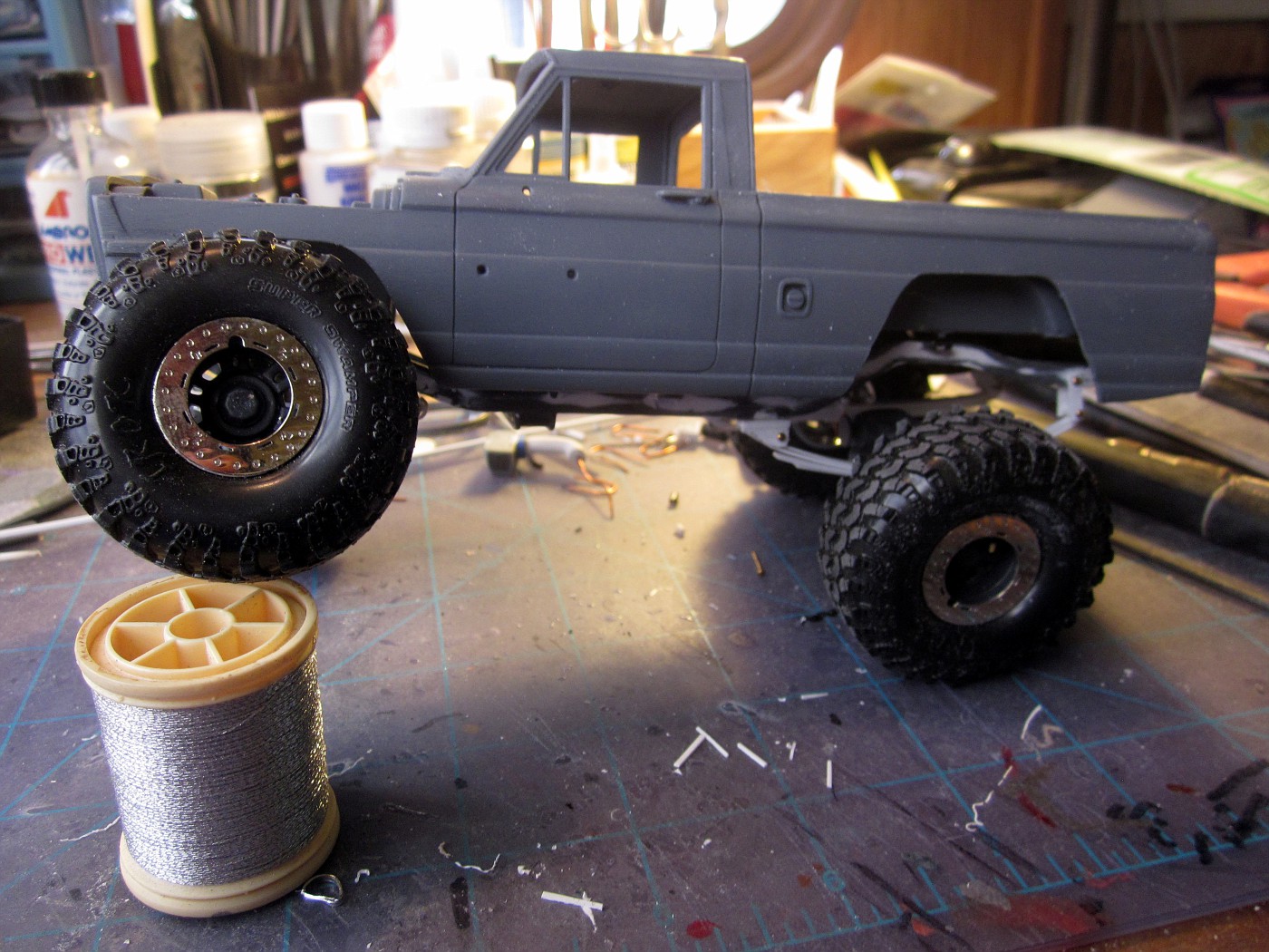

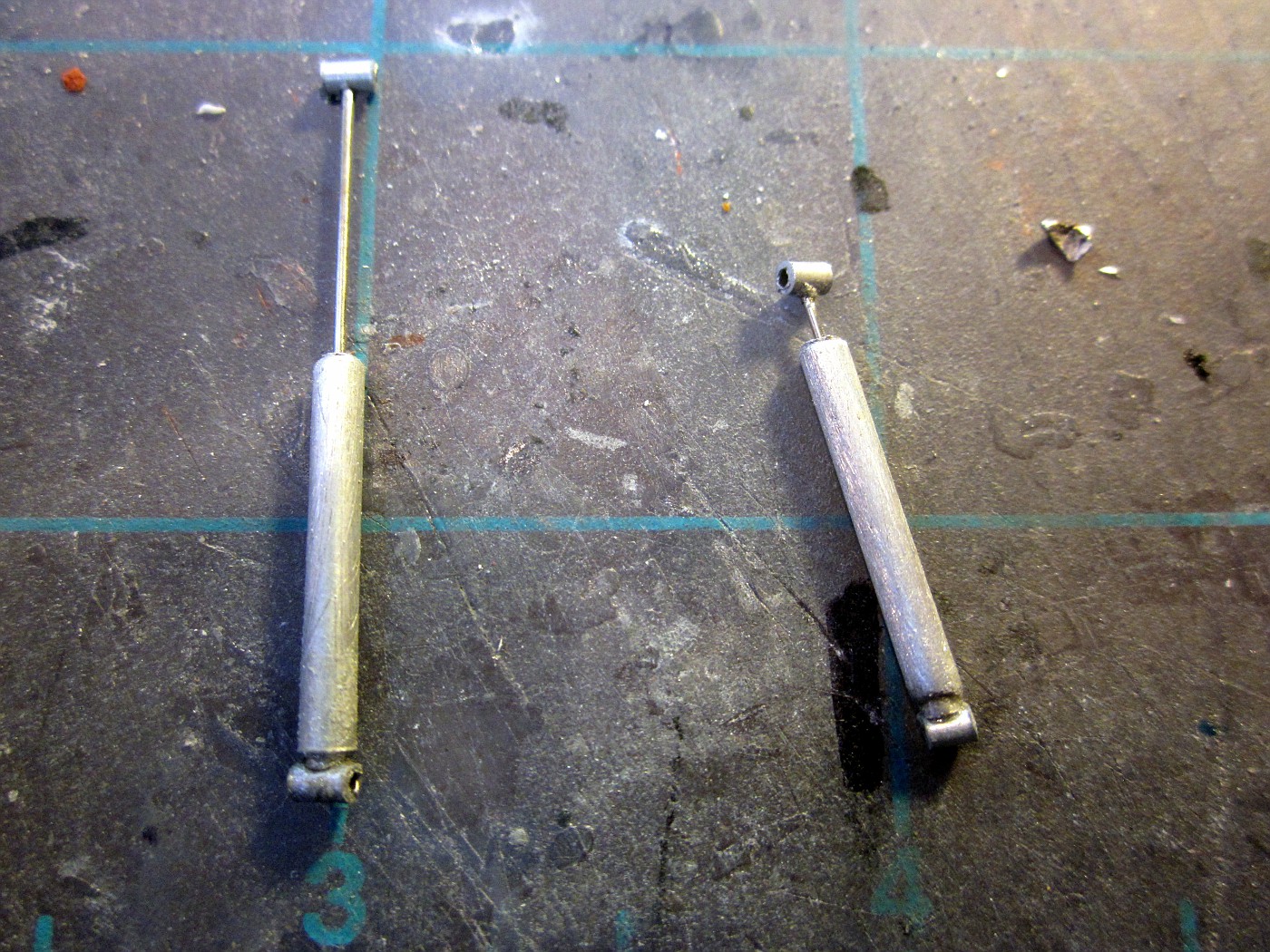

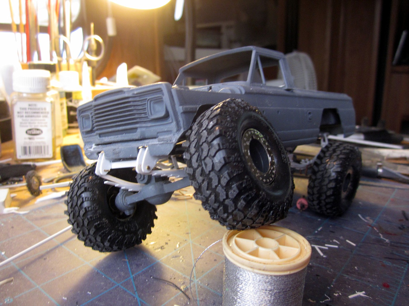

Front springs are built and the shocks made (yes they telescope up and down).
Next is to get the front hanger built and then the front springs mounted.

wow very coool keep it going that suspention looks killer, puts my jeep build to shame lol :mellow:

Wow that is really awesome that it is functional. Both the model and the real truck are really cool!
