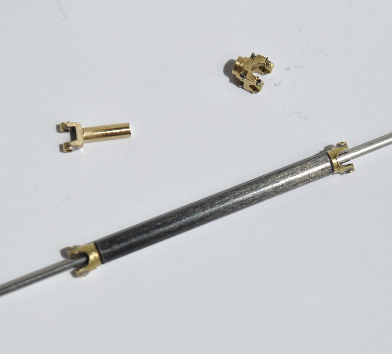

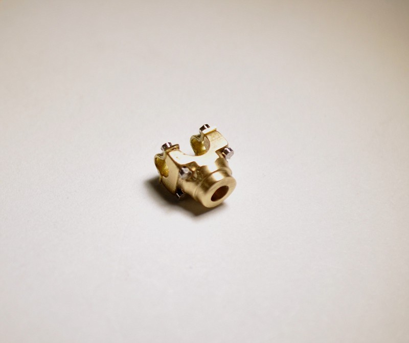

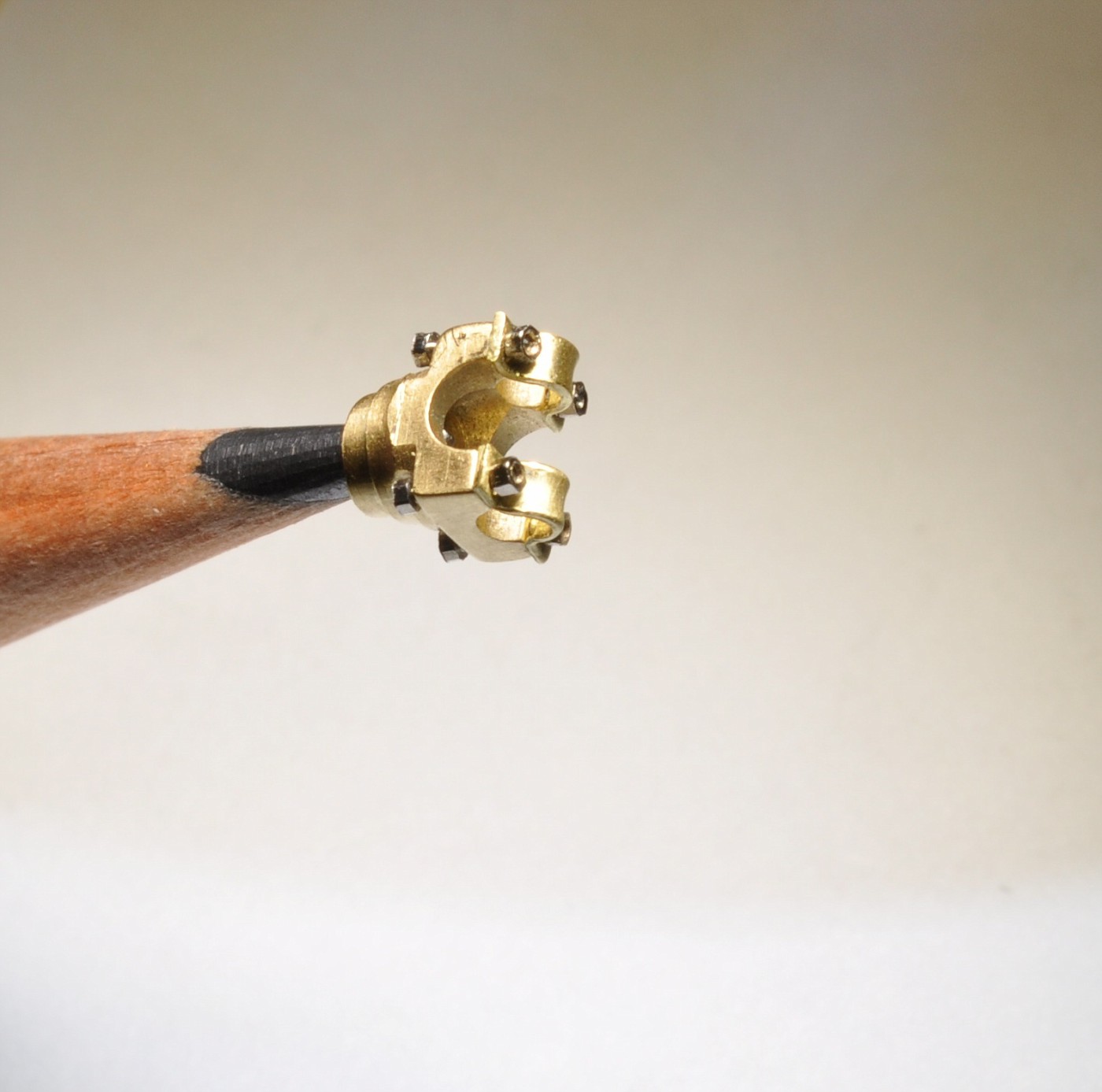

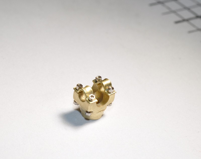

These pics are just of the pinion yoke u-joint "straps" as I call them. These things were SUCH a PAIN to do.....no way to machine them as they were too small and had to do them by hand. Much trial and effort but I got em' on. Had to free hand chamfer the back sides where the bolts feed through to get the bolt heads to fit. I didn't allow enough tolerance (a few thousandth was all I needed) when I machined the yoke. Turned out well but it sure tested my abilities to not mess it up. Feel kinda silly posting them but they DO complete the pinion yoke. I'm convinced that Randy D. completed his entire front brakes and discs on his GT-40 in the time it took me to figure out how to make and fab these buggars. Cheers, Tim

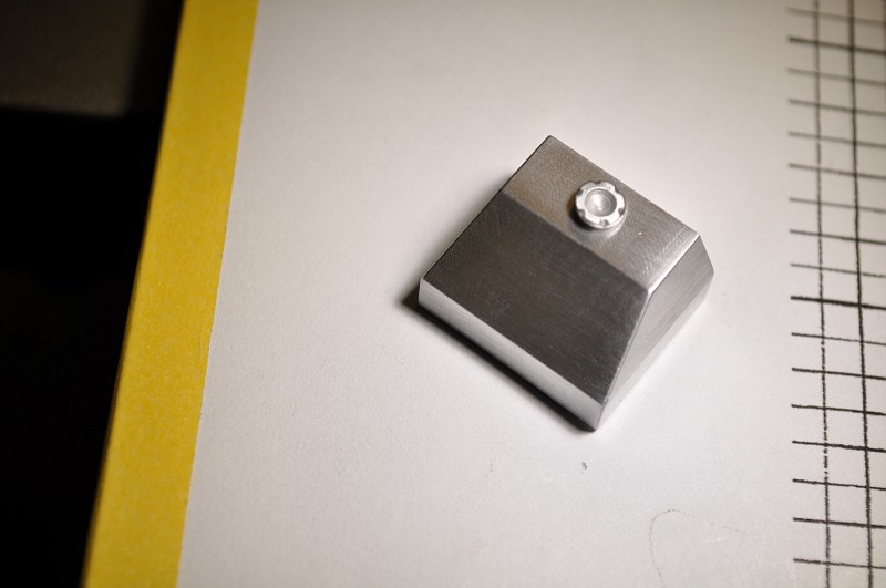

I know I just posted some pics earlier today but I wanted to share with Ray how I did a simple gas cap for the fuel tank. I just didn't like the other one and this piece, once I dychem it red will look much better. I promised some pics while I was machining some parts and this one was simple so I'll share the few steps I took to fab it.
This was the final result:
Here I took alum. rod and thinned the base down to 3mm. The top portion I eventually narrowed it down to a width of 3.8mm and a depth of .75mm
Here I used a round dremel ball type mill and put the indent in the middle.
You'll note I started wtih 2 pieces. Sure enough, I had the wrong angle on the tilting table...even though I've made similar things before like this...can you say "dummy"....sure you can. And that's why I made two. The rotary table with chuck spins the piece 360 degrees and I eventually settled upon a correct 35 degree angle to cut the 6 seperate notches on the edge of the cap. All of this was about 90 minutes. Comp1839 could have made this in 30 minutes I'm sure. Hope this helps Ray and I'll make an honest effort to share more in the future. If this is kind of what you were looking for. Comments always welcome.

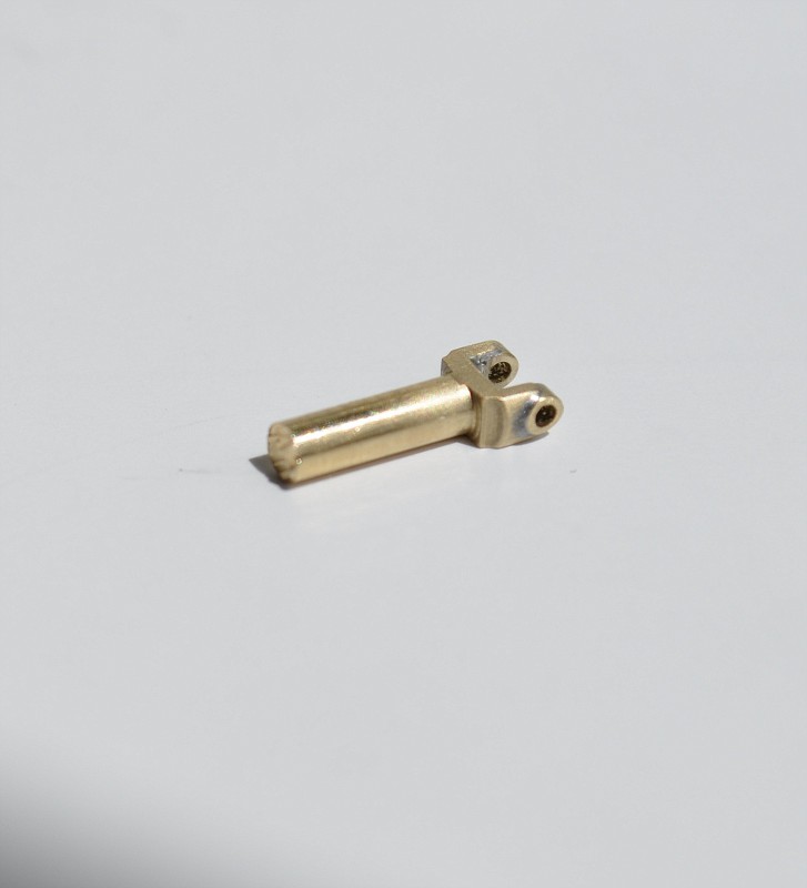

I finished the last yoke (tranny) and heres a pic of the 4 different yokes together. Cheers
