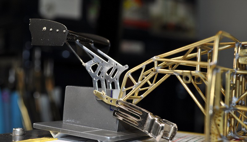

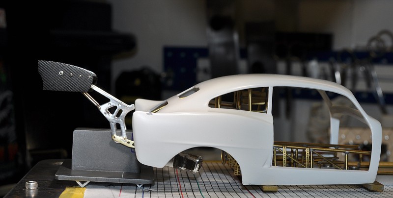

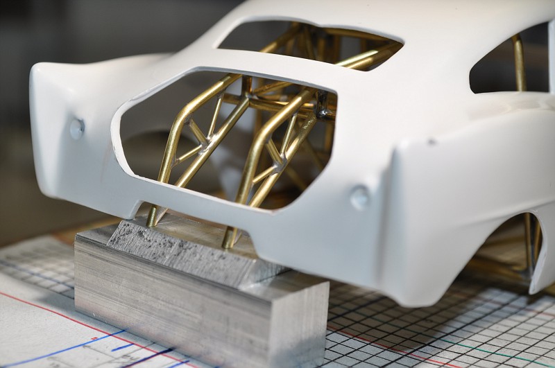

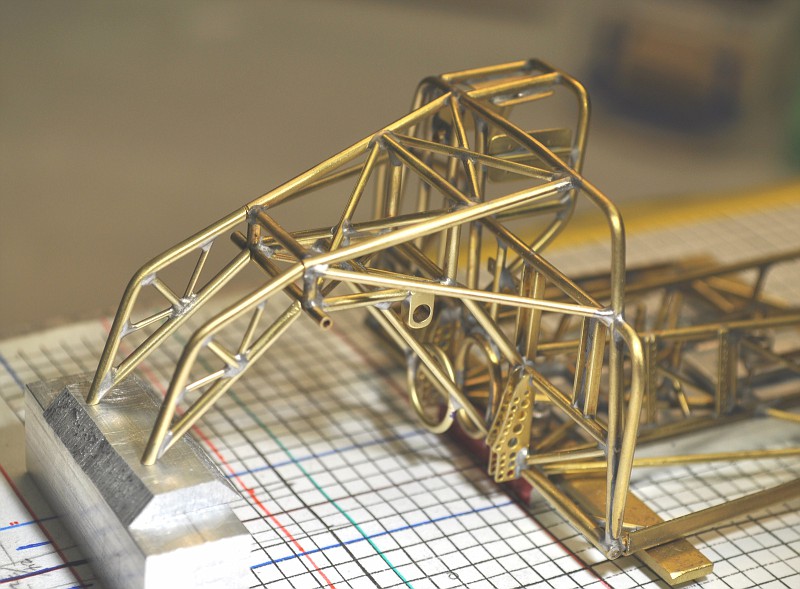

Codi Posted June 13, 2015 Author Share Posted June 13, 2015 (edited) Started the rear "tree" of the chassis. I have to thread the chute / wheelie bars and wing struts through the whole thing and make sure the trunk lid clears of course. Cheers, Tim Edited June 13, 2015 by Codi Quote Link to comment Share on other sites More sharing options...

Petetrucker07 Posted June 14, 2015 Share Posted June 14, 2015 Man that looks great. I really need to try out this soldering thing. What kinda of soldering iron are using? I have a serious fabrication build planned and soldering may make it easier. Quote Link to comment Share on other sites More sharing options...

Codi Posted June 14, 2015 Author Share Posted June 14, 2015 Thanks so much fellas. Hope to get some work done on it today and have it attached to the frame by tomorrow along with some additional bracing. Then I'll make the brackets for the wing and chutes. I'm anxious to mock it up with the body in place and the wing & wheelie bars attached to the chassis. Clayton - I use a 250 watt, American Beauty resistance soldering setup. Somewhere on this thread, I think I shared the model number. There are pros and cons of doing brass v. plastic, it's just what suits you and what you want to achieve. I say jump into the pool, the waters fine! Quote Link to comment Share on other sites More sharing options...

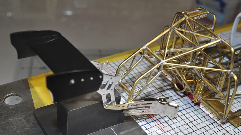

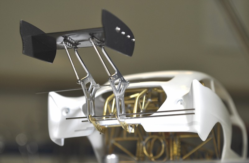

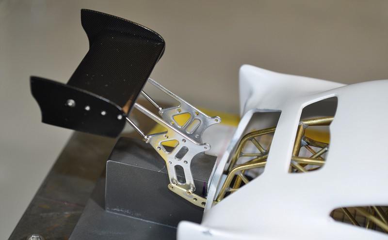

Codi Posted June 22, 2015 Author Share Posted June 22, 2015 (edited) 1/2 a day to make the twin brackets to affix the wing to the chassis. I had to remake the twin trees as one fell apart (careless on my part) while soldering it on. UGH! Anyways, the small brass brackets will be on the inside of the chassis, not the outside as you see them. The wing strut will then be secured on the outside of the little bracket. The little bracket was a challenge as it had to clear the body, mate to the chassis and have the proper angle for the wing. Comments welcome. Cheers, Tim Edited June 22, 2015 by Codi Quote Link to comment Share on other sites More sharing options...

Codi Posted June 24, 2015 Author Share Posted June 24, 2015 Thats sound kinda cool John. I'm sure you'll have quite a bit of interest once you start buiding and posting. Today was 6 (yes Joe, start the jokes now...I said SIX) hours of figuring out HOW to attach the brackets onto the chassis so that they were spot on in place (up/down/sideways/that way/this way.....you get the idea) and not ruin any of my other work. That's the engineering side of this process. After a bunch of thought and a trip down the wrong path, I got it right. It's not much of an update it might seem, but this was a very important point of progress for me. I have only a couple 32nds of an inch to get the wheelie bars to fit INSIDE the wing and the parachute bracket has to be perfectly down the middle of the wheelie bars. so far its where it needs to be. All I can say is "whew". Enjoy. Quote Link to comment Share on other sites More sharing options...
