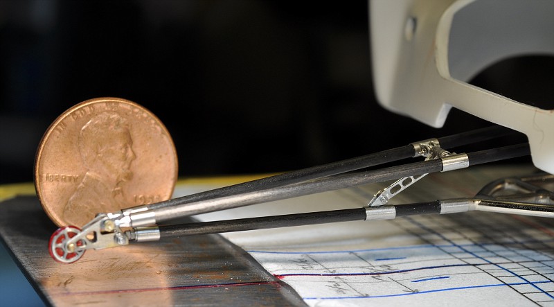

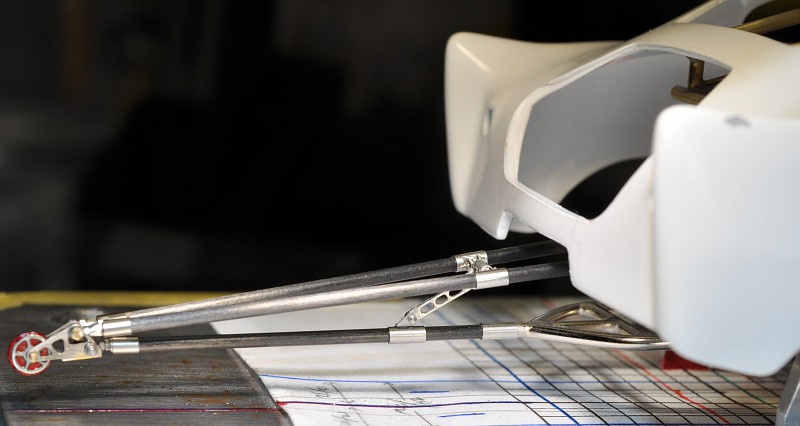

Codi Posted June 4, 2015 Author Share Posted June 4, 2015 (edited) John, thank you for the compliment and taking the time to check out my other builds....as few as they may be. Chris, best thing is to do a "bing" search for "caswell $49.99 nickel plate / copper kit......you should get the link to their site you need. I must admit, of all the vendor websites I go to, theirs is one of the worst to navigate. Great product, 1999 era website (search wise). As mentioned, did the bars over today. Here they are in their proper scale. The real 1:1 bars, for those interested are 1.6" in diameter. They are not glued together as you see them and the couple of support brackets have yet to be affixed....but here they are. Cheers, Tim Edited June 4, 2015 by Codi Quote Link to comment Share on other sites More sharing options...

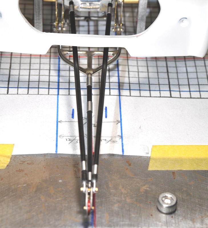

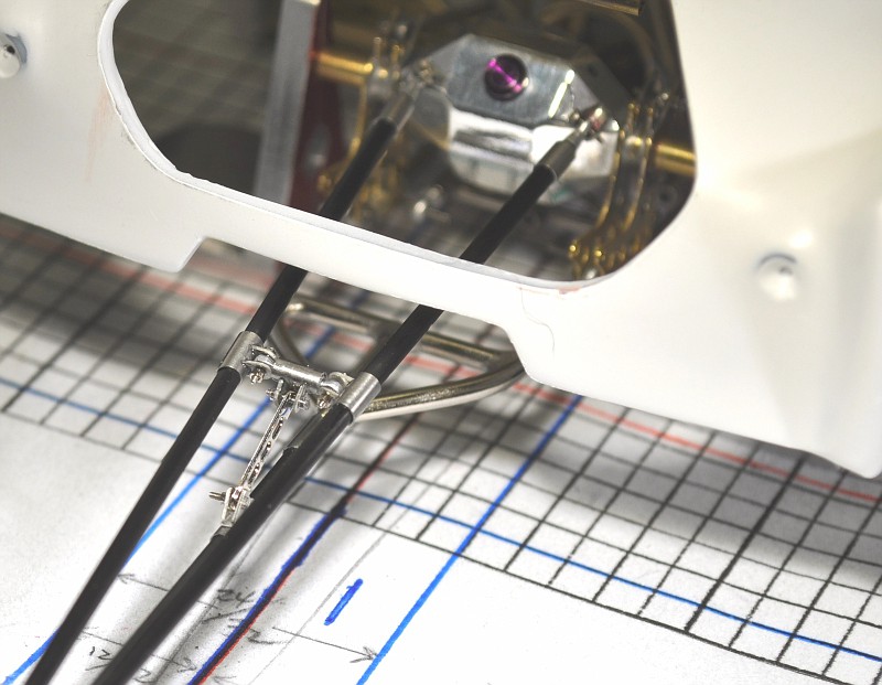

Codi Posted June 9, 2015 Author Share Posted June 9, 2015 (edited) Hi, I finally got the dirtmodeler chrome bracket on that I received recently and think it thoroughly completes the wheelie bar. Comments welcome. Cheers Now it's time to move on to complete the back end of the frame. Edited June 9, 2015 by Codi Quote Link to comment Share on other sites More sharing options...
Petetrucker07 Posted June 9, 2015 Share Posted June 9, 2015 That looks killer. I think it's perfect. The brackets and everything really make it look great. Quote Link to comment Share on other sites More sharing options...

Codi Posted June 9, 2015 Author Share Posted June 9, 2015 Appreciated fellas, they were frustrating to make. The hands good now Joe, a little sore and swollen at times, but a couple more weeks and I'm expecting no problems at all. Thanks for asking. Scott (futurattraction) no meaning on the penny date. I was born in 56' though. I would like to thank and acknowledge Scott for his products as well. I used 5 of his PE nickel brackets on the wheelie bar assembly in addition to the 2 brackets I used from dirtmodeler (they were brass btw). We're fortunate as builders to have suppliers such as these guys to provide these types of products. It would make scratch building far more time consuming if we had to make such mundane items too. NOT meant to demean what they they offer of course as they provide a VALUABLE service/product. It's just that I'd rather spend MY efforts and creative juices making different parts for the build. So I'll take one last moment to thank in no particular order, RB Motion - Scale Hardware - DirtModeler - Futurattraction - BNA Models (of Australia) and M.A.S. (machined aluminum specialties) ....if I've not mentioned someone that I've used on this build, my sincerest apologies in advance. Cheers to all of you guys! Tim Quote Link to comment Share on other sites More sharing options...

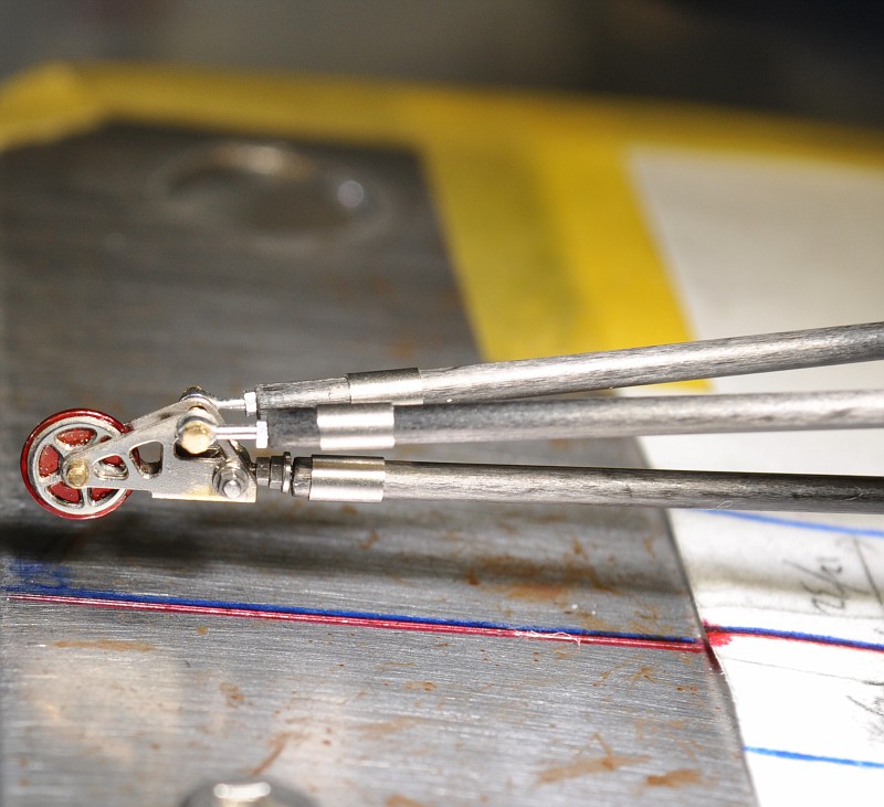

Codi Posted June 10, 2015 Author Share Posted June 10, 2015 (edited) Paul, i bought mine from RCFOAM.COM - They have an excellent assortment. The problem you'll run into is I build for accuracy as much as is feasible and the smallest tube they offer is 1.8mm which scales to 1.8". Real 1:1 wheelie bars are 1.6" in diameter. The difference doesn't sound like much but on the car you'll see it. Just compare the pic of the 2 sizes I made as the 1st was only .3mm smaller than the second but it looks downright skinny next to the proper size. They offer 1.5 and 1.6mm ROD which I used but had to drill out, but it is a real PITA to do so as it easily splinters. That's what took me so long to make these and made it a bit frustrating. IF and when they ever offer 1/16" CF tube, they'll sell a bunch of it just for wheelie bars alone. That or you're going to see at the shows a bunch of cars with oversized wheelie bars. Hope this helps. I might not have enjoyed making them but I DO like the result. The look of the real CF bars on the car just can't be beat IMO. Cheers Edited June 11, 2015 by Codi Quote Link to comment Share on other sites More sharing options...
