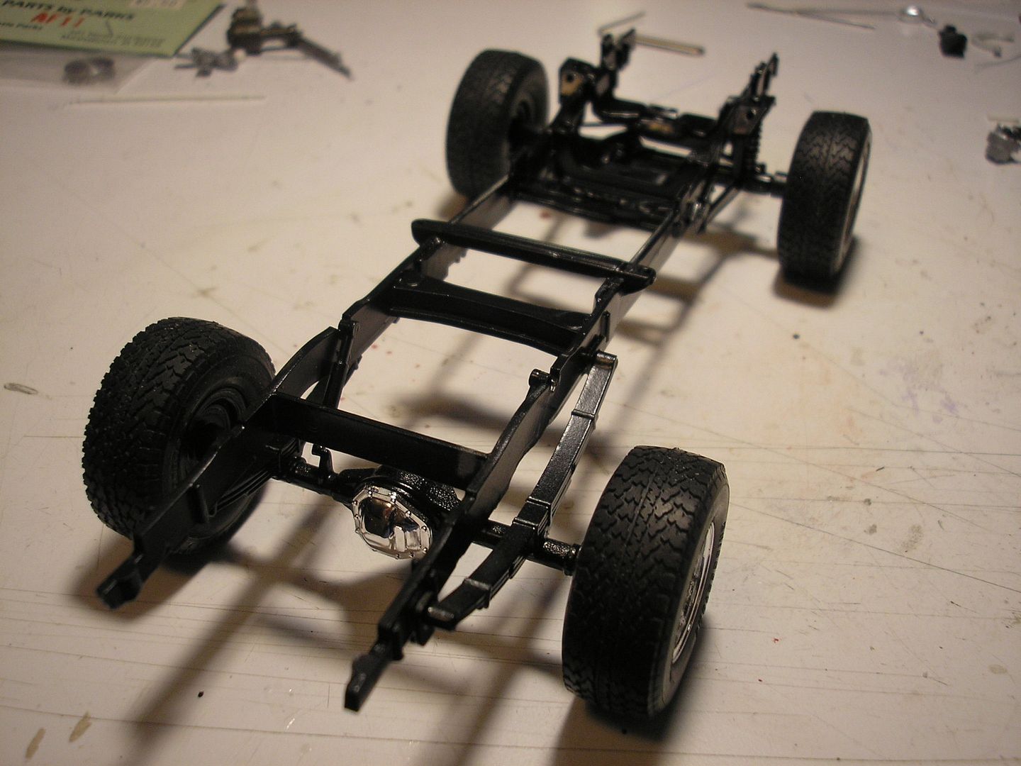

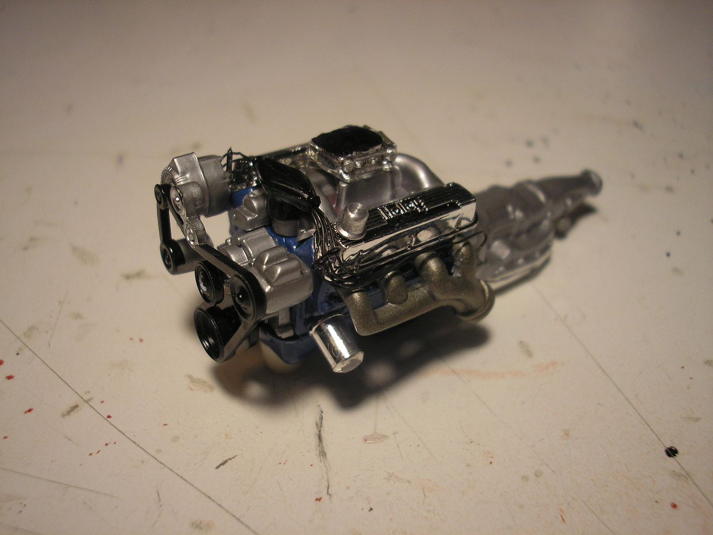

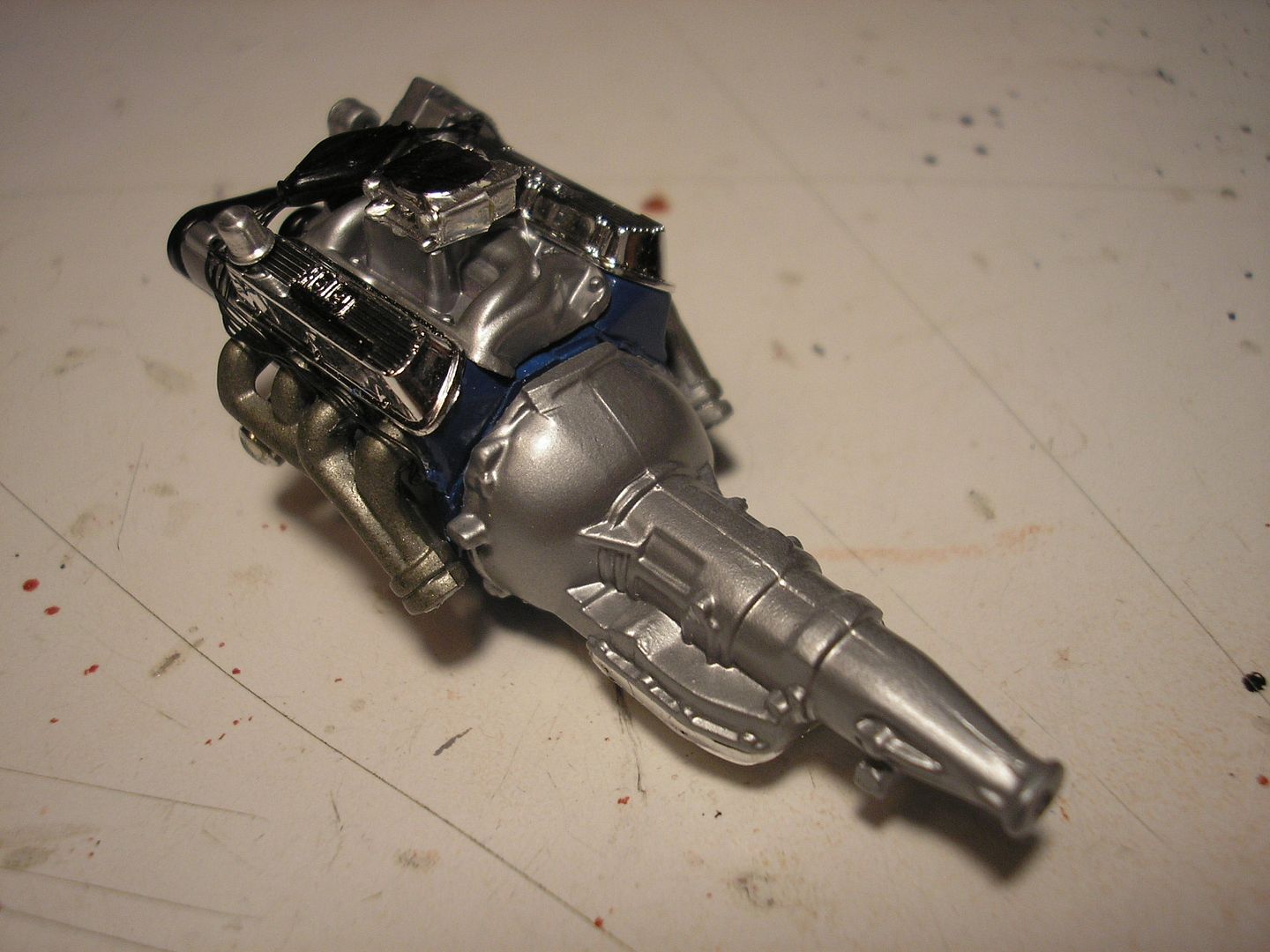

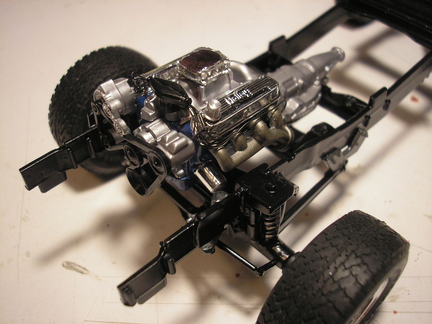

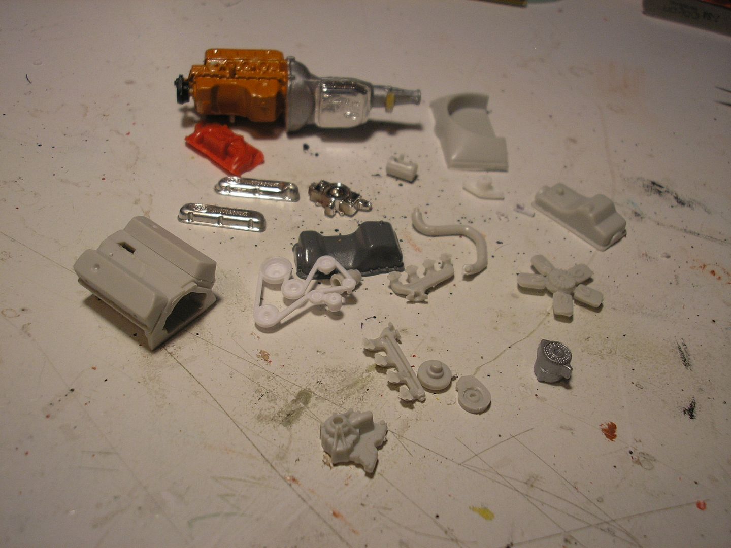

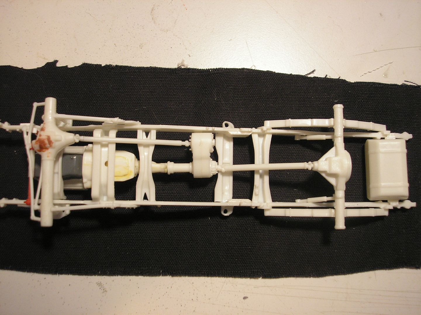

Maindrian Pace Posted October 25, 2014 Author Share Posted October 25, 2014 The junk model gets an appropriate junk model drive train. This is a few of the parts that will make up the engine/trans, an AMT '90s F-150 351W block, an AOD from a Revellogram '32 Ford, and other stuff from the parts box. Valve covers undecided, I'll surprise myself there. 4x4s do better with less weight over the front axle, hence the small block. Getting everything finalized on the chassis, added two more front shocks, made a steering damper with brackets, and built a simple steering box with pitman arm so the tie rod wouldn't hang out in space. The divorced transfer case makes it easy to add about any engine/trans you want. A Fox double sump oil pan was the right shape for the cross member. The short wheelbase makes the two piece drive shaft with pillow block/center bearing unneeded. Time to blow it apart for paint. -MJS Quote Link to comment Share on other sites More sharing options...

Maindrian Pace Posted November 6, 2014 Author Share Posted November 6, 2014 Thanks Gentlemen. I've been plugging away when time allows, and have most of the chassis and engine finished. One thing that the parts box never seems to offer up is an A/C compressor. So Plastruct and Evergreen to the rescue. I can tell that the exhaust system on this will be tricky. -MJS Quote Link to comment Share on other sites More sharing options...

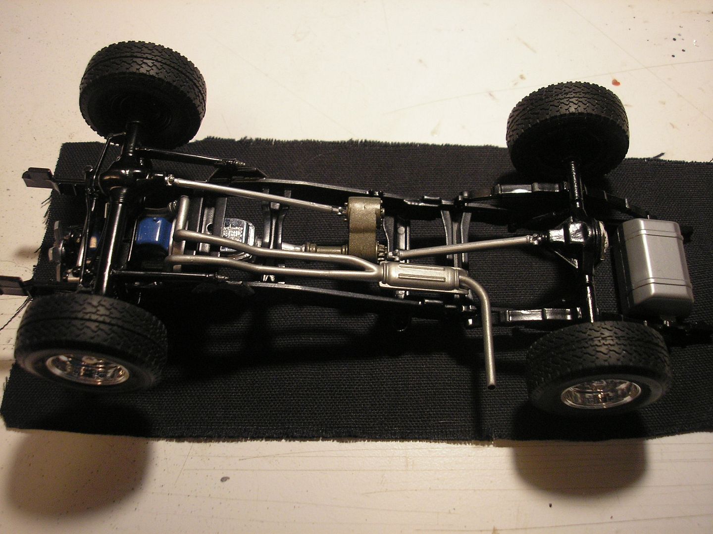

Maindrian Pace Posted November 15, 2014 Author Share Posted November 15, 2014 (edited) Exhaust: The transfer case and front drive shaft made it near-impossible to route a clean dual system and not have it hang too low on the left, so I made a 2 to 1 single system with parts box exhaust parts and a 3" sprue tailpipe. The exit ahead of the rear wheel is standard off-road configuration. -MJS Edited November 16, 2014 by Maindrian Pace Quote Link to comment Share on other sites More sharing options...
