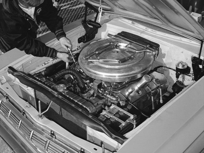

Not to stir things up but, it can't be a clone of the Daytona 500 Winner because the Belvedere trim is not down the side which is clearly visible in photographs of the day. I'm not saying it's not accurate clone, its just not a clone of the 500 Winner. From everything I have read and information gathered, the car started life as a Light Blue 64 Belvedere off the a new car lot and was transformed into a racecar. The chassis, underhood paint was still the factory light blue and the factory met. blue interior was intact to make it look more stock to try and overshadow the non-factory stock engine since, the Hemi were not sold new in the showroom to the public. Then as the year progressed, the factory interior came out and flat panel installed. Look at the photo attached, you can see that the interior is a different color than Petty Blue.
Look at the next picture and you can see the inner fenders under the hood where lighter in color than the exterior.

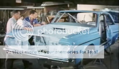

Yea you're right, I just quoted the texts on the websites at the links, I haven't had time to research the subject much more than that except for collecting pictures for future use,
So i'm open to all info as one of Petty's 64 Plymouth's are on my build list.
Here you see the lighter blue color under the hood in a color photo I found on the web a while ago.

If you look at the last picture, which is really a good one for info, you can just see the top of the bucket seat poking it's top out over the dash. I noticed in the clone it has a bench seat. I remember a few year back seeing an interview with RP. He stated in the interview that the Daytona car had a bench seat with the back removed. This picture proves that's not so. I think sometimes we've got to remember these guys, remembering things, are gettin old. I'm 66 and can't remember nothing. The one thing that bugs me about clones is someday some guy will come up with the cash to purchase the 64 Clone and sware up and down that the Petty's told him the car was the Daytona 500 winner and he'll have something signed by them stating it is. Don't get me wrong it's a beautiful car and the workmanship is top notch but I doubt Richard ever drove that car in a race. I wish, when clones are built, the guys building them would pay a little more attention to what they really were and had. I guess if they did it would be harder to tell a fake. LOL If you're building a Petty race car specially the 64 there is tons of info on the net and you can't go wrong with the info you find on Randy Ayers board. When it come to the older cars these guys know just about everything and are not afraid to let anyone in on the info. And they build some pretty nice models too.
