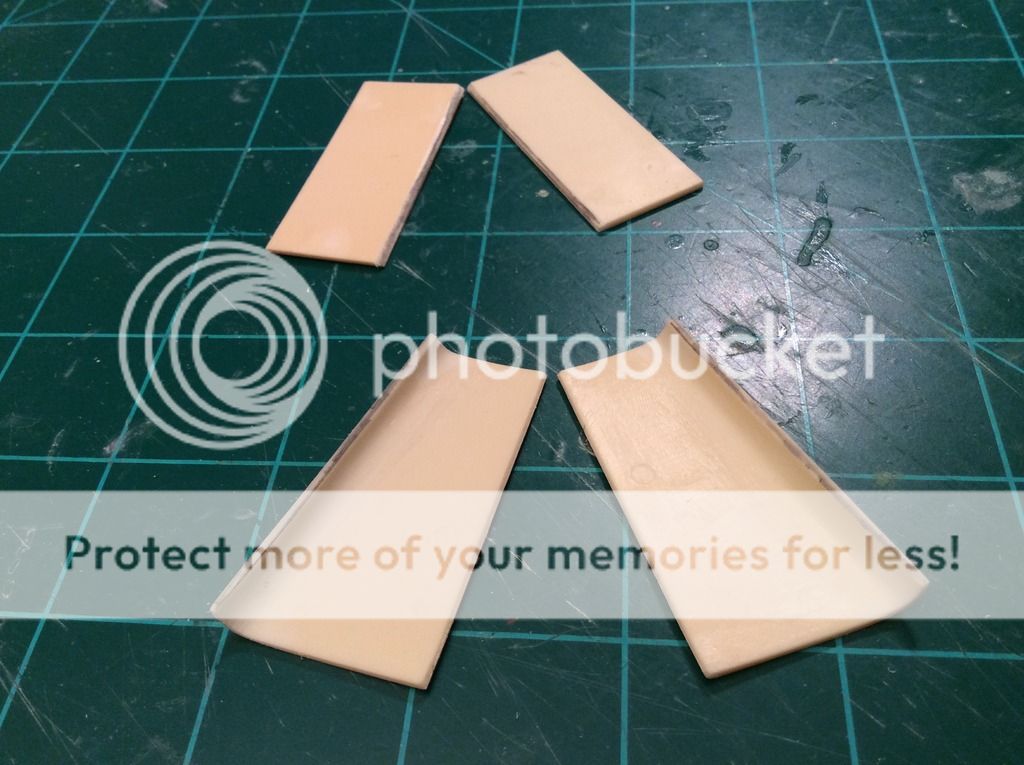

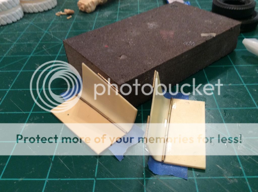

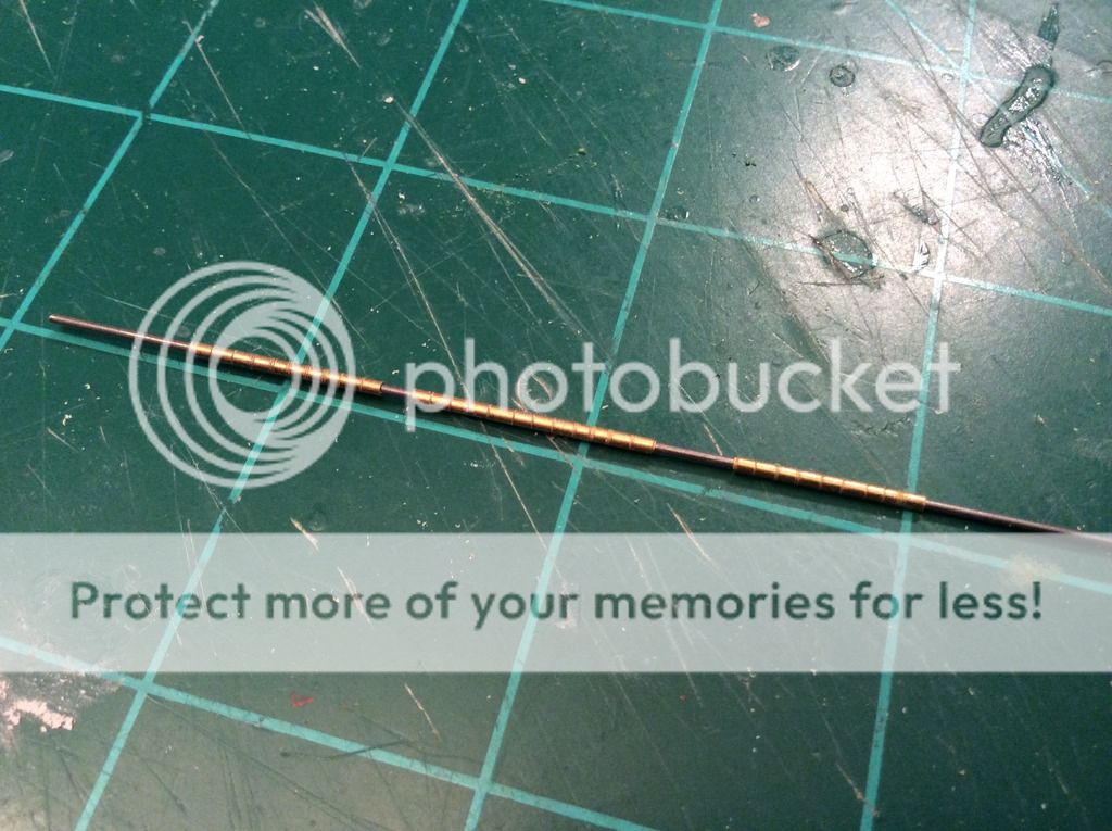

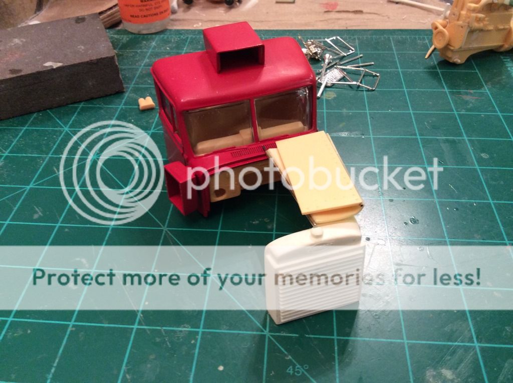

Superpeterbilt Posted August 23, 2015 Author Posted August 23, 2015 Thanks fellas. I was able to get some time in on the truck today. I hinged the hood using some brass tubing and small steel rod. I had a theory about doing this years ago but never tried it. Then I saw Sam use this technique on the doors of his Paystar. It was much easier than anticipated. First I put a slight bevel on all of the sections of the hood that the hinge would attach to. I shaded them here with a pencil so it can be seen. Here are the materials I used Using my calipers, I made marks every .060 on the brass tube, then scored it by rolling an exacto knife across it. Then it was cut in three sections. Then, holding the sections together with tape I did the same on the side panels. These hinges are inside the hood so I didn't score it as a piano hinge. It will just stay in three long sections.
guitarsam326 Posted August 23, 2015 Posted August 23, 2015 Lookin good Terry, your hinges came out better than mine, i didnt think of beveling the edges, but theres always a next time. I also had a hard time scoring the brass, my knife kept wanting to wander. Also be carefull when you paint, i laid down several thin coats and still filled the grooves, keep up the good work

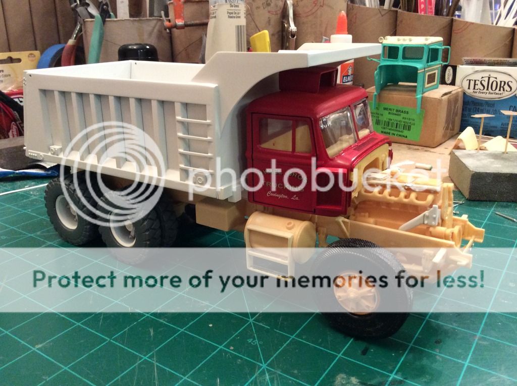

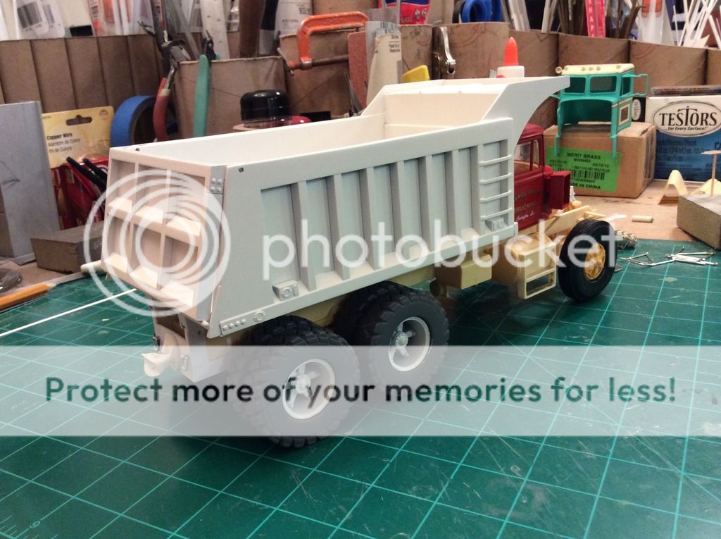

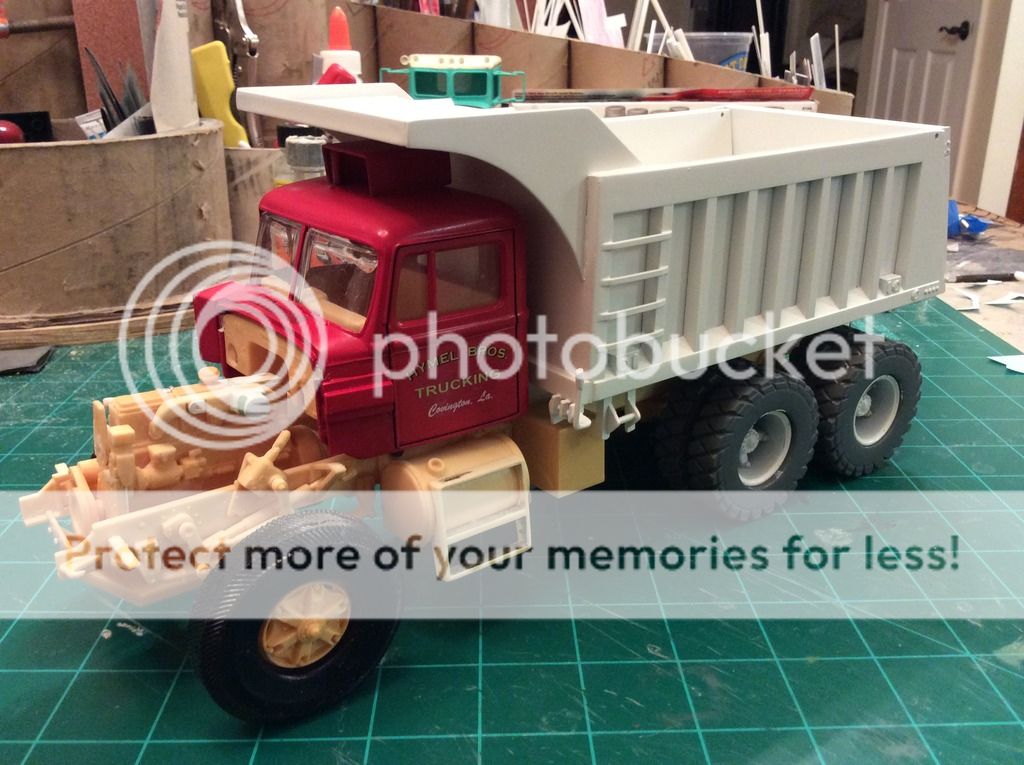

Superpeterbilt Posted August 23, 2015 Author Posted August 23, 2015 Last update for today. I darkened in the door jambs and put the door decals on. The dump box is in paint, and the rear wheels have been primed. I had to use some filler on the side walls of the tires because they all had blemishes. It's starting to look like something.

landman Posted October 9, 2015 Posted October 9, 2015 Thanks fellas. I was able to get some time in on the truck today. I hinged the hood using some brass tubing and small steel rod. I had a theory about doing this years ago but never tried it. Then I saw Sam use this technique on the doors of his Paystar. It was much easier than anticipated. First I put a slight bevel on all of the sections of the hood that the hinge would attach to. I shaded them here with a pencil so it can be seen. Terry, are those bevels flat or coved? And what did you use to "glue" the hinges,CA?
Superpeterbilt Posted October 9, 2015 Author Posted October 9, 2015 Terry, are those bevels flat or coved? And what did you use to "glue" the hinges,CA?The bevels are flat yes, and I used CA glue. Be very careful to only use the smallest drop of the glue in just a few spots until it sets, then take the hinge apart, then you can add a little more glue. I laid the three sections of the hinge in the beveled cradle, put a tiny drop on each section(three drops, three sections), then let it set, then slid out the center rod and had two parts of the hinge on one side, and the middle part of the hinge on the other side. Then I ran some heavier beads of glue. I hope this helps.

Chariots of Fire Posted October 17, 2015 Posted October 17, 2015 For anyone wanting to try hinges like Terry made I have a suggestion. Not far from here there is a supplier of all kinds of scratch building materials including very small brass tubing and stainless steel wire that make great hinges. The Tubing is 0.018" diameter and the stainless fits very nicely inside. If you clean up the brass with some steel wool and lay it on a flat surface just run some CA on the edge of the hood piece and move it against the tubing. When the CA sets fill in around it with more CA and sand the joint smooth. I used it on the 1929 Coleman.The supplier of the tubing and stainless is Precision Scale Model Engineering. psme@psmescale.com is Larry Milo's e-mail address. He also has a web site www.psmescale.com
