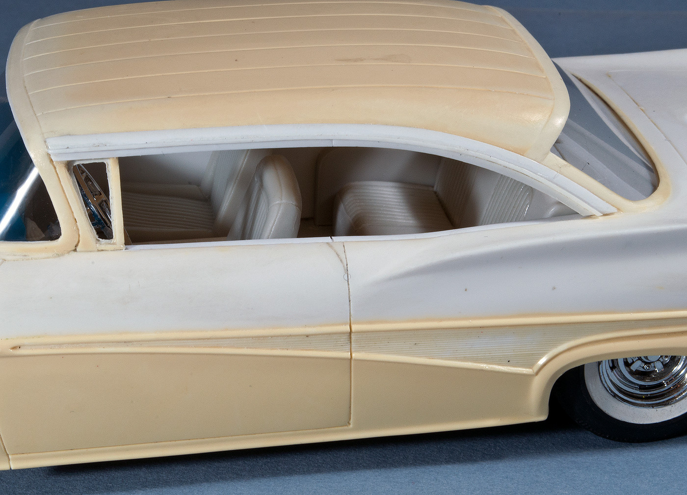

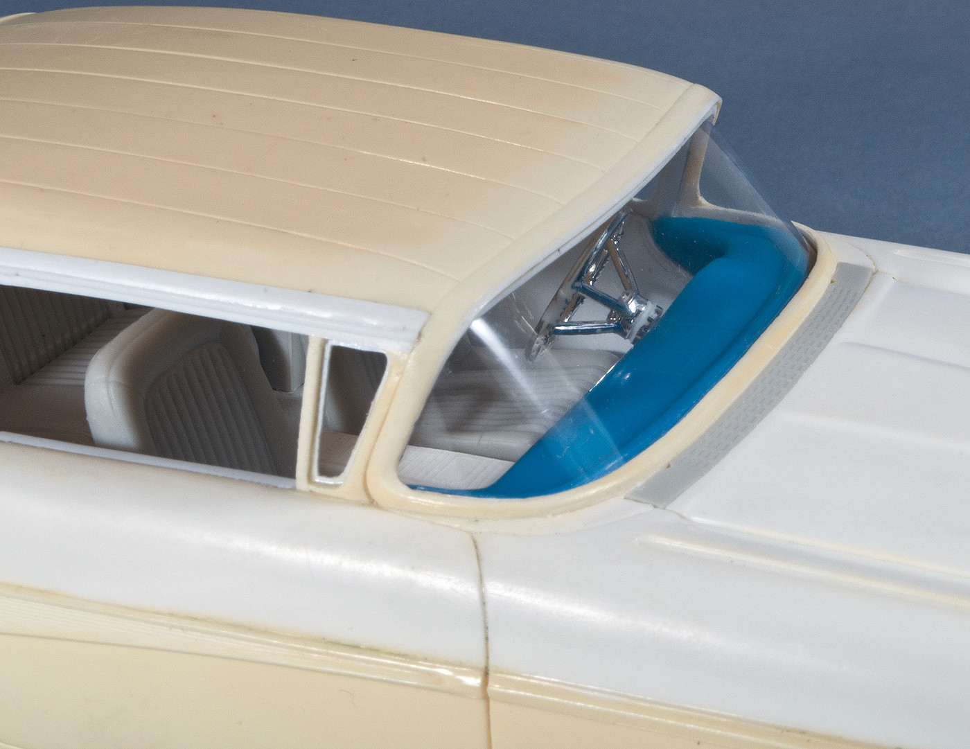

Wow! Great build! Super job on the glass. Gonna save that one!
Thanks, Terry!  Of course now I've gotta clock in an extra three to four hours on almost every build from here on!  :blink:
Share this post
Link to post
Nice, it's great to find a clear material that won't fog when it's being bent.
Thanks, Rob.  Yep, this stuff is great. However if you are too aggressive when bending or the curve is too sharp it show fine internal stress cracks that look like fogging.

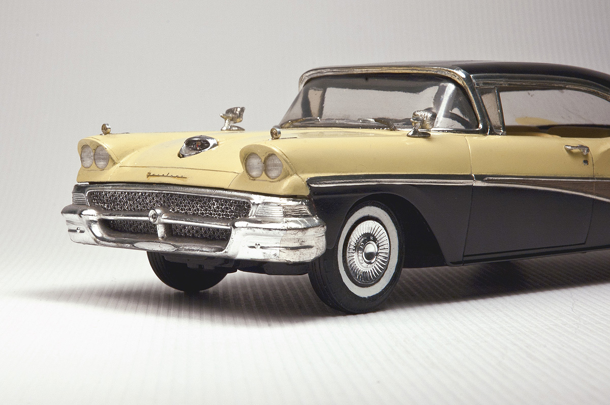

The fender ornaments were scratch-made and consist of a carved plastic base, a thin aluminum strip ring filled Micro Kristal-Kleer, with two little dabs of Kristal-Kleer on either that are painted gold. You can see them better in these two shots (The foils needs to be redone on the bases!)

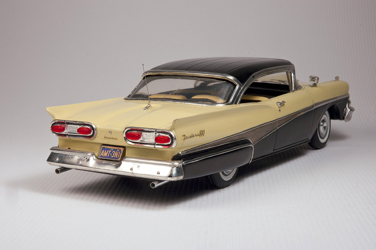

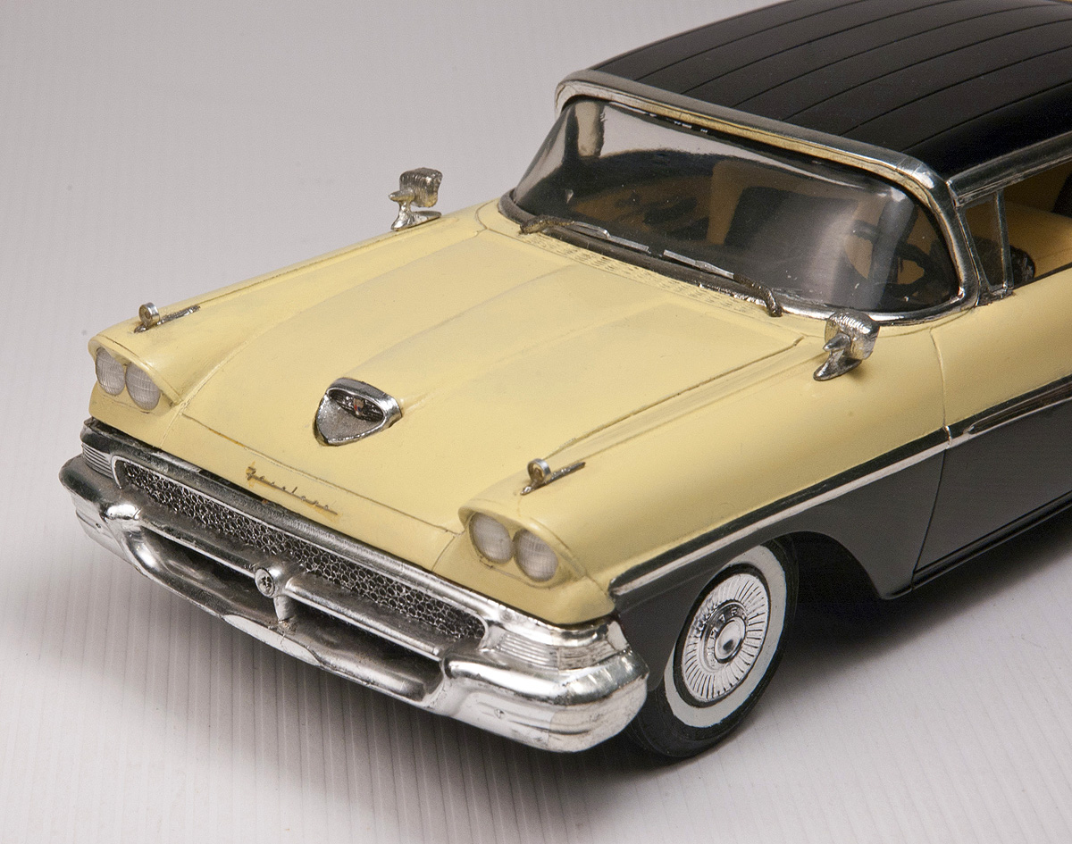

"... I wish I could remember where I got the clear red lights on yellow and black car - they were a custom option in an early '60s AMT kit."
Might we see a pic?
Share this post
Link to post
Might we see a pic?
Of course, Rusty! These lenses, wherever they're from are perfect replicas, including the little channels for the attachment screws.
(Wow!  Several object lessons in this shot, including; "Epoxy is not an archival method for attaching photo-etched emblems!," and "Here's why kit glass is junk!")

Well, those lights didn't cure and were pretty much stuck to the mold so I'm redoing it. I'll do better next time. Redid the grille with the Eduard photoetch mesh and removed the center bar - looks way better.
Thanks for the rear shot! I'm stumped on the source of those lenses too. Time to check Drastic Plastics' old instruction sheets on Fotki! Modelhaus did make separate lenses and bezels for the car, per Carol, but they weren't in the official catalog.
