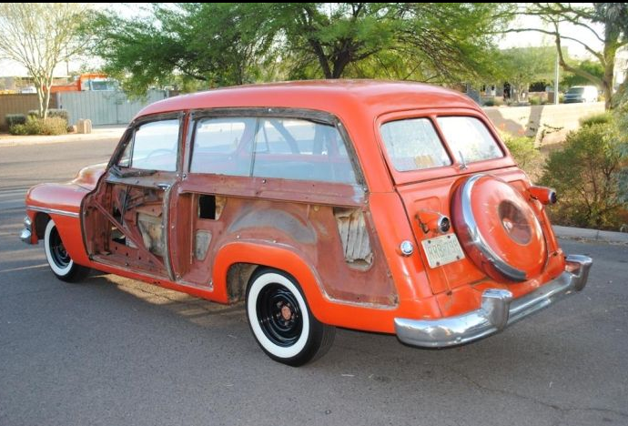

Things have been progressing slowly and have no photos but I have been looking into how I'll distress the wood. I want to have some missing pieces so went looking for woodies undergoing a restoration. I came on this pic that is just what I need and thought someone else looking here might appreciate what's under all that beautiful wood.
