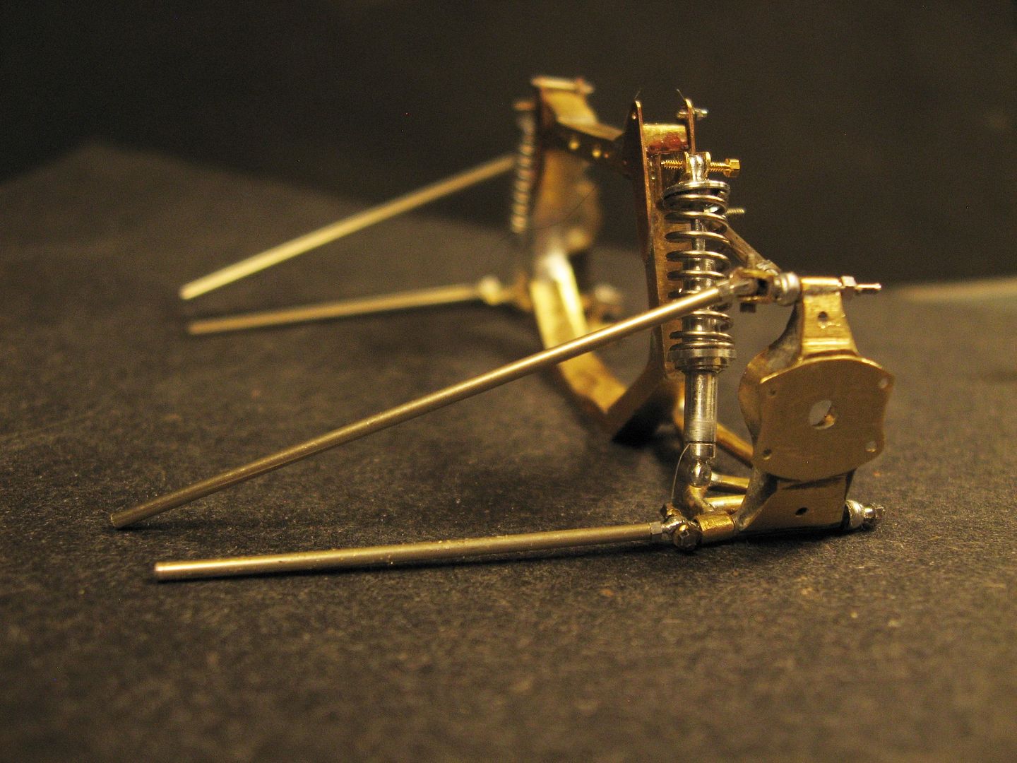

Randy D Posted March 27, 2016 Author Share Posted March 27, 2016 Hi Folks, Goat Guy, Glad you like it Thanks Scott !!! Ed, What do you mean OIL LEAKS???? I tightened every single bolt!!!!!! Hi Bruce, Thank you and I love the pickups Tim, Thank you my friend and thanks for the 'plug' on your henry build in the drag section You are one of the builders on this site that inspires me to do that extra bit to try to make each piece the best I can. Thanks for the push! Hi Dave, Thank you for commenting! Hi John, Thanks buddy! Chris, Appreciate the support as always, see you soon! Bill, Sorry to disappoint my friend, got to work on that Richard, thank you brother! Update for tonite.... Starting on building the 'trans axle hoop' . This is the key element to the back end of the chassis as everything hangs off of it. The bell housing and trans axle bolt to it and all the suspension is attached to it along with the frame work for the rear clip. The 1:1 hoop is made up of steel stampings then welded into the sheet metal making up the rear of the 'tub'. Some ref. pics.... This is a great shot of all the suspension components hanging off the hoop. The plan is to build the hoop as a stand alone piece then solder it to the flat chassis pan. Then bolt in the drivetrain and suspension. I can then double check wheelbase, track, engine clearance and rear clip fit. Then un bolt everything and finish with soldering up all the sheet metal to it. using 1/8th solid stock ... That is all for now, Thanks for looking in! Randy Quote Link to comment Share on other sites More sharing options...

Randy D Posted April 3, 2016 Author Share Posted April 3, 2016 Hi Folks, Hey Chris, Darn time is just flying by! Can't believe DSC is here. Bill, As always, thank you for commenting Hi John, Thanks buddy, see you soon Hi Pete, You are too kind my friend Hi Tony, Good to have you on board! Richard, I am trying to put as much detail into this as I can. The Gulf GT40 is my all time favorite GT sports car. I was a very impressionable 10 year old when Ford scored the first of their 4 straight wins at Le Mans and I tried to follow the story as close as I could thru '69. These cars were not overly complex so hopefully I can render a suitable facsimile Hi Tim, Thank you checking in and glad you are liking this! Bruce, Appreciate the support! Tom, Welcome and this one gets paint! I have another project that I'm building that will stay in natural metal. Joe, You be careful there Thanks Art!!! Thanks Brandon, I will leave the F40 to you! Your build in the Big Boy section is going to be amazing. Working on the various components of the rear suspension. Ref. pics... Rear upright.... Lower wishbone..... trailing arm clevis.... As posted before, this is what I'm aiming for... Building up the wishbones... More following this.... Quote Link to comment Share on other sites More sharing options...

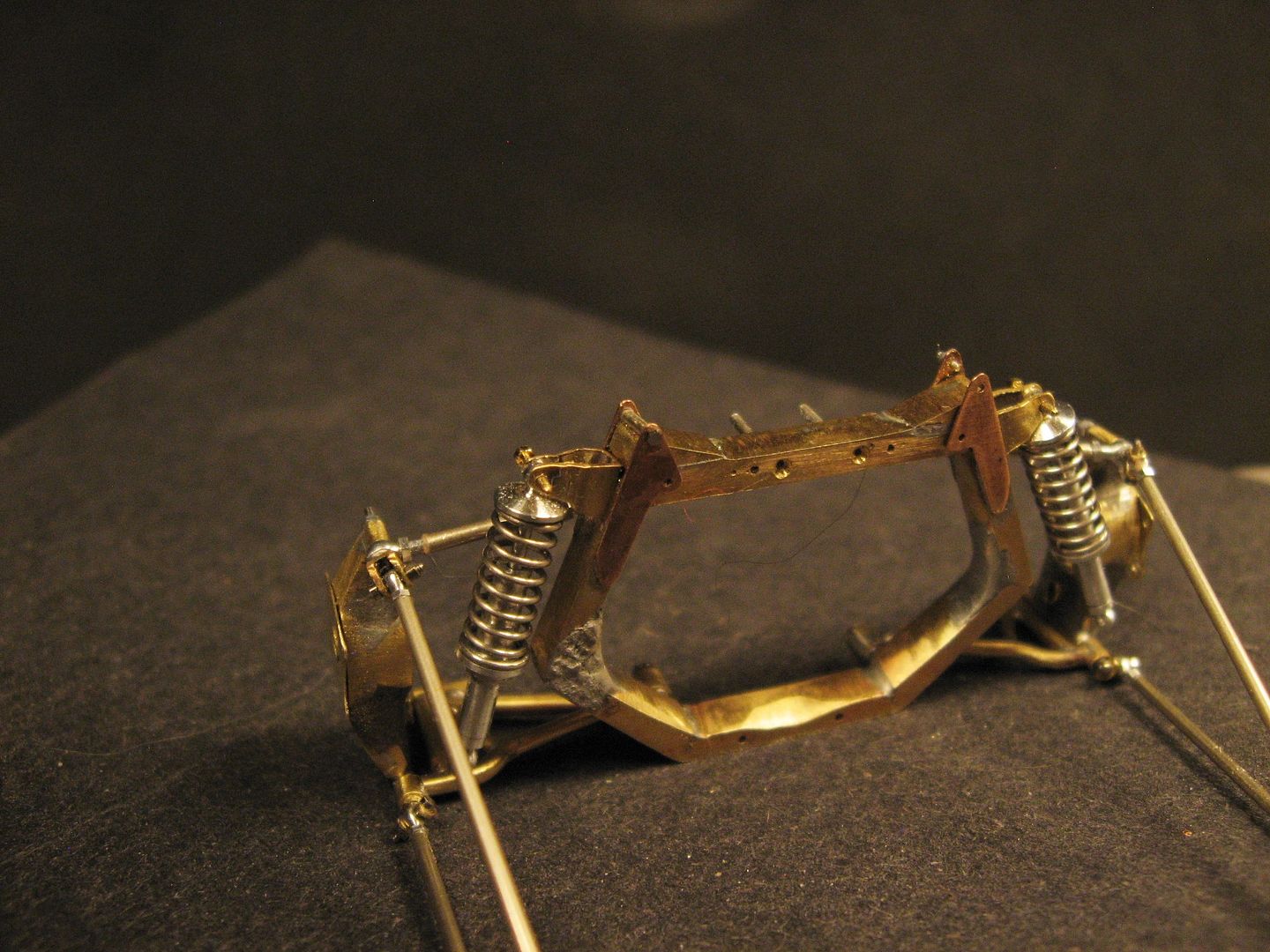

Randy D Posted April 3, 2016 Author Share Posted April 3, 2016 (edited) Next are the uprights.... The clevis for the trailing arms... A pic of the parts for one side..... Some pics of progress to date..... That is all for now, still need to make the anti-sway bar and linkage. Need to do the lower shock brackets. Then it will be time for the brakes. Thanks for looking ! Randy Edited April 3, 2016 by Randy D Quote Link to comment Share on other sites More sharing options...
