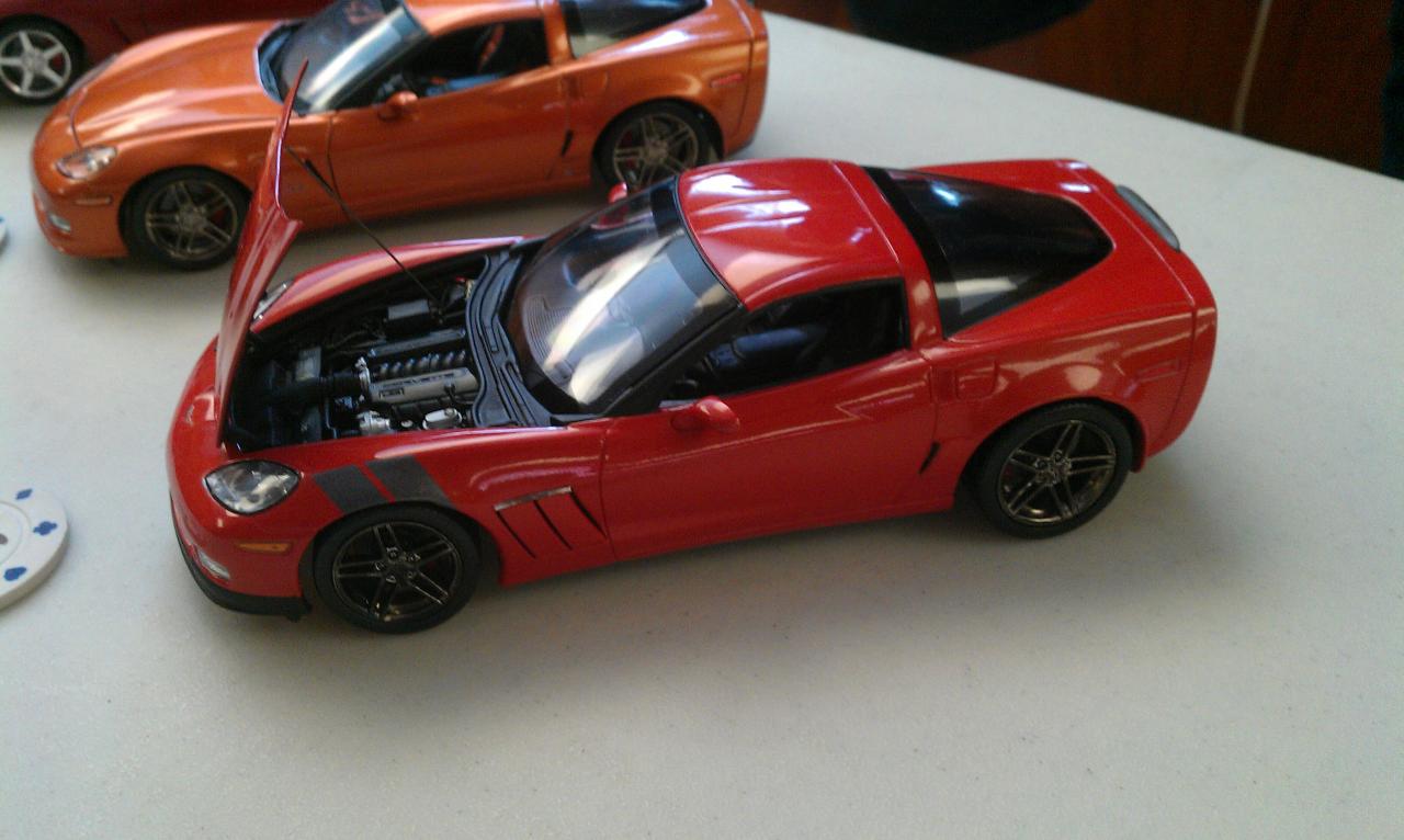

Looking good so far. If you need more views, I have a few shots in this album, start around page 8:
http://s150.photobucket.com/user/exotics_builder/library/2013-08-10%20Weekend%20Car%20Show%20Pix
High-res on my hard drive if needed.

Thanks Gerry!
Nice album. Thanks for sharing. That's Carlisle blue, a 2012 only color. That is one of the colors I'm considering for this build......

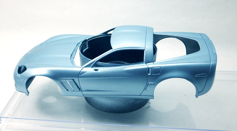

Finally got to sand the primer smooth and shot the first 2 coats of Scalefinishes Carlisle blue: a 2012 only color.  Very strong metallic content. It looks more silver in the picture but it is really a bit "bluer".  After it dries I'll lightly color sand it before a final wet coat.  The primer had 3 years to dry.  I hope the paint dries quicker than that :D

  Color sanded the body and applied a final wet coat, diluted 3:1.  The picture looks very similar to the previous one, but it is much smoother and "bluer".  The color is really hard to photograph. Once completed I'll take the official pictures with proper equipment and light.
Next step: Clear.
