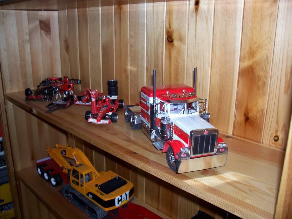

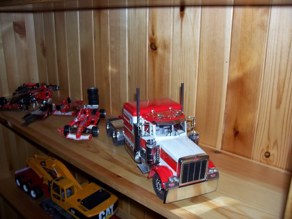

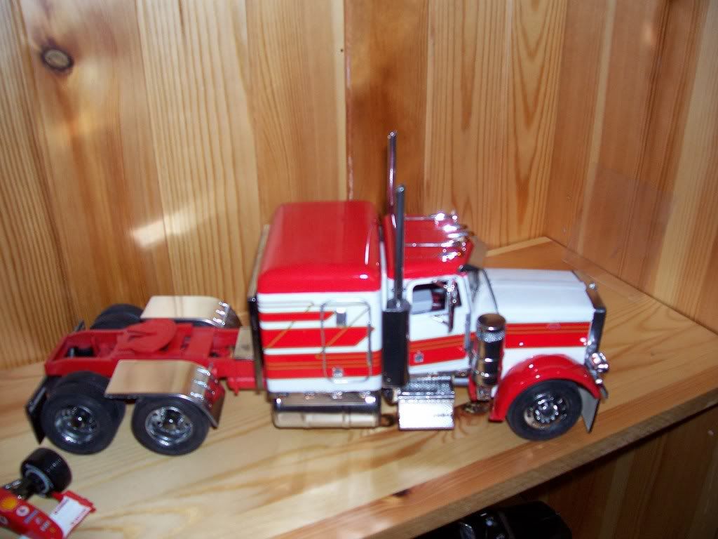

mse op Posted January 28, 2008 Share Posted January 28, 2008 hi folks,here is my latest build,a revell germany pete 359 i modified to look like a 379.for the paint i used zero paints pure white,ferrari rosso fiorano 323,2k(2 parts)clear.this stuff is so great,i highly recommend it!!!!!!!!!!!!!!!!!!!!!!!!!!!!! for the chrome,i used alclad polished aluminium over alclad glossblack base.enjoy the pics Quote Link to comment Share on other sites More sharing options...
mackinac359 Posted January 28, 2008 Share Posted January 28, 2008 Looks good. The only thing that "screams" 359 is the location of the windshield wipers. 379 has them parking aimed towards the right, 359 has them park either at the windshield post or opposite/outboard. 359 was air operated independently and 379 has them electric in unison. Tim Quote Link to comment Share on other sites More sharing options...
ABC Auto Industry Posted January 29, 2008 Share Posted January 29, 2008 Wow! That thing really looks like a 1970's rig! Great job! Quote Link to comment Share on other sites More sharing options...
