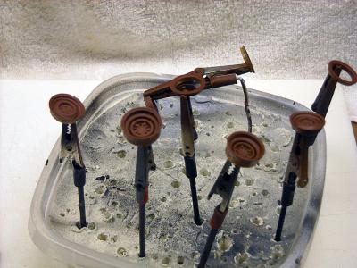

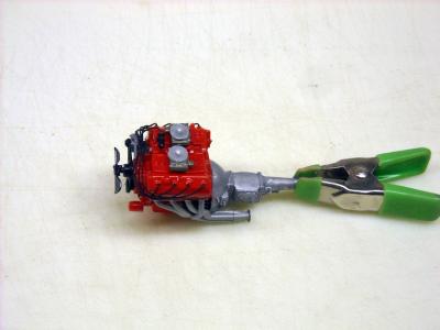

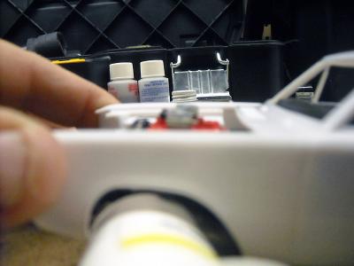

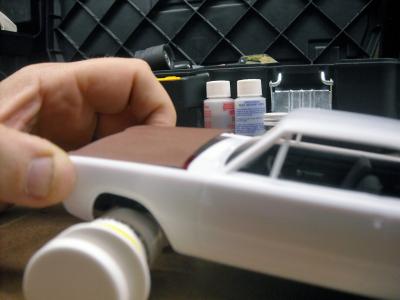

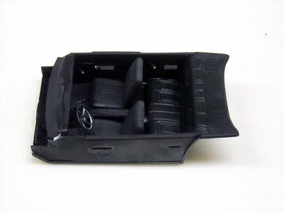

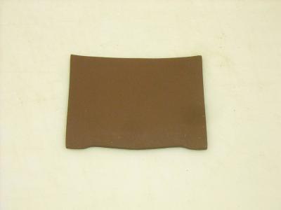

The Sleeper Hemi Dart is coming along nicely. The motor is done except for the air cleaner nuts and a bit of black wash. The faded interior tub is done, using the stock interior (not the Hemi drag interior). The flat hood is done and rust primed. the steelie wheels are rust primed. The rear suspension is mounted on the painted chassis. Unfortunately, as the (slightly out of focus) mock-up photo shows, I've got some serious work ahead lowering the engine so that the carbs and air cleaners fit under the flat hood - maybe as much as 1/8 inch. I've also got to make sure that the oil pan still clears the pavement when I'm done lowering the engine AND still clear the torsion bars with the headers.

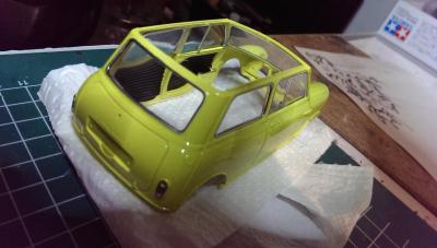

It's April. I put no hand on it during eastern ;) and my Mini is still in the race. New pictures coming soon
EDIT.... Added some pictures...

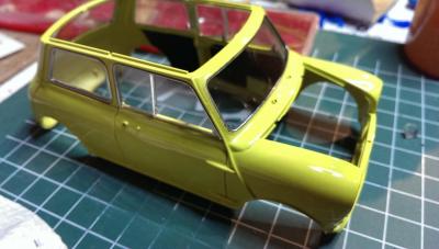

The body is still painted, the window frames done and glasses glued in

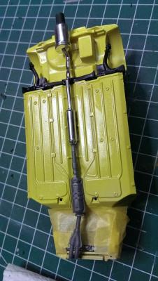

Then I cut one (!) hour to fit the Honda exhaust to the short Mini chassis :huh:
post-14847-0-23021000-1428467496_thumb.j
Next: finish the interior, put the body and chassis together and start with putting the engine into it's place. It's to less space to put all the stuff together and get it married as a last step. So I have to work in the engine compartment :lol:

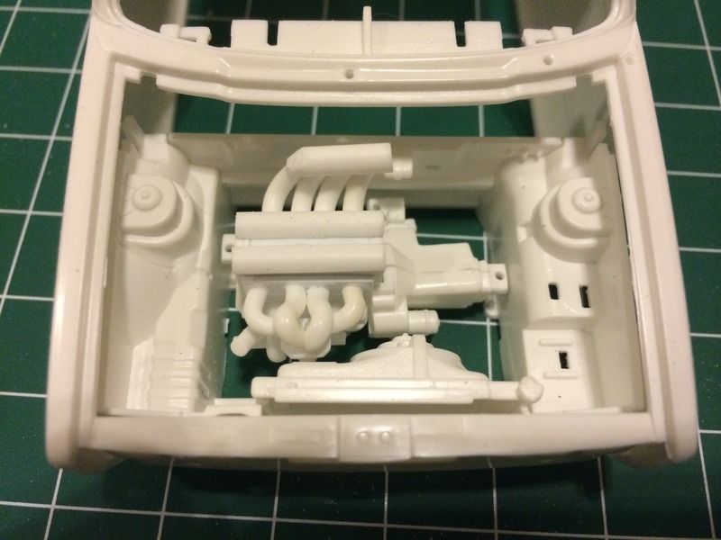

I'm pretty sure that I now have the 426 Hemi down low enough to clear the Dart's flat hood (after shaving down the intake manifold where the carbs sit, sanding the carbs down, scratch-building flat air cleaners, removing the engine side of the motor mounts, shaving down the chassis side of the motor mounts, notching them for the headers and thinning the tranny cross-member). I'm not sure about ground clearance now (the headers and the oil pan now hang down awfully low), but one problem at a time. Maybe I'll get lucky and it will be okay as-is.................

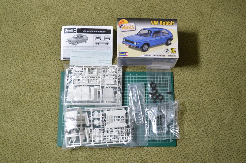

For my entry I wanted to keep it simple. I chose the Revell California Wheels release of the Volkswagen Rabbit. Seems like a really nice kit so far. Here it is shown fresh out of the box. It even has MI plates for me.

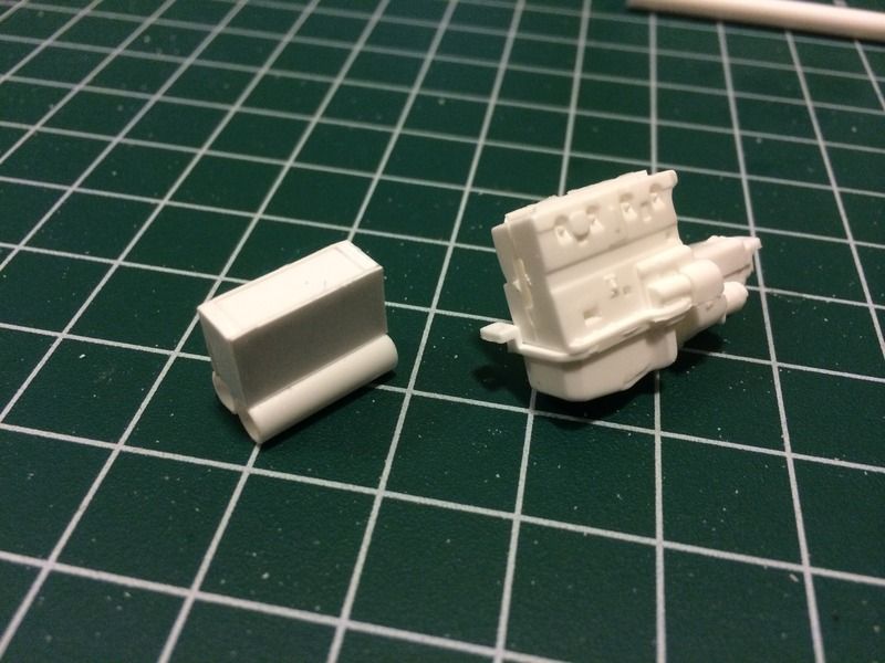

My first task was to get rid of the little-engine-that-wishes-it-could. My entrant has decided to go all out and have a billet engine block made. Would have a robust forged set of aftermarket internals for a Mitsubishi 4G63 with a block and head made from billet for more strength and easier adaptation into a first gen Rabbit. I set about scratch building the custom billet 2.0L DOHC engine. The basic block shown next to the kit 1.6 engine.

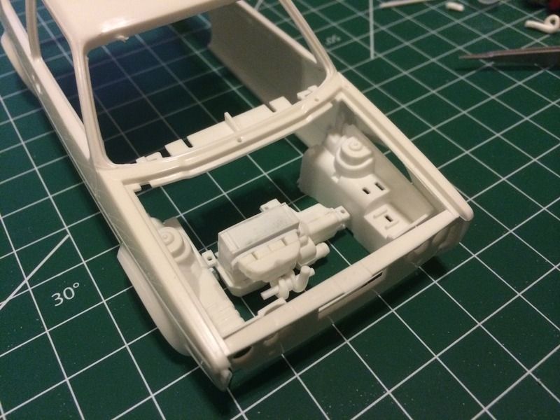

I removed the kit block from the trans, and test fitted my custom block to check for size. I scratch built my first manifold which I attempted to make look like a cast square tube manifold. I scratched up the basic components of the turbo for mock up.

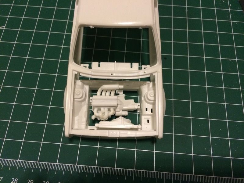

It quickly became apparent that the square manifold was much too large and looked out of scale. I pitched it and began working on a tubular manifold. If the driver spent the money building a custom block, they probably wouldn't run a cast manifold. After an hour or so I had bent up a pretty cool looking tubular manifold. I mounted the turbo opposite its original position so it would more easily clear the radiator. I bent up some more styrene rod to mock up the intake manifold. Not 100% sure I like it just yet, but I haven't had a chance to work on it again. I also just started work on the DOHC valve cover. Only have the cam covers cut out so far. Will be adding many more details.
Slightly further away to show general size and fitment. Future plans include scratching up an external wastegate, charge piping, intercooler, COP ignition, and a Megasquirt style ECM. The car will retain the stock body with only slight mods to the front end if needed for charge piping.I am planning for a slight drop, photoetched big brake kit, and wider front tires if I can find any that will work. My planned paint job is a dreary tan color with black steel wheels. The only external sleeper hints will be the big brake kit if it fits, and maybe an extra opening for the intercooler.
