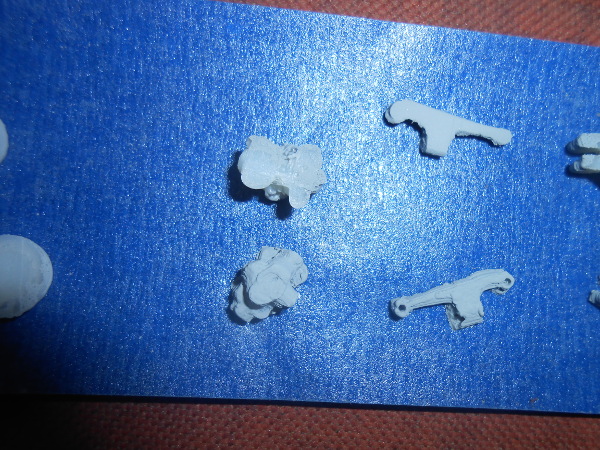

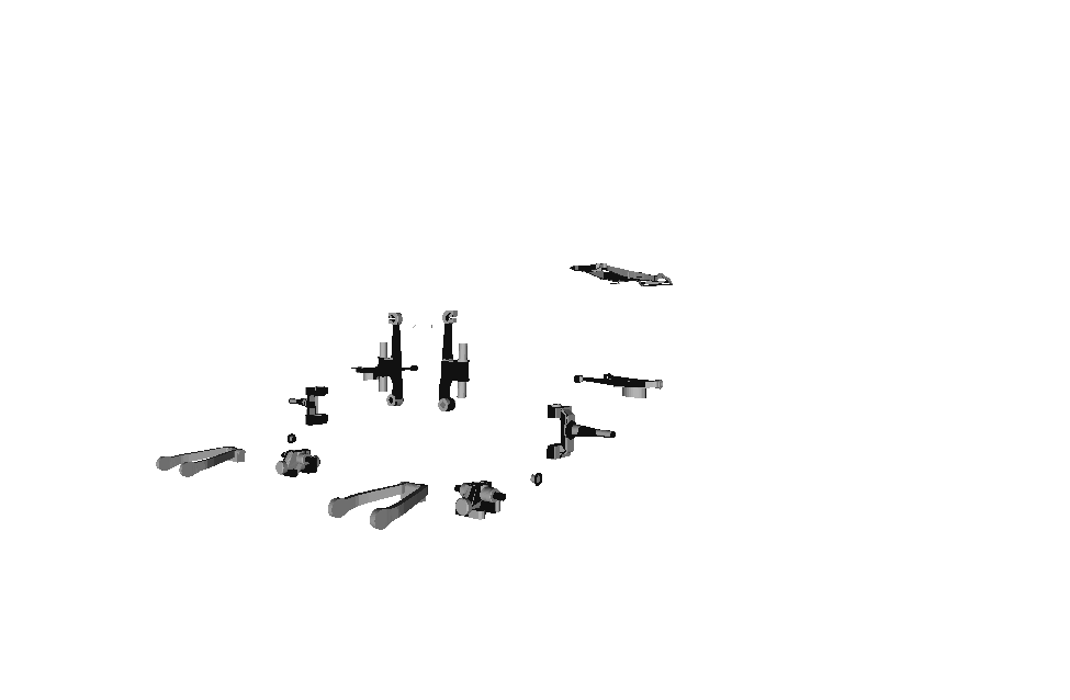

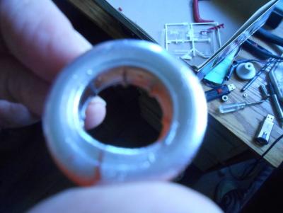

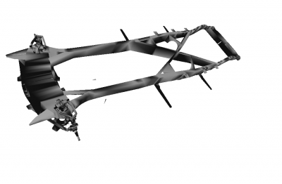

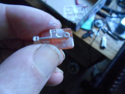

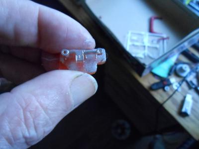

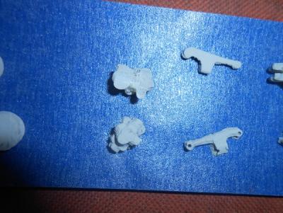

my66s55 Posted December 29, 2014 Author Share Posted December 29, 2014 Here's a good example of the difference between a part that's printed on my filament machine and the dlp machine. Last picture is the stl file,first is the filament print and the other 2 are the dip print. Quote Link to comment Share on other sites More sharing options...

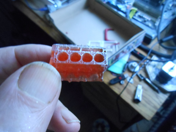

my66s55 Posted December 29, 2014 Author Share Posted December 29, 2014 Thus is a better picture of the the engine block. Quote Link to comment Share on other sites More sharing options...
charlie8575 Posted December 29, 2014 Share Posted December 29, 2014 Is that starch plastic (PLA) or conventional petroleum plastic? Very nice, Doug. Charlie Larkin Quote Link to comment Share on other sites More sharing options...

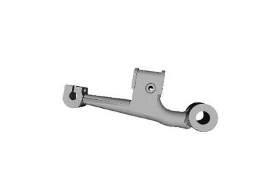

GlueTube Posted December 29, 2014 Share Posted December 29, 2014 This is the stl filed I used. Hey Doug, How long did it take you to create the the file? Regards Brian Quote Link to comment Share on other sites More sharing options...
1930fordpickup Posted December 29, 2014 Share Posted December 29, 2014 These parts are looking better than anything I have seen printed in scale. Quote Link to comment Share on other sites More sharing options...

my66s55 Posted December 29, 2014 Author Share Posted December 29, 2014 Hey Doug, How long did it take you to create the the file? Regards Brian I don't recall, Brian. It was done as a part for the front suspension of the 1935 LaSalle convertible coupe model I am printing. At the time, I was still learning to use Blender and didn't know all the shortcuts. It wouldn't take that long today. Here are the files. Quote Link to comment Share on other sites More sharing options...

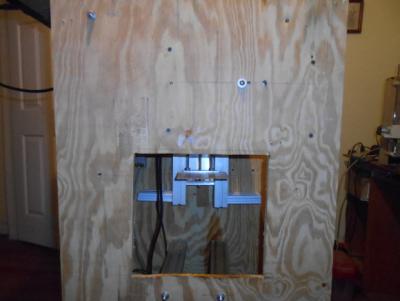

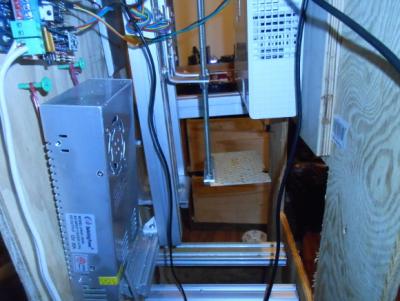

Mooneyzs Posted December 30, 2014 Share Posted December 30, 2014 I still would love to see a pic of your printer set up. I like the fact that the price is much cheaper than buying. Another good site to find 3D models is 3DContentcentral.com. all of the parts that I have modeled and drawn up has been in Solidworks. You can see some of them in my 1/16th scale Army Vega funny car build thread. I could also post some pics of various parts I have modeled and printed up for my build. Quote Link to comment Share on other sites More sharing options...

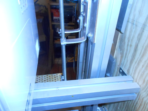

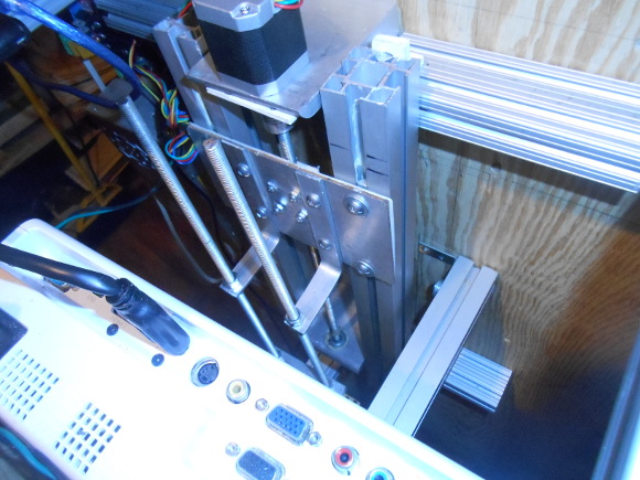

my66s55 Posted January 1, 2015 Author Share Posted January 1, 2015 I still would love to see a pic of your printer set up. I like the fact that the price is much cheaper than buying. Another good site to find 3D models is 3DContentcentral.com. all of the parts that I have modeled and drawn up has been in Solidworks. You can see some of them in my 1/16th scale Army Vega funny car build thread. I could also post some pics of various parts I have modeled and printed up for my build. Sorry for the delay in answering this request. When I went into this project, I was not sure of the end result. I knew that I could resell the projector if things didn't turn out favorably. With that in mind, I did some parts as cheaply as possible. After seeing the success of the project, I needed to make some upgrades to improve the end results. With that in mind, here is my dlp printer as of now. I have included a build list of what I used. Quote Link to comment Share on other sites More sharing options...
my66s55 Posted January 1, 2015 Author Share Posted January 1, 2015 Here is the list of materials used to build this. Add another $20 for misc hardware and you have the cost. The software is all free. Quote Link to comment Share on other sites More sharing options...
