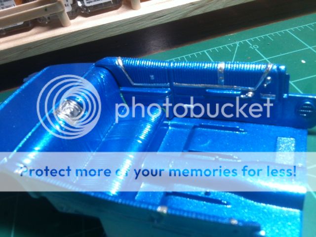

Kevin, that color over gray will darken it a little,
that interior tub is icy blue over gray primer.

Interesting. I'll probably go with white primer or base coat first then. I really like the color of the hood behind the interior.
That definitely looks metallic. If you want opaque don't use it.
Are you saying that metallics aren't opaque? I was under the impression (perhaps incorrectly) that only candies were translucent.

Kevin, the body behind that interior is painted in testors Nassau blue.

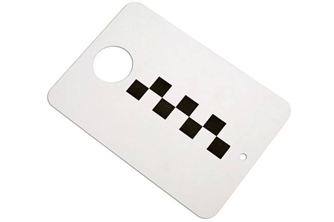

"Metallics" consist of tiny metal or plastic particles suspended in a tinted clear. This is so you can actually see the particles, or flakes. If the flakes were mixed with an "opaque" paint, they would pretty much disappear.
Because the flakes are suspended in a tinted clear, it can sometimes take as many as 5 coats, even when using Teasors "one coat" paints, to achieve full hiding and even color with no basecoat or primer show-through.
This is why painters of real cars use "sprayout cards" with black and white squares. When you can't see the black through the paint any more, you know you have enough coats of paint to provide full-hiding. This is especially important if the color is not going to be clear-coated, but sanded and polished. It's necessary to provide additional coats of paint after full-hiding is achieved to allow for the removal of paint on high-spots that is inevitable during polishing, to avoid light spots and primer show-through.

It's beautiful. I'll probably end up buying a can. Thanks,
Makes perfect sense, now that I think about it. Almost immediately after posting, I got to thinking the same thing, if the paint was truly opaque, that would probably render the flakes more or less useless. Looks like I'll be using a white (or perhaps silver) base coat under mine then.

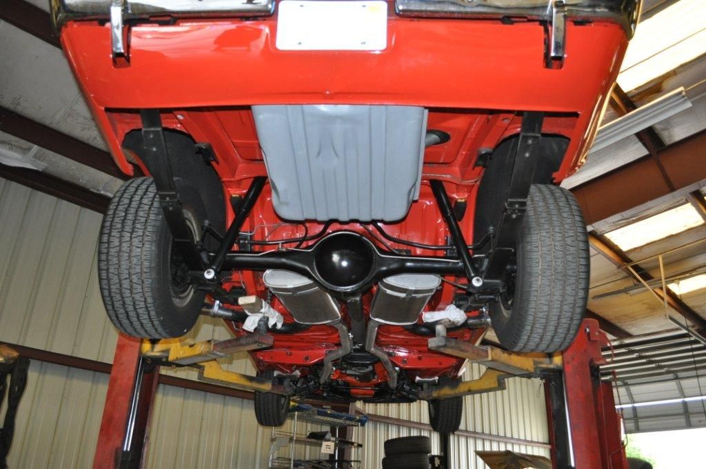

Hey there Kevin. I found out some information regarding chassis. Initially I had painted my chassis black but later found out that it was mostly body color. Here's a photo from one of my reference photos that I acquired through here:
Not nit picking as you are off to a good start but just giving some info to you.
