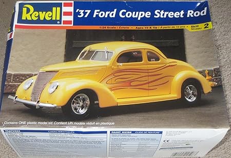

What I'd like to know is info and pointers from those of you who have built these old racers. Specifically, I picked out this kit to build the car off of...
From the looks of the image on the box I suspect the car is lowered somewhat so I'll have to actually beef up the suspension some to make it more natural looking. Any thoughts on this, or am I using the wrong kit for this project?

The body is great,but the chassis will not work for this application.For starters,the kit is in 1/24th scale,and almost everything else you're gon na find,is in 1/25th.If my 74 year old memory serves me right,the pic looks to be from the early to mid 50s. Monogram had 1/24th '36 coupe,that you might be able to use for some parts.Grab a Revell '40 Coupe for its frame and other running gear.Don't get the one with the Columbia O.D.rear,and don't worry about it being 1/25th,it will work.The next thing you must do,is get your hands on a Replicas&MiniaturesCo.of Maryland catalog.They have just about anything else you'll need,wheels,shocks and a ton of flathead stuff.If at all possible,try to find a REAL car at a museum or collector.Y ou'll need to be creative,nobody from the past is going to critique your work.Hope I,ve been somewhar helpful.Good Luck!
Share this post
Link to post
You'll have to source wheels for the car too. The photo shows the '37-'39 "wide 5" style wheel, and there were several variations in width, from 3.5" on the V8-60 powered cars to 5" on some trucks. AMT '36 Fords have kinda pretty good stockers, but they lack the scalloped centers your photo shows. The Revell '37 Ford trucks have the scalloped centers, but unfortunately, part of the hubcap assembly is molded on to the wheel, and it completely obscures the signature "wide-5" bolt pattern.
I know I've seen the correct wheels somewhere, either in a kit or in resin, but I can't recall where.
Bigkenny is right about the chassis. All '35-'40 Fords are on essentially the same chassis, but the street-rod version with independent suspension that's under the kit you have isn't appropriate for a period stock-car racer.
The frame and running gear from the Revell '40 coupe (the stock one) comes with the 2-speed Columbia rear end, which is also wrong for a race-car, but otherwise, with a few slight adjustments, should work fine. You'll need a non-overdrive rear end, and any of them from the Revell '48 Fords should be adaptable to the '40 chassis.

The Wide-5 wheels that Ace is referring to is part # P-9 from Replicas&Miniatures Co.of Maryland. You'll still have to tweak them a bit,but they are a good start.Have fun and Happy New Year!

Thanks a lot, guys! But due to money constraints I may stick with the kit's original chassis. I haven't completely decided on this yet, as I'm still going to search for the proper wheels and tires, but I don't think her family is going to notice the suspension ain't factory.
Yes, everyone HERE will notice it though, and that's why I'm planning to build a more authentic racer sometime later this year when I have all my parts lined up (I've also got the '37 sedan Ford kit which has the same identical chassis...). BUT, one of my modelling friends pointed out that I don't need to run through all that when most of her family hasn't seen a '37 Ford racer since the early '50s anyway.
Still, it never hurts to have knowledge from those that have invested their time and money into projects like these. Keep 'em coming!

You could build it with what you have,the most important issue would be the stance and the wheel and tire combination,and the paint and lettering.As I understand it,you,re building it to go on a shelf,so it doesn't need to be as complicated as Ace and I are trying to make it!
