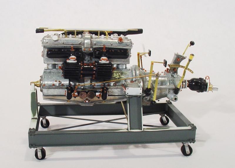

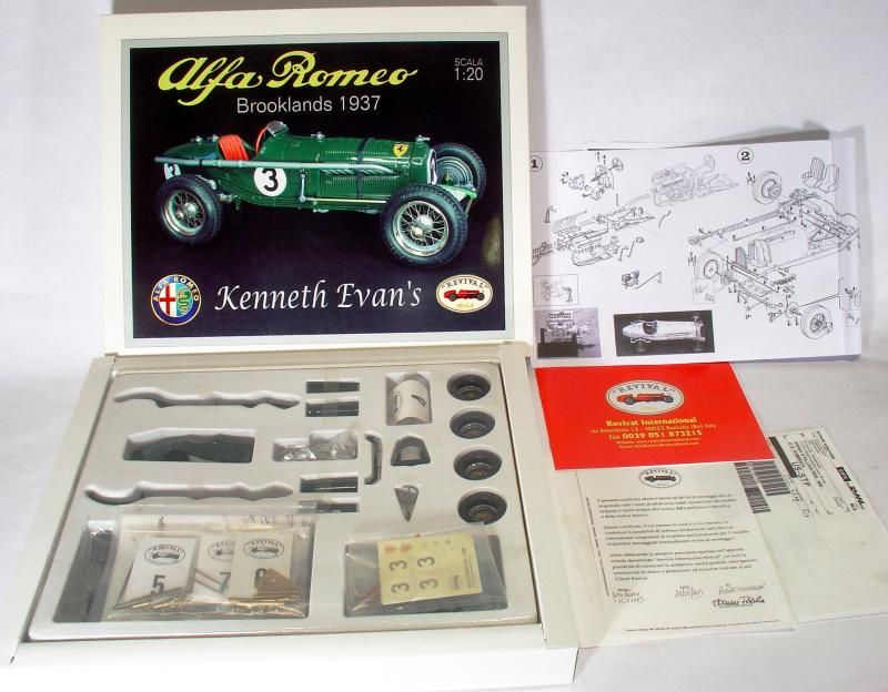

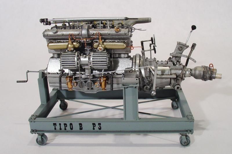

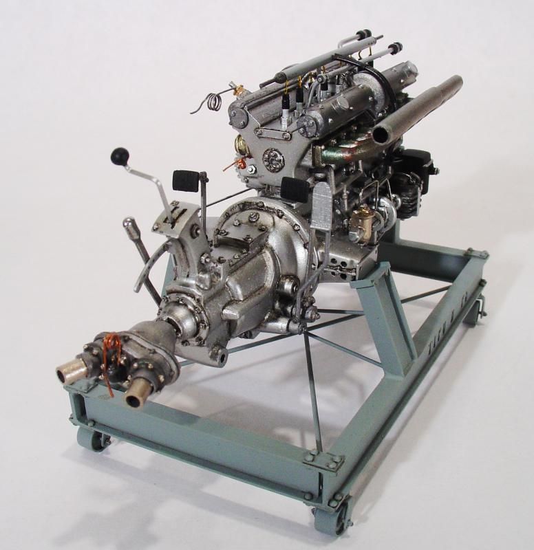

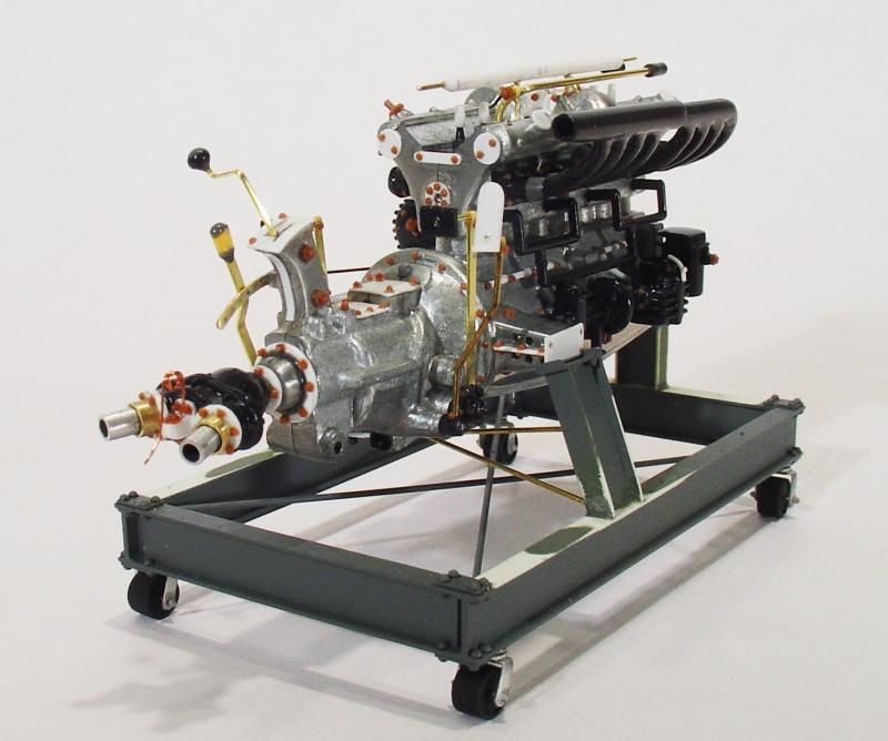

Here are some photos of the engine from the Revival Models (Italy) 1/20 scale Alfa Romeo Tipo B P3 Grand Prix racer I'm building. These Revival kits look great in the box but can be somewhat of a challenge to build.
Share this post
Link to post
Wow. Looks like a metal kit. Is the engine stand included?
Hi Pat,
The kit is mostly metal, yes. The stand is not included, but the engine is detailed enough that I bought a second engine kit from Revival to display outside the model on a base. This required me to scratch-build a stand from Evergreen structural shapes. There are 133 pieces in the stand which is styrene except for the wheels which were cut from brass tubing and castor mounts bent up from brass strip. Lots of Tichy Train Group styrene nuts and bolts on both the stand and engine. Thousands, I think....... :blink:

Those engine shots are beyond belief. I don't know what reference you have, but as a longtime Alfisto, I would certainly go with Rosso Corsa red.

Beautiful work Bob!
Does that mean you are building two engines?

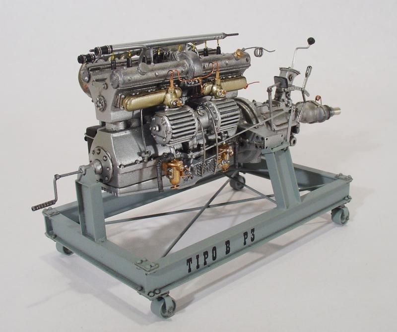

Are there TWO driveshafts on that car?
You have a discerning eye, Pat. Yes, there are. The final drive from the gearbox ran to an attached differential which then split the drive into two torque tubes housing two propeller shafts which ran back to two bevel gearboxes on the rear axle. The advantages of this design were (1) it offered a slightly lower seating position for the driver who sat between the torque tubes, (2) it allowed a lower unsprung and axle weight since the axle carried no differential, and (3) it facilitated final gear ratio changes to suit various race courses. I've tried to show this using aluminum and brass tubing for the torque tubes and propeller shafts.

Beautiful work Bob!
Looking forward to seeing more of this!
Tom
Yes I am, Tom. One engine will be mounted in the car with the hood (bonnet) panels open, and the other will be displayed on the engine stand next to the model on the base.

If you have the interest, the Website for Revival Models is: http://revivalinternational.mysupersite.it/
I ordered my kit directly from Italy, along with a second engine they sell separately as a kit. You'll receive a warranty slip with a serial number which you can copy and send back should you need any replacement parts that somehow became broken or lost. My kit arrived well-packaged and in excellent condition, and I did ask for three missing parts which came in about two weeks. Good service.

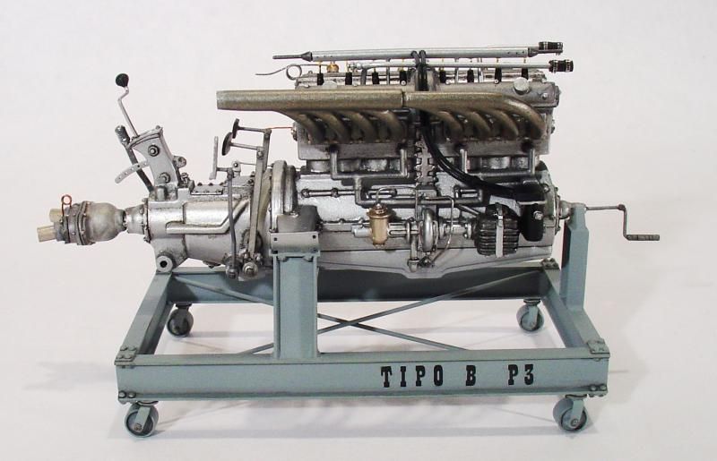

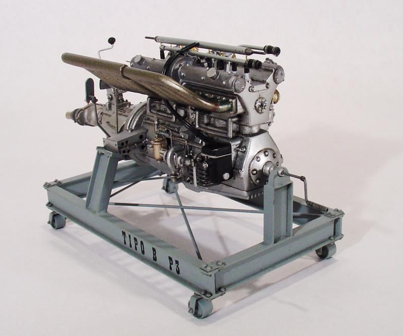

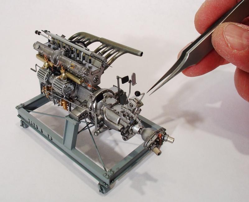

Well, both engines are finished and have 1020 pieces between them. One will be mounted in the car while the other will be displayed on its stand next to the finished model. You gotta love that Alclad II. :)
These kits from Revival Models are best tackled if you're an intermediate or advanced modeler, mostly because there are no instructions per se. Just several exploded drawings which task you with deciding on assembly sequences and which screws go where. Still, I'm having great fun with this.

I am glad you put your hand in one of the pics Bob
Fantastic detailing there
