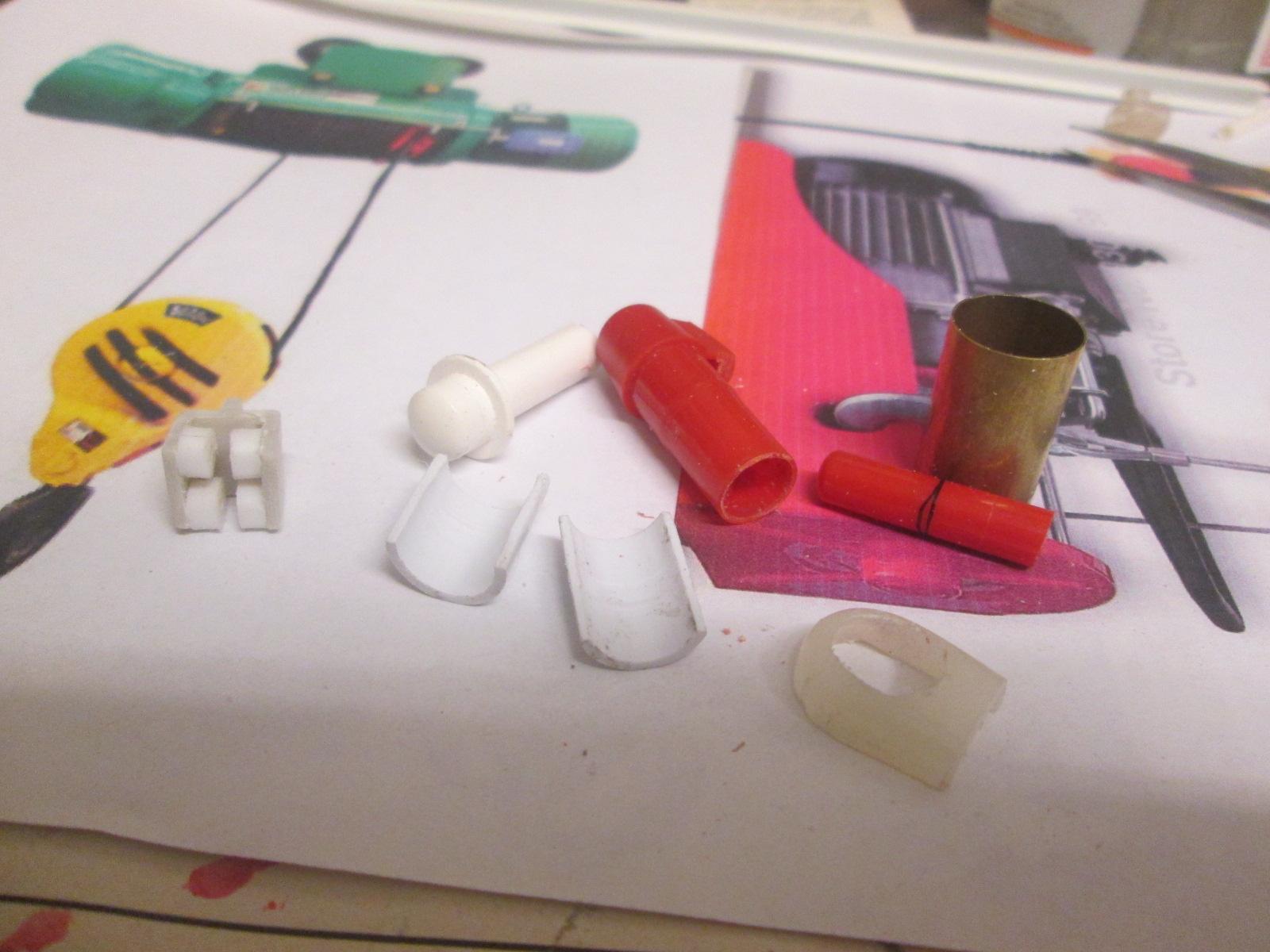

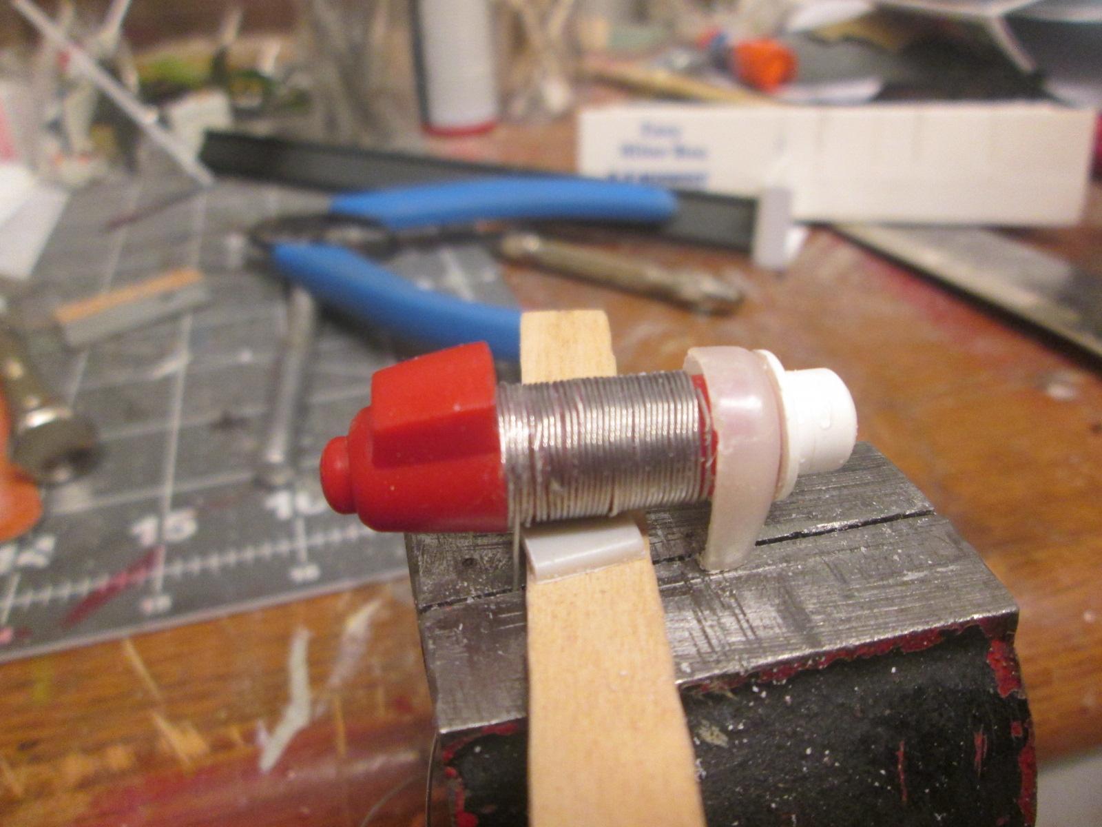

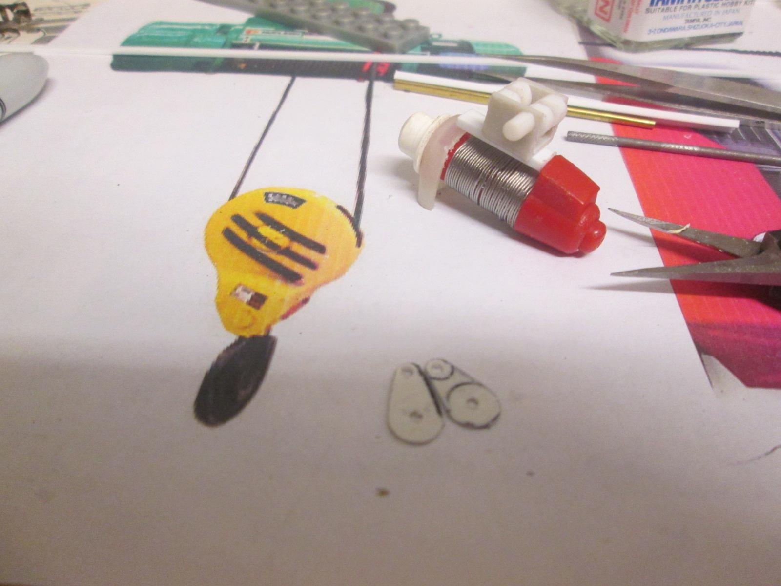

Started on a wall/floor mounted jib crane.I think the girder was part of a trailer kit .
It will reach all the machines
Used my new mini lathe to bore holes in a rod that will become part of the cable hoist carrier.

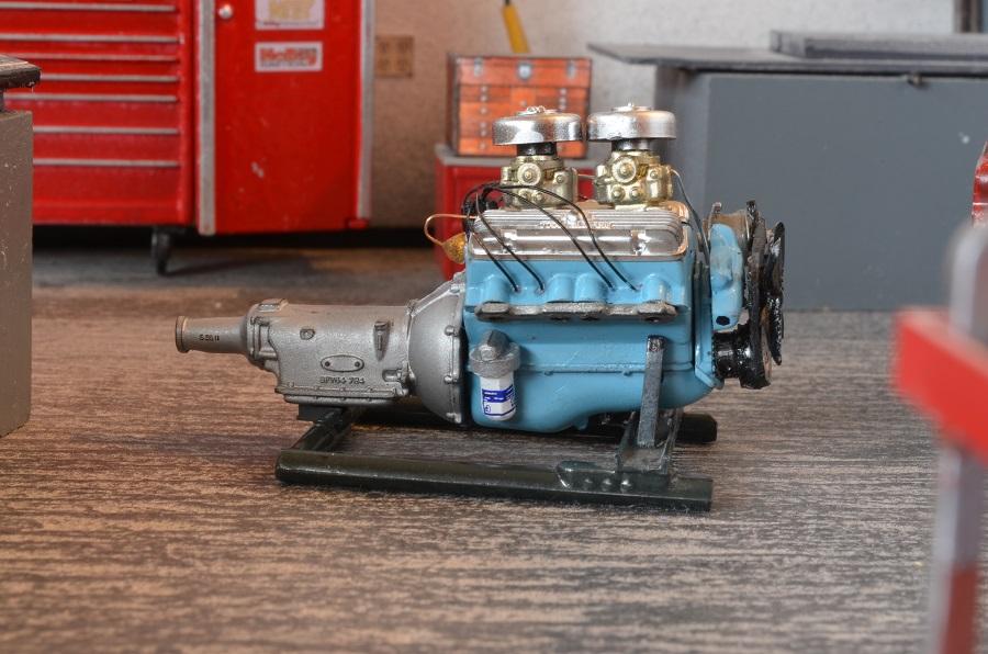

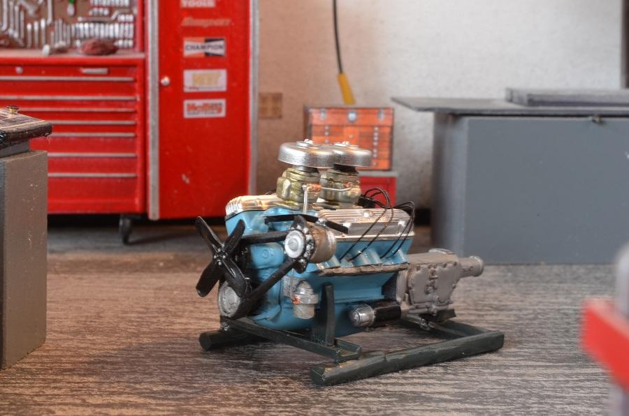

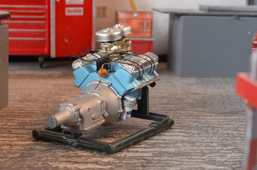

FTB recently completed a Pontiac SD 421. It is the one from the ERTL parts pak, which is a drag engine with three induction options. I chose the dual four setup but "streetified". The starter, water pump ,fan/pulleys/alternator assembly, distributor came from the parts bin. The oil filter, fuel pump, distributor dashpot and various tubing were scratchbuilt.

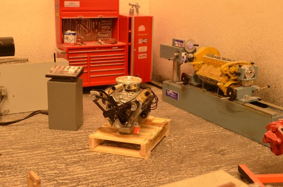

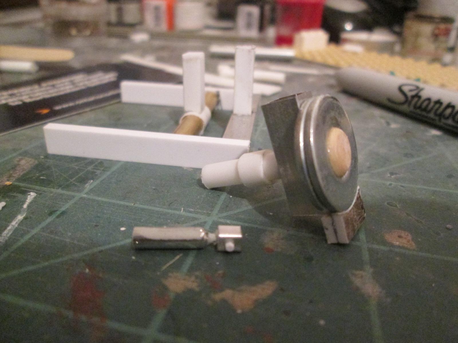

The next machine I was going to build was one of these block mounted cylinder boring machines.
I couldn't remember seeing on what they placed the blocks to do the bores so I went back. they use one of these, an OTC revolver 6000lb. stand.
I started on it this morning
Edited by landman

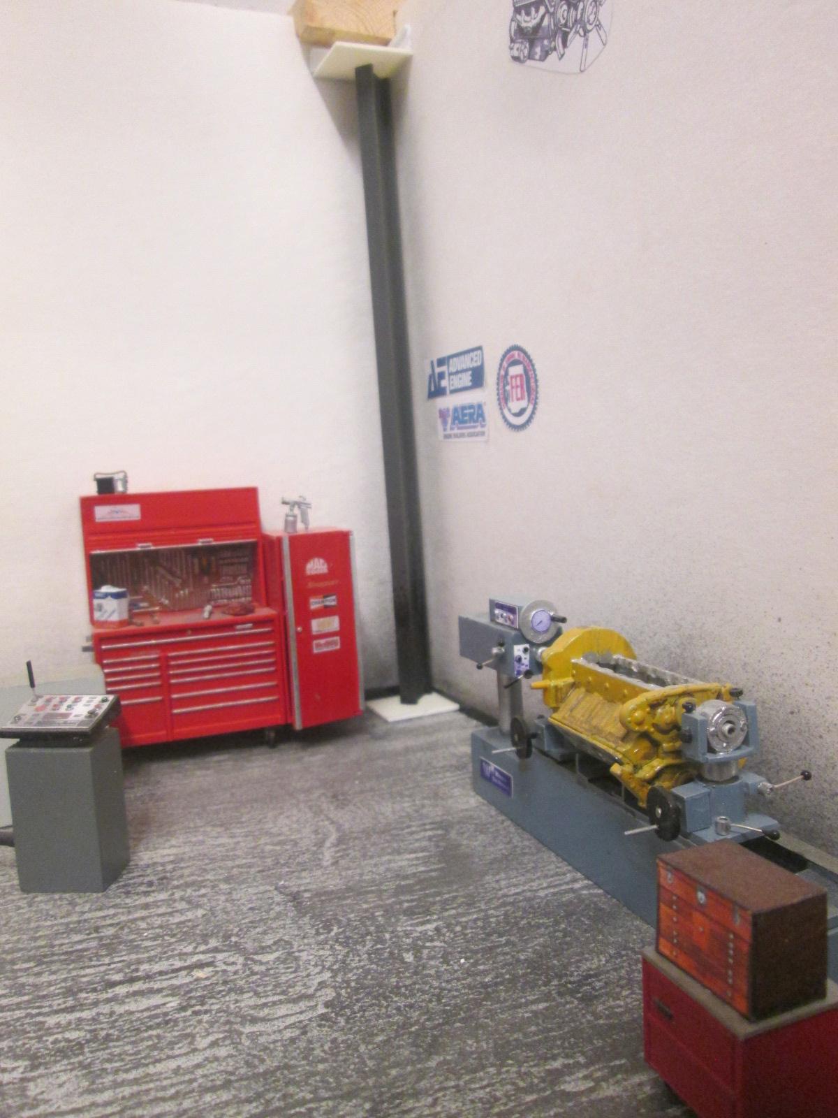

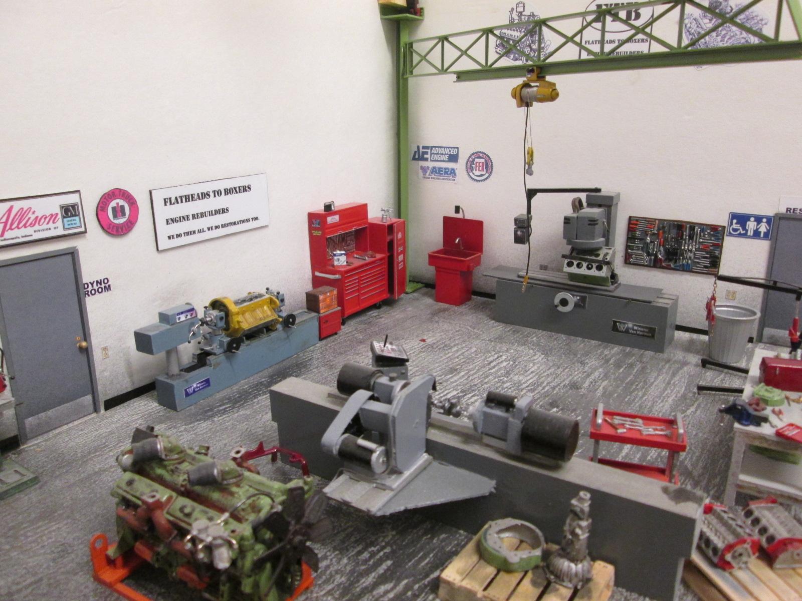

Completed and installed jib crane.
I got behind viewing and it ALL looks spectacular so far! Everything just looks right.
One little tip from one who spent a career designing cranes would be to add small lengths of angle on the web between flanges as bump stops for the hoist. These are always there and will be a tiny detail that's noticeable. They would be right where you have some bolt heads.
Link to comment
Mike, I put the short tubings there as stops but if real cranes have angles, this one'll get them. thanks for the kind words and the suggestion.
Link to comment
eheh, the bolts do look ok but won't stop that hoist from coming off the end. To bash it to death, a L3x3 is is commonly used. That's 3 inches)
