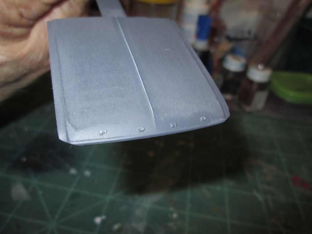

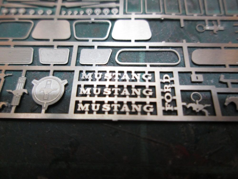

I am working on a 1:25 model of a Ford mustang. The scripts front & back are individual letters. On the hood I am using, they are molded in. On the rear decklid, they aren't. the detail PE sheet for this car has the scripts. Ford goes on the hood and Mustang across the decklid.
I have looked at many videos & tutorials about working with PE all of which were very informative. However, none of them show how to install individual lettering straight and with the proper spacing. Has anyone here ever done this? And how do you "chrome" something this small?

I can see the center letter method working on the rear.
As for the front do I:
- Paint the raised letters?
- Use the PE letter ON TOP Of the raised letters?
- Shave the raised letters before using the PE letters?
Share this post
Link to post
It's your call Pat. I usually use the "paint over foil" method myself. But being as you have the PE letters & you're using them on the rear, I would keep things uniform & use them for all of the scripts. For the front. I would take measurements of the existing letters & right them down, or do some sort of template, then sand off the existing letters before painting. Steve

Thanks Bob. Does PE polish to a silver color?
From the shot it looks like nickel that should bpolish up nice. Try some polish like semichrome or fritz on part of the fret to see if it looks lije what you want.
Share this post
Link to post
Back up the letters with some masking tape before you polish them, it will prevent them from tearing off or bending. I put the tape reinforced fret down on a wood block and the either use the Dremel with a polishing bit and compound or metal polish by hand. The nickel will shine up like chrome because the bright color you see on "chrome" is actually the nickel plating. "Chrome" is used as a thin sealer to prevent the nickel from tarnishing. On a model the tarnish issue is not usually a problem as the exposure to the elements is limited.

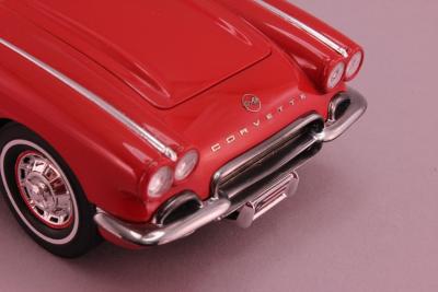

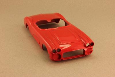

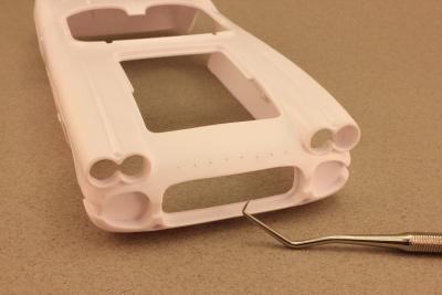

I always make a very small indentation with a small and sharp dental pick just before they disappear during the sanding process. This will give me an idea where to place the P/E parts after the paint and clear are in place. The P/E letters will cover the small indentations as seen in the images here.

Future Floor Wax. I place the P/E part as close as possible to the area and dab a very small amount of Future. I will then move the P/E part onto the Future. Once 100% dry, I will dab a bit more of the Future on top of the part.
