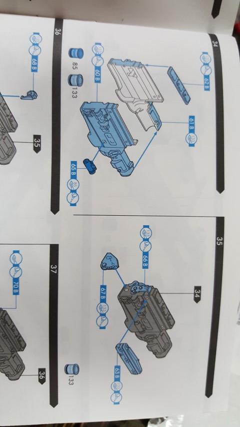

Ah just the thread I am looking for, problem is I have no clue what kind of engine I have here. Kit came with paint. It this correct? can anyone help?
Share this post
Link to post
What kit is that from?  Also, what do you get when you mix the 127 & 133 paints?  I'm not familiar with Humbrol colors.
Share this post
Link to post
The engine you have there looks to be from an Italeri kit and it's a Cummins NTC 400 and should be beige...but Italeri sometimes wants us to belive it's a Cummins N14 as they in some kits changed it from a water to air aftercooler to an air to air intercooler.
A Cummins N14 is black often with red valve covers, but the N14 has different heads and more squareish valve covers...and these are NT-NTA-NTC covers.
When I looked closer at your picture the paint call outs (marked blue) are for the exhaust and water manifolds and the exhaust part of the turbo, nothing for the engine block assembly, the paint call out for the engine block can possibly be shown at an earlier stage.
But all of the engine was painted beige from the Cummins factory and the paint would burn off on hot places like the exhaust manifold and turbo.
Edited by Force
Share this post
Link to post

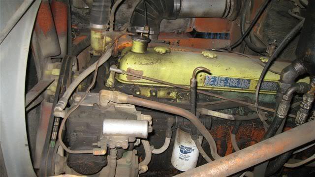

just a test-who knows the story on these lime green cummins and detroits?
As far as the Cummins goes the PT series "power torque" were lime green and I believe some custom rated Cummins were also. The Detroit appears to have a red block "International" an alpine green head and a Terex green valve cover and coolant hose neck and other small parts.
