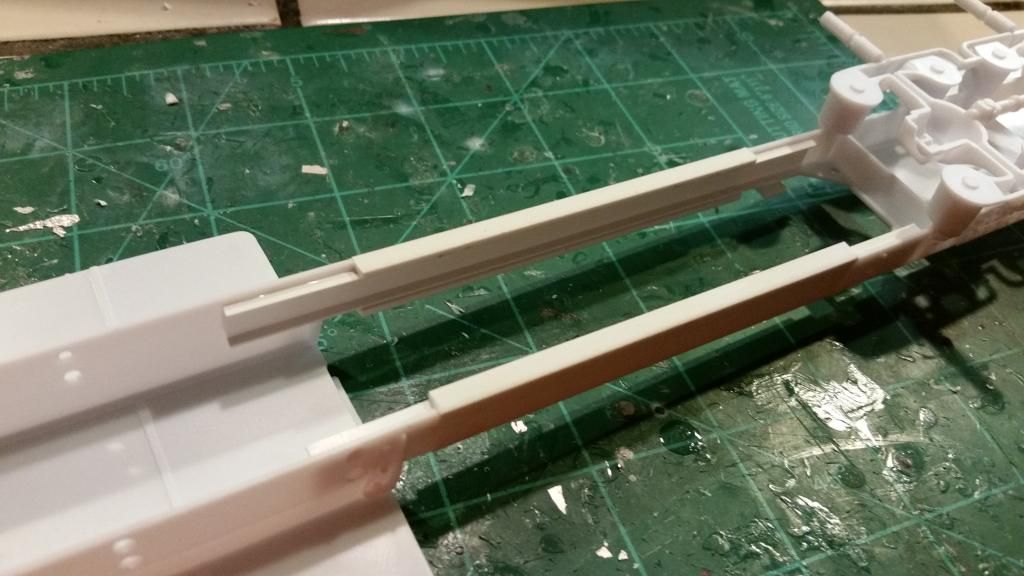

kilrathy10 Posted February 9, 2015 Share Posted February 9, 2015 (edited) Why certainly, my friend....First of all....Welcome to the forum and the world of truck modeling.....I'm sure someone will chime in with some tips on engine wiring, but that's not my expertise....I'm sure Clayton or a few others could help you with the both of these things......I can help you with simple frame extension, though.....It can be accomplished several ways, but I generally use what's on hand and within the budget.....Here's what I've done with the frame from an AMT T-600 Kenworth......Just a few pieces of scrap plastic and a lot of sanding...... Edited February 9, 2015 by kilrathy10 Quote Link to comment Share on other sites More sharing options...

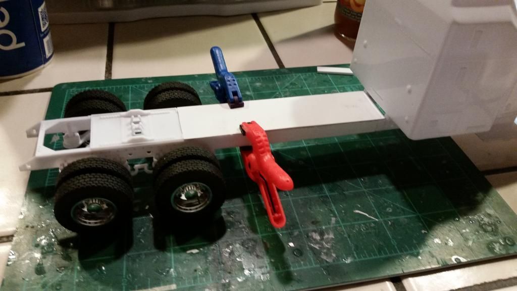

highway Posted February 9, 2015 Share Posted February 9, 2015 Thanks, woulda never though to just use scrap plastic. What about lengthening the drive shaft? If it is just a short extension like JT showed, I'd just get some plastic tubing either similar in size to the kit driveshaft and use that to make a new driveshaft and just use the kit U joints or get some just big enough to slide over the kit shaft and cut the kit shaft in half and insert into the longer tube. Now, if it is a little more extreme like this one I have in (forever) progress, then more driveshafts are in order. I added 7 1/2 inches to the frame, if I remember correctly. The white is the addition. I took these two bits from a wheel adapter kit (MRC or AMT IIRC) and fashioned a midship carrier bearing to attach the kit's original driveshaft to and still have to make a driveshaft from the engine to the carrier bearing. Also, to add strength, I added some square tubing to the top of the framerail to double as a sleeper mount. Quote Link to comment Share on other sites More sharing options...

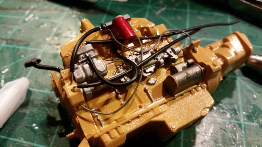

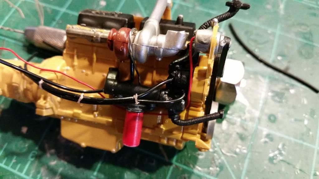

Petetrucker07 Posted February 9, 2015 Share Posted February 9, 2015 Here's how I did mine. Quote Link to comment Share on other sites More sharing options...

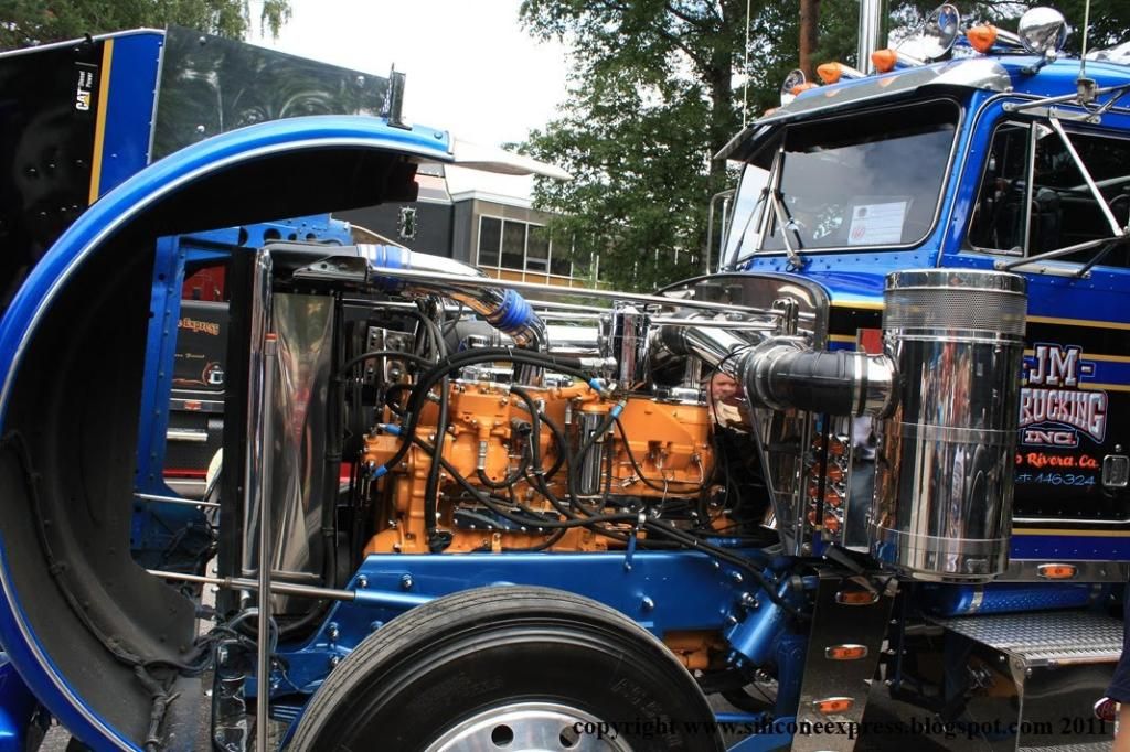

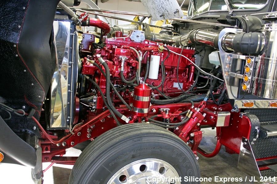

Petetrucker07 Posted February 10, 2015 Share Posted February 10, 2015 Here's a cat. Quote Link to comment Share on other sites More sharing options...
