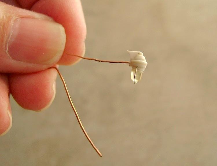

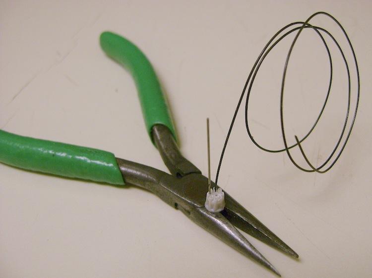

Russell C Posted March 19, 2015 Author Share Posted March 19, 2015 (edited) Distributor. Ground off the part below the cap, glued a rod into the underside hole to have something to grip the remaining cap with. That's a #77 drill bit on the left (minus the pin vice I used, of course) and some nice reasonably soft blackened wire from my wire collection on the right. I can see why there's some demand for pre-wired distributors. Bit of a chore drilling nine holes, I got two of 'em nearly perfectly centered...... Edited March 5, 2016 by Russell C Quote Link to comment Share on other sites More sharing options...
dino246gt Posted March 19, 2015 Share Posted March 19, 2015 Just a little tip for wiring that cap, push wire down through one hole and up through another, now one piece of wire becomes two wires and they won't pull out of the cap. Quote Link to comment Share on other sites More sharing options...

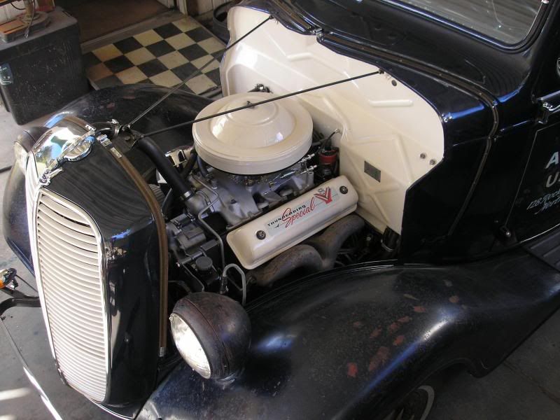

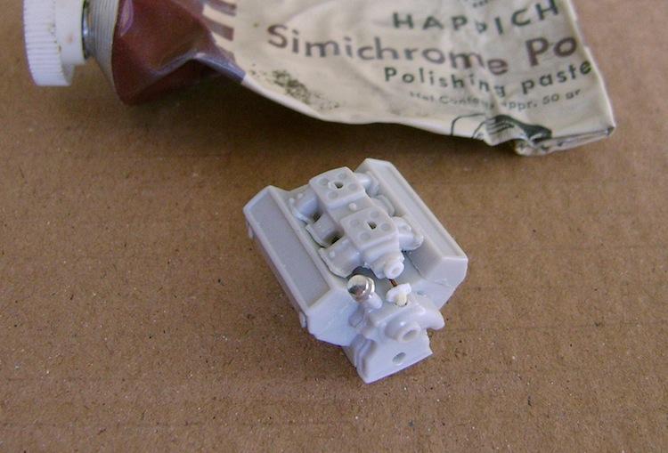

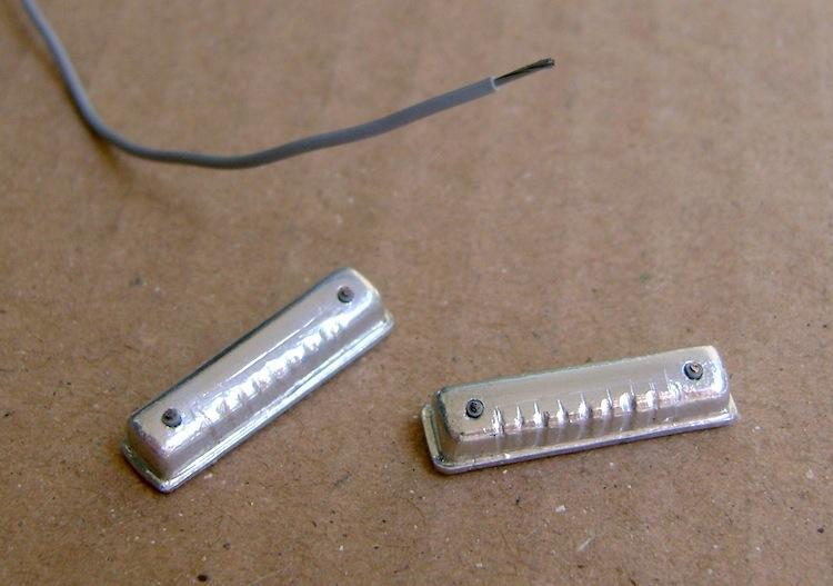

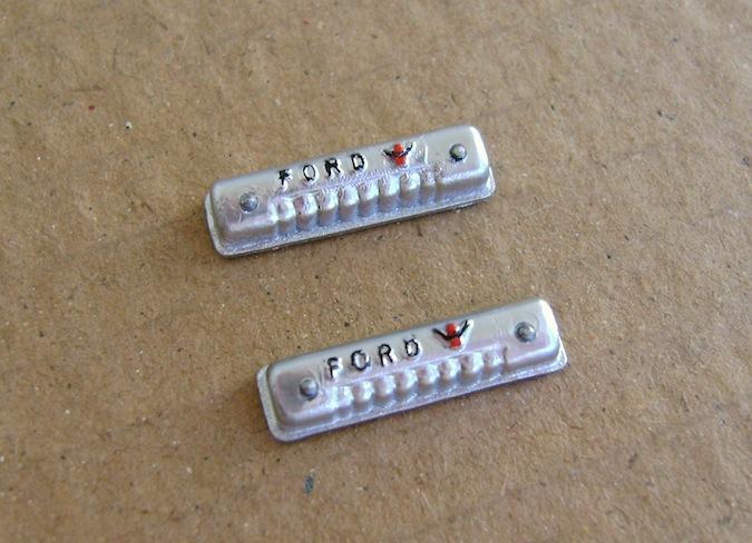

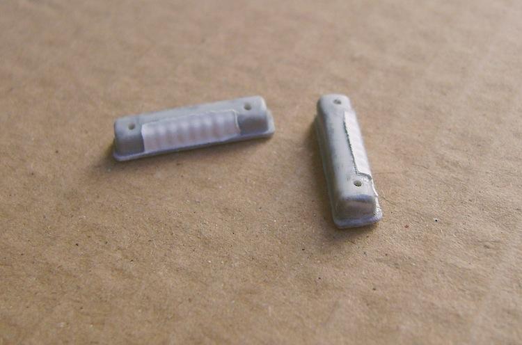

Russell C Posted April 6, 2015 Author Share Posted April 6, 2015 (edited) Valve Covers. Close-up photograph is a great humbler. Top photo shows the not-so-good path I headed down first ..... ..... chrome spray paint with bits of soft paperclip wire I attempted to 'turn' on my motor tool into something that resembled washers & bolt heads, and fine marker-painted lettering. Initially looked ok from a distance, but the photo bothered me too much. I thought the ribbed area was just too prominent, compared to what is seen in full size chromed covers. Which, from what I saw, never have raised letters. So, I filed off the letters, masked over the ribbed area, and sprayed a dozen or more thick coats of primer to build up the area. Filed the raised rib areas flatter, applied five separate (top & 4 sides) areas of Bare Metal Foil to each cover, buffed it as shiny as I could get the surfaces, and then created the bolthead / washer effect by using gray insulated wire with the insulation stripped away from the very top. Much more overall satisfying appearance for me now. I've already nudged that one slightly askew bolthead/washer down a bit, and I'll have to make some of the ribbed lines in the tops a little wider. The white primer under the foil is just soft enough for me to mash in wider lines without wrecking the foil. Edited March 8, 2016 by Russell C Quote Link to comment Share on other sites More sharing options...
