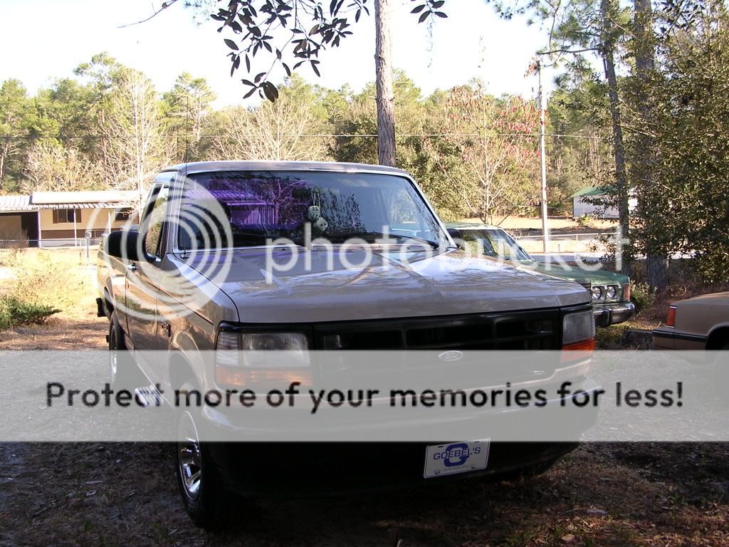

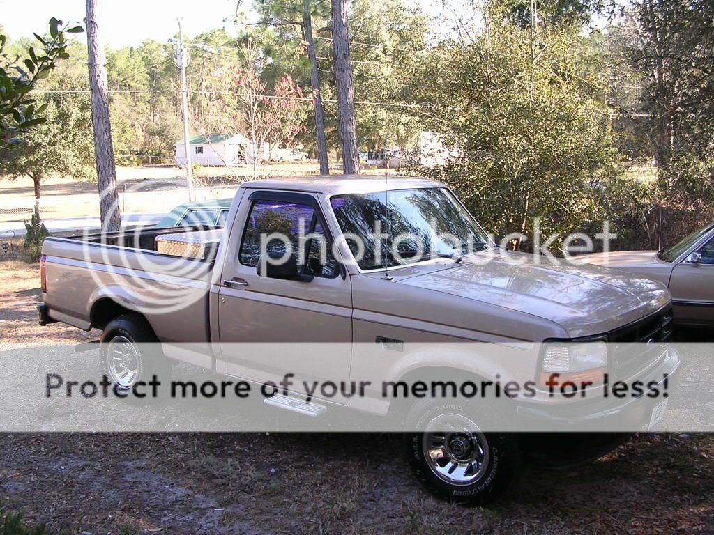

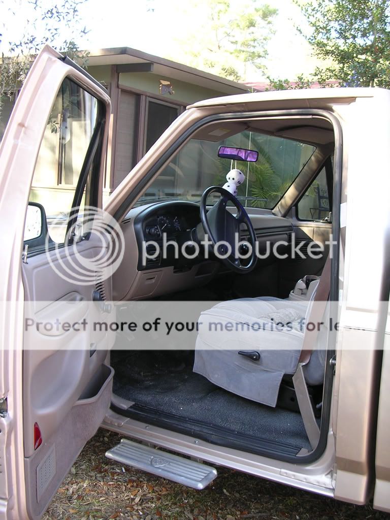

GrandpaMcGurk Posted September 5, 2010 Posted September 5, 2010 thanks don. glad you like the jig. watcha runnin' at the old farts gig? charles, the extrusion is from a company called 80/20. i bought from a supplier called mcmaster carr. the rest of the pieces are just "what not's" i had laying around. Dave, I don't want to get your thread too far off topic but you asked so here's a couple quick pics.... My 150 isn't quite 15 years old yet.....300 in-line six, headers, gears, 5-speed and mild hop-up, It'll be a "grudge" race against a bud's '37 Chevy Coupe, 292 in-line six with a whole row of carbs. The green car peeking out behind the truck is an old Chrysler New Yorker. I have a fresh 2-4 barrel 440 in it with toys....it's a big heavy car but once it's rolling it steps out just fine. I have no idea what the gang will put it up against. Our dragstrip is a private runway on private property. Hey, it keeps me off the streets, and you don't need mega buck sponsors to play.
comp1839 Posted September 5, 2010 Author Posted September 5, 2010 well it looks like you'll have a great time. all the key ingredients are there for sure. keep it safe and i hope you win!
