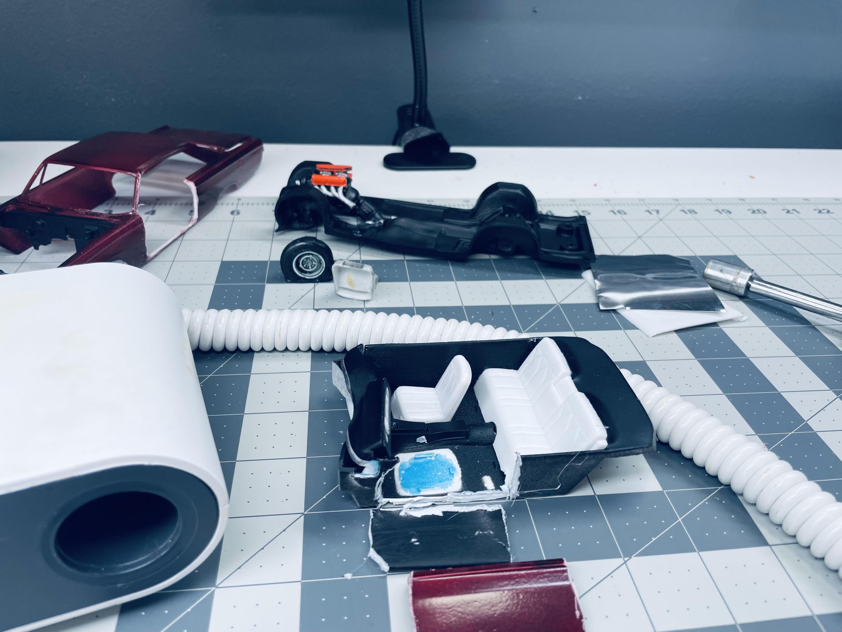

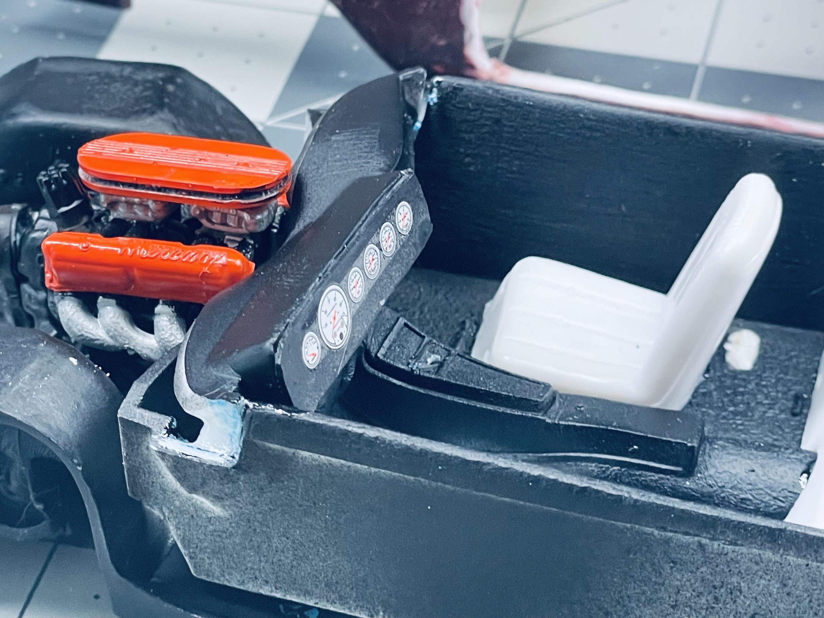

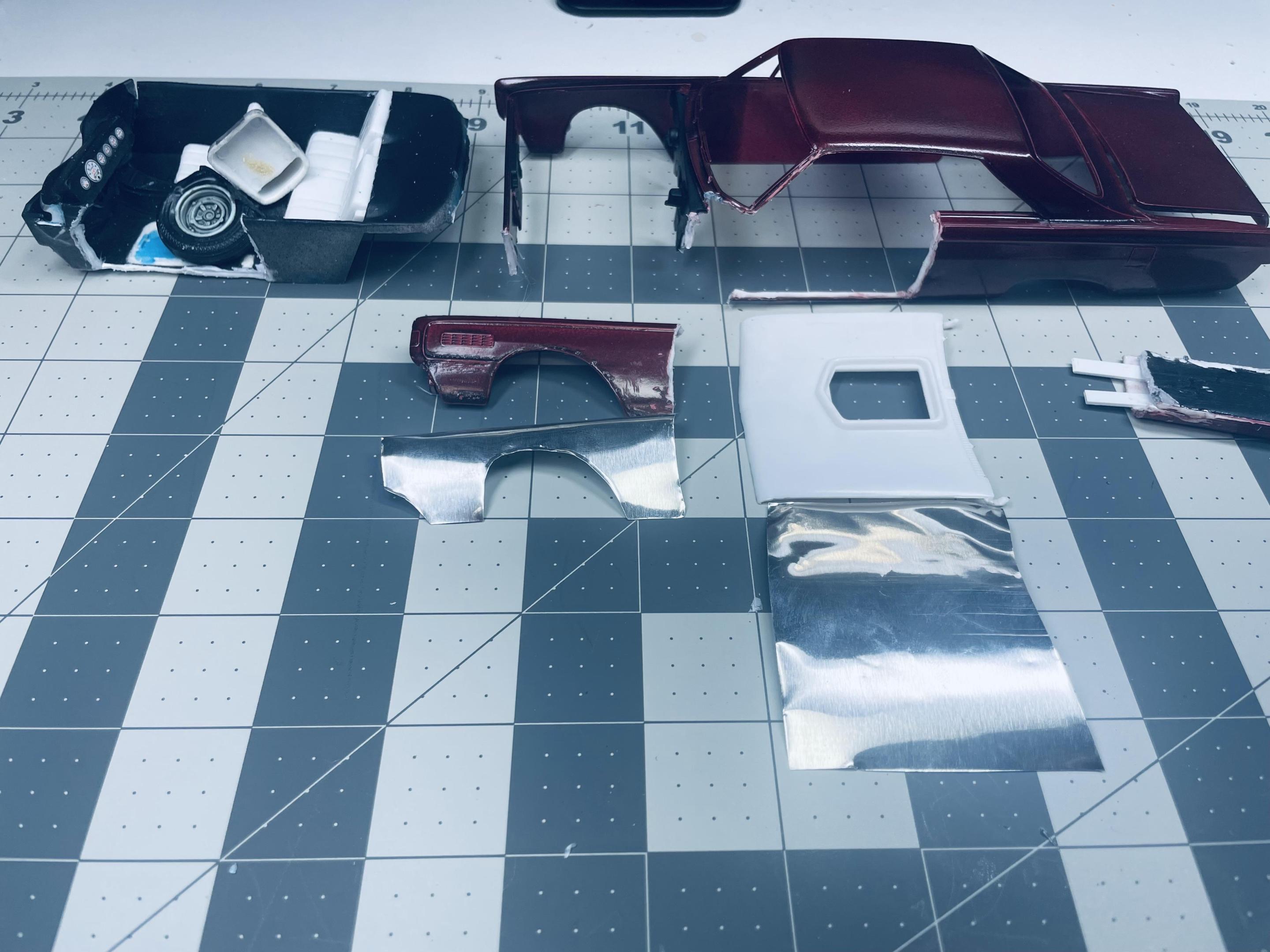

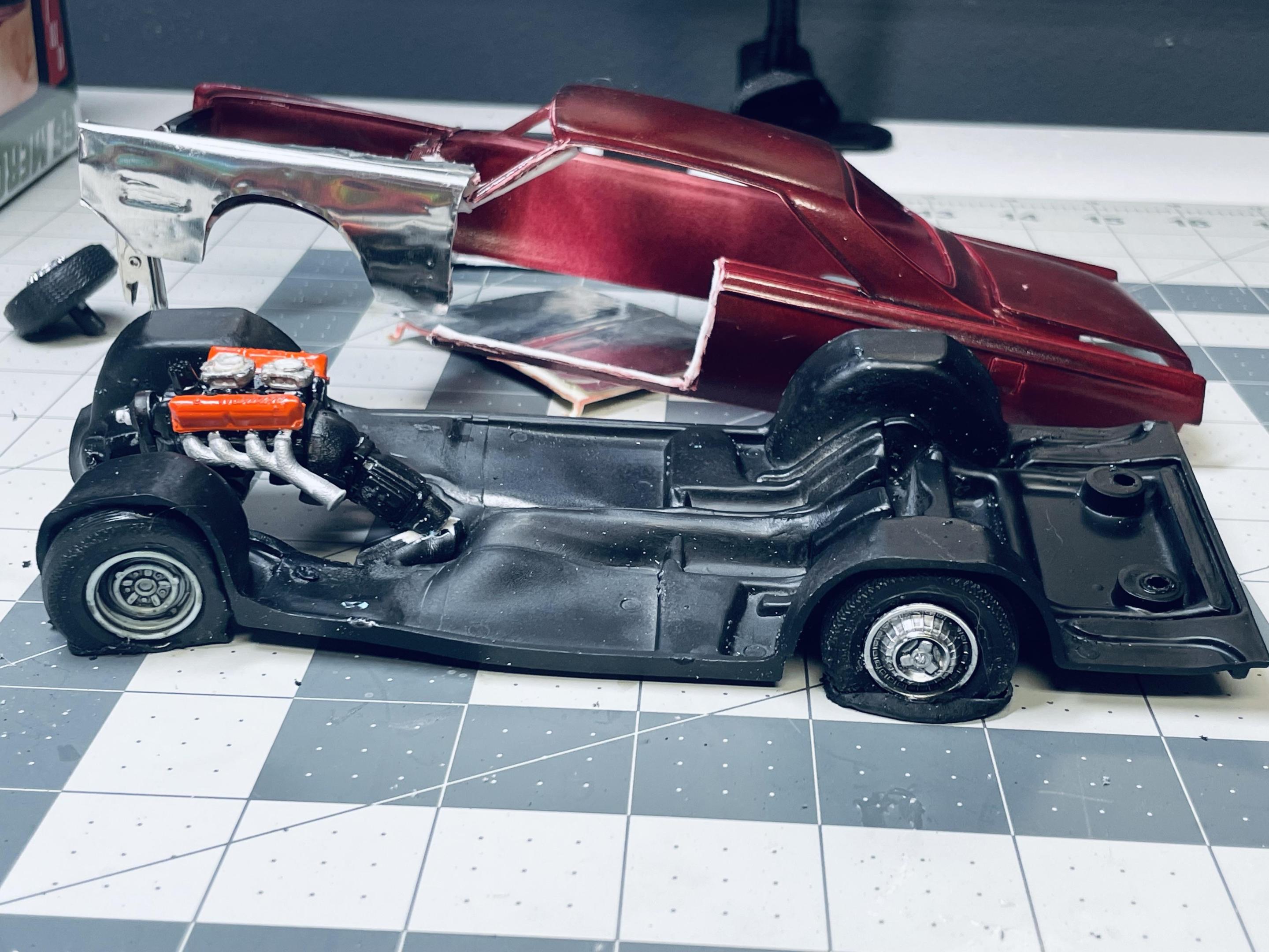

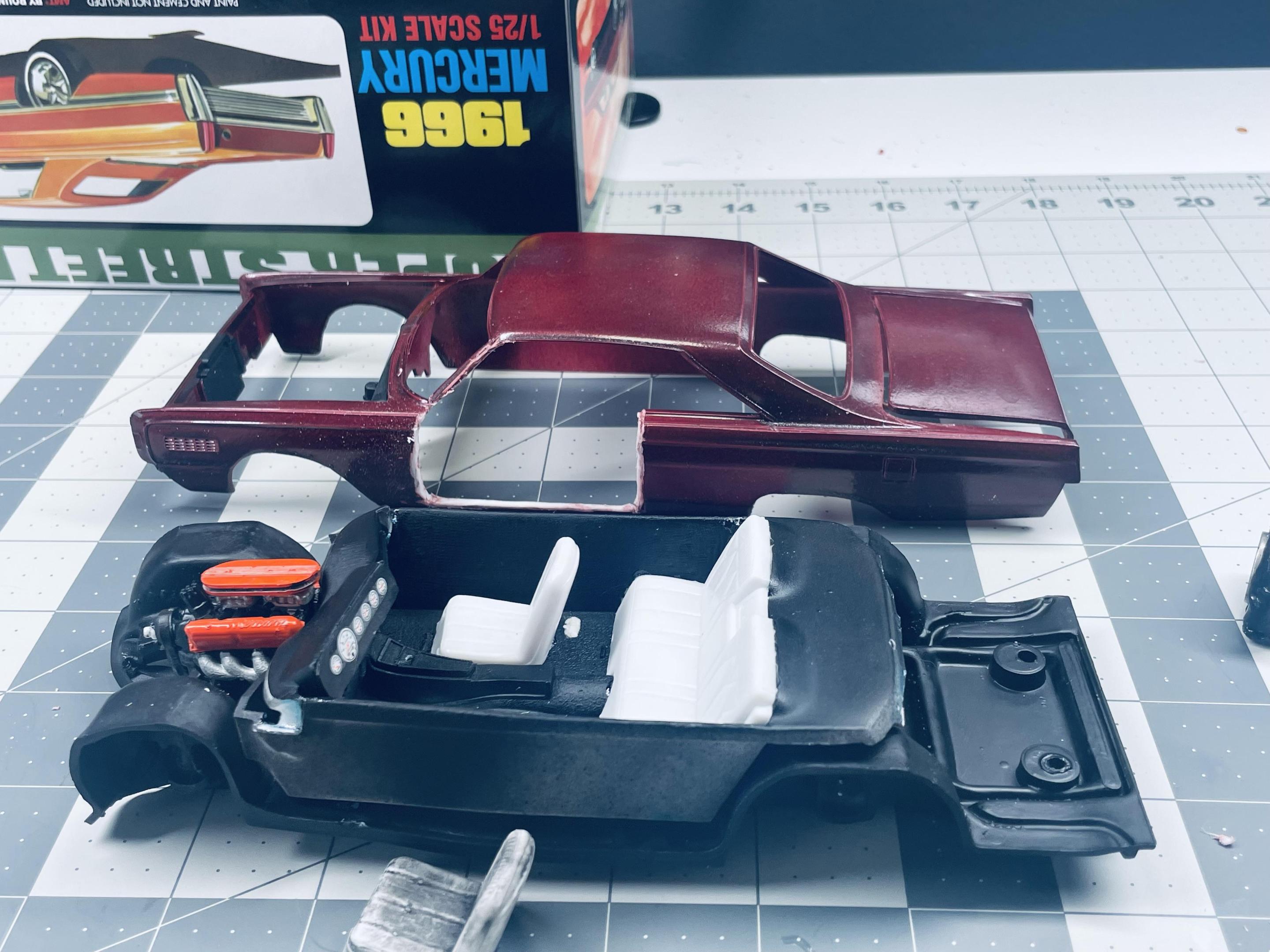

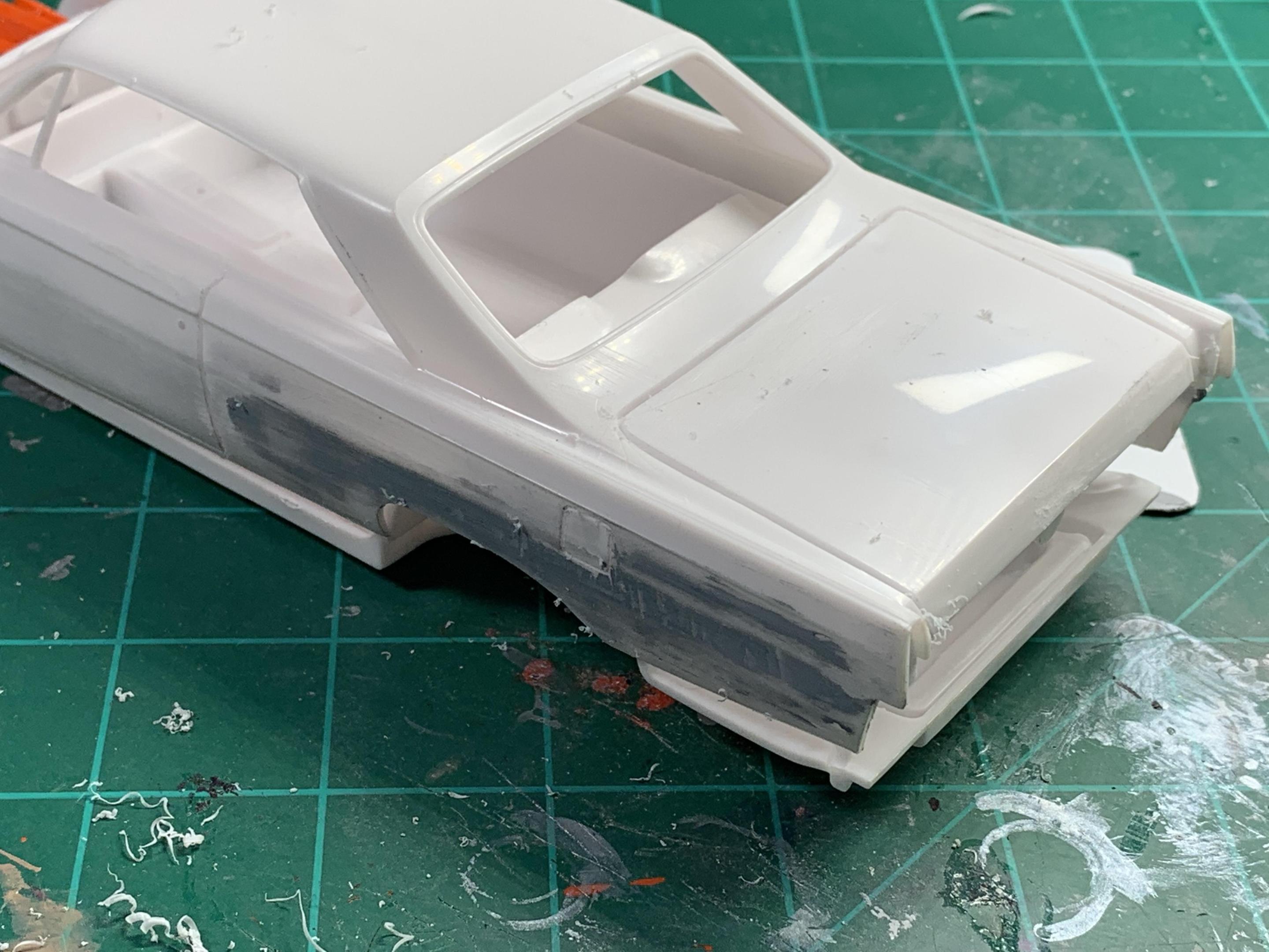

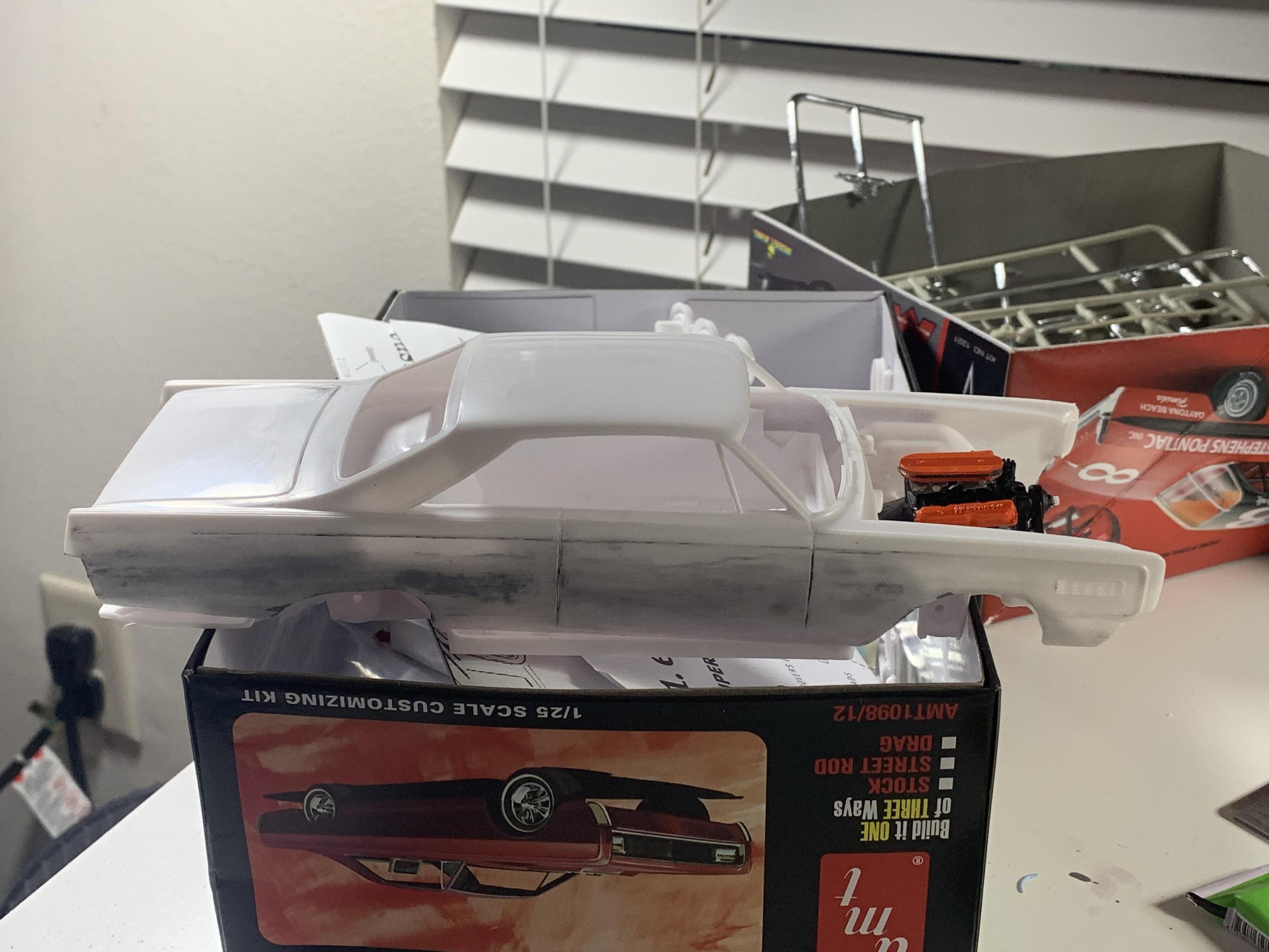

Hey y'all. I had a plan a couple of years ago to build some old o NASCAR replicas that I couldn't find in kits (https://www.shamblesmodels.com/race-cars-2.html). This 66 Merc is one that I started, messed it up with filler trying to get the 'trim' and emblems off, and decided to just wreck it. So, It's got the race car dash, but the rest is gonna be pretty stock when it slams into that tree. I've had pretty good results using thick gauge aluminum foil over the 'crashed' model panels, but it's tedious. I've reinforced the A pillar so I can buckle the roof a little. The skinny parts on a model have a tendency to shrink or all but disappear when heated along with the larger panels. After years of experimenting on flat tires, I've found that a hot plate works pretty good. It'll stink up the house and set off the smoke alarms, so I do it in my vented paint booth. Remove the wheel from the tire and insert a 7/16" socket. That way, the inside of the tire and the plastic wheel stay round. I keep some aftermarket 'steel' wheels to replace the chrome wheel when the hub caps fly off in the wreck. I use a 1/4" drive socket extension for the 'tree'. I'll add new photos as the wreck progresses. .

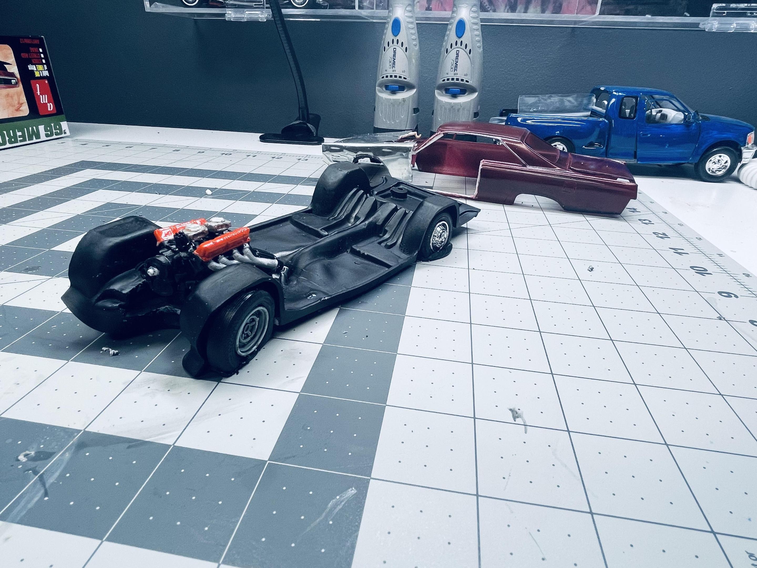

Here's a Chevelle wreck in progress that will be added to the salvage yard soon... just a few more details. This was a decently built model I found on eBay. It was coming apart, but all there and priced right. When I took it apart to begin wrecking it, I noticed that it had been built from two kits.... one red, one blue.

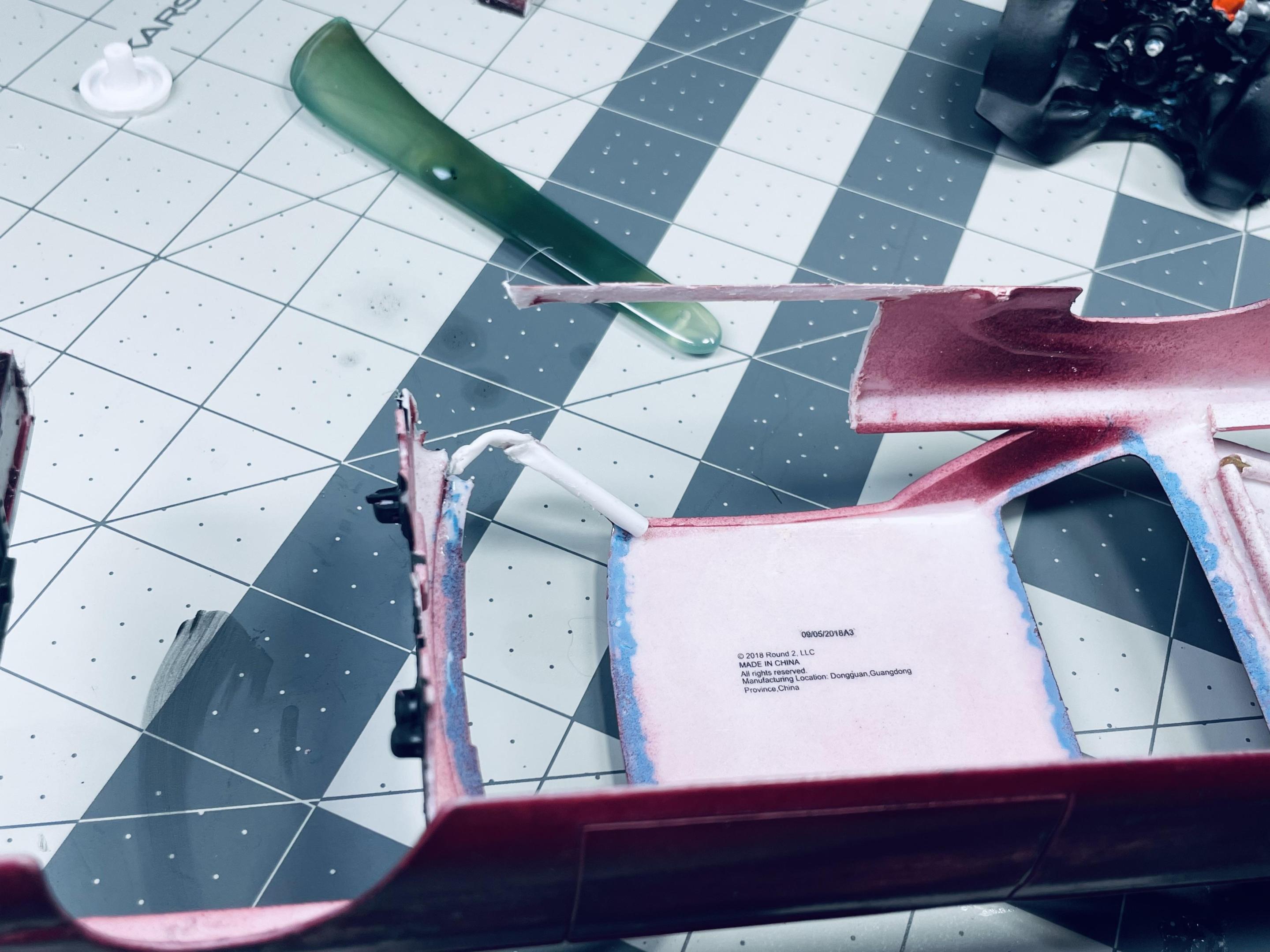

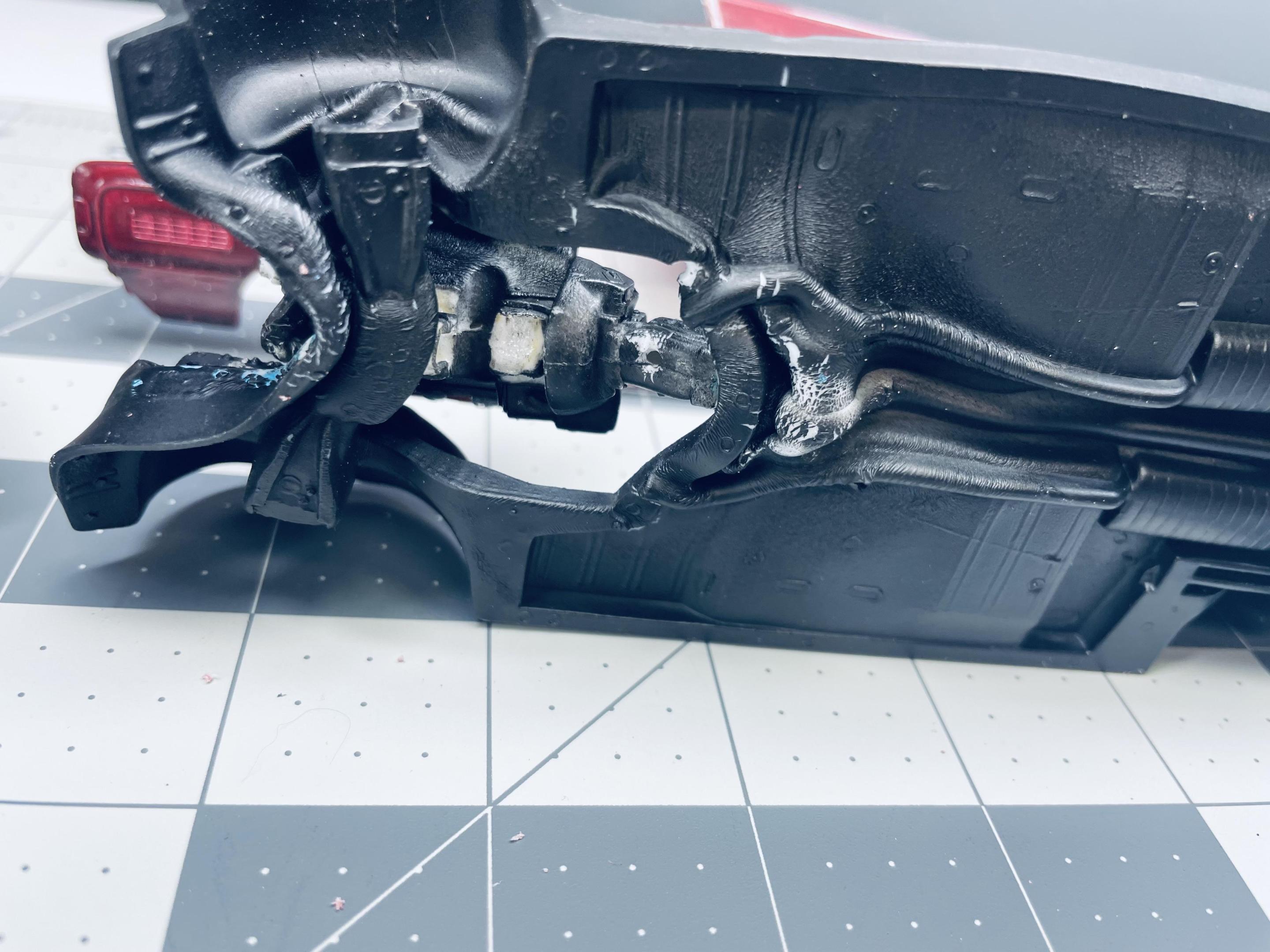

I guess I'm getting a little carried away with the details, but hey, it's a challenge. Here's one I'm working on now. It was a fairly well-built model I bought on eBay. I've completely disassembled it, and building the wreck from the inside out.
