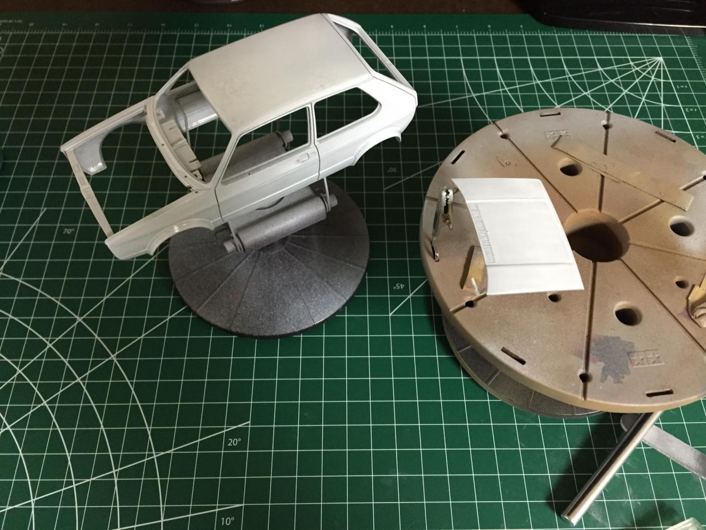

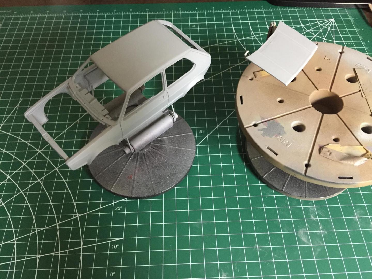

  1. I am still planning to finish the Rabbit. This Summer has been crazy, I even got married. I dragged the Rabbit back out and got to work. I had four, yes four, failed paint jobs. I tried tan, brown, gun metal, and silver leaf. All were either horribly orange peeled, or would drink the clear coat. I discovered putting clear over Tamiya flat paint won't add any gloss. I put the Rabbit in primer for the fifth time. I then shot a light coat of Tamiya Pure White. There are of course some flaws, but I'm tempted to just leave them. I'm not sure how many more times I want to try and paint this thing.
