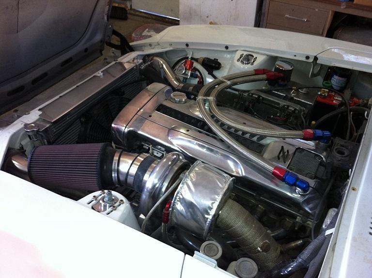

Profile Information

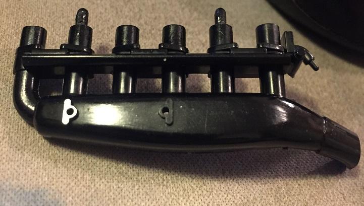

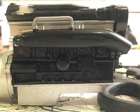

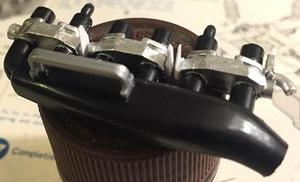

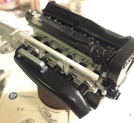

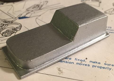

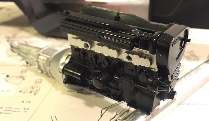

  1. little update. Oil pan is complete aside from drain plug and bolts The manifold that comes with the kit has less than ideal details, a merged throttle bodies/fuel rail/block of ugly. So I chopped a bit off and got it down to the separate pairs of throttle bodies, added throttle linkage arms(that need some trimming) And a quick test fit with a fuel rail placed roughly for reference (actual car has an aftermarket fuel rail) working on injectors and mounts to get the fuel rail on permanently Valve cover needed some touch-up due to the slip of a knife while cutting off the factory/stock wiring loom box for the injectors Also received a confirmation email saying that my parts have been 3d printed and are on their way! should see them sometime this week.

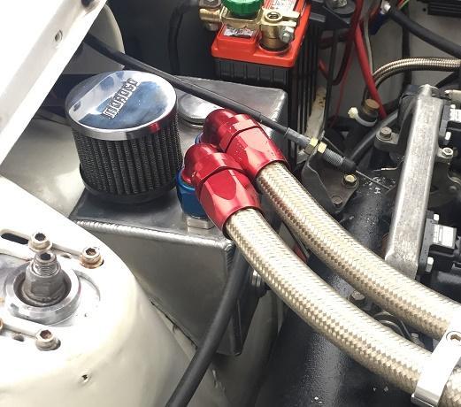

  2. Pretty much. The two tubes run to an external wastegate. It bleeds off exhaust gases to regulate the turbocharger RPM / Boost pressure.

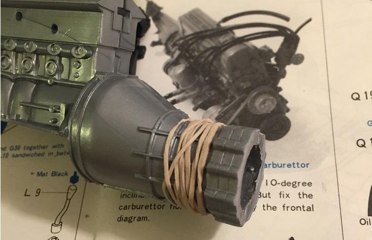

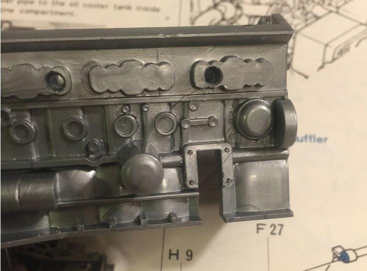

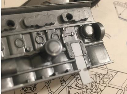

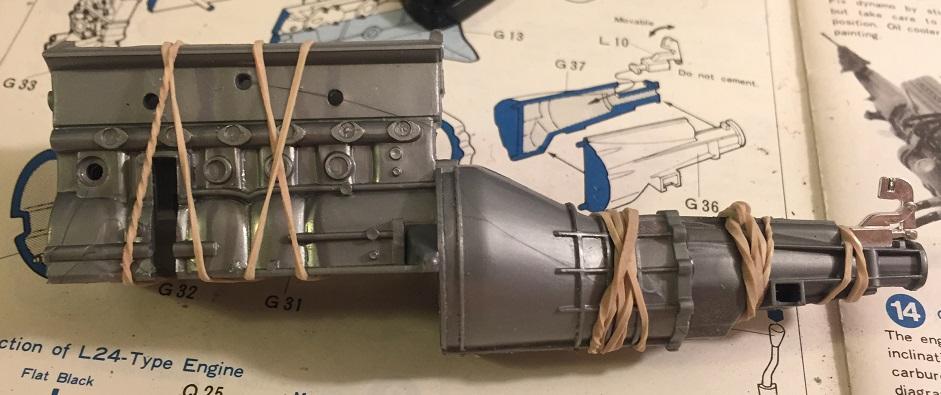

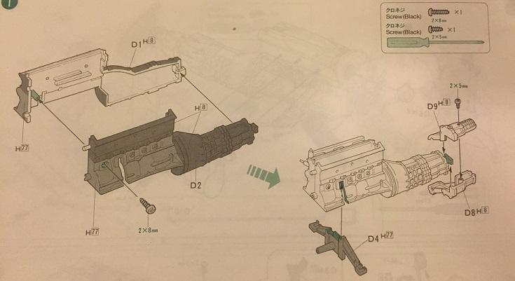

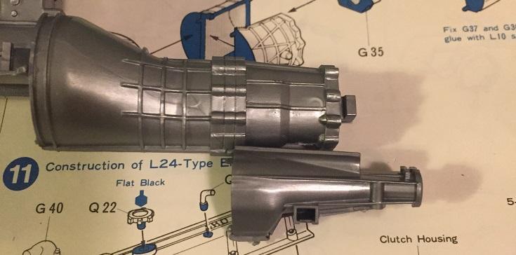

  3. So a small update of what I got up to yesterday: The engine from the skyline kit (along with majority of the car) is unfortunately a screw together kit, nothing glue and filler cant fix. As is, the transmission doesn't really work to well from the RB26 so some modifications were made. Its not 100% accurate, but spending 500+ on a 300ZX model just for the transmission is a tad out of the budget lol Factory engine mounts are useless for this build, so more filling and filling A touch of paint : And this evenings project, Rear sump oil pan to clear the subframe of the 240Z
  4. Here is the 1:1 Still waiting on him to decide if he is going to coat the valve covers black, would make things easier for the 1/12 lol

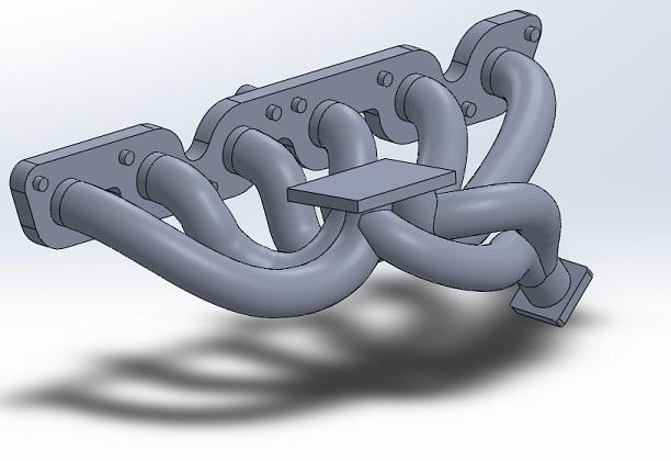

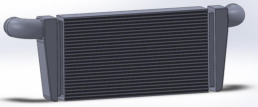

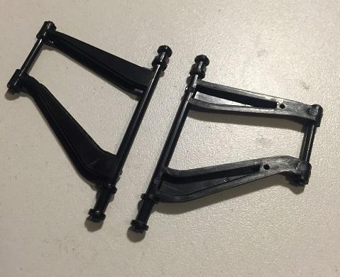

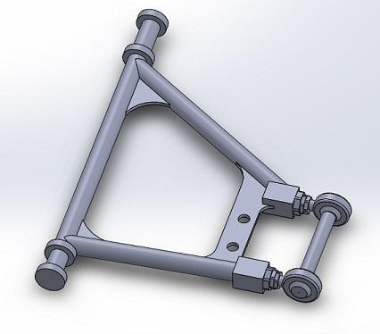

  5. Right now is the gathering reference material / parts stage. I have a few solids drawn up now for some of the components of the build which will be getting 3d printed. Single turbo conversion manifold for the RB26DETT - Based off the one used in the actual car, OBX manifold. Front lip Front mount intercooler lower control arms from the kit(left) to be replaced with the control arms on the right (Techno toy tuning LCA's) Hopefully will be placing an order in the next day or 2, excited to see how they turn out.

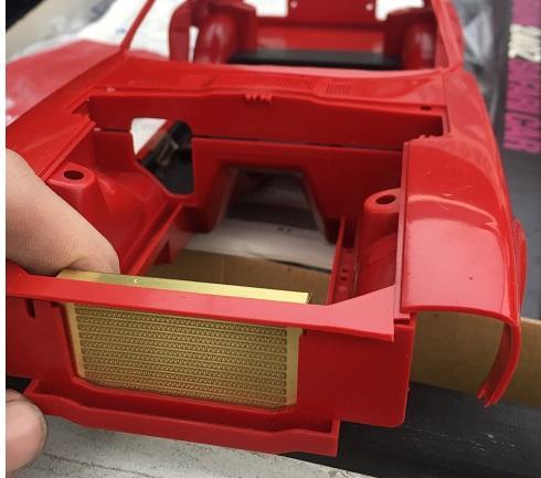

  6. Similar process for testing out the catch can/coolant reservoir.

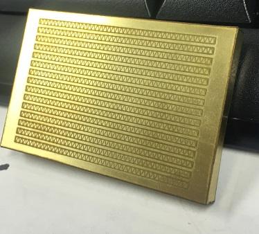

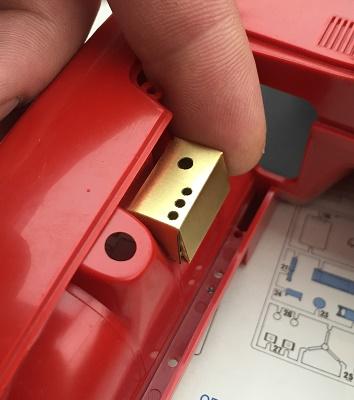

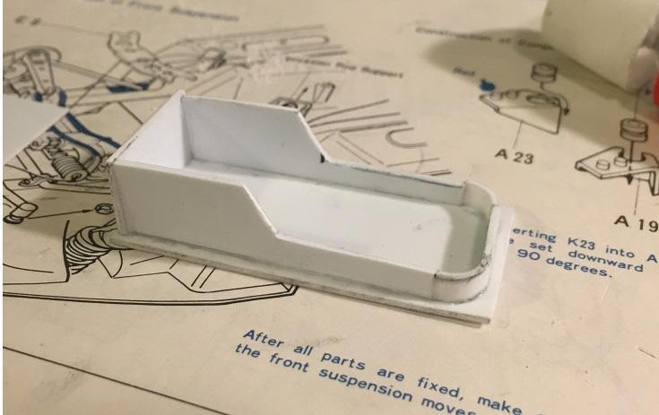

  7. Did some testing with the laser engraver to cut out a foldable template for building the radiator, Only had brass shim stock at the time, however got a good idea of how it may turn out using aluminum.

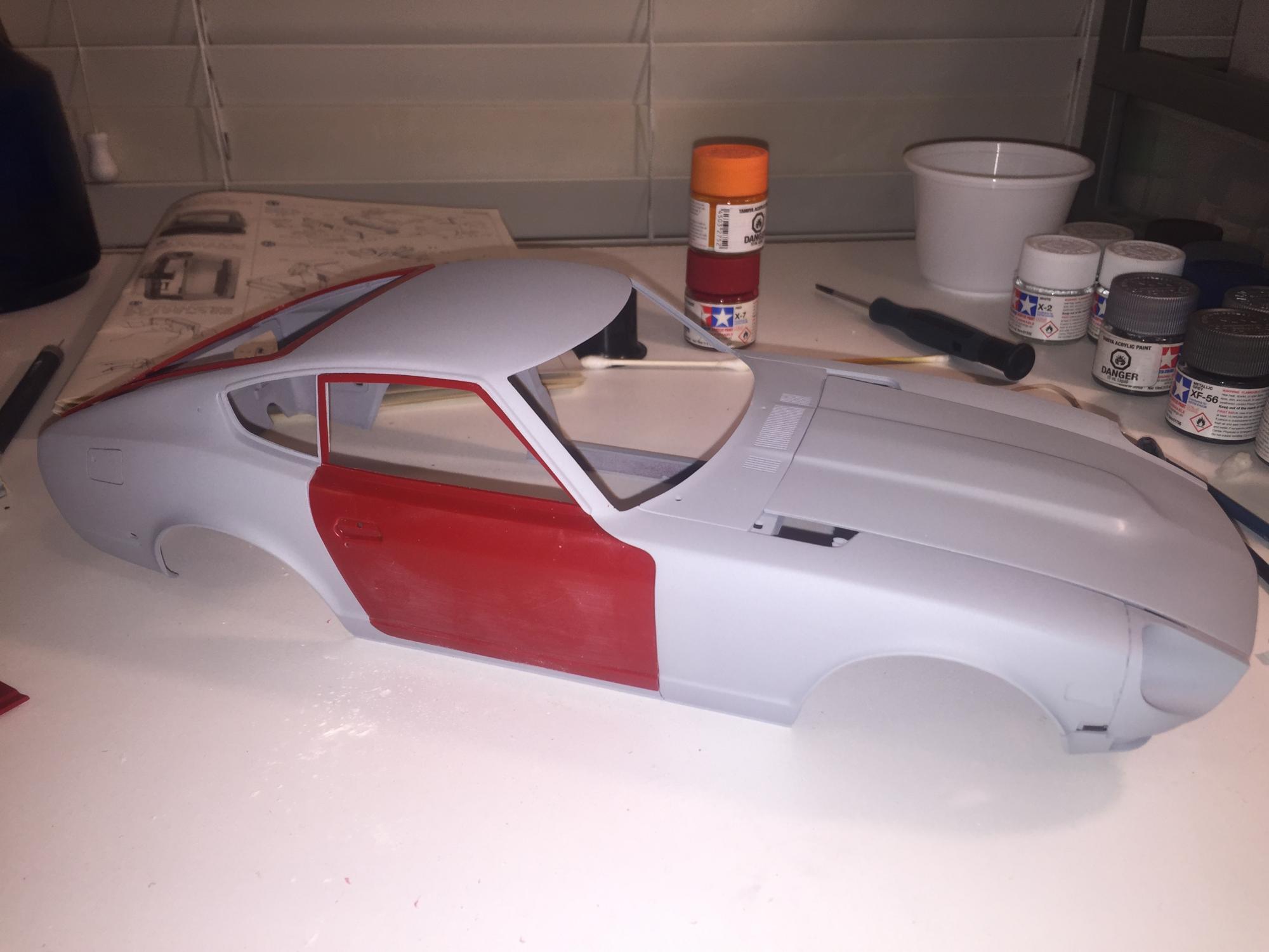

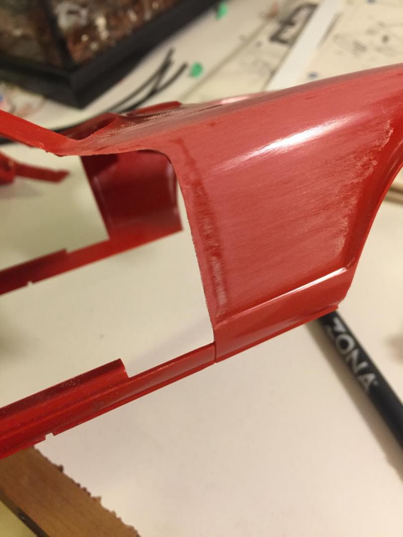

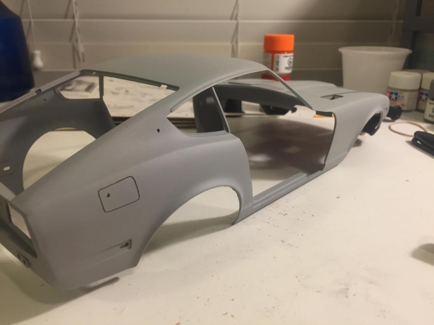

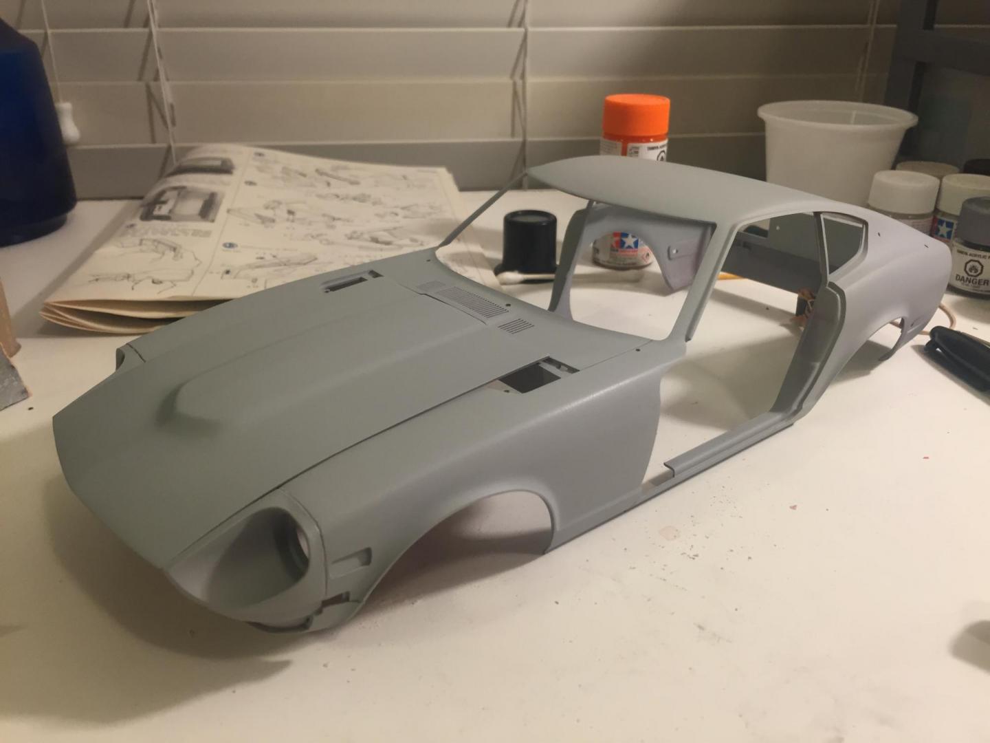

  8. It sucks how difficult & expensive some of these 1/12 kits are getting these days. The body was fairly decent, a few dips here and there that needed some TLC and filler. The safari car unfortunately came with some square holes in the hood and a raised section to mate to the rally lamps. That was filled and sanded out nicely. after some cleanup of the mold lines, defects etc. I got a few coats of primer on the main body. Test fitted the doors, they seem a bit tight and need a little cleaning up before primer. The fuel door was very faint(almost non existent in spots) and needed a good scribe to get some clean lines.

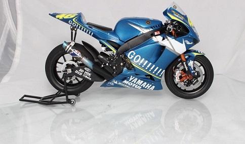

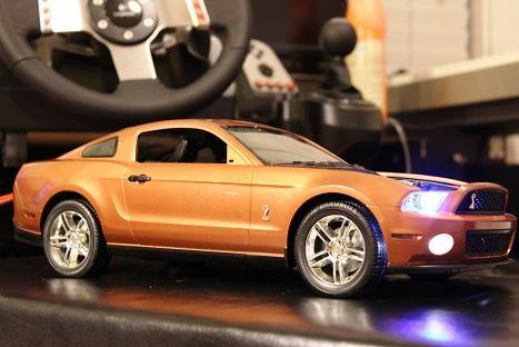

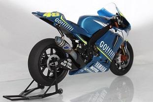

  10. Hello all, As a kid I used to enjoy building model cars (of course with questionable quality at that age) and have recently dove a bit deeper into the hobby. I have completed a few 1/12 MotoGP bikes, 1/12 Revell mustang, 1/12 F2002 F1, and assorted 1/24's Started browsing on the forums and finally decided I would take a minute and say hi. My current projects: Tamiya rally 1/12 240Z replica of a coworkers car, including a RB26DET engine sourced from a 1/12 fujimi Reebok skyline. 1/12 reebok skyline drift car, missing engine due to above project, LS1 V8 will be put in place I will be posting up some details on the 240Z build as this will be a fun project trying to replicate an existing car. Few of my previous models:
