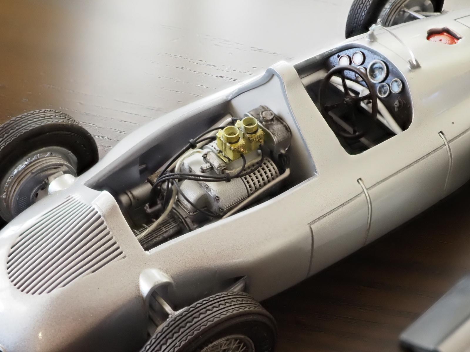

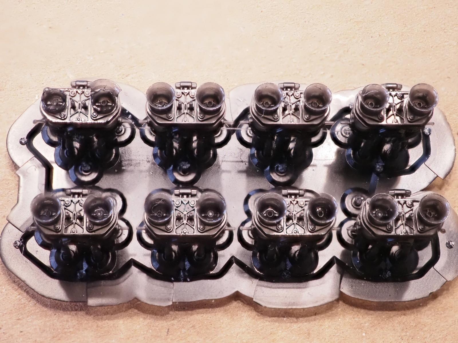

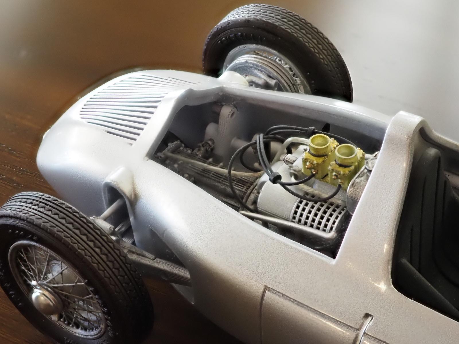

I've been experimenting with a new 3D printer the as very high resolution. The printer, an Anycubic M5s Pro, has a pixel density of 1412 pixels per square inch. My old printer, a mono X has a ppi of only 508. There are lots of controversy of the value of more pixels, with folks saying that the individual pixels are only about .02mm in size, smaller than a human hair, just too small to be seen. Well my testing shows that more pixels do matter. Take a look at these 1/24 scale Weber carbs. These were done with the high res printer and they are phenomenal. Dame near perfect. Read the Weber type! These make my past webers, used on some of my best models look crude.

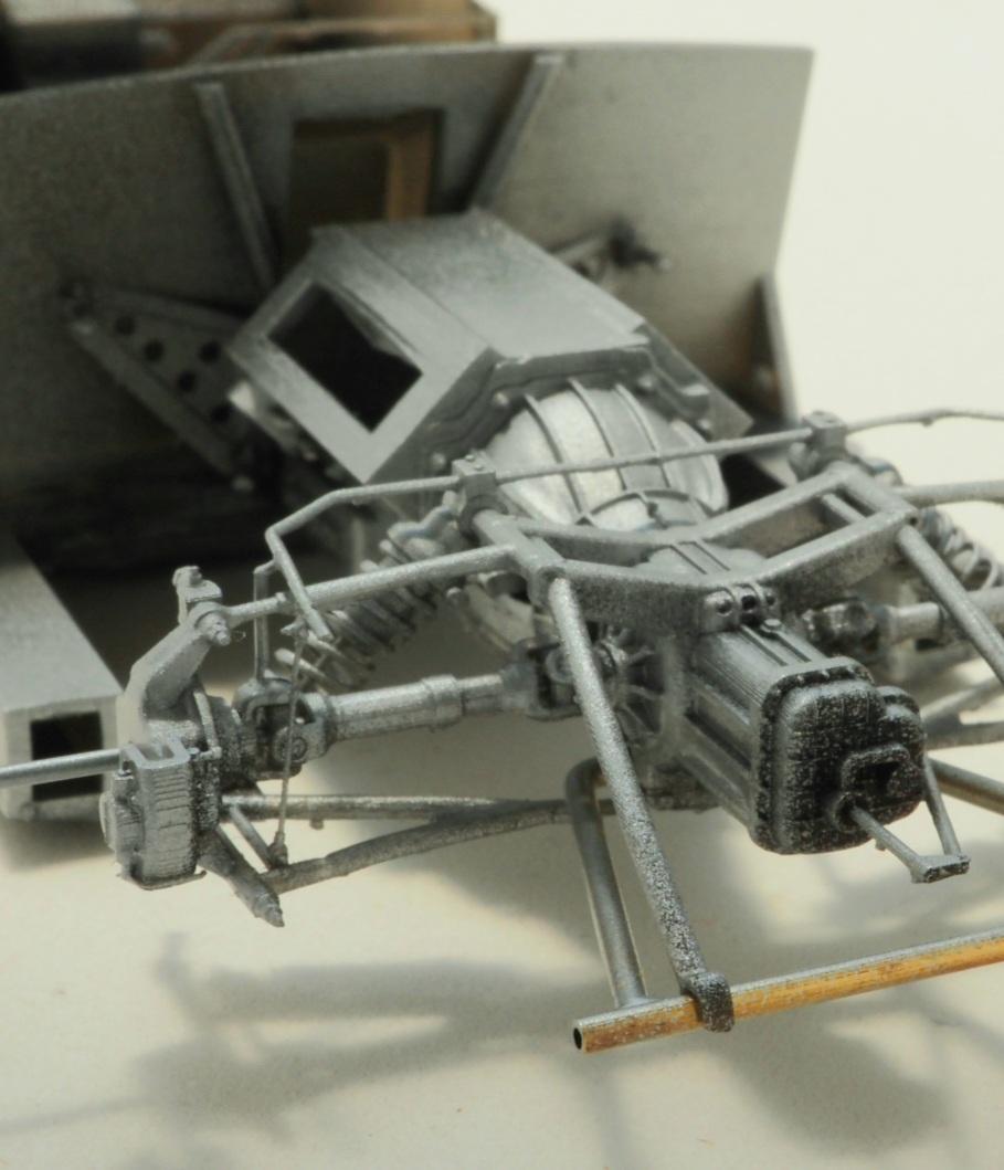

Here is a print of the chassis. It is all printed in a single piece except for the tubular brass support for the rear body section. Although all of this CAN be printed in a single piece, in the long run it makes sense to print components like the coil over shocks as separate pieces so they may be optimised in printing and more easily painted.

This project was very difficult for me. I just couldn't get the body to a satisfactory look, and I couldn't figure how to support the rear body section when it flips open. The body was revised at least 10 times, and the body opening was solved with a soldered brass support the mates with the resin structure. The P70 is now cruising forward with almost all parts printing and working well.

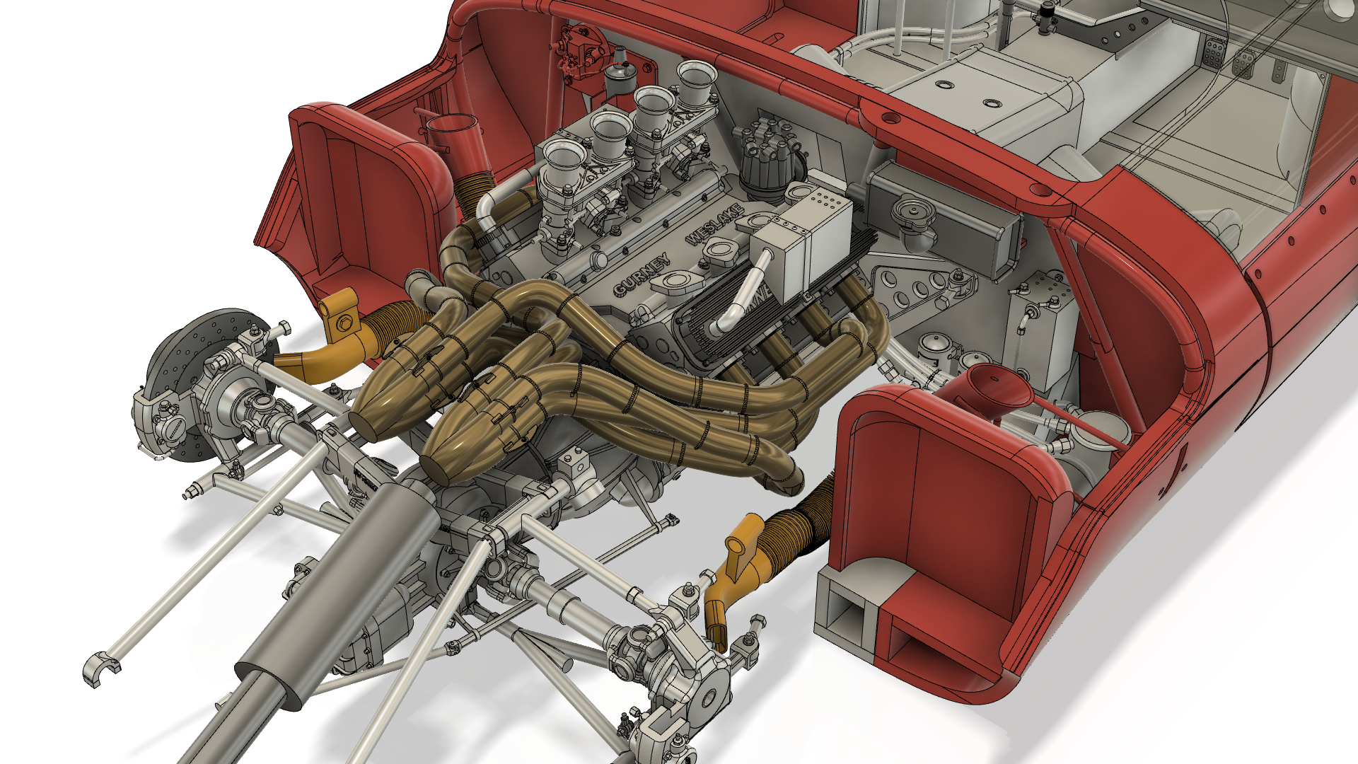

Yes, as one of my drawings shows, it will have a flip open tail section and full engine and suspension detail.

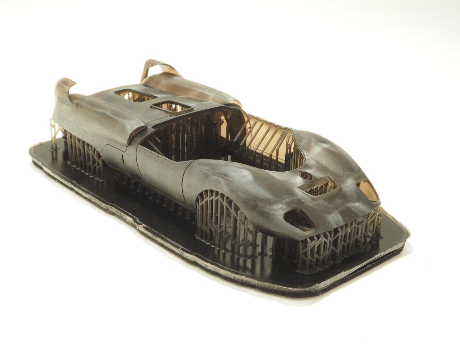

With the supports removed, the body looks pretty good. The resin is semi transparent, but the body is quite thin as well. I keep my 1/24 scale car bodies 1mm thick.
Here is a print of the body. The resin is Anycubic ABS like resin. Very impact resistant. As strong as normal kit styrene.

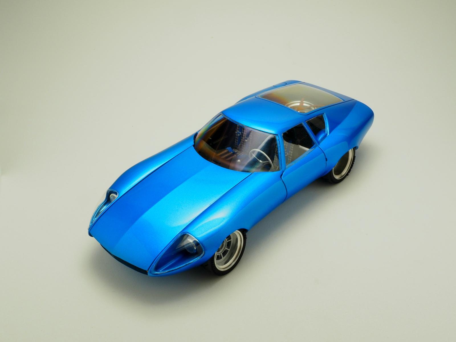

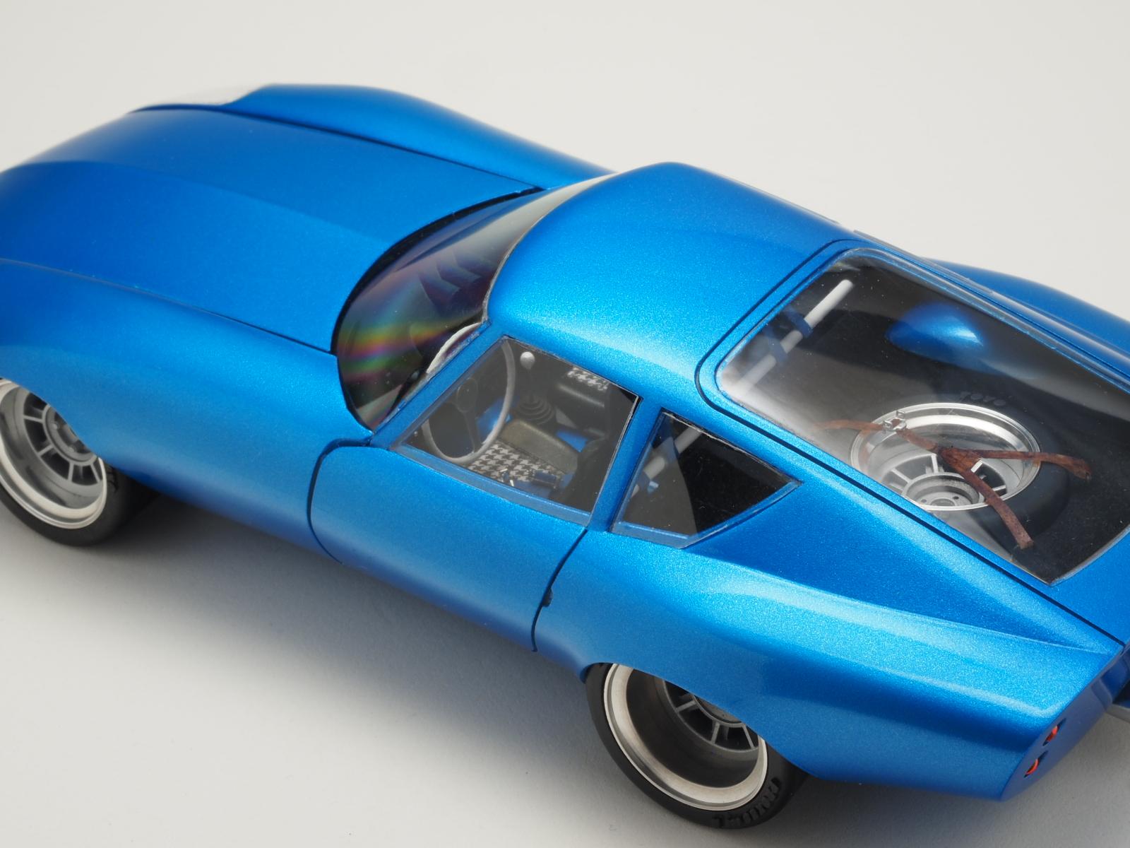

This is my latest design fot the car. It's certainly not perfect, but I believe it's pretty darn close. It's also a printable and buildable model.
This build is several years old. 1/24 scale, designed in Fusion 360 and resin printed on an Anycubic Mono X printer.

This is my earliest attempt at the bodywork. This is a Fusion 360 drawing and it really needed a lot of work.
I'm pretty deep into a 1/24 design on this famous car. It has been on and off the workbench for about 4 years. The difficulty in capturing the complex shape and figuring how to make a workable/buildable model have stopped me cold several times.
