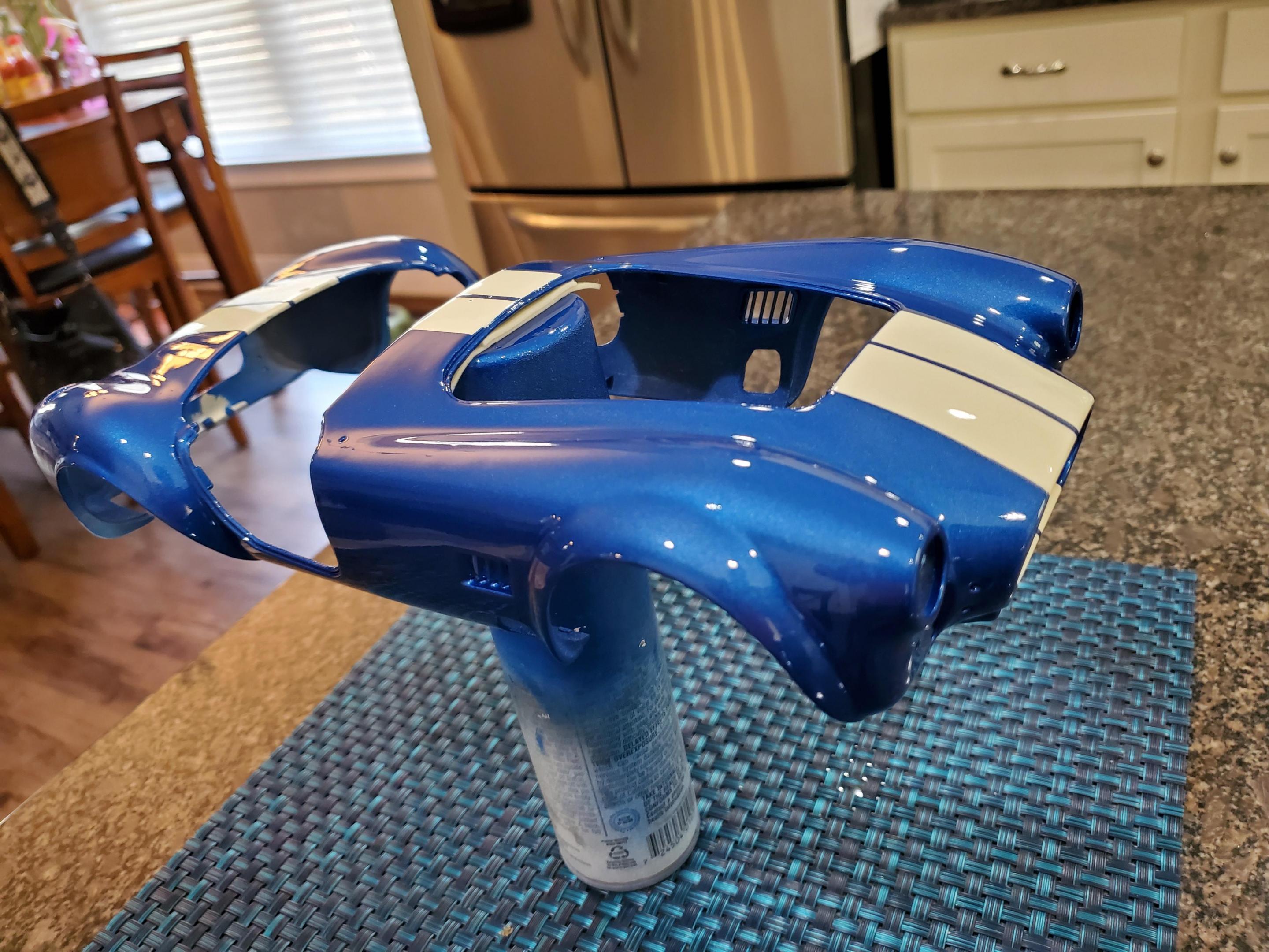

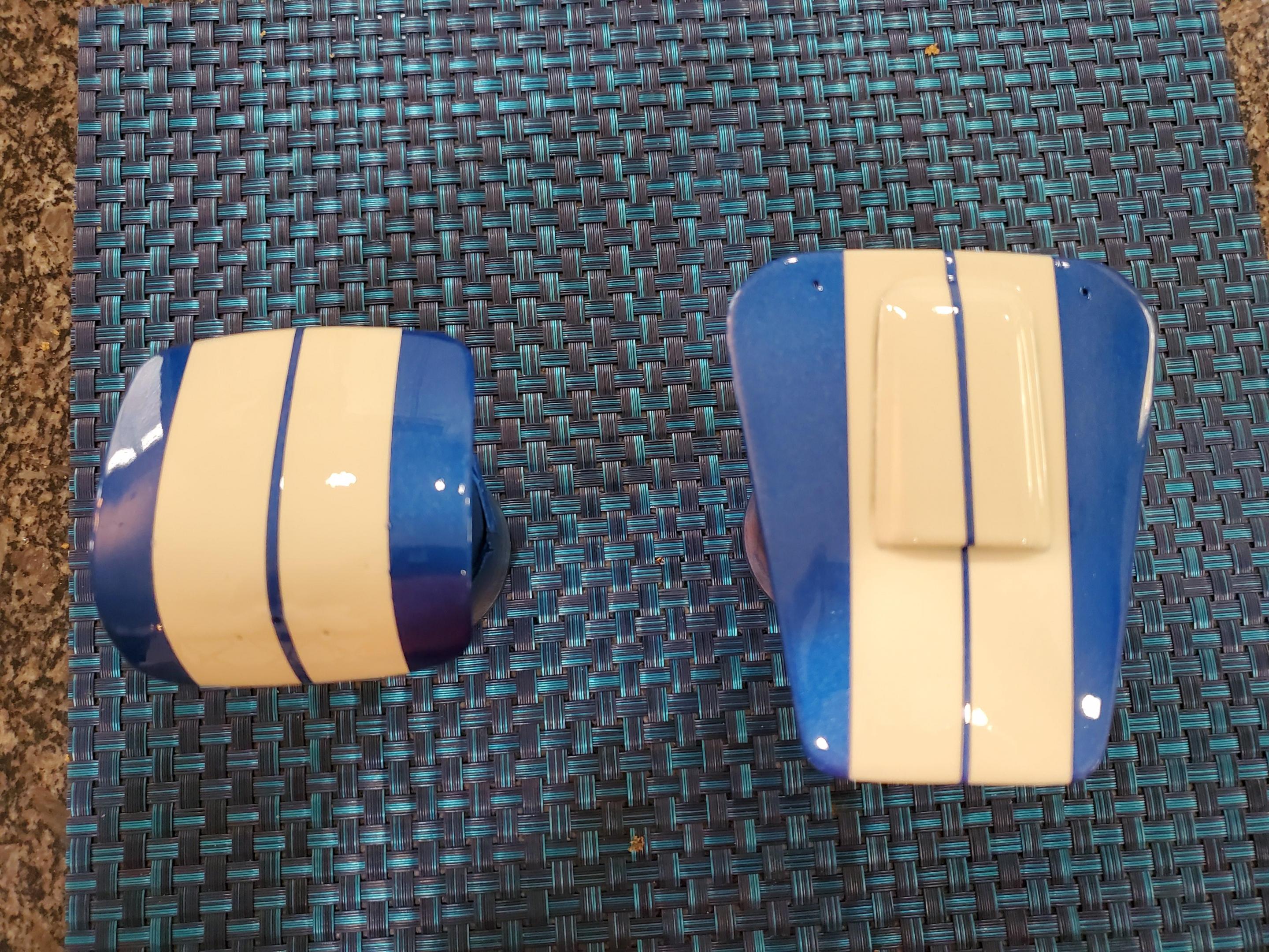

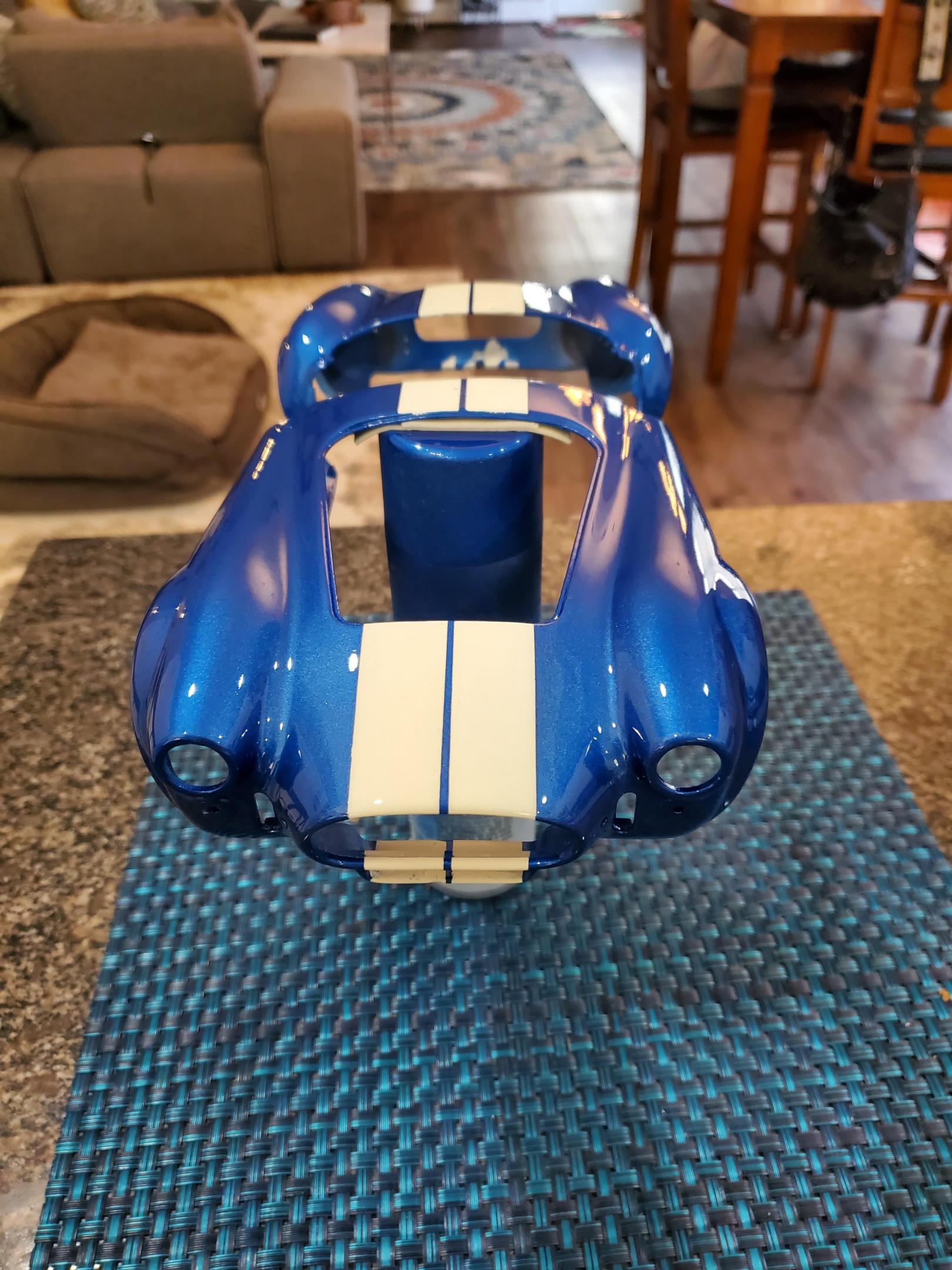

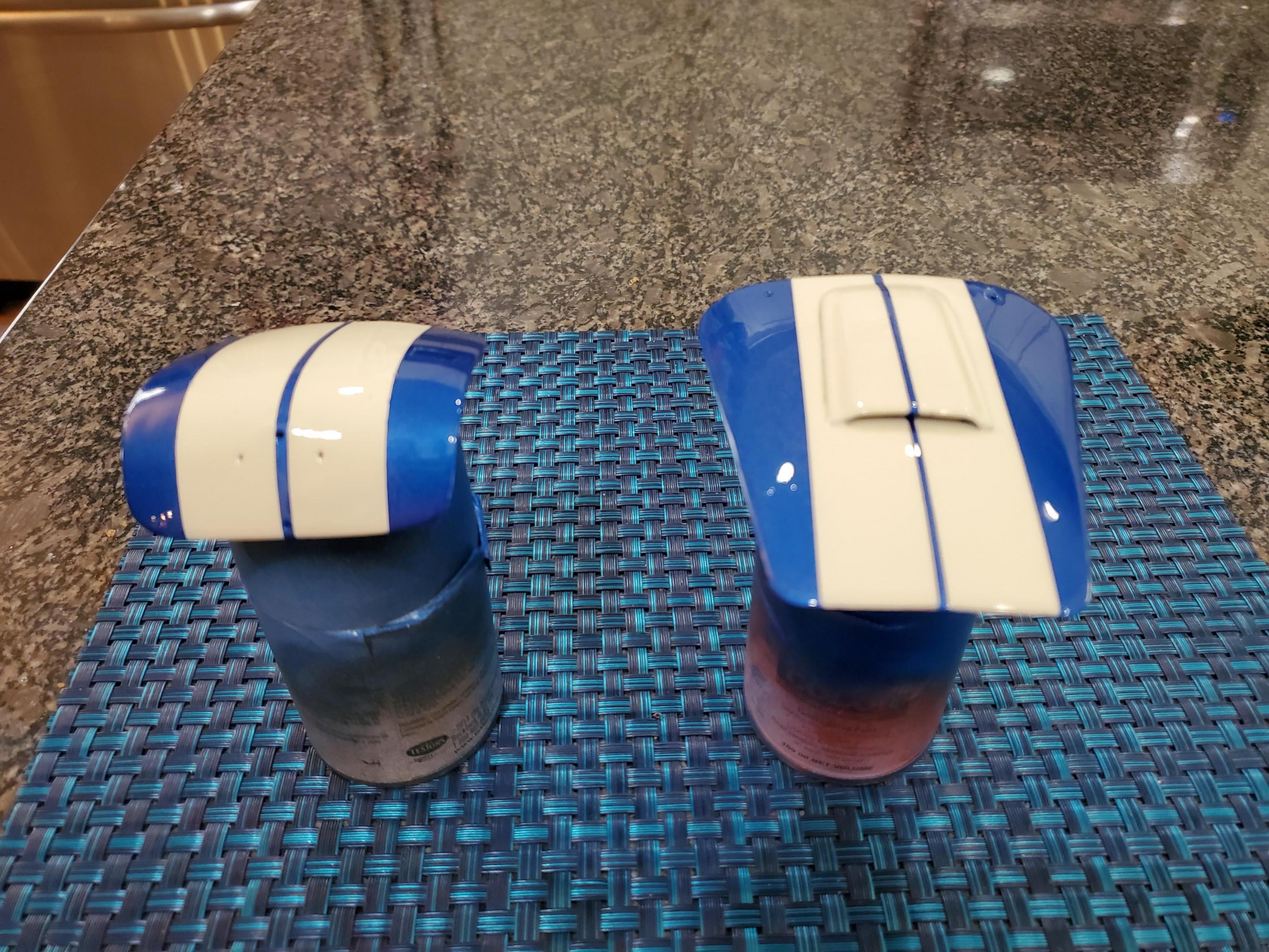

Thank you for your kind words, my friend. I agree completely - Tamiya is best bang for the buck and out-of-the-box fitment, but MFH is the best when it comes to accuracy and detail. They require a lot of finessing, but it's worth it! So, thanks for tip on the clear tape. I just ordered two rolls for myself. The headlight lenses on the Ferrari look perfect! You can't tell at all. I just finished spraying clear for the final time. Here are some pics of that - I have not yet started to wet sand and polish, but that will be next. The stripes look more yellow in the pictures than in real life. They are Tamiya Racing White which is an off-white/ivory shade.
