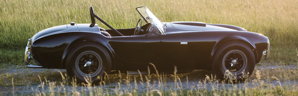

  • Full Name

  2. My intent would be to build the car sans any top just like the first photo of CSX 2075.

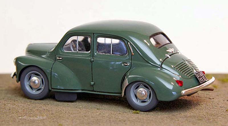

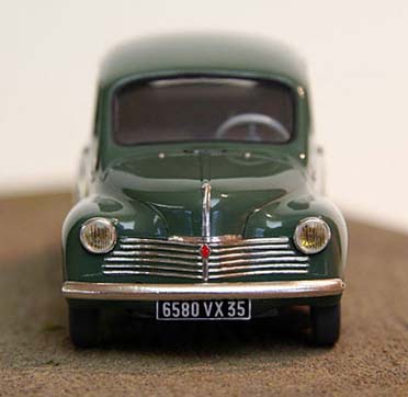

  3. I've seen the Monogram Ultimate Cobra and agree it is beautiful. The '67 Corvette 427 convertible from that series is also really nice. I actually do build 1:43 cars. This is my Heller Renault 4CV from awhile back. Most of those Heller 1:43 car kits are actually quite nice - well engineered and with very 'scale' detailing. They're quite buildable, as long as you're patient and willing to pin joints and such. Nothing French is 'shake-n-bake' Tamigawa easy. Stay away from their Renault R30 TS though. Yes, I do like those older, obscure European models. ?

  7. This is the best tire photo I've found for CSX 2075. The tire is a "STX 70", so a General Grabber. Not sure as to its width? I do know that the original Cobra wheels were all 15" and that Cobras all had 4 wheel disc brakes.

  9. Hope I'm posting this in the right place? I have an original, mid 60's issue of AMT's early Cobra (kit #2170-150) that I'd like to build into a narrow body, non side pipe 289 street Cobra similar to this car, CSX 2075. This build isn't at the head of my que at this point and I'm just doing initial research right now as I've never built a Cobra before. My kit is complete and has blackwall Firestone Supreme tires in the box? The Firestone tires don't look right for a Cobra and seem more suited to a Galaxie or other non-sports car. My questions: What are the wheels on CSX 2075 above considered? I've also looked over the kits stock alloy wheels, which I think are 'Kidney Beans'? Are the kit version considered accurate? If so, what is my best source for 4 correctly sized tires to use with them? Any other things that I should acquire to make it more accurate? The kits exhaust headers don't look right and so will be replaced. The headlight bezels also look wrong.. TIA Andrew
