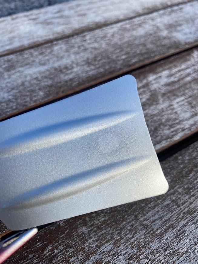

  7. Hi there - Looking for some quick advice on a build I am working on. I have painted the bonnet of my 300sl Merc but noticed a big black hair in the model of it. Grrr. I sanded out the hair with around 1500 grit which perhaps was a bit too much. Anyway it has left a blemish in the paint (see attached photo). I had thought it was because I went through the clear coat in that section so sprayed two coast of the primary color with a plan to the lay down some more clear coat and thus restore the "level" of the paint. Unfortunately it doesn't seem to be going away - And I'm worried I spraying more will be a bit futile. Is there anyway to repair this or should I just strip and repaint? Thanks in advance, Andy
