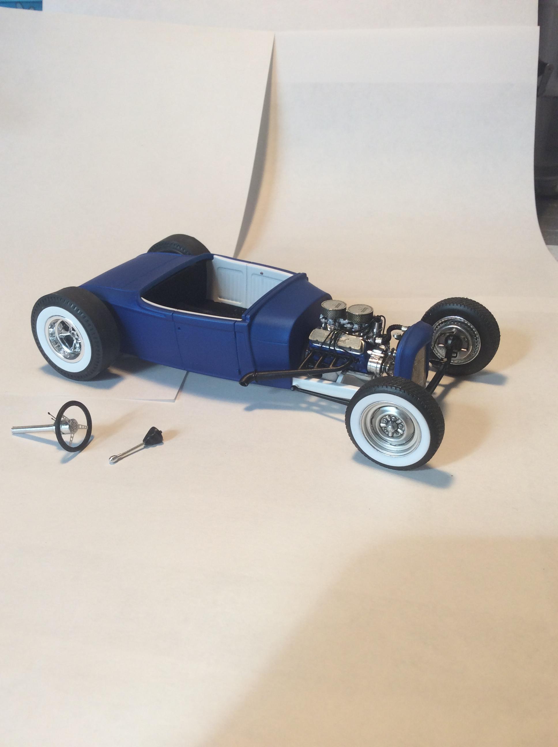

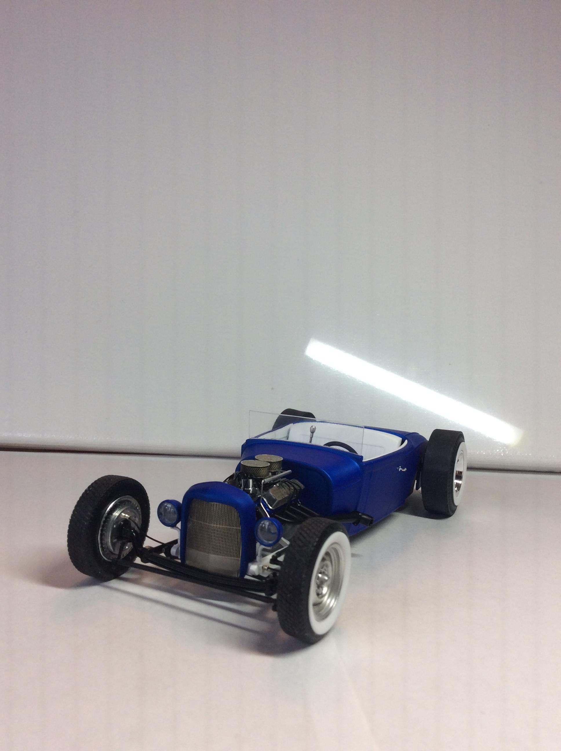

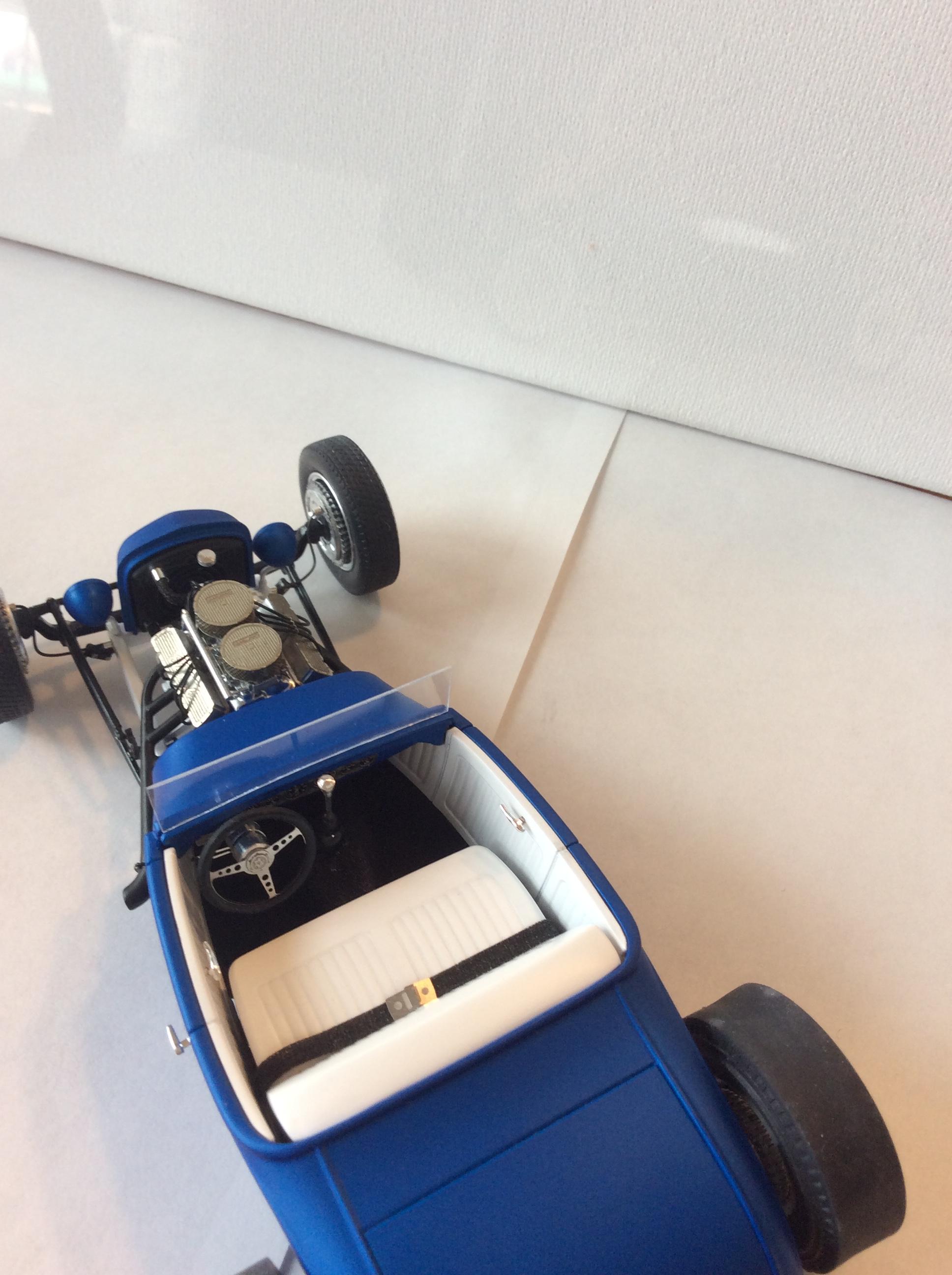

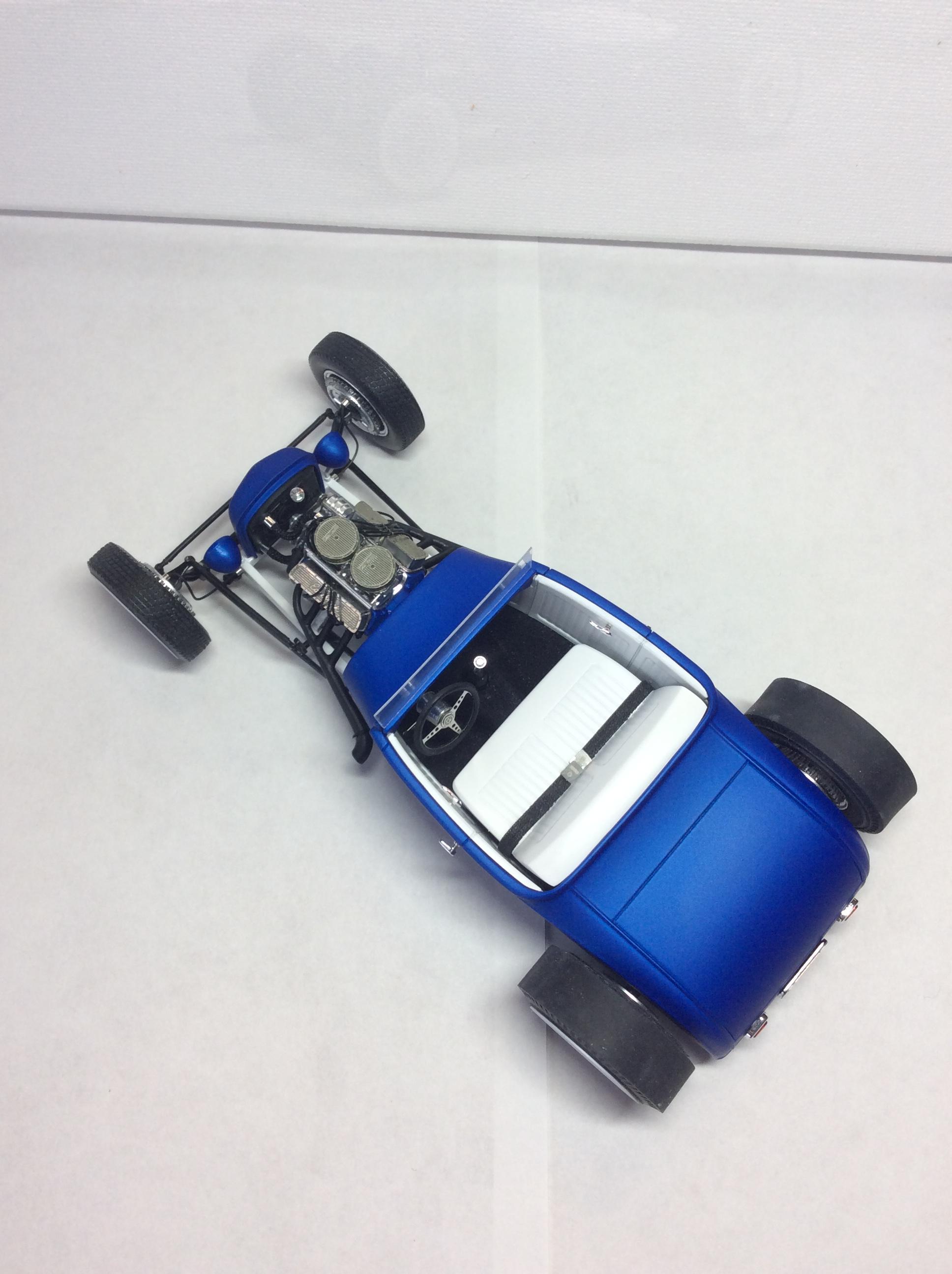

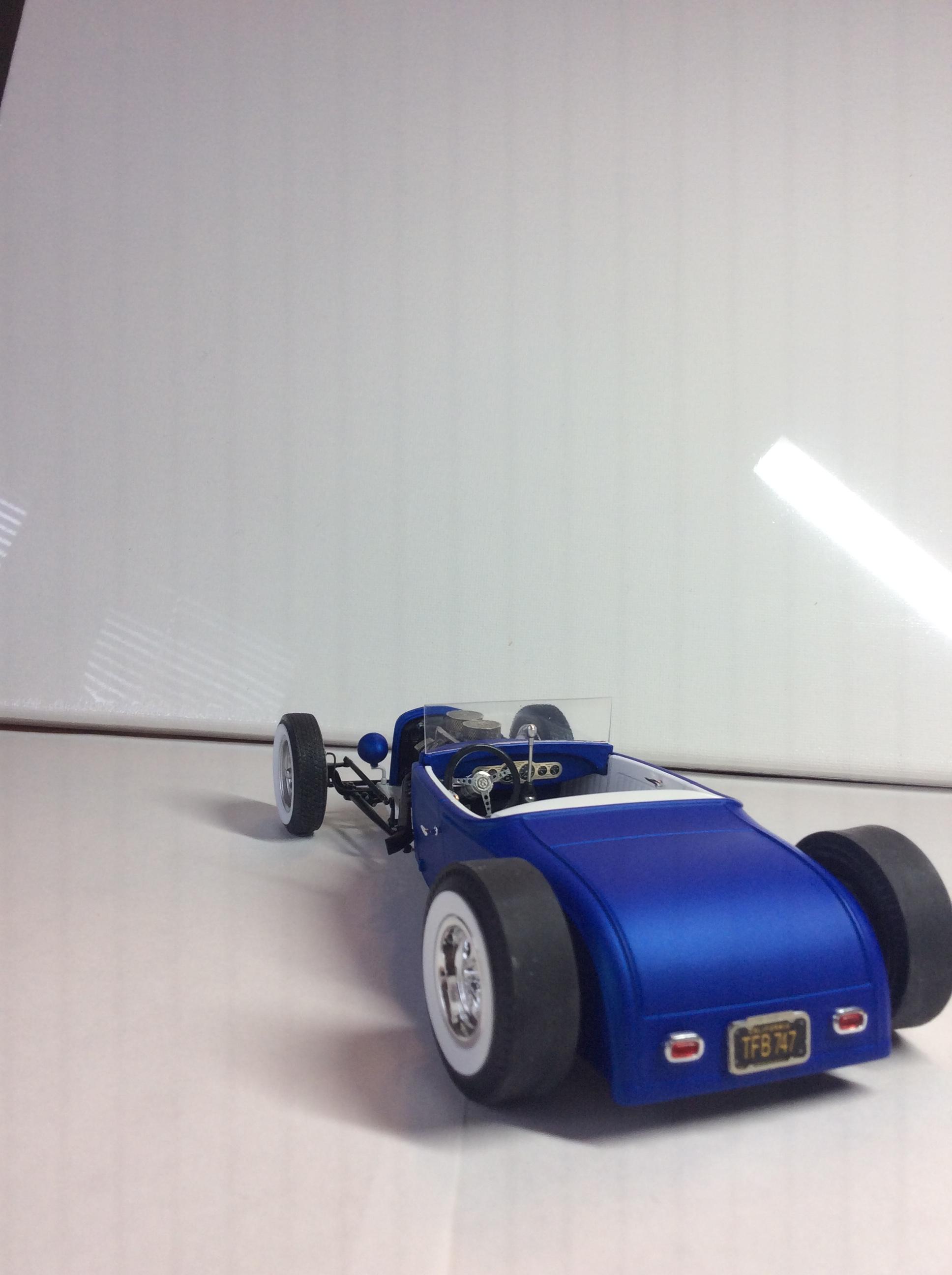

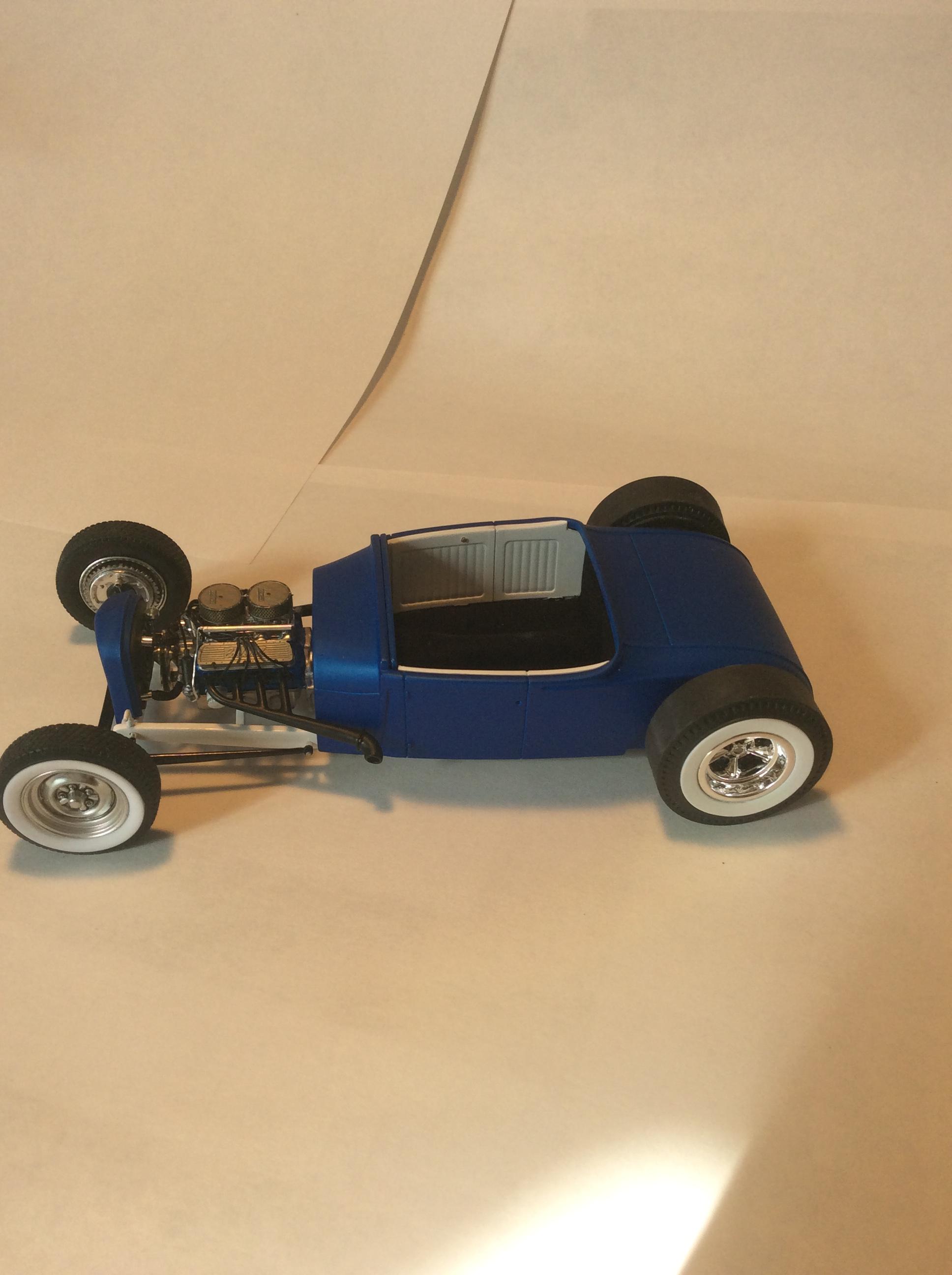

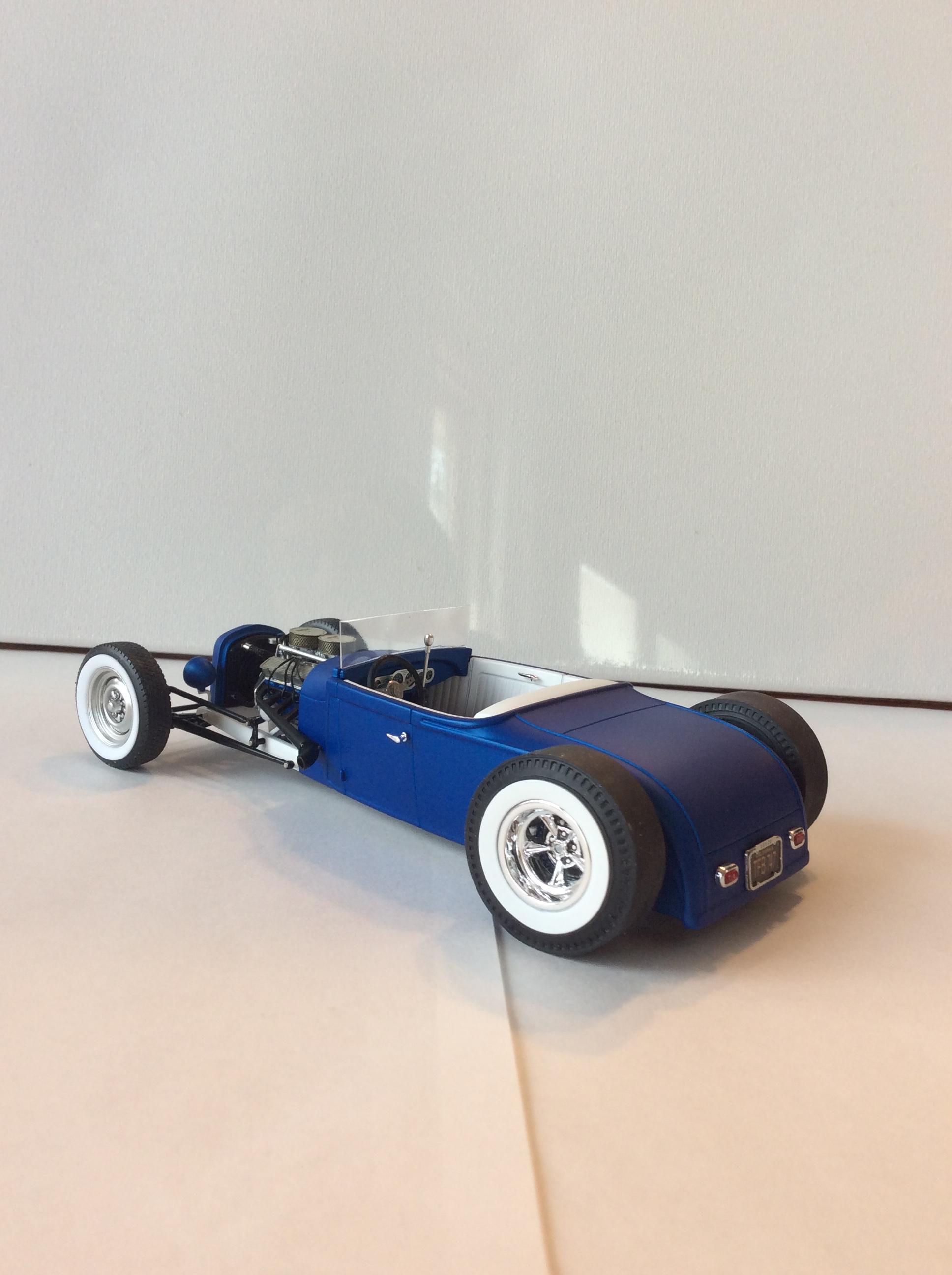

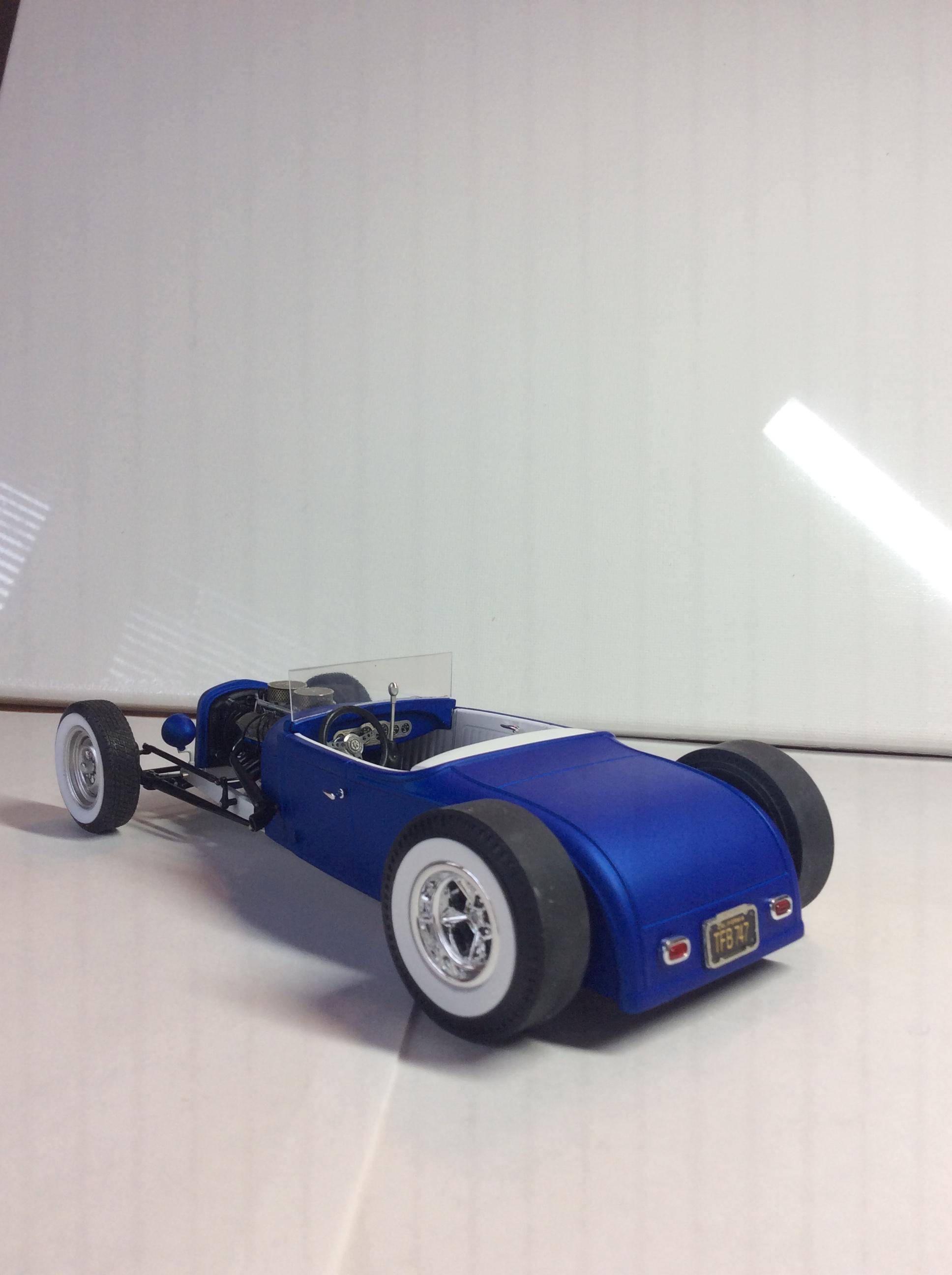

  1. Calling this one done..........One mistake is the windshield frame. It was so warped that it was unusable. I should have glued it in place before painting the body. I was forced to think of other options but in the end the only thing I could think of was a frameless windshield. The second mistake is the painting flaw on the seat. I ended up covering it with the seatbelt. Great kit I will be building more of these kits.

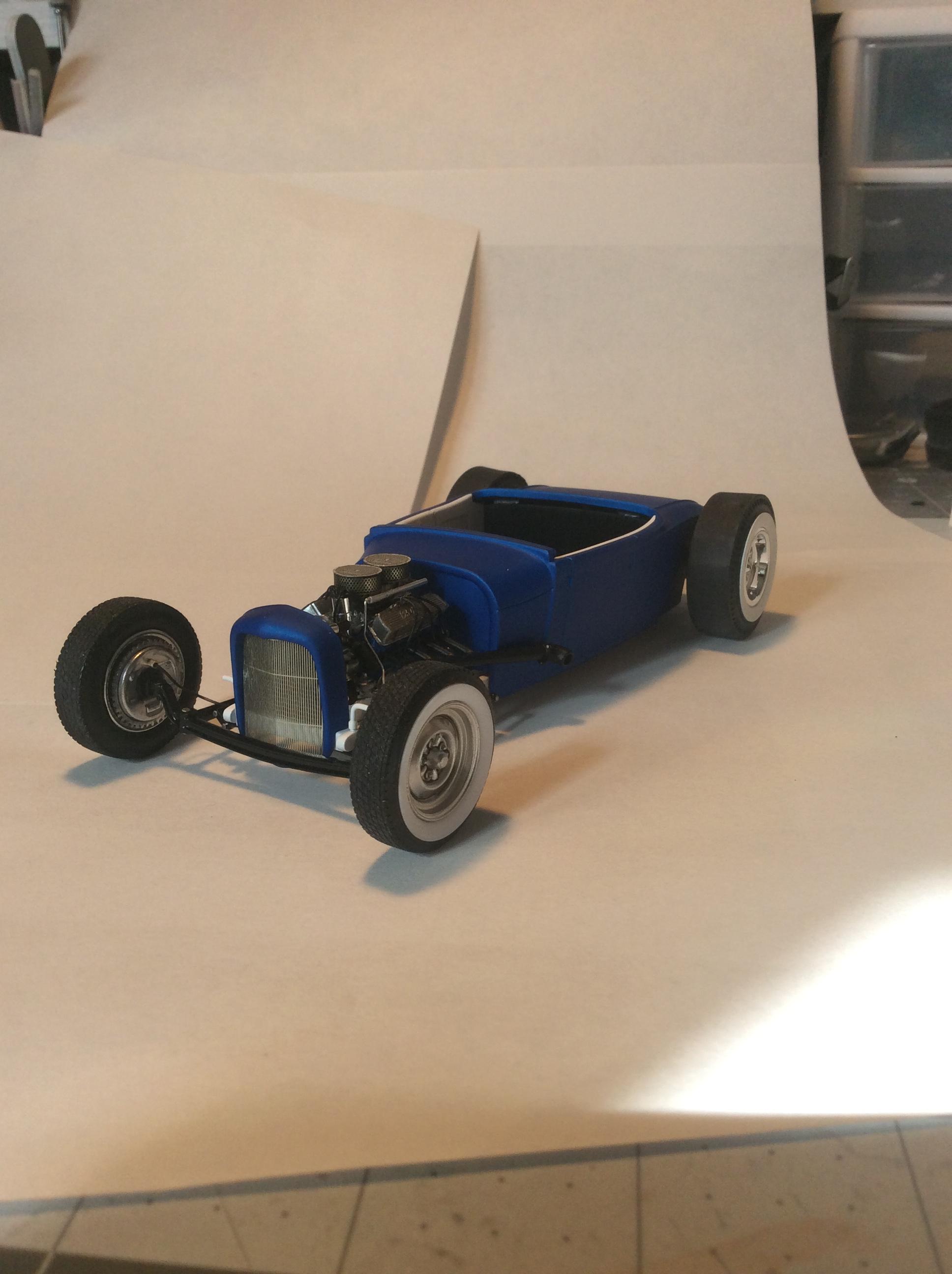

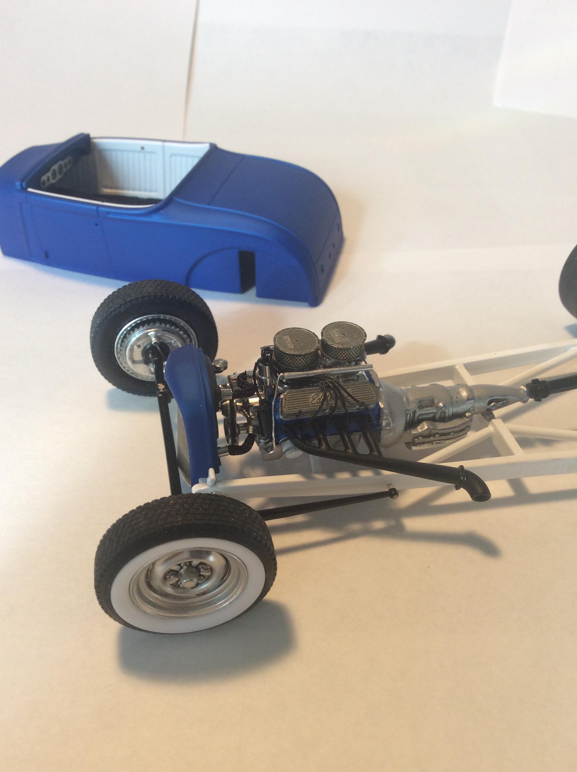

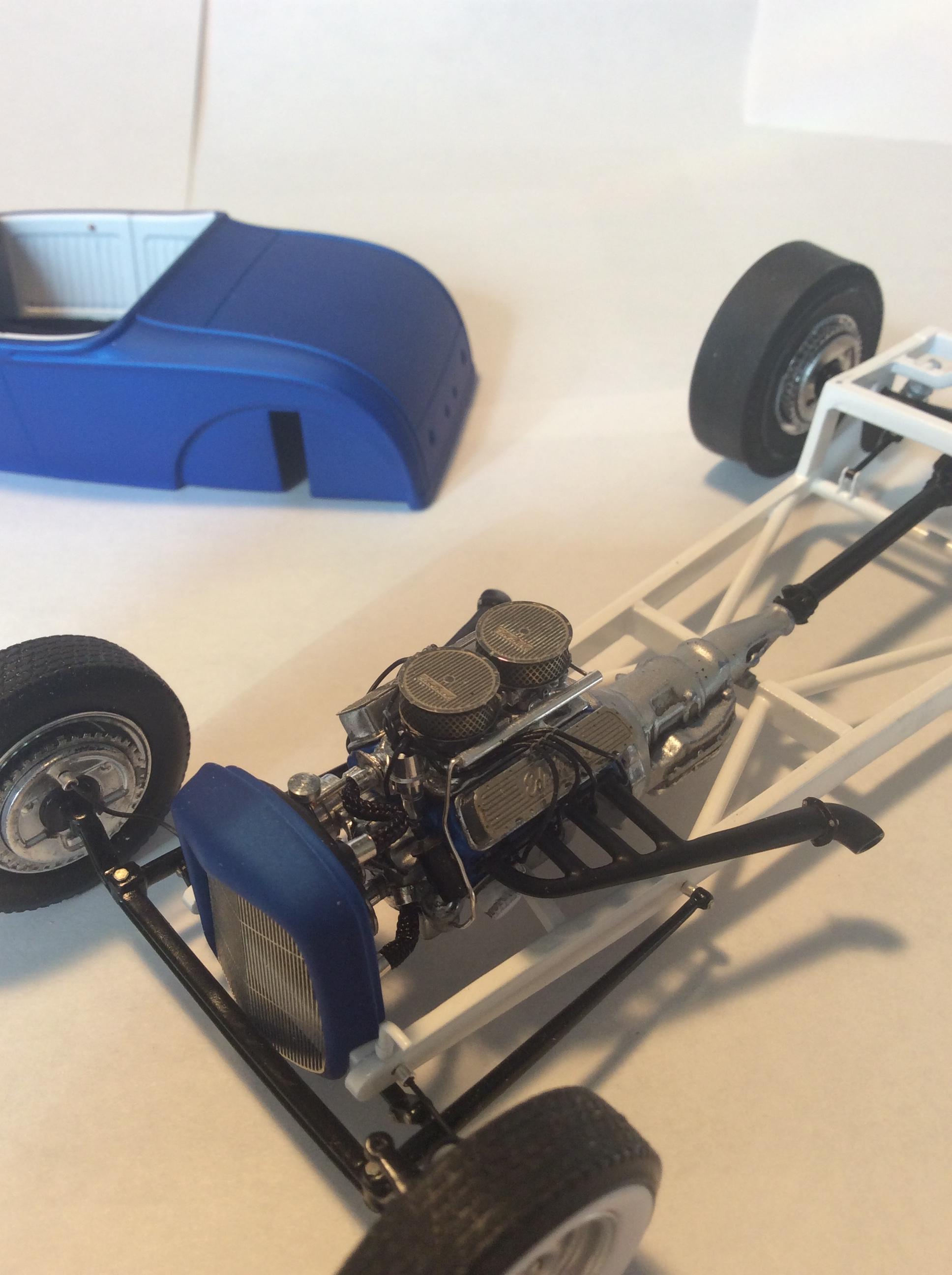

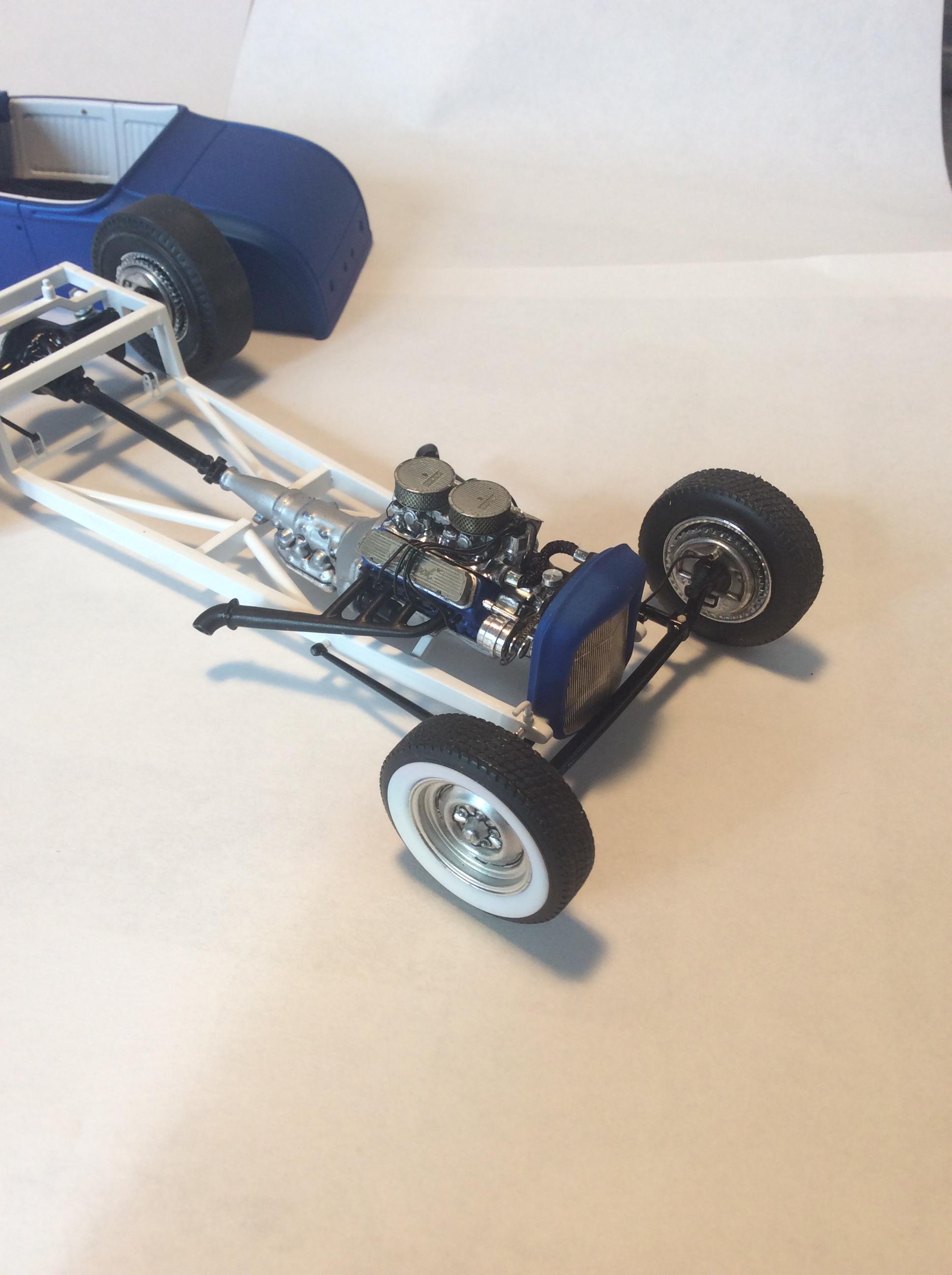

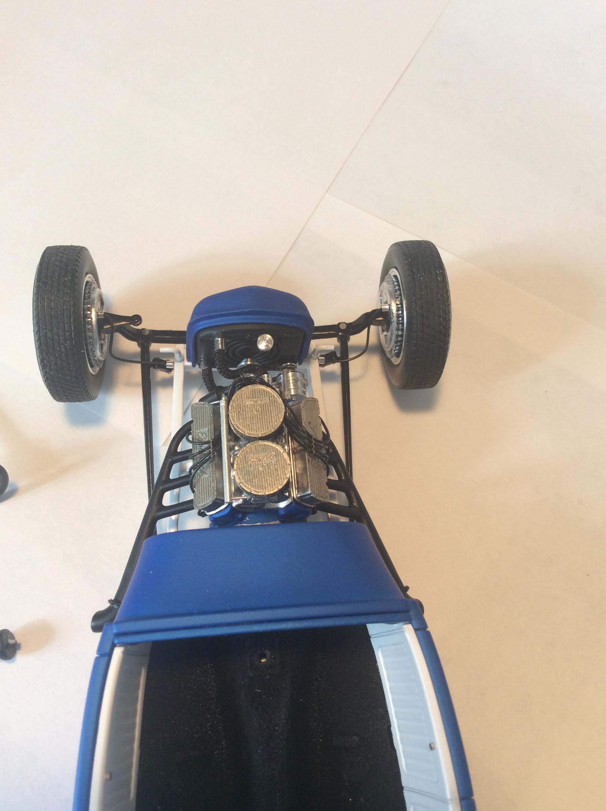

  2. Revell 32 ford kit engine RMCOM small block ford duel carb intake kit MCG small ford block valve covers and duel air cleaners mr model pulleys and alternator and distributor Revell 32 ford rear end re-built,grill shell and radiator chopped 4’ to fit MCG PE grill Revell 29 model A kit . Chassis re-built to lower it further to the ground,re- built headers to fit ford engine , re- built front suspension, scratch built 4 link rear suspension and coil over shocks, the body Wheel wells and fire wall filled in with sheet plastic, added scrap engine Fran’s tunnel in floor pan. mr model steering wheel and shifter knob Pro Tech gauge cluster ,nut and bolt heads, spark plug boots ,wire and looms Rust-oleum matte blue custom lacquer with Tamyia flat clear

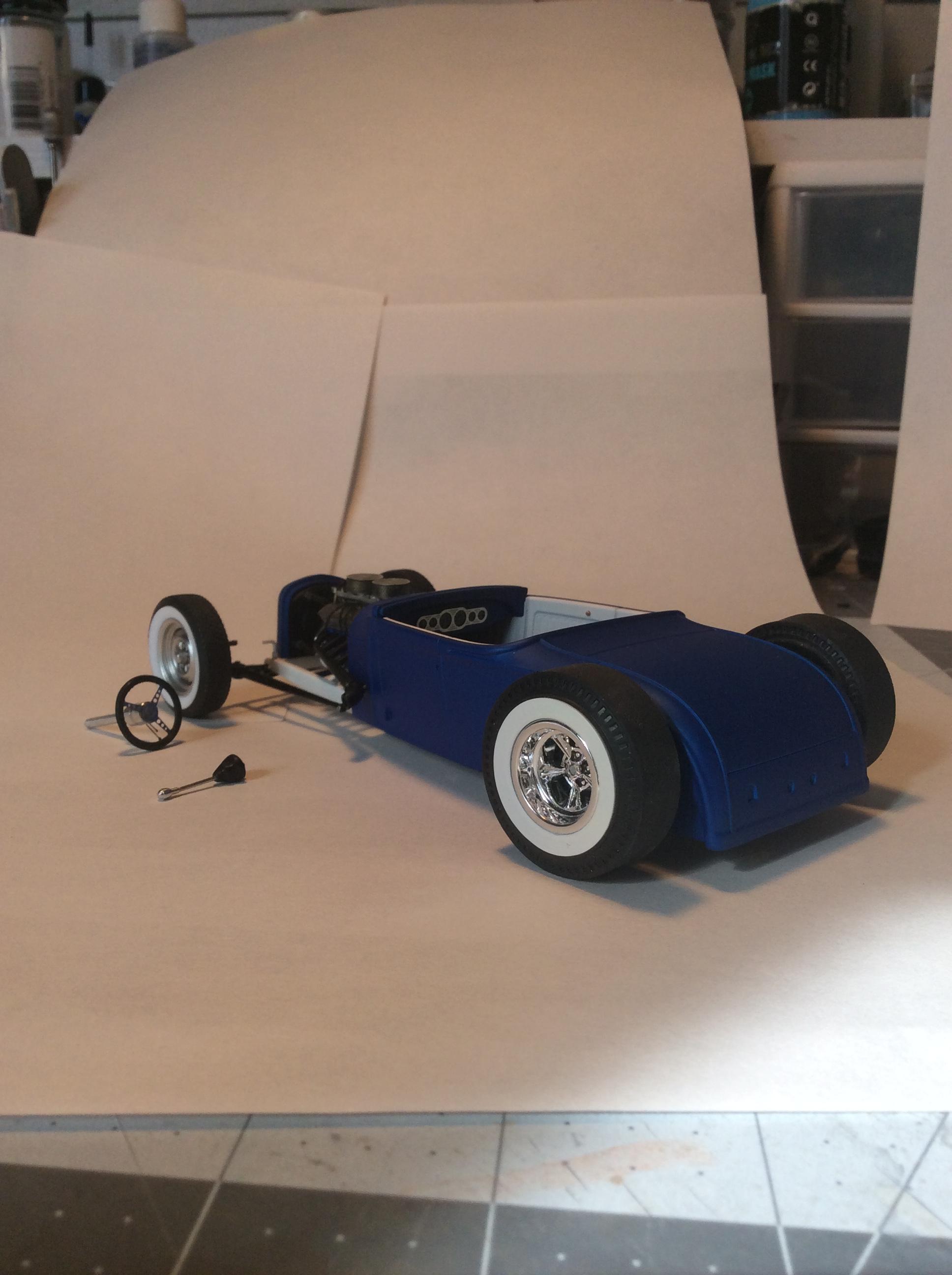

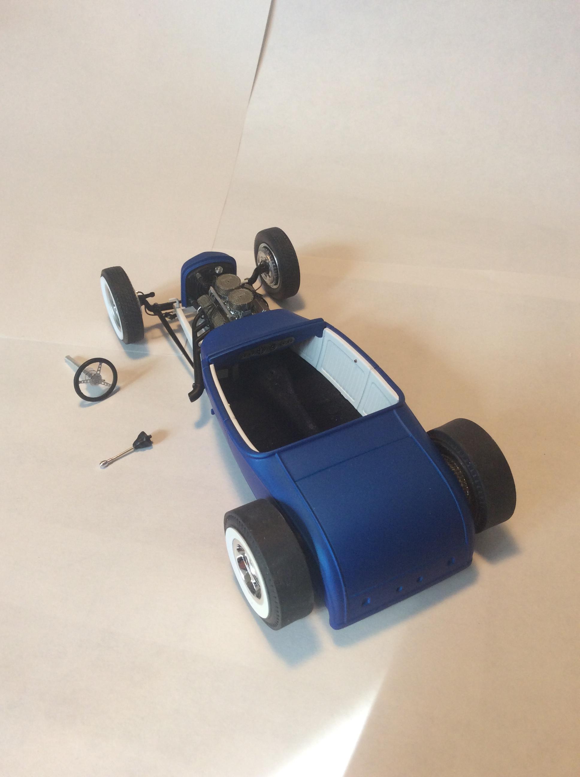

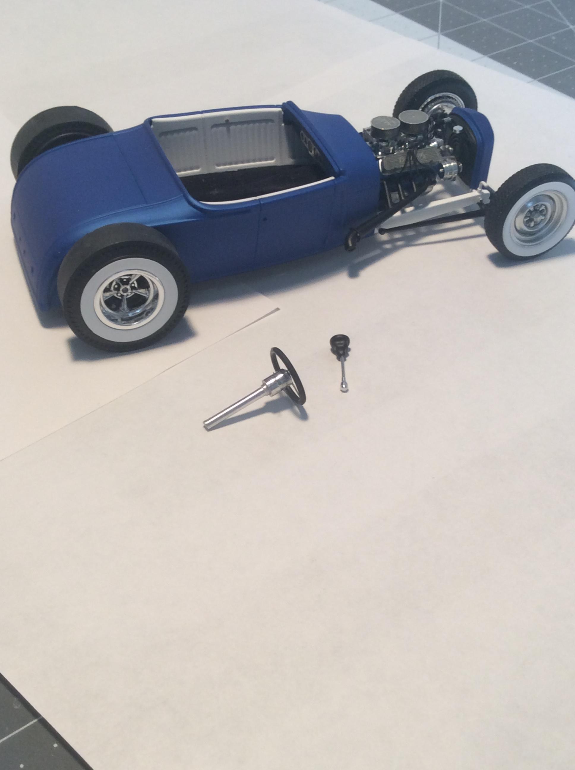

  3. Lost most of my in progress pics.Still have to finish interior, head lights, tail lights steering gear and a few other odds and ends.Hope you enjoy.
  4. Thought this car looked pretty cool so I tried to replicate into a model. It has a pretty cool color scheme with a flat blue paint job with black accents and a white interior.
