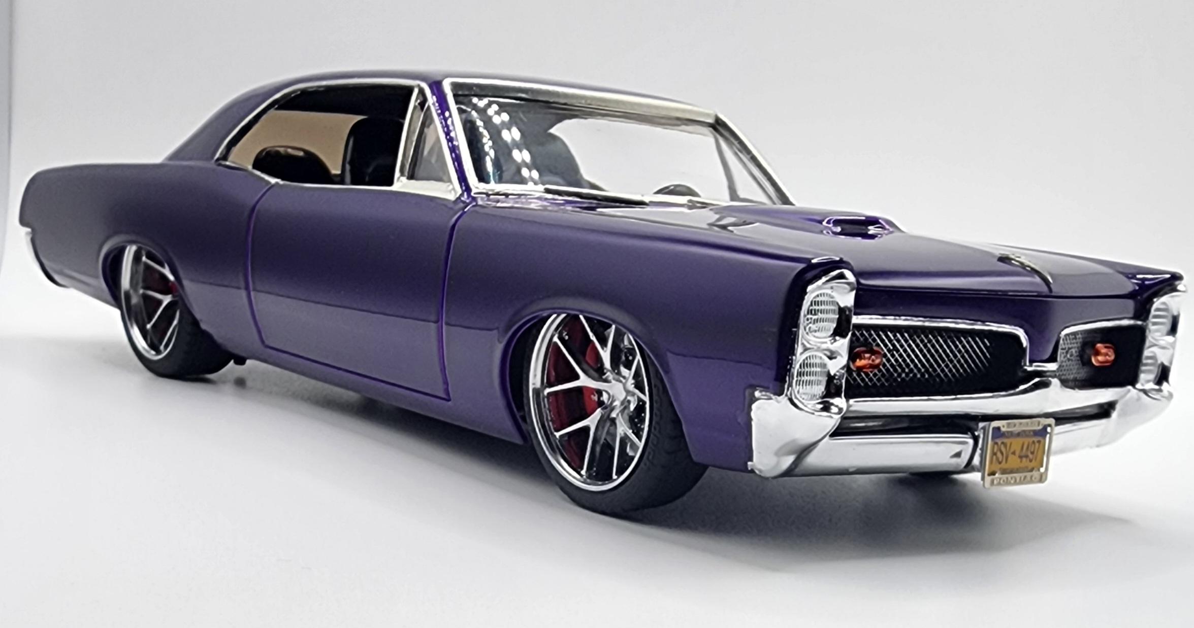

Mods: 3d printed wheels 3d printed steering wheel 3d printed booster/master cylinder Photo etch kit Full custom interior with C5 seats Z06 engine from monogram kit Scratch built engine bay Shaved all emblems Plumbed engine mildly (heater hoses, AC lines, brake lines, upper/lower rad hoses) More... Paints: Body- mr surfacer 1500 grey primer Tamiya titanium gold base coat Mr color clear purple Splash 2k clear Interior- mostly body color and tamiya semi gloss black Wheels/tires- revell chrome and tamiya rubber black Various tamiya and alclad for the metal shades Window tint tamiya smoke Any questions feel free to ask. Thanks for looking!

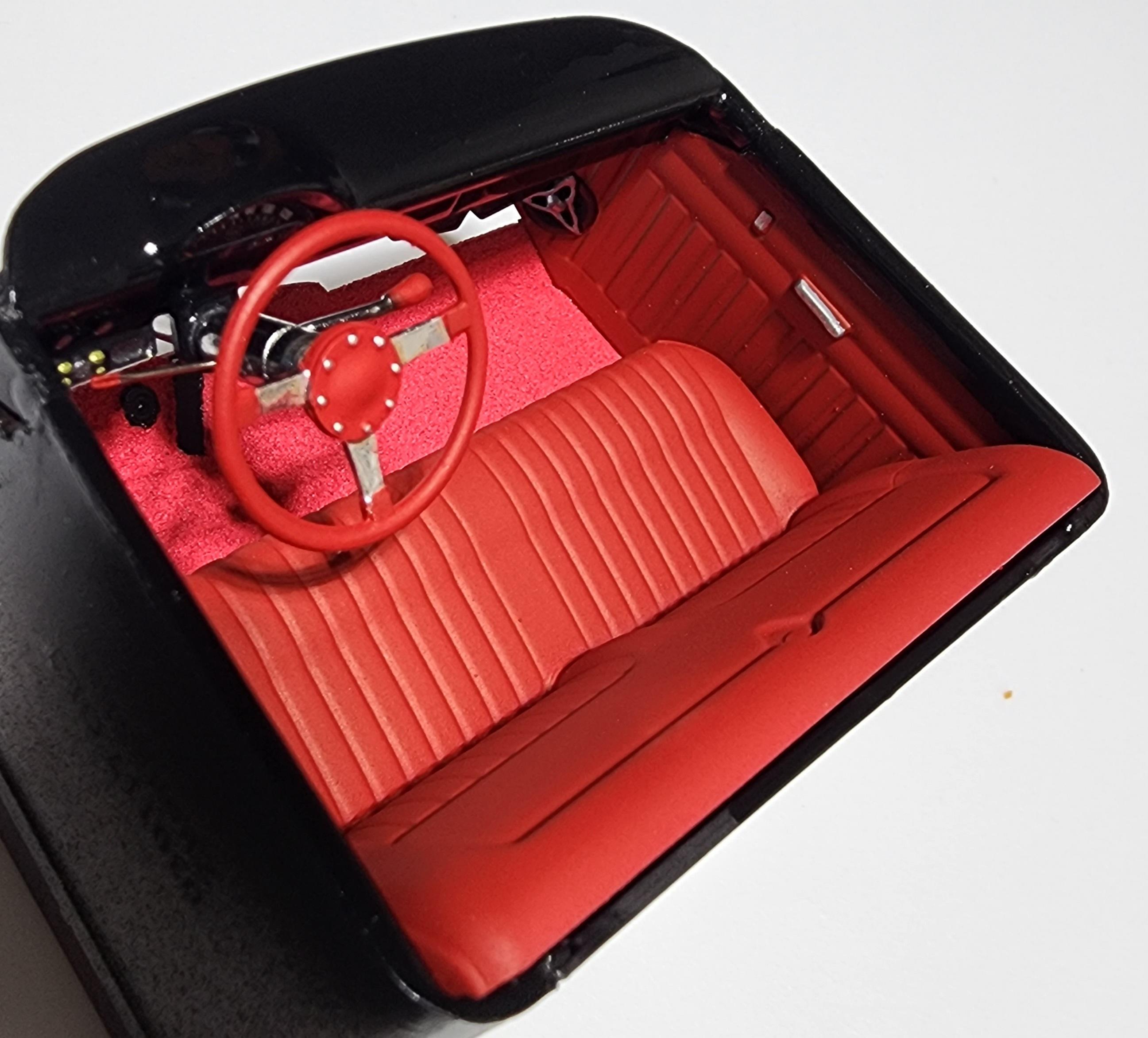

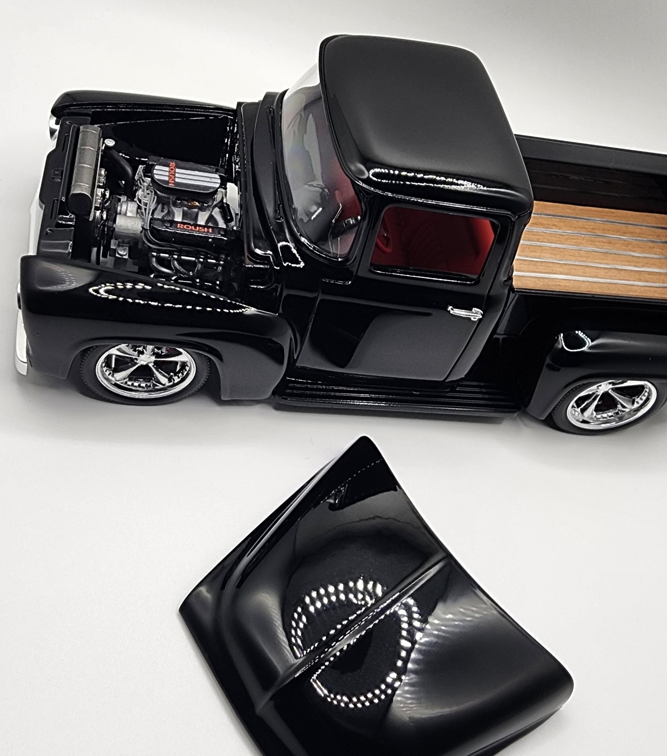

This is my first build after about a 7 year break from building. 7 years ago i built the chassis and engine and put it in the box. I pondered over color choice for a good number of days but finally decided it just looks best in black. But i changed the interior to my liking. Hope yall enjoy. Side note. For anyone doing this kit. Build the interior tub and then sand about 2 or 3mm off of the whole bottom rails of the tub. This allows the cab to sit down proper. Mr surfacer 1500 Tamiya flat black Splash 2k clear Basswood bed Embossing powder carpet Steering wheel from a revell plow truck

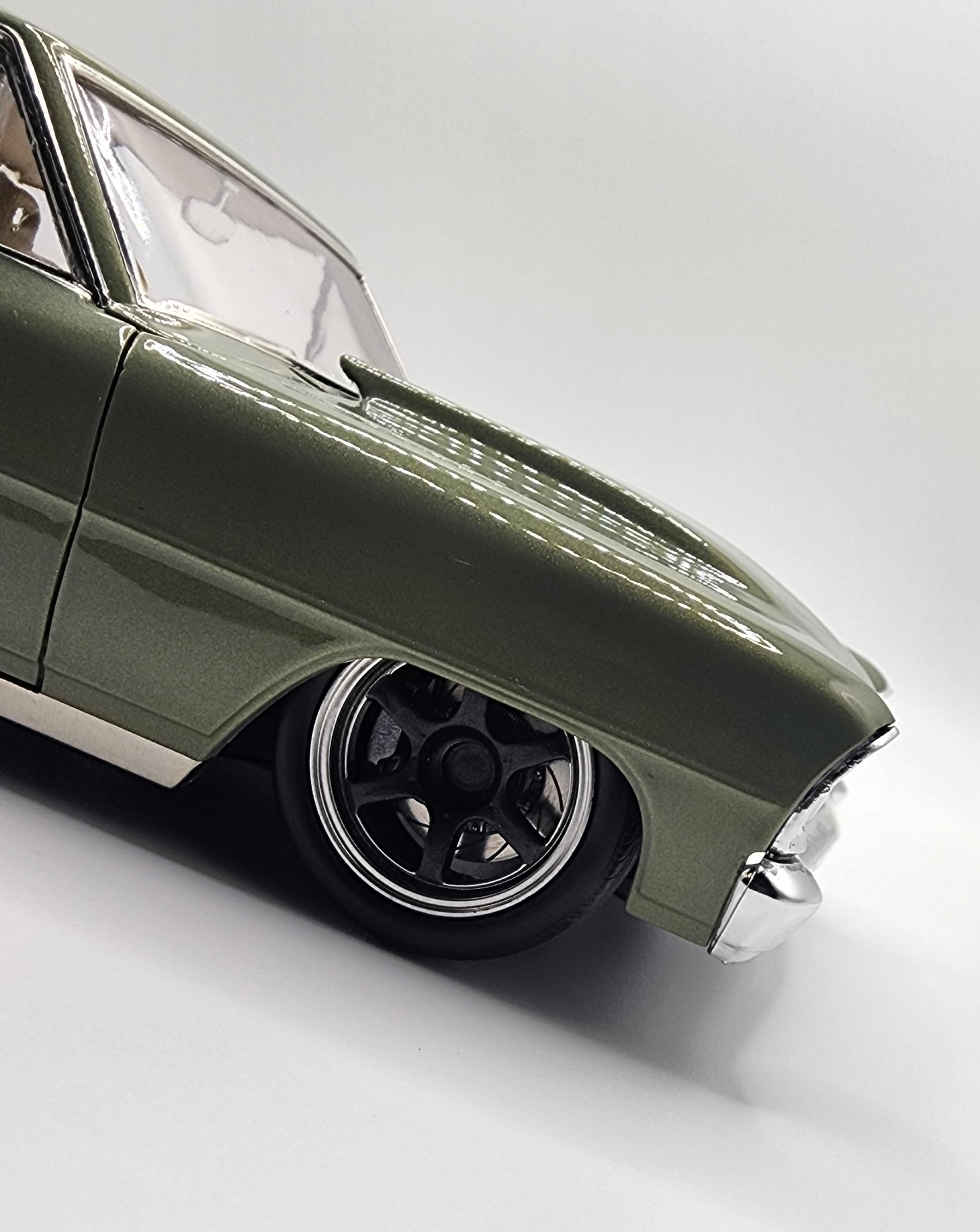

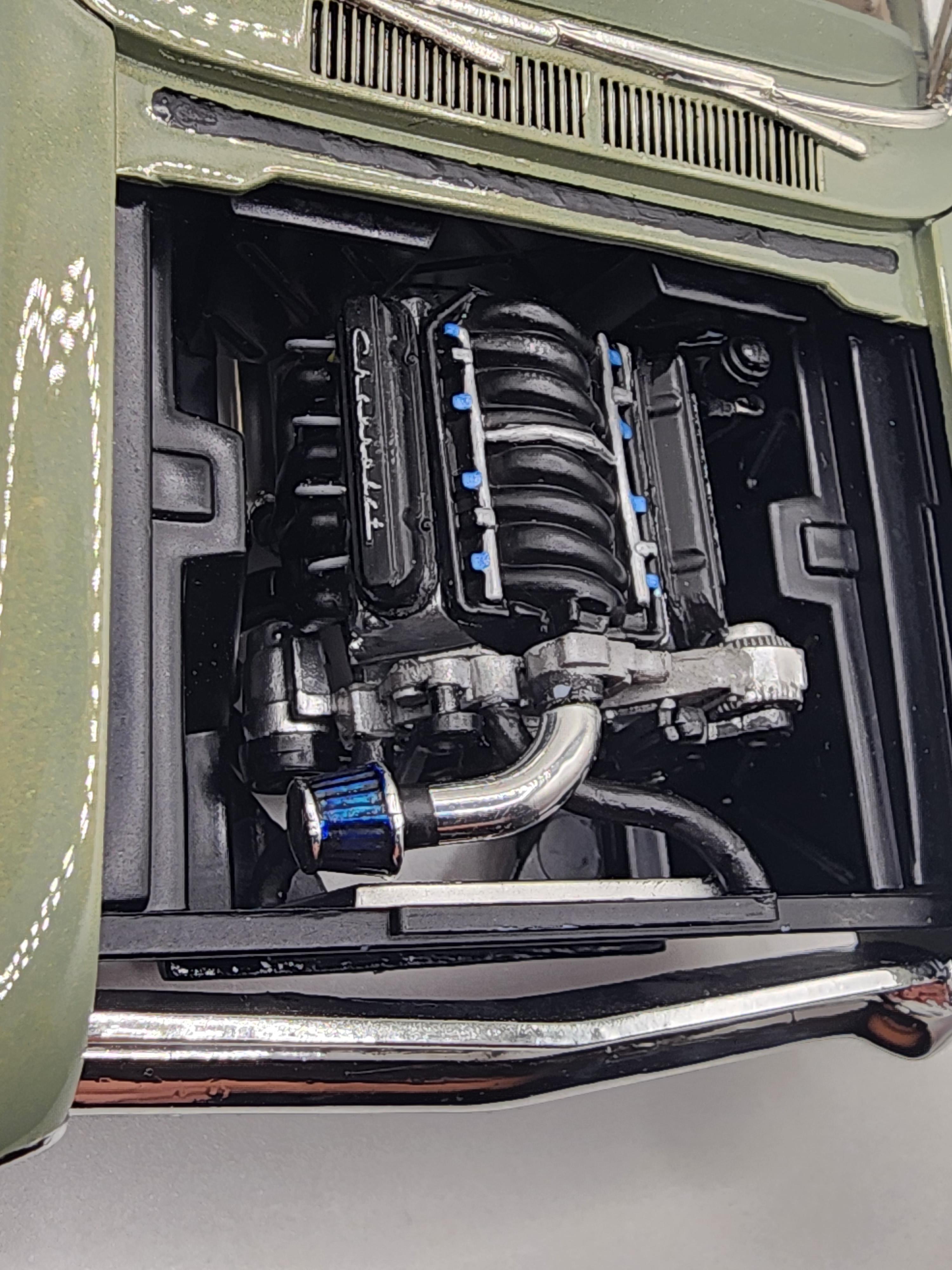

This is a kitbash to achieve the vision i had for the amt 66 rides magazine nova. LS block from monogram Z06 Z06 tires Cut the block off the transmission and used the nova kit transmission (fit perfectly) Parts box valve covers turned into coil covers Wheels/steering wheel/brakes/photo etch rotors from a tamiya gt-r race car Embossing powder carpet Custom scribed door panels Seats front and back from revell integra Added plug wires and brake lines from the master cylinder Solder exhaust/kit mufflers/aluminum tubing dumps Mr surfacer 1500 Custom craft paint mix splash 2k clear This kit was tricky for fitment but i made it work.

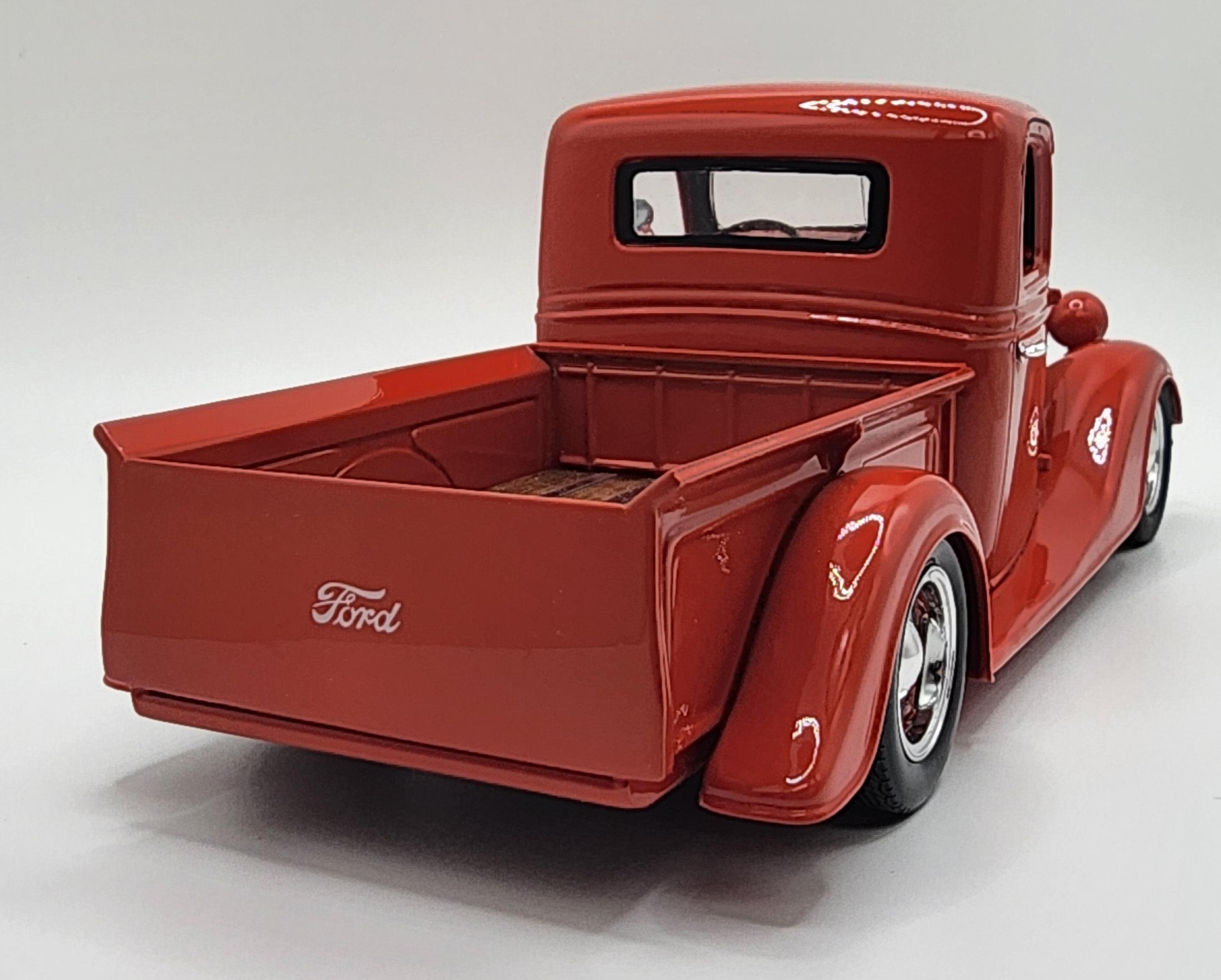

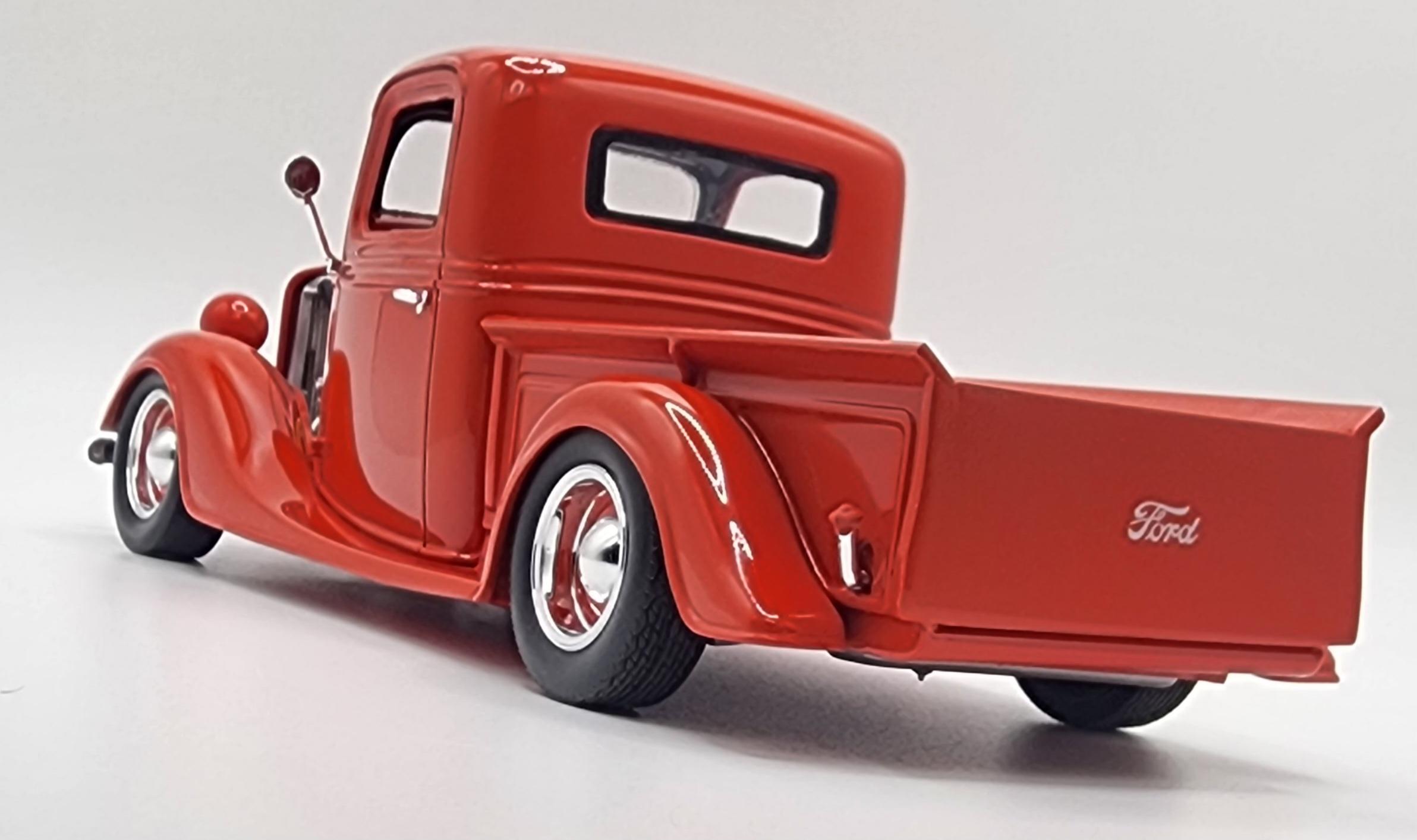

Revell 37 Ford pickup. Built Ford tough with chevy stuff. 90s hot rod styling. Small block chevy from amt corvette Lowered the kit suspension Wheels/tires from monogram 32 ford Moons from part box Smoothed step rails Shaved firewall Sheet styrene shaved tailgate/roll pan Solder headers+exhaust Accel type plug wires/boots Custom flush rear glass Basswood bed Mr surfacer 1500 Tamiya custom mix of red/yellow Splash 2k clear
