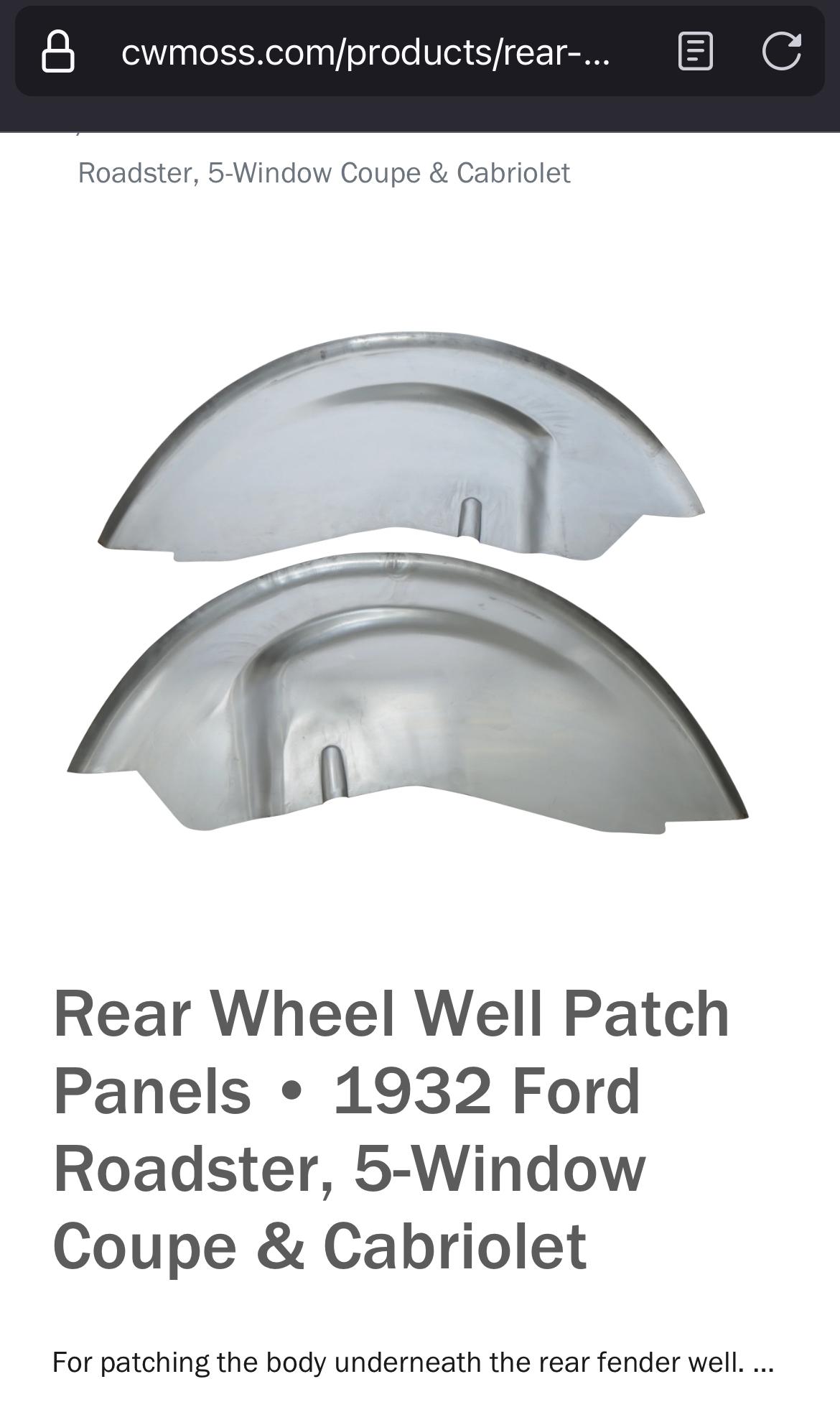

  12. I do believe you're right...there is a detail in the 3 window wheel well stamping just above the frame rail (usually hidden behind the rear wheel) that I hadn't noticed before. On 5 windows and roadsters, the wheel well is more visible when built as a hi-boy, and the Revell flat wheel well in the kit doesn't quite look right. Now that my curiosity has been piqued, I need to see what the same part looks like on a real steel tudor sedan also.
    I hear what you are saying about the non-OEM  hemi. The next time I work on one of Revell's 3 window deuces I will try to incorporate that to get that detail right. We all know it's plastic, but the period I usually shoot for with a build is before fiberglass replica bodies existed, and it is satisfying to give the model a "real steel" look by sneaking in extra detail that isn't in the box. Your build is certainly looking the part.

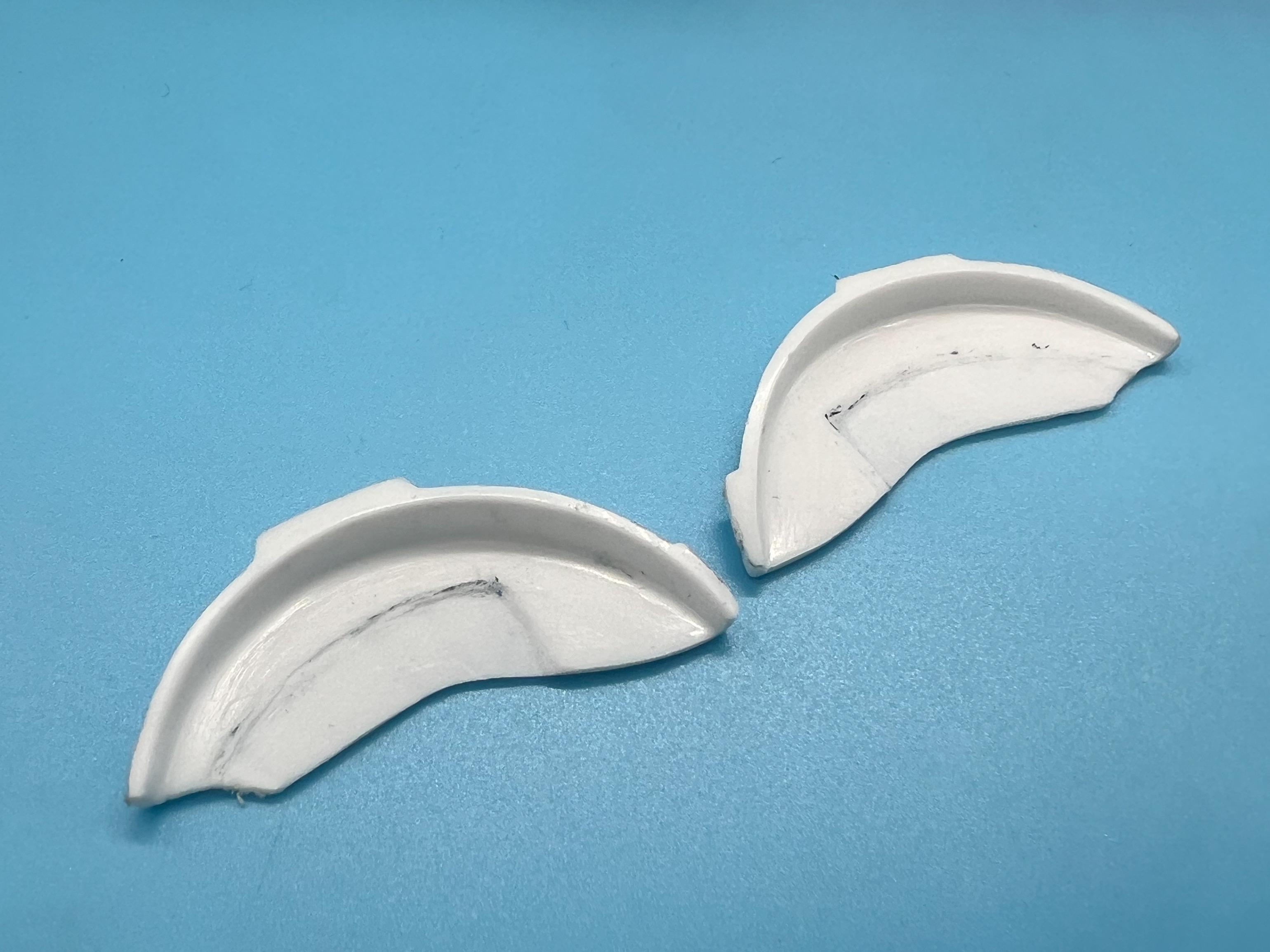

    And finally, I made a start on the inner rear fenders tonight.  I’m sure you all know what the flat Revell kit pieces look like, but I wanted to add some detail to make them look more like a real set:
    Nothing for it but to get the files out and start carving away material…
    Excuse the roughness, they’re not finished yet, but I didn’t achieve much this evening and they were an extra thing to show for my time at the bench ?
    Thanks for looking, more soon, soon as I’ve done more!
    If there is a '32 expert that can correct me, I'm all ears. The '32 5 window and and roadster had wheel wells like in your attached image. I believe 3 windows and sedans actually had flat wheel wells (more like what is represented in Revell's kits).
    I started mastering a pair years ago for the roadster with the intention of casting multiples in resin, but the work was sidelined by work of the paid variety.
