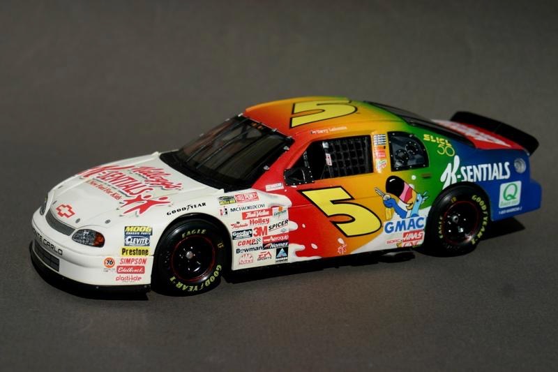

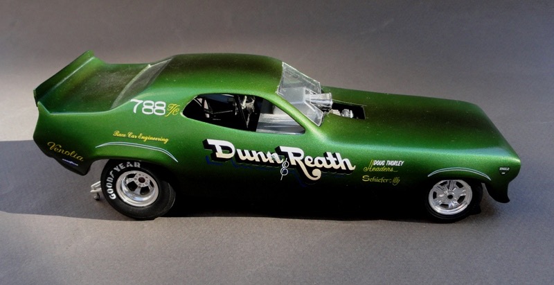

Multi colors and fades just take time and practice. And one of the biggest rules I had to learn is to be patient, don't rush a paint job. That K-Sentials paint job took 10 days to accomplish, giving the Testors enamels time to dry between maskings and sprayings. But the results can be well worth it.
A couple of things that a great airbrush friend of mine, John Pattison of Albuquerque, NM) taught me are:
1) when spraying multi colors, try to spray the lighter color first and the darker color last

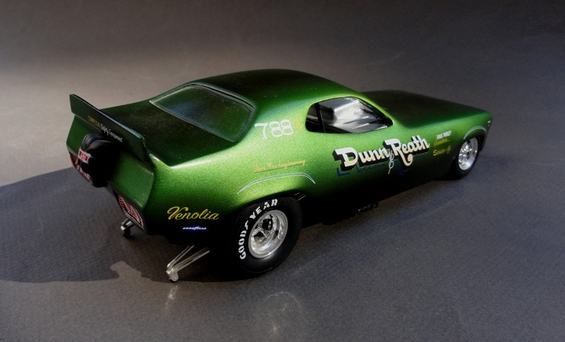

Example ...... the Dunn & Reath funny car is actually two shades of blue (light on top and dark along the bottom and the faded stripe down the trunk, top, and hood) and all that was covered with a candy gold to turn the colors the green shades you see ......... light first, dark second, and oversprays last.
2) When spraying multi colors, try to start at one end of the car and work to the other. And be patient, these types of paint jobs can take days to accomplish.
The Dunn & Reath dragster below, and the K-Sentials Nascar were both painted from the nose to the tail.

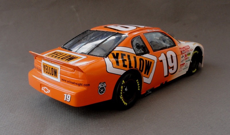

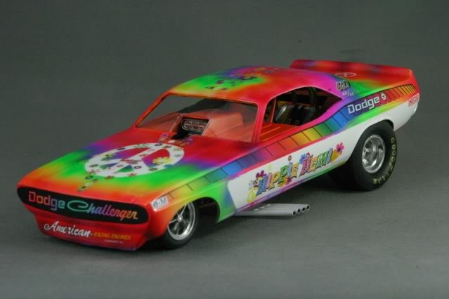

Unlike Mark, who can do fantastic paint jobs with acrylics, I have never been able to handle them. Plus I don't like cleaning my airbrush with water or alcohol ( I use a double action Paasche ). I stick to enamels and lacquers. That's where my experience is (and also my comfort level). I use Testors enamels quite a bit, and they can be mixed to make custom colors. For lacquers, I used to use Cobracolors but sadly they went out of business. Now I use Model Car World lacquers. They have a wide assortment of factory colors and a huge number of racing paint colors (especially Nascar colors). Their paints are PPG and DuPont automotive paints which airbrush really well.
Here are a couple of examples.
Lacquer
Enamels
