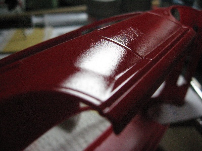

  1. ok, thanks guys, I'll try your suggestions do you thin TS-13 clear for airbrush spraying? how can I use sanding sheets in difficult to reach areas?
  2. What do you suggest at this point? A Tamiya coarse? Or finest? Thank you very much
  3. Thanks for your reply, the problem is that every area near the airbrush atomization become orange peel With a small object I've no problem to obtain a perfect gloss clear, but when I move airbrush long a side of a car, roof, for exemple, become orange peel !!!
  4. Hi, my name is Marco and I write from Europe, Italy, so please sorry 'bout my english.. I've read a lot about finishing glossy clear coat and now I'm trying doing myself I put TS-13 into a jar so it can be airbrushed with a paasche talon .38 The problem is that when I spray the last wet and heavy coat paint has a perfect look if it is under the airbrush pattern, but in the nearest area paint become orange peel looking (maybe overspray cause?) Have I to insist on spraying? for example, I can obtain a good finish on a side of the model BUT roof appears orange peel Is it a pressure problem? A spraying distance problem? Thank you in advance, good night Marco
