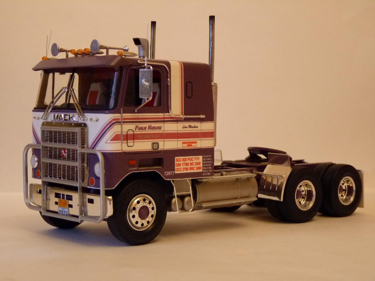

How in the world did you do/make that ultra fine black stripe between the various stripe colors?
Cab mounted exhaust?
All lines on the cab - hand made decals.

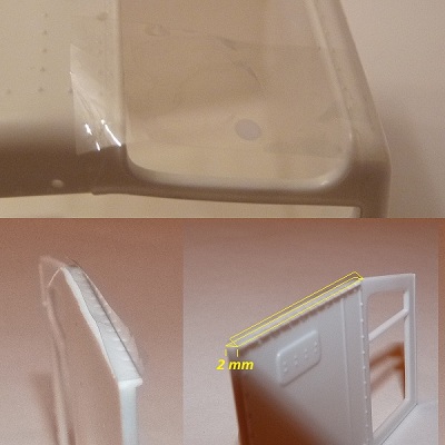

. Are you using the MCG piano hinges? I'm having abosulte fits making them work. can you post a how to ? If your using an alternative I'd like top learn how?
Hello! The material I used to make doors open you can see on the photo. I cut out form that I needed, glue one side to the door and another side to the cab. So, the door is ready. This method is very simpe and can be done in 15 minutes but it's working.

About hinges. I didn't use piano hinges. They are made of very thin transparent plastic. Day after tomorrow I'll make some photos to explain how it works.
