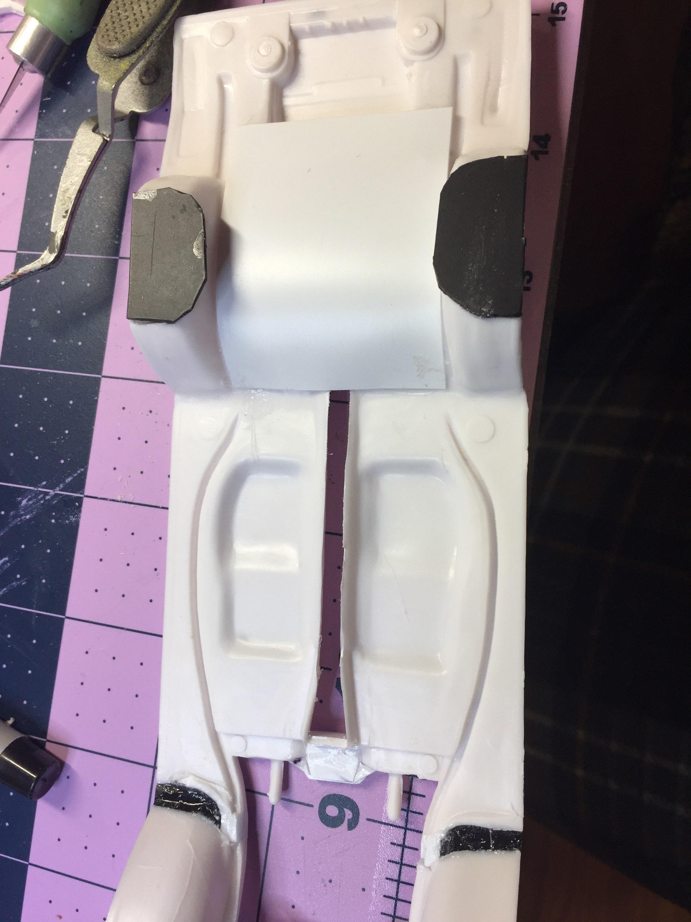

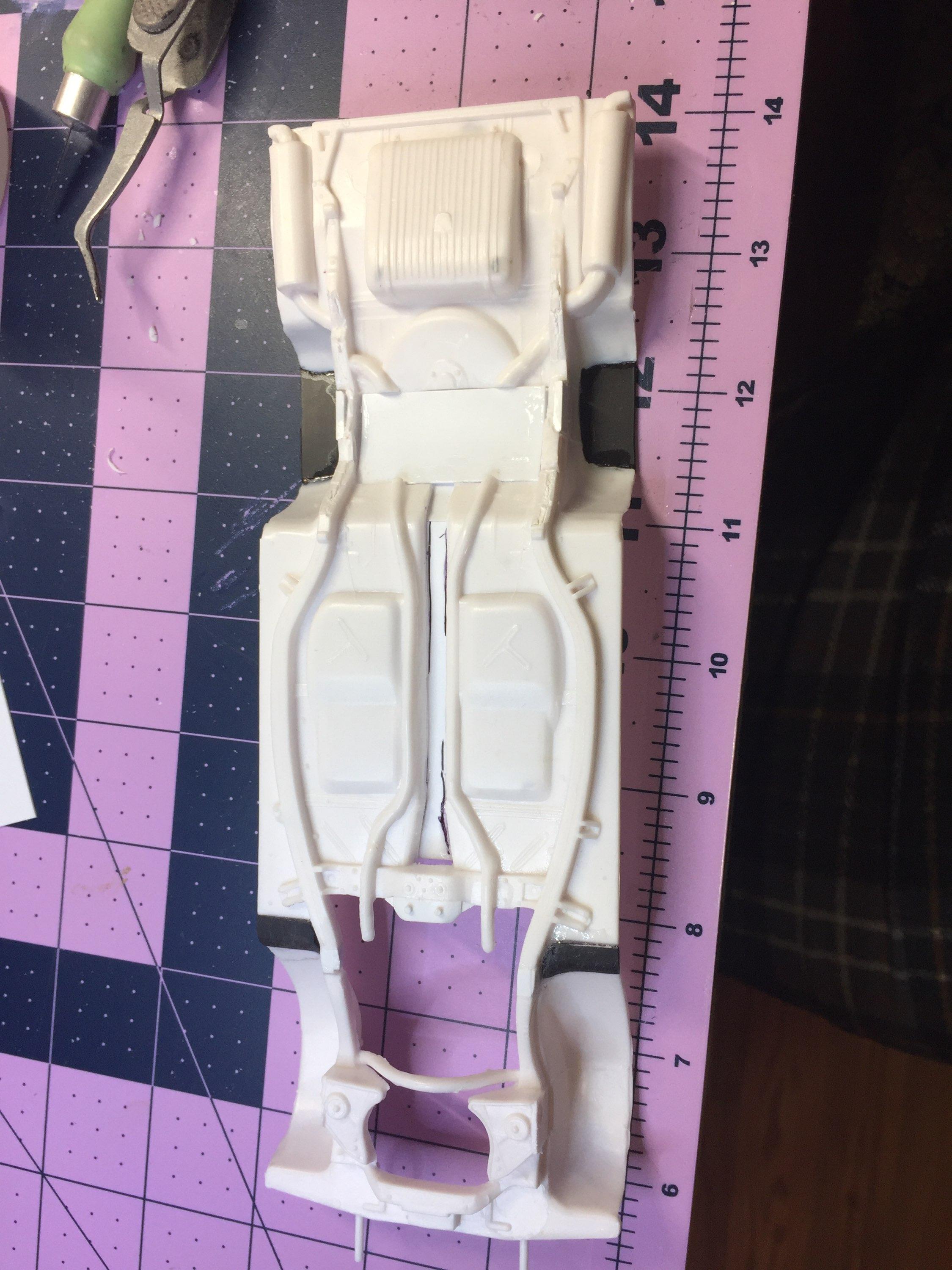

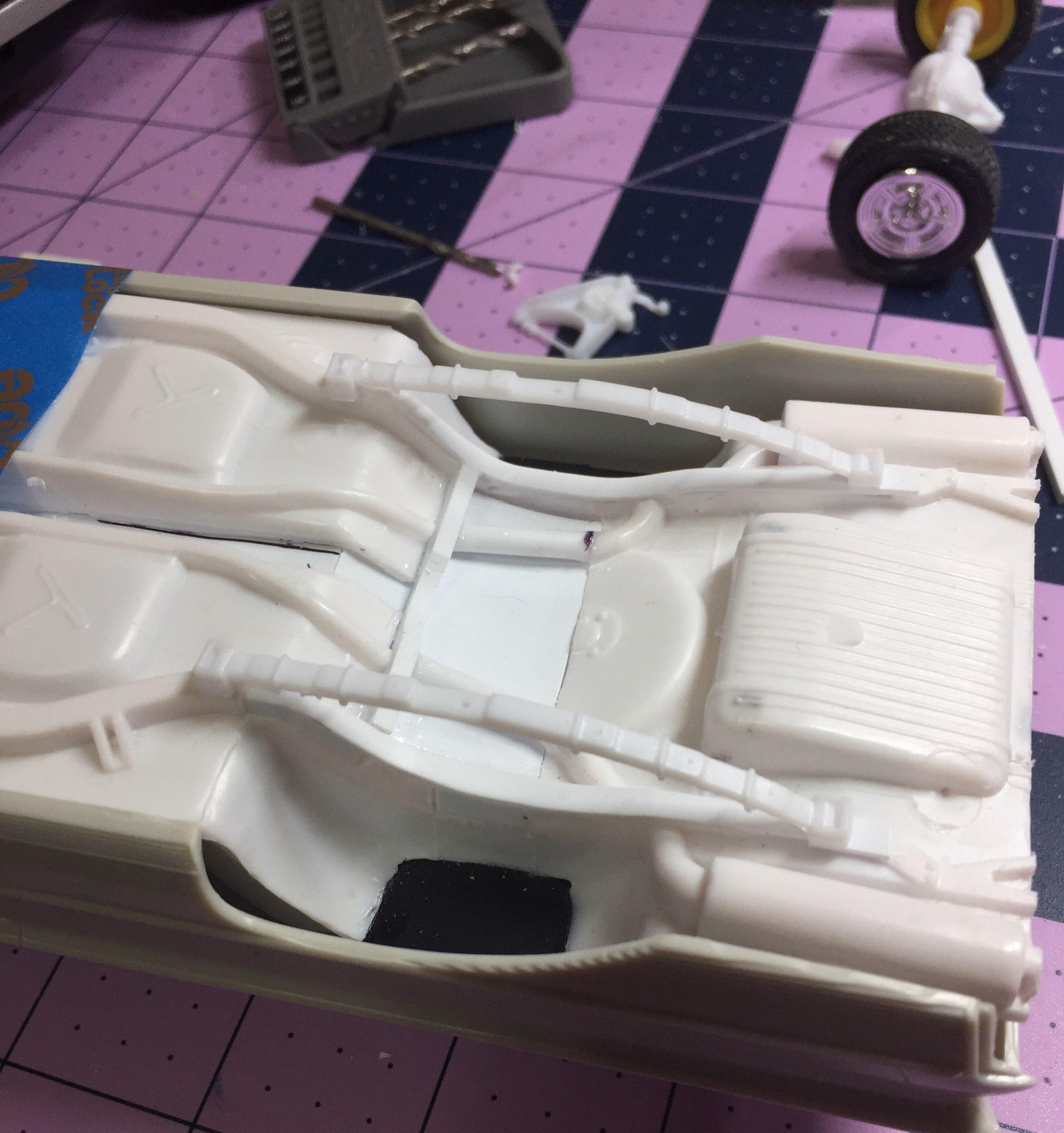

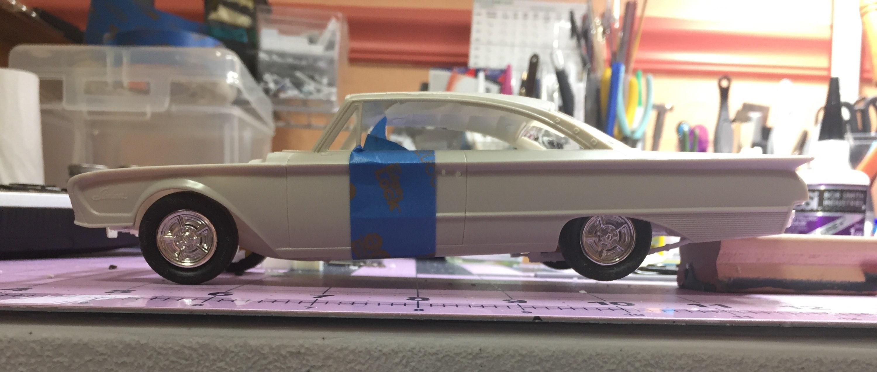

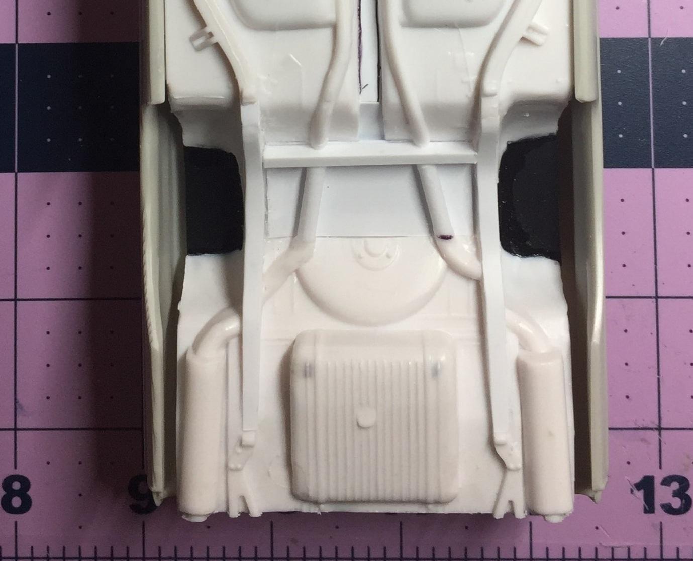

  1. After having bought a nice '60 Starliner kit only to steal the chassis and firewall, etc. in order to build a decent model of a '63 Galaxie lightweight, I fell in love with the awesome body style of the '60. Being a cheapskate and somewhat thick-headed, I decided to use the discarded '63 chassis/floor pan under the gorgeous '60 fastback Starliner. This necessarily includes the '63 firewall which ain't too bad, really, but the chassis is pure dog poop. I started hacking away on the chassis and you could describe my actions as "going off half-cocked". I lengthened the chassis at the firewall.? - not sure why but I decided to leave it that way. It seems to work except the rear axle thingie was too far back. I suppose I could have just drilled holes a bit forward (I did ?) but I knew I wouldn't be happy with that (I wasn't ?). It was time to get serious and force my will upon this turd so I spent several hours today beating that P.O.S. into a real....um.....well, you decide. I attacked the blobular rear end with my sprue cutter. When the violence subsided, I closed the holes with some .015. I made quite a mess so I cleaned it up a little with my trusty Micro and patched in the somewhat vague frame over the axle area. I could not come up with a proper 9" Ford axle but was able to locate this nice Dana unit from the Revell '68 Dart GT. I replaced the cross member that I hacked out earlier and patched in the tail pipes (it ain't pretty but it's way better than what was there ?. The length of the springs is perfect but the axle locating pins are a bit off. On the axle housing, the spring pads are too far in-board also. Some minor evergreen work and it should fit nicely. I won't go into the wheel selection process but I will say that I'm grateful for the '41 Plymouth kits lying around here. I think I have the rear end located to my satisfaction now. Thanks for reading all this, you must be very sorry that you didn't just look at the pictures ? ? I'll bet you're wondering what this is all about ☝️
