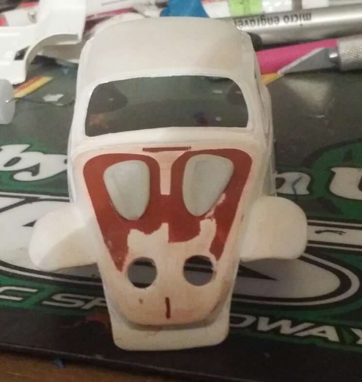

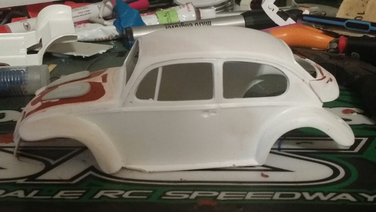

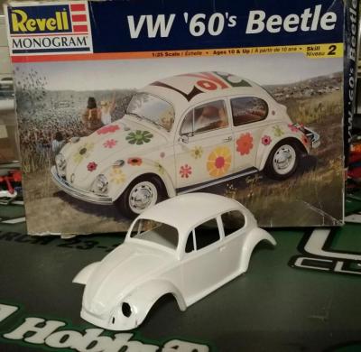

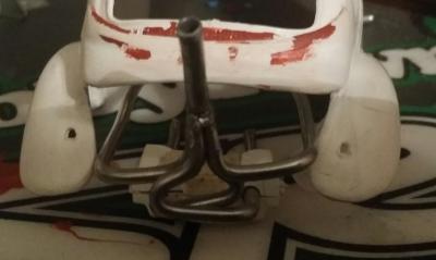

jacoballardtattoo Posted April 5, 2015 Author Posted April 5, 2015 (edited) Okay keys see if the pics will load Okay looks like they loaded. So I started to build a 60s baja and planned on more pics, but that didn't happen. Finally here they are and maybe the pics will prompt more responses. So I'm starting with a Revel 1960s bug kit I got from a family member. I think it'sa fairly old kit but not sure. It has some quality tooling fewer but apparent mold lines. I copied 3 of the four fenders so far and created duel exhaust for it so far. The exhaust kinda kicked me in the teeth for a bit but just got it down tonight. Here's to the hopes of a great baja when I'm done. please leave comments, suggestions or criticism. Thanks. Edited April 5, 2015 by jacoballardtattoo

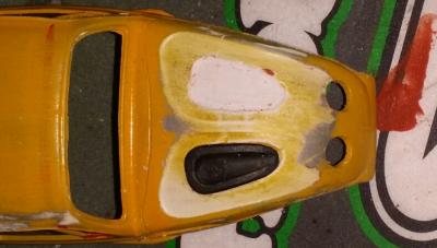

jacoballardtattoo Posted April 5, 2015 Author Posted April 5, 2015 My next portion to tackle is the hood to give a after market fiberglass look and the close eye headlights. My plan is to drill out two wholes for the light buckets to drop in into the hood and mold them in. Let me know what you think.
Atmobil Posted April 5, 2015 Posted April 5, 2015 Looks like a nice start. You are correct that the tool is of older date, the original release of that kit was back in 68 and it has been out many times since.

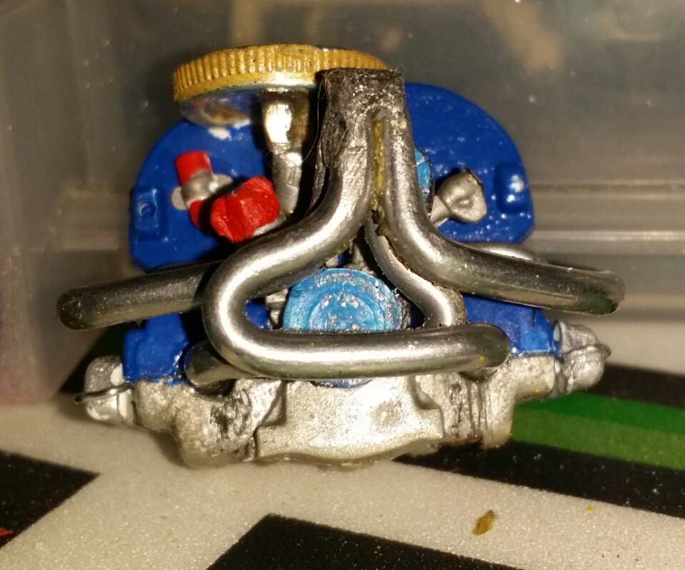

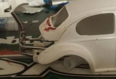

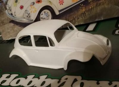

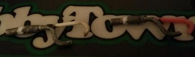

jacoballardtattoo Posted April 20, 2015 Author Posted April 20, 2015 Finally had a chance for pictures and an update so here it is. From top to bottom. #1 & 2 sooner exhaust. This has been the biggest headache of the build. I first tried to create it from spare exhaust pieces that I was hearing and bending but could not get the bends right. The final exhaust was done with solder I had in garage. Work pretty good. #3 is the hood and front end copied and shaped. #4 just a side view. Next step will probably be paint and assembly of the engine so I can shape the rear to fit right. Let me know what you guys think, good bad or ugly.
Zarana-X Posted April 22, 2015 Posted April 22, 2015 If you didn't destroy the headlight buckets you cut out, I'd suggest using those, and build the nose around them. What you showed looks too narrow to me.

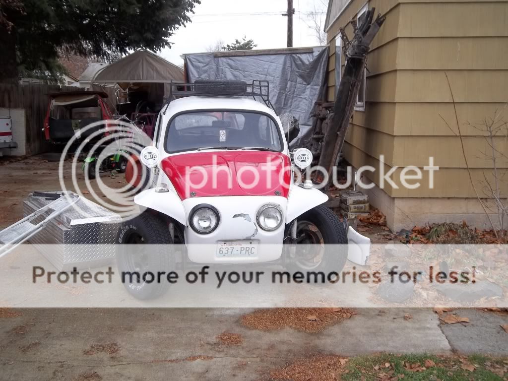

jacoballardtattoo Posted April 23, 2015 Author Posted April 23, 2015 They are slightly narrow Jason, on the 1:1 y you have here the nose is shortened but on mine I modified the stock hood. I have buckets I will be putting in and possibly molding in not sure yet but it should look good.

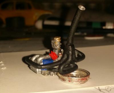

jacoballardtattoo Posted April 23, 2015 Author Posted April 23, 2015 No pictures yet but just finished up the engine tonight. I was planning on going full detail with plug wires throttle linkage the whole nine but found I not that skilled on this small of scale yet. Pictures are delayed due to me breaking the singer tip and not having much luck tree gluing it. I will fought that again tomorrow and then hopefully snap some shots. Also I found the carb and single port intake tube in this kit won't work without all the shielding you remove with the back end on a Baja so I spent most the night creating a new tube and carb. Along with a not so realistic air box I hope I can hide in the body when I'm done. So here's hoping I get some pics up tomorrow. Again thanks to everyone for all your comments.

jacoballardtattoo Posted April 24, 2015 Author Posted April 24, 2015 Thanks Randy, I'm kinda proud of the exhaust, unfortunately I'm struggling with gluing the stinger tip back on after I broke it. I'm trying to glue solder to solder. Since it broke after I glued the exhaust to the motor I can't just fuse it together. I do have rims and tires for the rear, I want tall and thin for the front so the rims I used in the rear won't work up front so I'm still digging through my parts box for the rear rims. I will be trying to post pics soon.
chunkypeanutbutter Posted April 24, 2015 Posted April 24, 2015 Try some two-part/ five minute epoxy to fuse the solder back together.

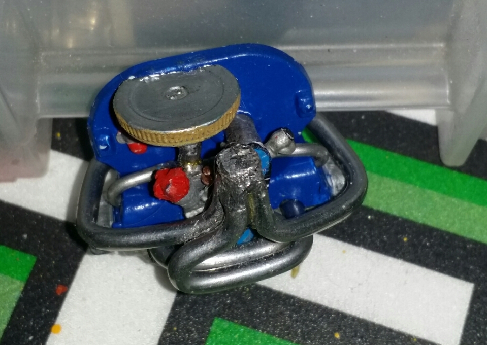

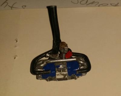

jacoballardtattoo Posted April 25, 2015 Author Posted April 25, 2015 Thanks Miles I will most likely be doing just that for the exhaust. Okay so it's not much but here are some pics of the engine. It's still rough and I will most likely be adding to it still but here we go. To list what I have done to it as far as mods go. Custom built exhaust (the stinger tip broke off and I still haven't fixed it yet) Custom single port intake tube and carb. Tried to shape the heads. And a poorly done self built distributor. (I lost the one from the kit) I may pull this one off and try again.

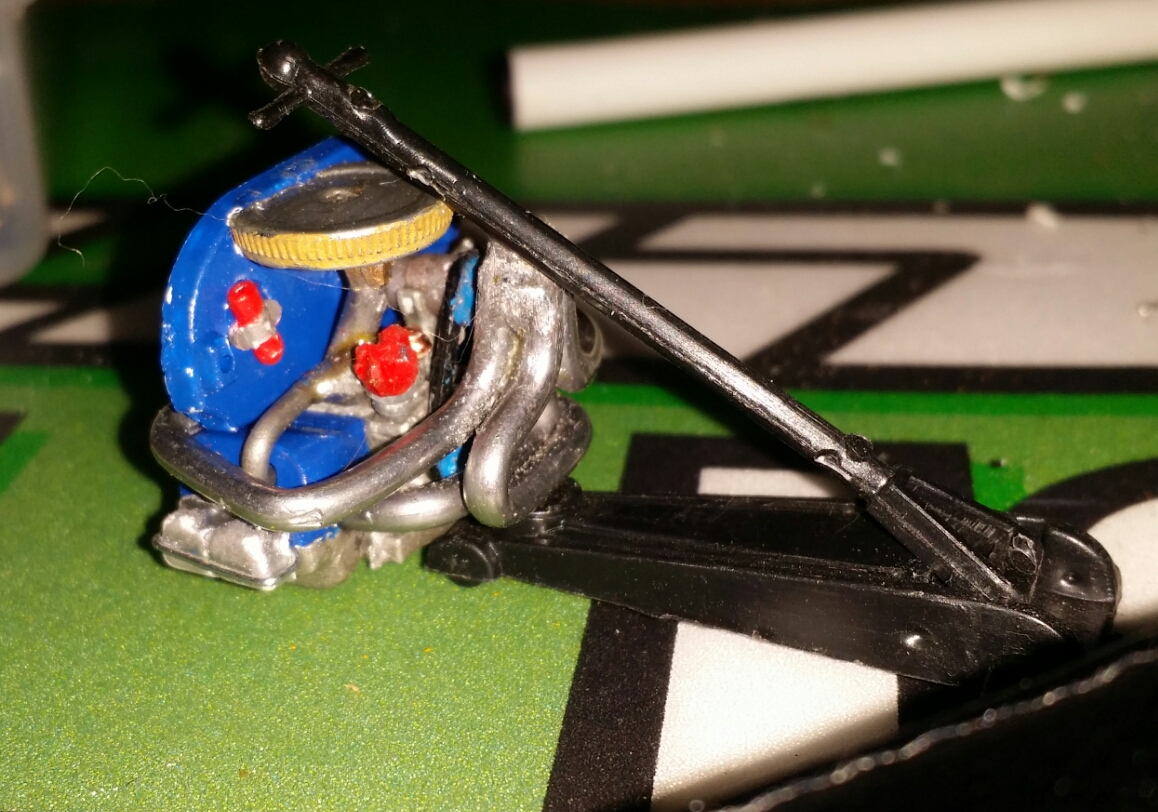

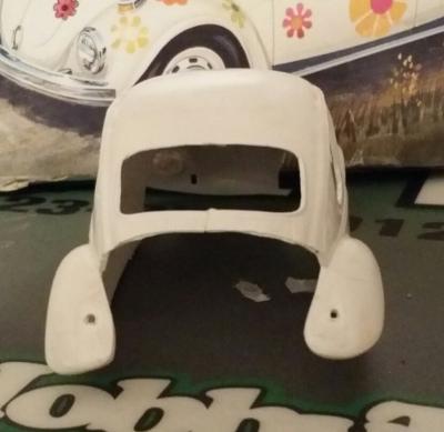

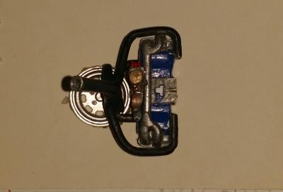

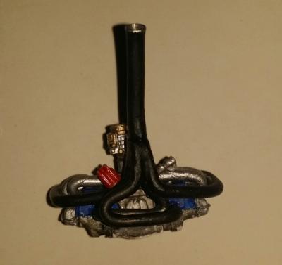

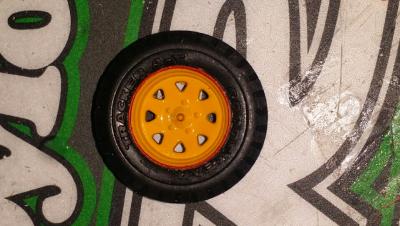

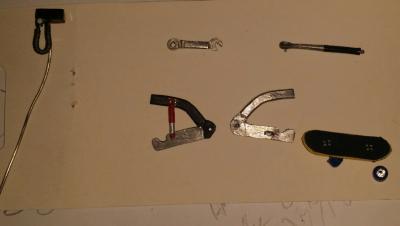

jacoballardtattoo Posted May 13, 2015 Author Posted May 13, 2015 Okay is been a bit but I have some updates. First I felt the engine was pretty rough and just plain not good enough. So I tore it apart and re-did some of it. On the engine, I completed the exhaust and painted it flat black. Created a whole new duel port fuel intake manifold. Replaced the old distributor with one that actually looks right. And put on a real carburetor. The next picture is the rear spring plates built from solder. A couple tools to put in the back. (Torque wrench and combination wrench.) A skateboard deck and some tires to throw in the back seat. Rear rim and tire with paint scheme. And the last picture is the workings of my Baja hood.
