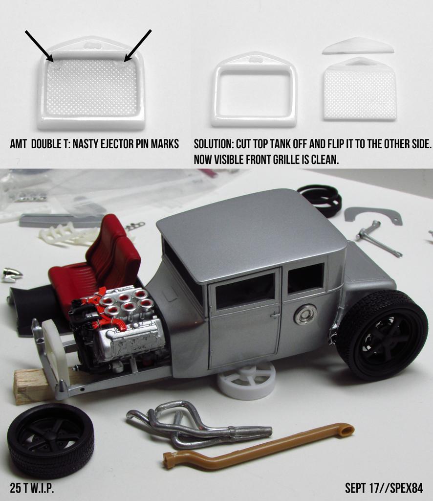

Spex84 Posted September 17, 2015 Author Share Posted September 17, 2015 It's been a while, busy summer. But this build has progressed somewhat. Engine is mostly assembled (but needs some scratchbuilt radiator hoses). Body and frame are now Aluminum.http://i107.photobucket.com/albums/m312/Spex84/ScaleModels/25 T Hi-tech/25T_HiTech_Setp17_zpsjajqrv6x.jpg Quote Link to comment Share on other sites More sharing options...

Ace-Garageguy Posted September 18, 2015 Share Posted September 18, 2015 (edited) Liking the rake and proportions, the tail treatment, the modern guts, wheels and rubber...all of it actually. Radically chopped phone-booth Ts have always been among my favorites.. Nice job you're doing with it. Just FYI...six individual throttle bodies could be made to work (I assume it's supposed to be a custom EFI setup). Might be a bugger to get the tuning software sorted, but it IS possible. Looks good, too. Edited September 18, 2015 by Ace-Garageguy Quote Link to comment Share on other sites More sharing options...
Dennis Lacy Posted September 18, 2015 Share Posted September 18, 2015 The stance and proportions look really good, Chris! Nice fab work and the engine looks awesome, too. Just FYI...six individual throttle bodies could be made to work (I assume it's supposed to be a custom EFI setup). Might be a bugger to get the tuning software sorted, but it IS possible. Looks good, too. It has already been done a bunch on the Ford 4.6 DOHC (which is what the models engine is) engines although typically there are 8 throttle bodies and at first glance they look like a 4 - Weber setup. The same is also available for the more current Coyote DOHC engines. That said, with the tuning capabilities available today there's no reason a 6 throttle body arrangement couldn't be made to work, especially sharing a common air plenum. Quote Link to comment Share on other sites More sharing options...
Spex84 Posted September 18, 2015 Author Share Posted September 18, 2015 Thanks guys. Yep, I did some cursory research into modded DOHC 4.6 engines. There's a rod out there with a very nice Coyote that was reworked to look retro. I think it was in Rod and Custom. Apparently the tuning/computer nonsense was a nightmare, as was the plumbing, but in the end it looked gorgeous. I seem to recall they put EFI Hilborn injector stacks on that one.In this case, I just wanted something exotic and Ferrari-ish.I've come up with some rectangular headlights that are going to be a love-hate thing for most people, haha. Once those are dialed, I can paint the grille shell. Quote Link to comment Share on other sites More sharing options...
