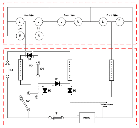

BigTallDad Posted June 8, 2015 Author Posted June 8, 2015 (edited) The diagram for dual headlights (one per side) is shown below. Where lines intersect, they are connected unless one line arches over the other. A description of each component follows the diagram. There are two outlines in dashed-line format. One represents the model, the other is the separate control unit. S1 The master on/off switch, shown in the ON position; it is a push and hold switch, to prevent inadvertently leaving power on and running down the battery S2 The headlight/parking light switch; it is shown in the OFF position S3 The brake light switch and is shown in the ON position. NOTE: if you plan on installing turn signals (as in a 1953 or newer vehicle), S3 is not installed S4 The high/low beam switch, shown in the HIGH position D1 This diode turns on the tail lights when the head lights or parking lights are turned on D2 The diode prevents head, tail, and (especially) brake light voltage from going to the front parking lights D3 An optional diode. In most newer cars, the front parking lights come on when the headlights are in use; D3 supports this function. If your model is an older vehicle and the front lights did not come on with the headlights, do not install D3. The diagram for quad headlights (two per side) is shown below. Where lines intersect, they are connected unless one line arches over the other. A description of each component follows the diagram. There are two outlines in dashed-line format. One represents the model, the other is the separate control unit. S1 The master on/off switch, shown in the ON position S2 The headlight/parking light switch; it is shown in the OFF position S3 The brake light switch and is shown in the ON position. NOTE: if you plan on installing turn signals, S3 is not installed S4 The high/low beam switch, shown in the HIGH position D1 This diode turns on the tail lights when the head lights or parking lights are turned on D2 The diode prevents head, tail, and (especially) brake light voltage from going to the front parking lights D3 An optional diode. In most newer cars, the front parking lights come on when the headlights are in use; D3 supports this function. If your model is an older vehicle and the front lights did not come on with the headlights, do not install D3. D4 Another optional diode. In the early versions of quad headlights, the outer lamp was dual element and was used for both low and high beams; the inner lamp was a single element lamp and was a high beam only. Diode D4 supports this approach. In newer vehicles, the outer lamp is the low beam and the inner lamp is the high beam; removing D4 supports this. Edited June 8, 2015 by BigTallDad

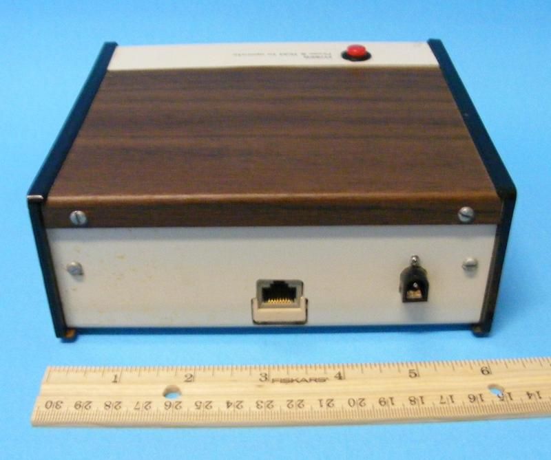

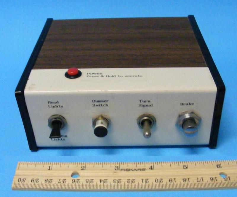

BigTallDad Posted June 10, 2015 Author Posted June 10, 2015 On 6/10/2015 at 8:27 PM, vintagercr said: Ray, what did you use for the box? I used a Rodeo Shock box; 1
