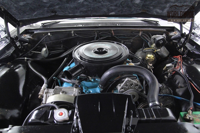

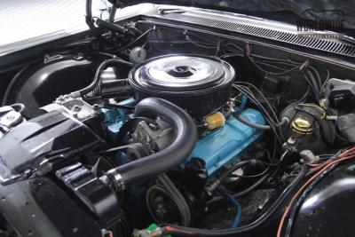

om617 Posted June 9, 2015 Author Posted June 9, 2015 Thanks for great infor guys. Not really sure what type of compressor this car has,it does have air-suspension,compressor on the right. The kit compressor. The 1:1 real deal. If GM changed to swashplate in 63 (As for the Cadillac mentioned above),i would assume it would be the right for the 64 Bonneville as well. As for the visual they both look similar,so how picky do i need to be lol Pictures found on google.
Bob Ellis Posted June 11, 2015 Posted June 11, 2015 The A/C under dash unit you are showing is a dealer add on unit, not from the factory. Most of the large GM cars from '58 and later had outlets in the dash. Some of the model cars have the dashes with A/C outlets.
om617 Posted June 11, 2015 Author Posted June 11, 2015 Thanks Bob. As for under hood it looks quite diffrent then the Cadillac unit. Maby skip the whole thing.
Ace-Garageguy Posted June 11, 2015 Posted June 11, 2015 (edited) Thanks for great infor guys. Not really sure what type of compressor this car has,it does have air-suspension,compressor on the right. The kit compressor. The 1:1 real deal. If GM changed to swashplate in 63 (As for the Cadillac mentioned above),i would assume it would be the right for the 64 Bonneville as well. As for the visual they both look similar,so how picky do i need to be lol Pictures found on google. Both of those are swashplate compressors. The compressor in your post #13 picture is a piston-type, mounted on its side (similar to the top photos, post #8). Here's a '64 Catalina with another piston-type compressor (aftermarket installation, non-factory). Edited June 11, 2015 by Ace-Garageguy
om617 Posted June 12, 2015 Author Posted June 12, 2015 Thanks for the picture. Then maby the Bonneville compressor also is aftermarket installation.
