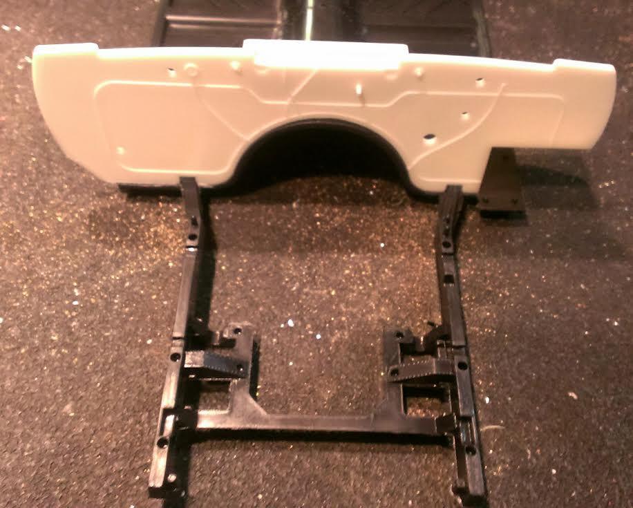

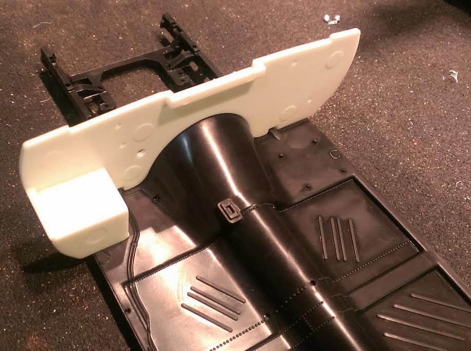

" Firewall B" in steps 4 and 5 (THIS IS THE FIREWALL I HAVE) has no notches for the hood hinges and has a block section that protrudes into the driver's compartment on the driver side floor. This firewall does fit the contour of the transmission tunnel and is notched for the framerails, but the frame rail notches are very wide.
This firewall doesn't allow the interior door panel to fit and the width of it makes the fenders pop up. When trying to fit the body/firewall/floor together, there is about a 1/4" gap on both sides of the floor were the rocker panels meet.

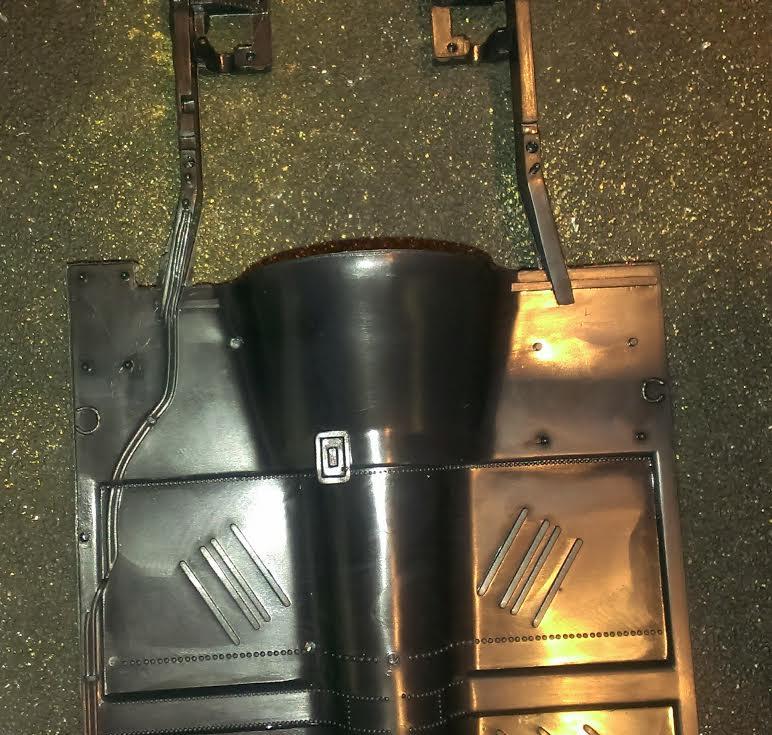

Here are the photos of the components. The firewall needs to be trimmed down .075 on each side to fit inside the body properly. Ive searched for the build and I dont see any with this firewall. All have what I called "Firewall A" If you notice the chassis section, where the firewall sits, on the driver side the floorpan protrudes into the engine bay a bit, and has 4 locating tabs in that area that nothing on the instructions say to use.

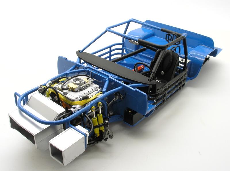

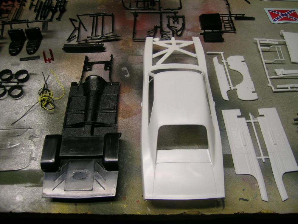

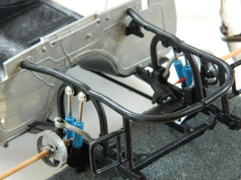

Here are some photos of other 1/16 General Lee found off the internet. The tree that my firewall was on was different.
LOL ok. I found it. This firewall belongs to the MPC 1/16 Richard Petty Charger. The odd thing is it was on a tree with the pushbar, front and rear valances for a 1969 Charger. The chassis doesnt sit right in the body either. It has the "right" rollcage system and not the NASCAR one.

hey Clutch, tanks for the heads up on the firewall unfortunately I found out the hard way I had it painted and all together until I tried to put shell on!!   " @#$$@@$$!! "
so I cut out battery box and used the end piece of battery box and glued it were battery box was, and shaved down each side of firewall like you said .075 (3/16") and it fits im post some pix of progress so far but thanks again
