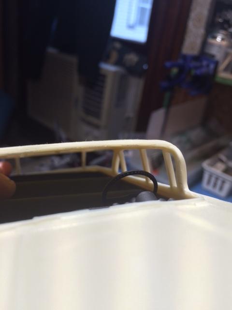

James2 Posted August 20, 2015 Author Posted August 20, 2015 This pic shows how the tub fit. I sanded the body some and the tub enough to fit properly. You can also see how high the steering wheel is. That was corrected by lowering the ledge in the tub where the dash attaches. This made more room for the glass as well. The Grill and both bumpers fit well. But the rear tails are going to need some attention. There should only be four of them, two on each side. .

Tom Geiger Posted August 20, 2015 Posted August 20, 2015 Thanks for illustrating the fitting process! Guys need to see that with a resin body you need to prefit EVERYTHING. Never assume anything will fit like a kit part. As far as the thickness of the resin body, note that bodies of this era were a lot thicker than modern kit bodies to begin with. Injection molding technology wasn't as advanced and that's why early kits had thicker plastic, or even multipart bodies due to the limitations of the molding processes of that era.The tail light issue is a carry over from the original promo / kit. It would be nice if someone did a 4 light master and sold it as a resin part! I have one of these wagons sitting because I haven't wanted to tackle that one!
Bob Ellis Posted August 20, 2015 Posted August 20, 2015 Tom, you are correct. It has to fit before paint and assembly.I am guessing that maybe there is a 5% shrink in a resin copy versus original. Even still, the body is thicker in the resin that original and it is not consistent in thickness.There are 2 Modelhaus '60 rear bumpers. One is the Impala shown above used in the AMT Craftsman Nomad kit. You need to order the promo '60 rear bumper for the Nomad which has 4 tail lights.
James2 Posted August 20, 2015 Author Posted August 20, 2015 Tom, you are correct. It has to fit before paint and assembly.I am guessing that maybe there is a 5% shrink in a resin copy versus original. Even still, the body is thicker in the resin that original and it is not consistent in thickness.There are 2 Modelhaus '60 rear bumpers. One is the Impala shown above used in the AMT Craftsman Nomad kit. You need to order the promo '60 rear bumper for the Nomad which has 4 tail lights.Or make your own!
