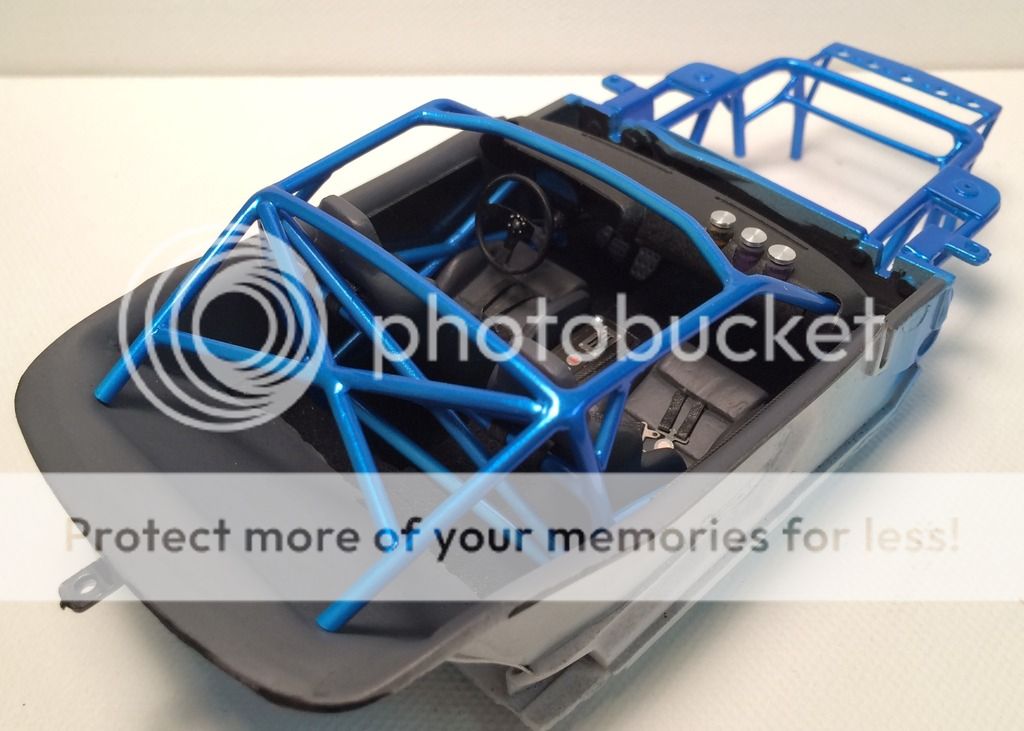

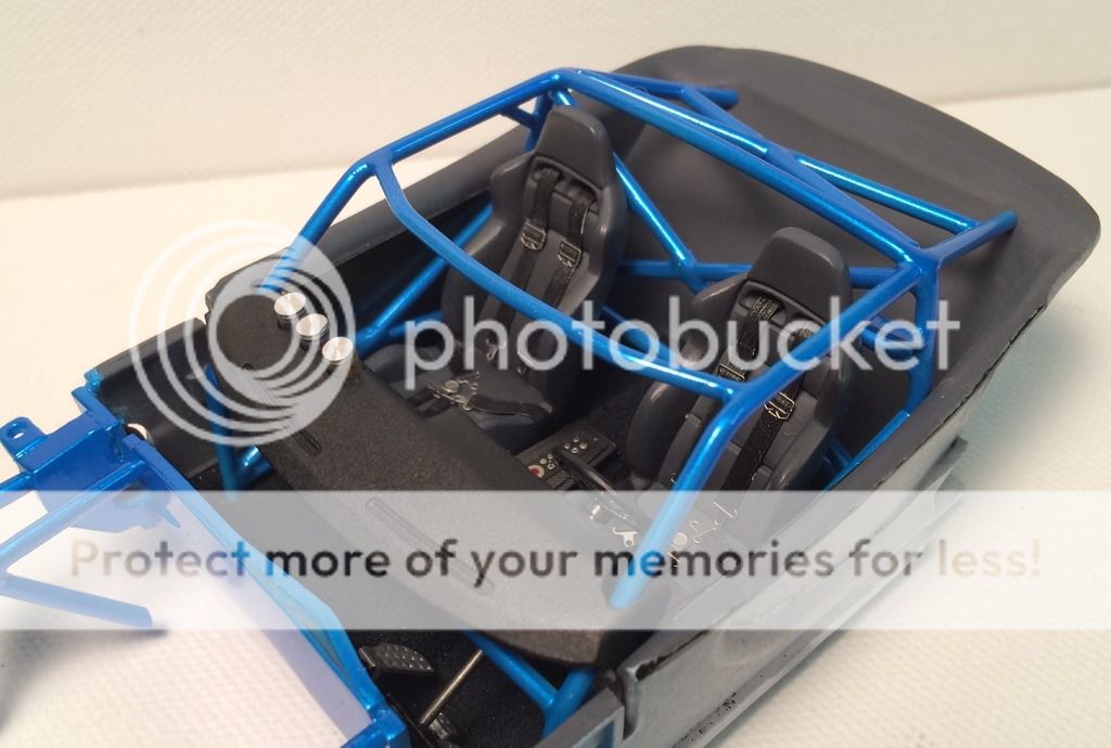

Quick weekend update here... Interior and Chassis are pretty much done, plan on dropping the engine in tonight.

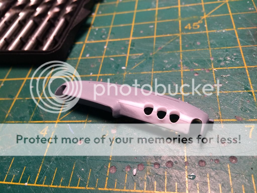

First up was the dash, needed to drill 3 holes for the remote brake & clutch reservoirs:

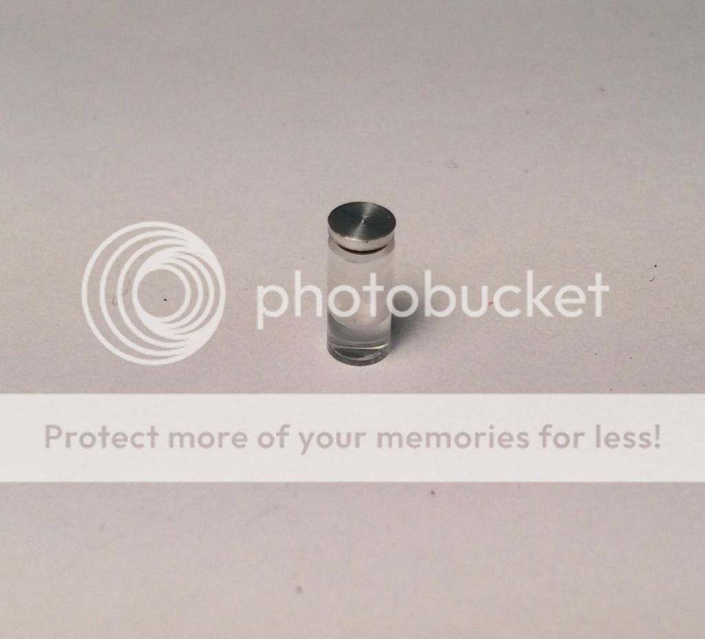

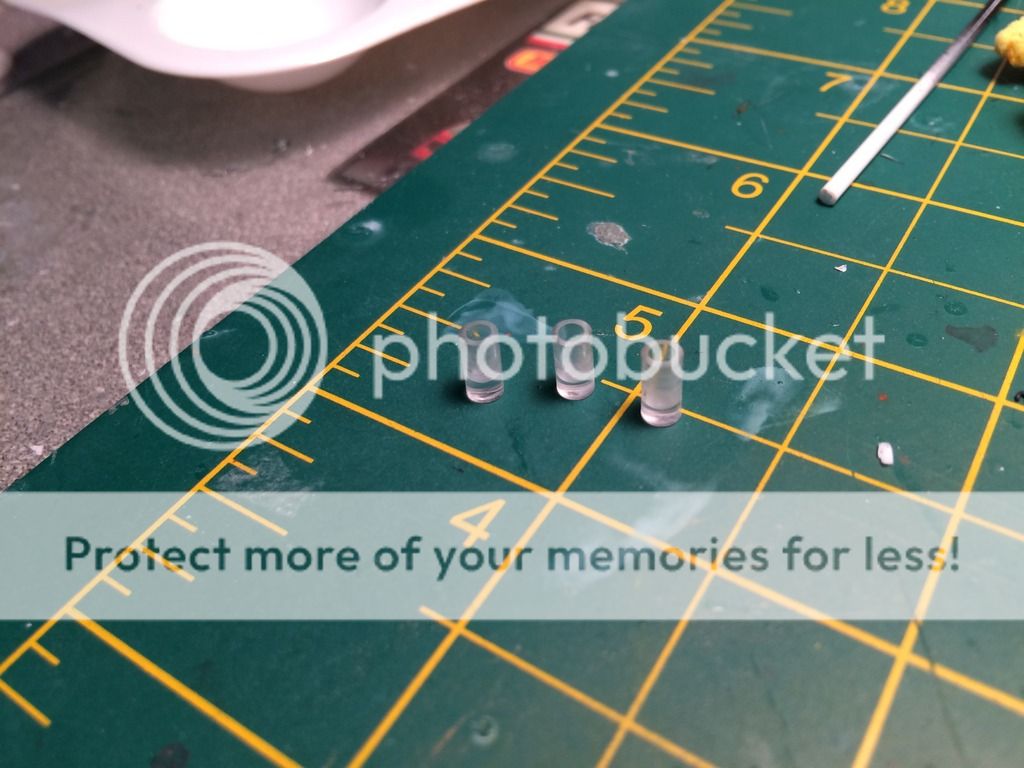

Then make the resivoirs.. 1/8" acrylic rod on the lathe:
Then some caps:

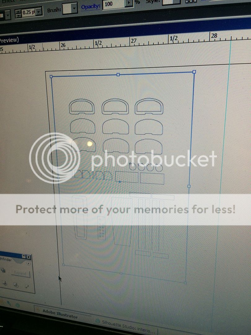

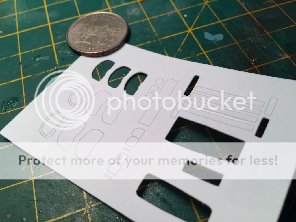

Next up was the DigiDash and Center console, started off in illustrator, drawing all the pieces and parts:
Sent to the cutter with .010 loaded up:
Painted, Decal-ed and Future-ed

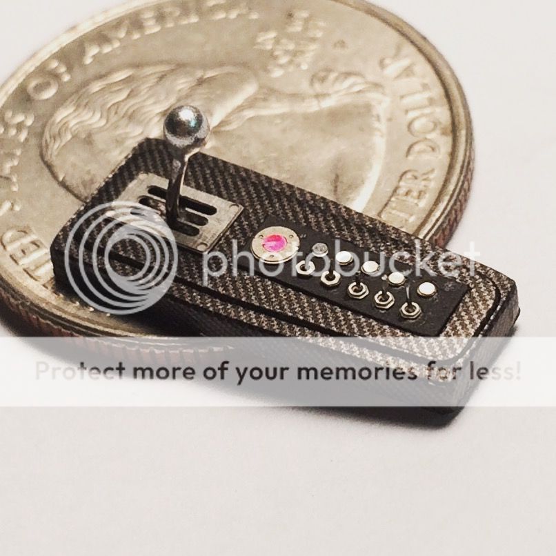

Same with the Center Console... Scale Production shift gate, Straight pin shift knob, S&S hex nuts with wire for toggles, and a random P/E piece as the start button:

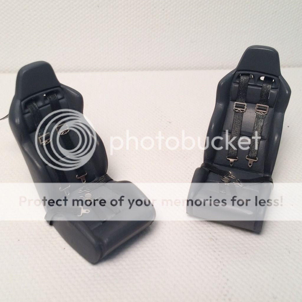

Seat belts with the crazy modeler FXX P/E hardware.. belts are .005 styrene scuffed in one direction with coarse sandpaper:
Finally all together and assembled!  I filled the reservoirs with future tinted with some yellow and purple acrylic paint...They turned out a little to big in hindsight (both tall and diameter)  but i still like the little added detail:

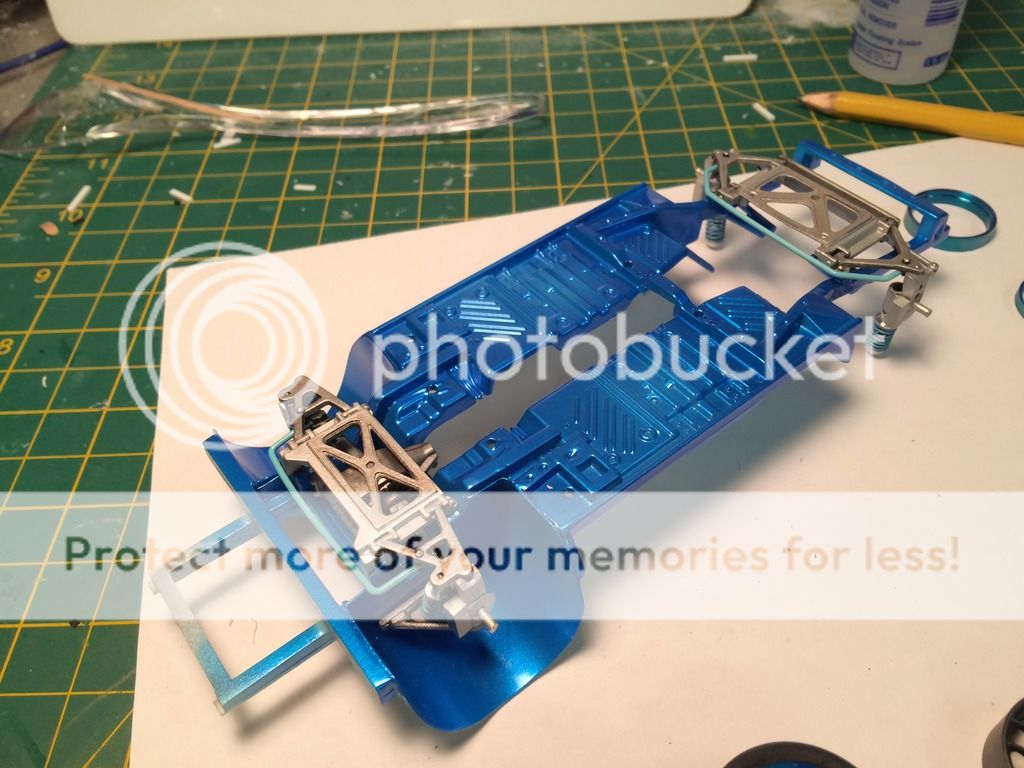

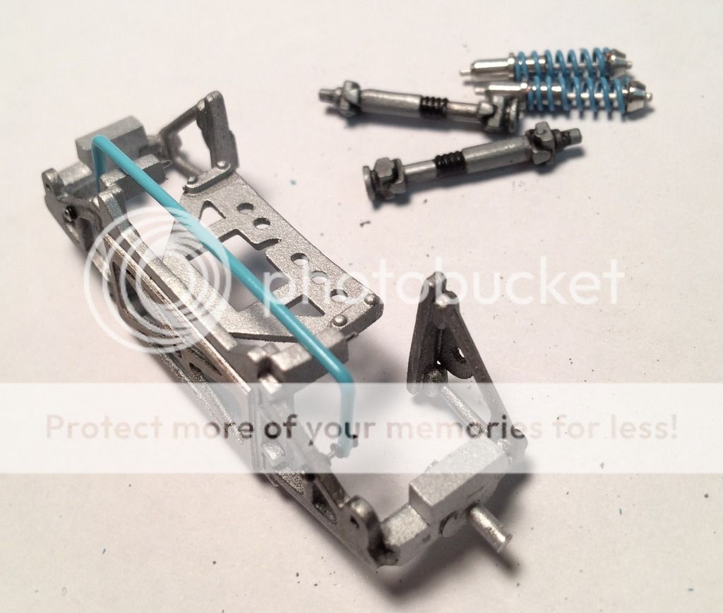

And then finally the chassis assembly.. which was quite easy to this point... its mostly covered with the belly pan:
One little fun detail i did because I could... Swaybar links!  I picked up a set of micro O-Rings and the smallest size slips perfectly over a straight pin.. so i stacked them up and made links.. I will add a Photo-Etched boltheads to the pinheads later as a final detail.
Link to O-Ring set... they really are tiny-tiny.. and come in quite handy.
http://www.banggood.com/Mini-Small-Rubber-Washer-O-Ring-Watch-Crown-Waterproof-Watches-Seals-p-72731.html
Assembled chassis:

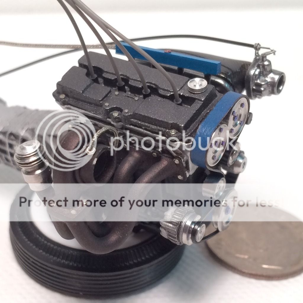

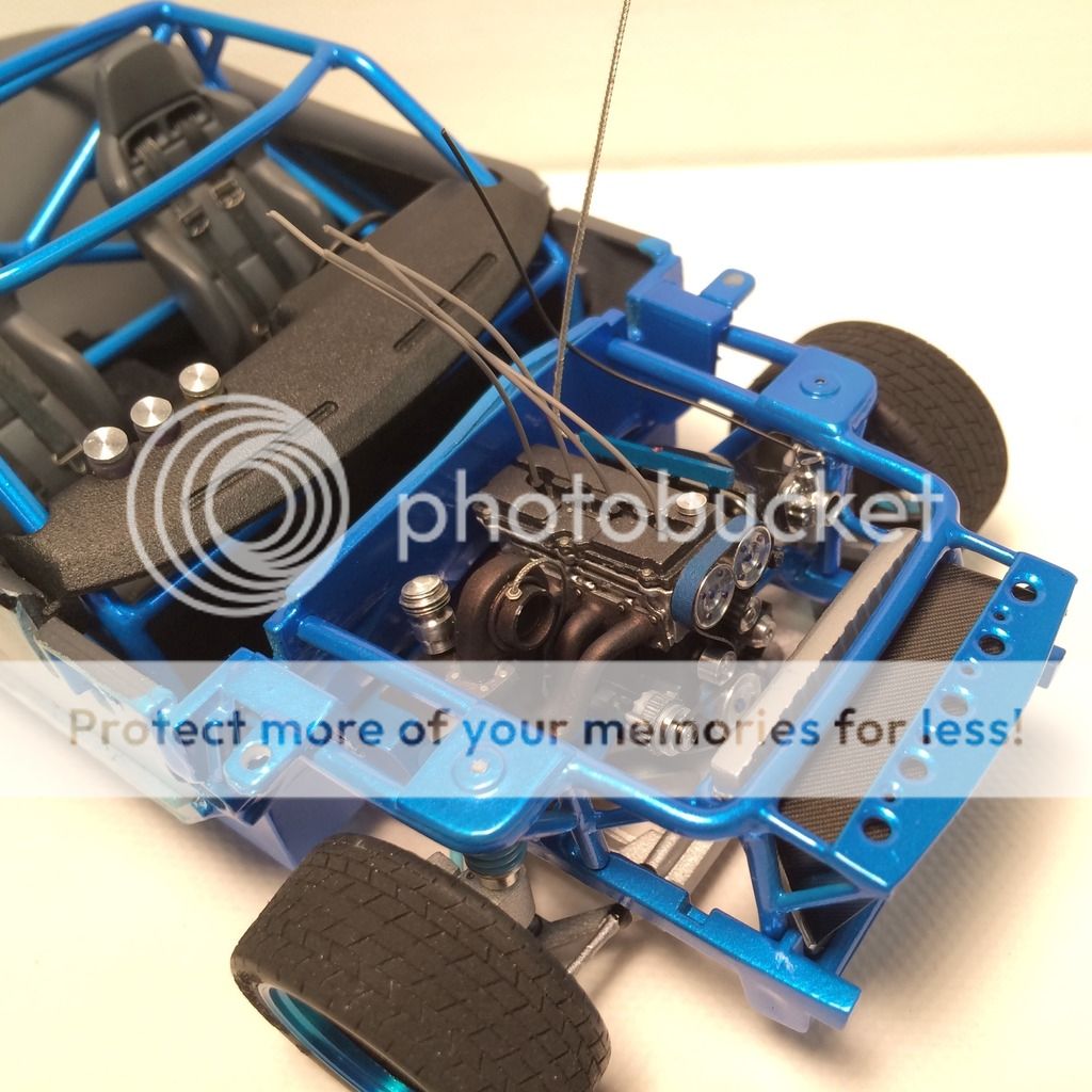

Engine done, and installed into the frame:
I "dropped" the interior over it to check fitment, and see how it looks. This thing is going to be a pain to get together, im already a little scared.
