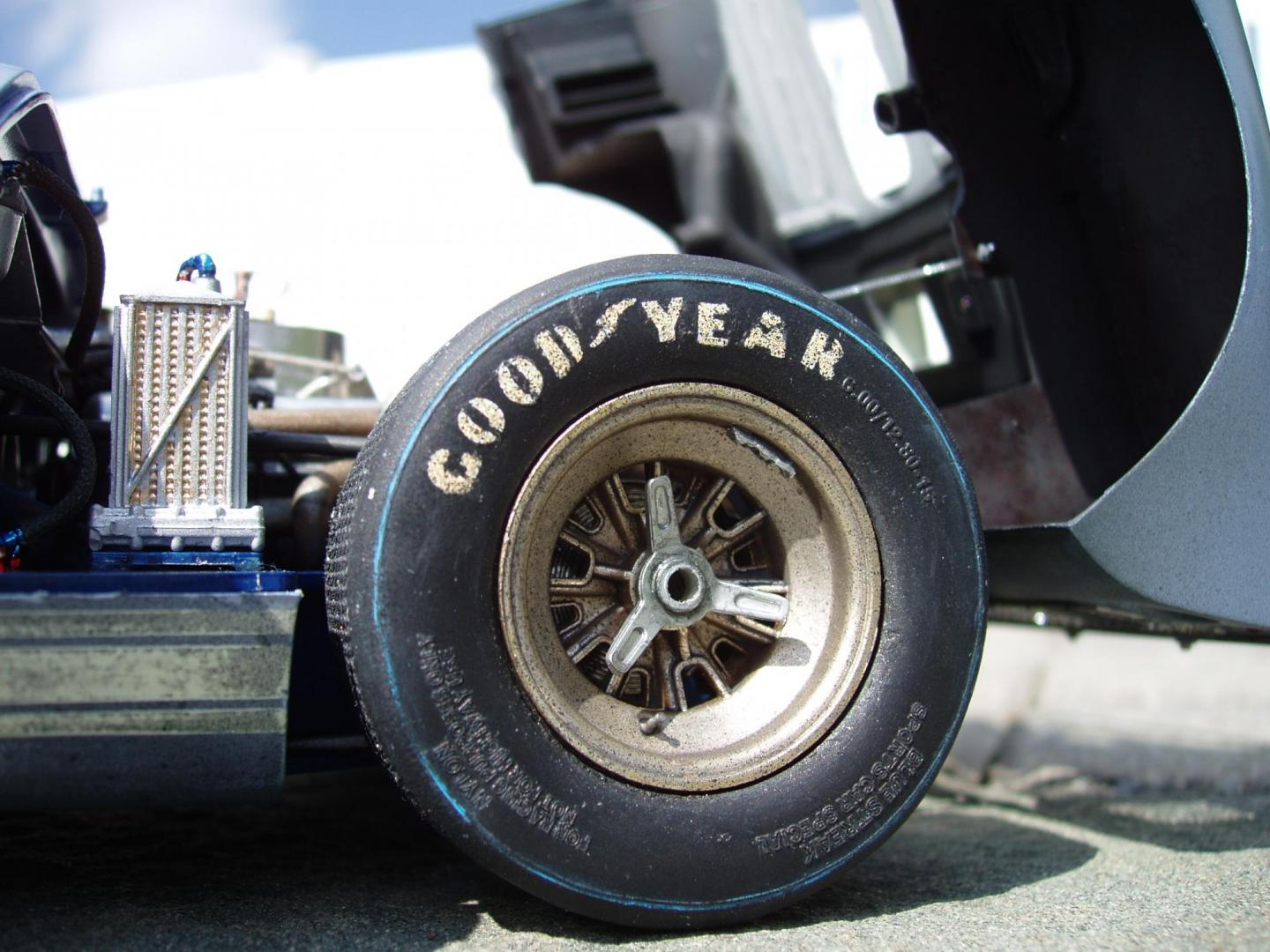

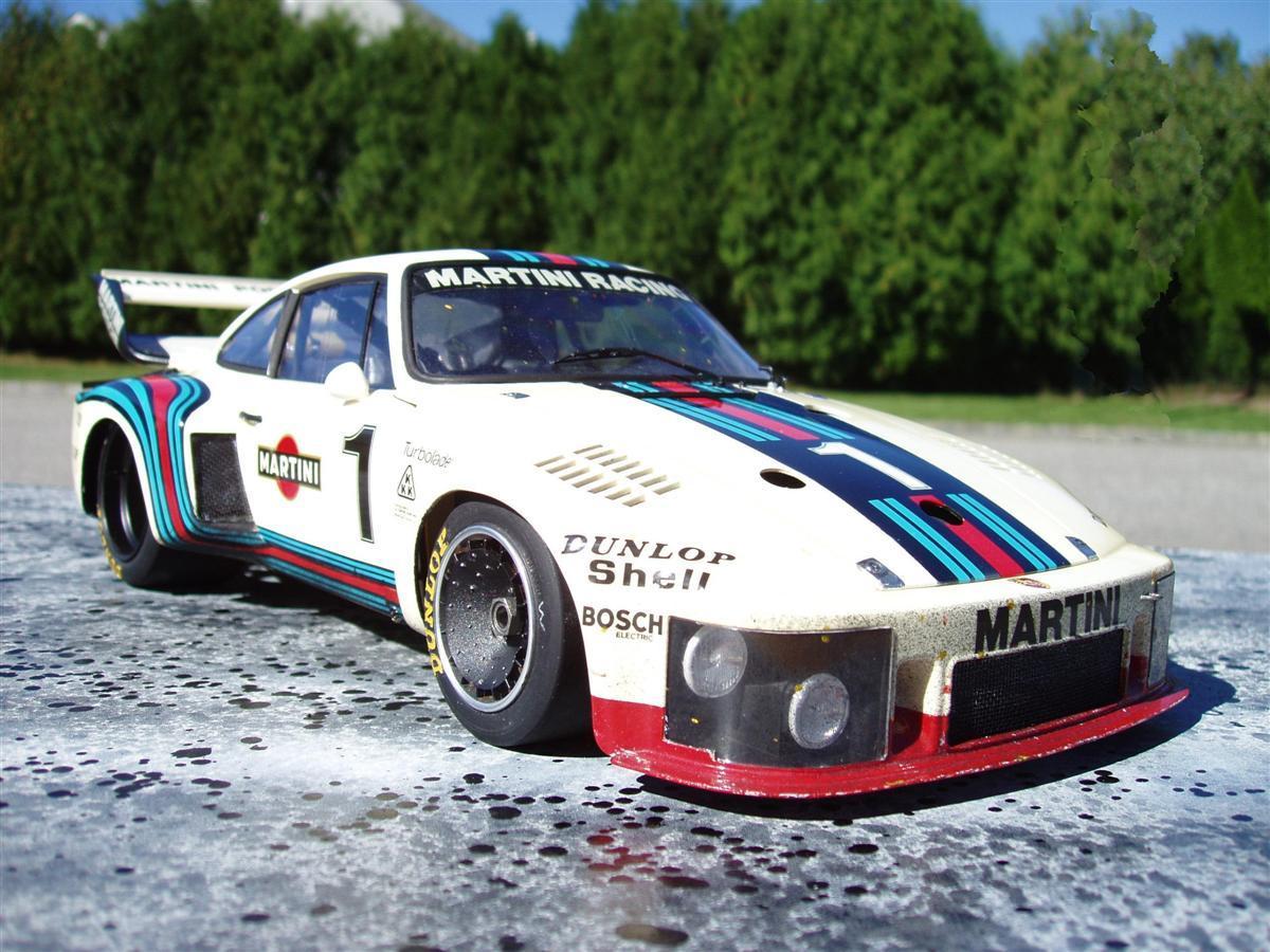

Cato Posted August 31, 2015 Posted August 31, 2015 cotton will depress over time. Who knows if there will be a chemical reaction from silicone, Do what the demo derby drivers do.. fill them with sand The cotton I advised Skip about, which is in my GT-40 tires has not depressed in 5 years. Nor my 935 after 26 years. Has it happened to you?
